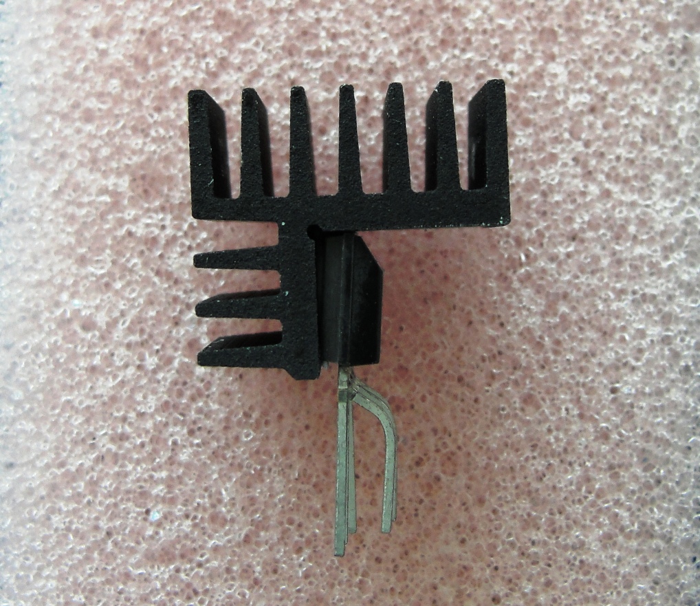

i have a heap of mills for the 0r47 in amp and power supply, they come standard as 1%, but really for the source resistors i should match further by hand right? fets are matched, should i do this, or will it be thrown out by the rest of the parts tolerance and need to be trimmed out anyway?
scaiff001: which jfets do you have? its easier if you are more specific. if you actually have a j109, there is no heatsink for them unless you use a cpu sink and glue it with silver epoxy. if you are using 2 x j74 and you have matched them, it realy depends more on whether you need more drive from them depending on your build. heat stability can be managed fairly well with matched units by gluing them face to face, but if you need to get more current from them the heatsinks you get from Patrick's (EUVL) partner mark lai. message him through the forum. Peter may even have some of them. this also helps them track over temp, but i think if they are matched well glueing them will do well also

> Do the JFETs require heatsinks on them, if so dose anyone know the email address of the person who is selling them ?
http://www.diyaudio.com/forums/group-buys/135359-toshiba-dual-jfet-heatsink-6.html#post2366641
Pls also read post #282 re shipment conditions.
Will fit the PCB from PD.
We actually sent him a few.
Patrick

Further on what qusp has said: PD's boards that you have won't allow gluing the J74's face to face. EUVL's wee sinks or maybe a TO-220 clip type heatsink?

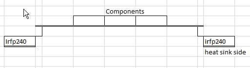

On PD's boards is it best to mount the mosfet from the underside of the board then bend them up to give a decend amount of clearance from the heatsinks?
Yes, that's the best way. You also don't need any additional mounting screws to support the board.
