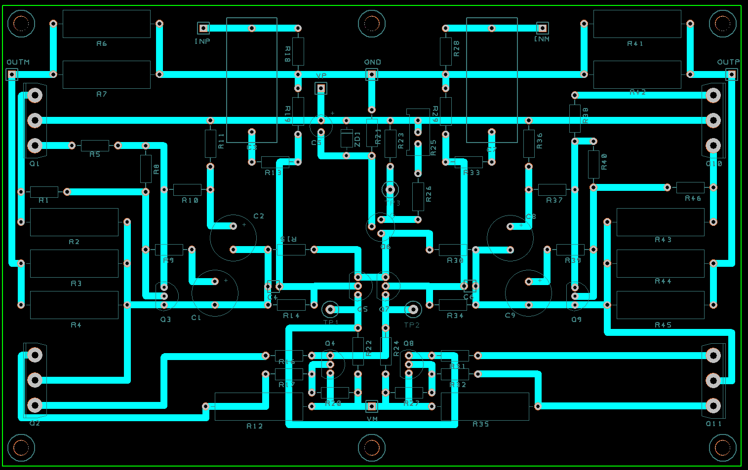

PCB design feedback
I would like feedback on my PCB design for an Aleph JX variant.
Some background information:
- The power supply rails are +22V and -22V respectively (determined by an old trafo I want to use for the project)
- The amplifier is biased to 2.5A per channel (to achieve 2x10W in 4 Ohm)
- The PCB tracks are 1.45mm. They should be able to handle 3.3A with a temperatur rise of 10C -- without accounting for any derating from nearby tracks and components
- I have tried to make the PCB design as symmetrical as possible for aesthetic reasons
- I have tried to reduce the length of the PCB tracks as much as possible
- The PCB is single-layer
- The board is 160x100mm
-- Peter

Any feedback is welcome (note this is my first PCB design). In particular I would like feedback on whether I should I keep the track from R22 round-about to R31 (at the bottom center of the board) or whether I should make a jumper shunt to shorten the path.
- The PCB tracks are 1.45mm. They should be able to handle 3.3A with a temperature rise of 10C -- without accounting for any derating from nearby tracks and components
-- Peter
I don't know if it's easy, or whether you have a different idea (a heatsink), but if you can face Q5 and Q7 toward each other, you could cable ties them together for better temperature matching.
I havent decided how to thermally coupling and heat sinking Q5/Q7. Ideally, I would like to get my hands on the dual TO92 heatsink (without having to buy 25 pcs). If I cannot manage that, I'll probably end up facing them toward eachother and clamping them to a piece of aluminium. In free air I believe they are rated at 180 C/W. At 10mA bias per JFET they should produce 170mW each, which is a 31C temperature rise (minimum). Thus, I would prefer a bit of heatsinking to reduce this.
Whatever I do it will require some minor modifications to the PCB layout.
Uh?
You run the tail current source at 0.7/1.1=6.4mA and that is shared between the two jfets. These little buggers run at far less than your figure.
170mW is anyway far above a reliable number, try to stick below 100mW for reliable long term use. You might want to think about a cascode, as it further cuts down power dissipation, Miller capacitance and improves noise.
Hannes
i think hes talking about with the little to92 heatsinks installed. still might be a bit high

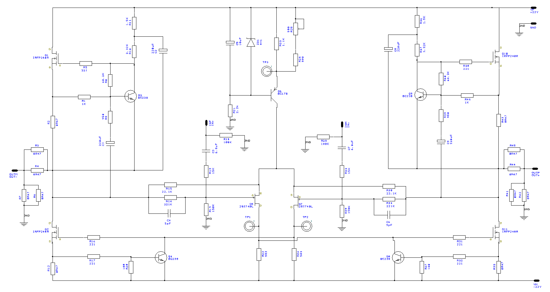

My intention in the schematics was to make an adjustable current source in the range 16,5mA to 25mA (and to tune it around 20mA once I build it). This is how I came to those numbers: R23 is 1.1K. R25 and R26 are 500 Ohm each. Together they can be adjusted from 344 to 524 Ohm. I assume the voltage drop across the zener minus the drop of BC178 is 8,6V (should be close enough). That should allow me to adjust the current from 16,5mA (8,6/524) to 25mA (8,6/344).
I was thinking that it would be ok to run the JFets at 170mW each with some heat sinking, but I take your point and will reduce it further. I must admit that the 10mA bias (per JFET) was chosen somewhat arbitrarily.
