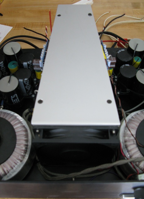

give us picture from bird perspective
if you're just blowing in da case , effect is minimal
you must have proper intake opening at case , same as as proper outtake opening at case

ZenMod said:give us picture from bird perspective
If you are taking requests, I would like to see a photo from a Gazelle perspective...
Intake openings are ~5X the area of the outlet, which was shown - the two opposed heatsinks with fins touching.
The intakes are:
a) rows of vent holes along sides of case - larger holes along the bottom and smaller holes along the top.
b) a row of ventilation slots in the top - located on the other side of the A-J boards from the fan (so resistor heat will be exhausted).
c) rows of vent holes in the case bottom immediately under the A-J boards.
Air speed through the heat sink 'tunnel' is fairly lazy to cool this...

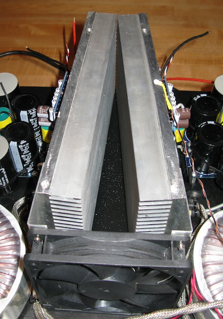

yes , but you must have defined tunnel from one side of case to other side of case
if you dont have cold air intake and hot air outtake , all you are doing is just warbling hot air in case

Sorry! Here the top of the tunnel is opened up, so you can see the heat sink fins and the position of the thermocouple (yellow heat shrink) for temperature readout. The case layout with closed front was intended to minimize fan noise in the room. Again, air inlets to the interior of the case are via rows of holes in the sides, bottom, and slots in the rear top. The fan draws that cool air past all of the interior components and then blows it out the back over the heatsink fins. The full back plates are not yet made, but will be split so the rear of the heatsinks are open.
Again, with the 12V 1200 rpm fan at full speed, the heatsinks rise about 24 degrees C above ambient. That fan speed is audible outside, though not annoying. With the fan slowed down just beyond the threshold of being heard outside the case, the heat sink temperature rise is ~30 degrees C. So I think I don't want more bias because in summer the ambient air temperature can easily be 10C higher. That means about 60C for silent operation, 55C when I'm rocking-out and don't care about a little fan noise. 😉 What do you think about those operating parameters?
