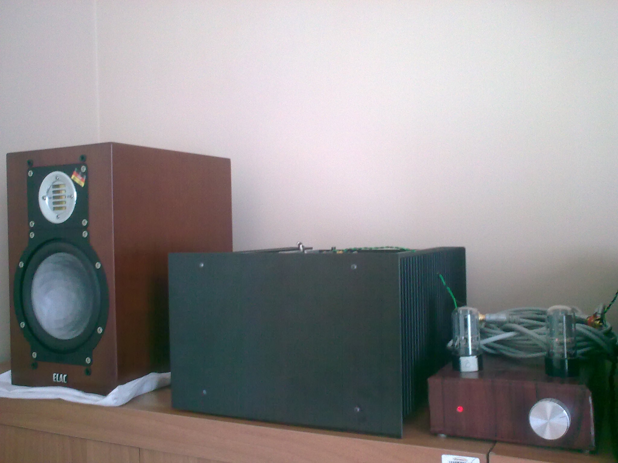

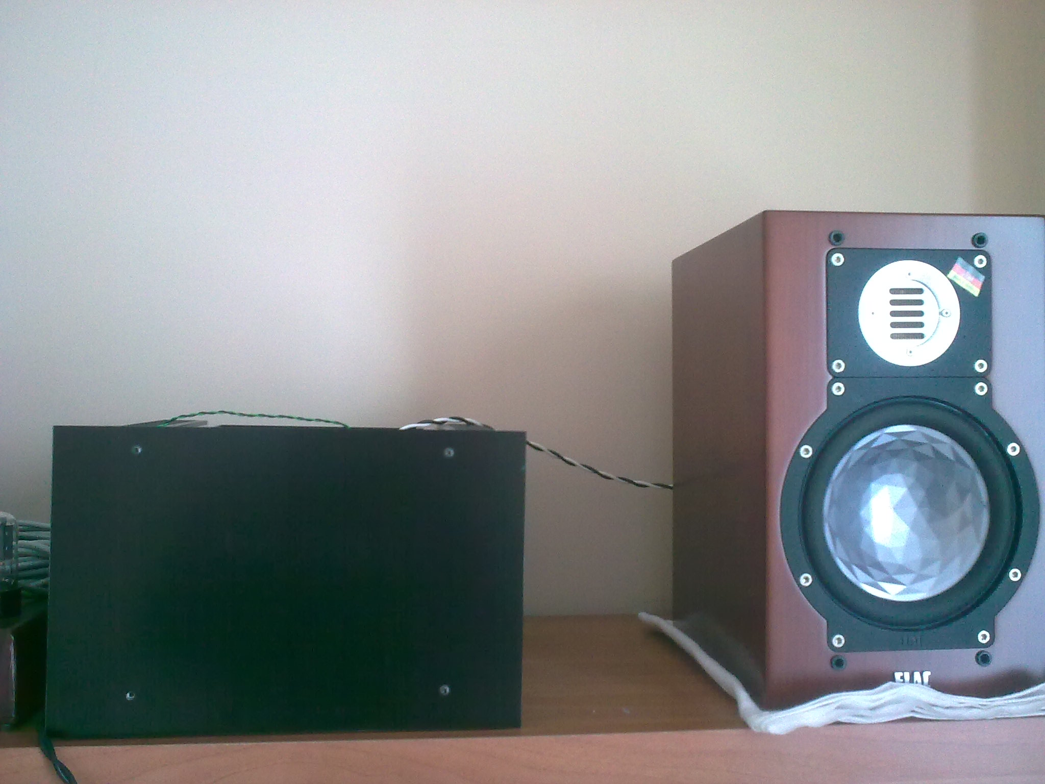

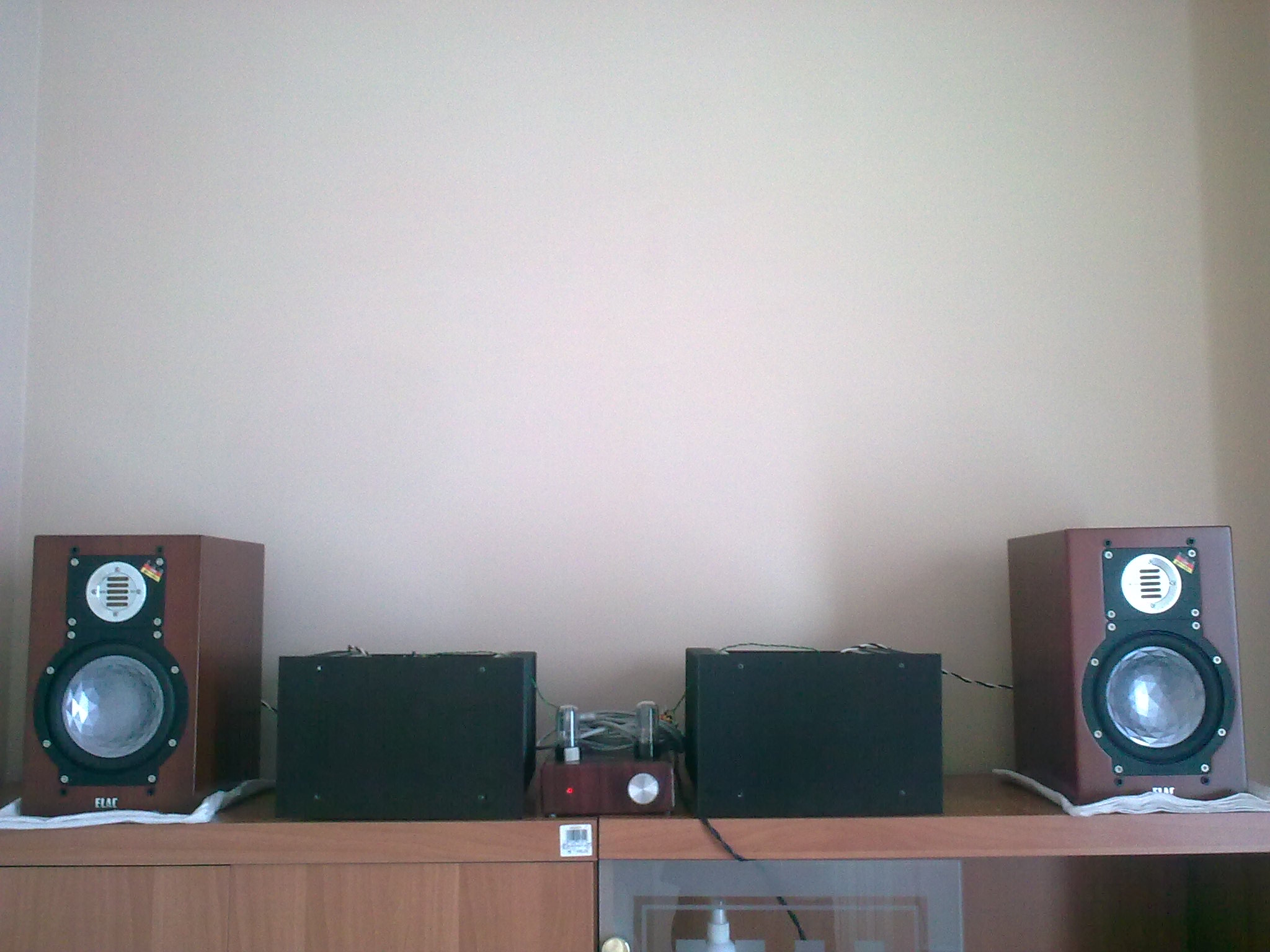

at 1.6 amps/fet bias the J`s have a little bit of control over the low spl, low impedance speakers which I have.sincerely didn`t heard them sound like this before, this is first listening impression but there will be more in the next hours..days
I have to adjust a little bit the offset and probably lower the bias
will do some ''real'' photos when I finish everything...everything except listening to music 🙂
still have to drill holes for feet(Adam Hall 4909), input/output connectors(cmc silver type), top plate for cooling and for power on led, after I can say I have almost finished the amps
they do worth the waiting and the effort of the build
