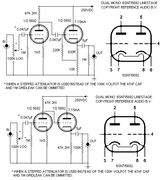

no, I use the second version of the schematic above with 6sl7 as amplifier stage and 6sn7 as buffer, with a separate casing psu

with 6SL7 you're having way too much gain
not exactly most clever solution , looking from signal leveling point of view - too much attenuating and then too much amplifying
with funny J , all you need is gain of 2-3x , at least I prefer stages like that to purely passive
I also like iterations with just proper buffering , so no gain at all
@ Schultzch - yes , exactly
buzz - you have any possible part candidate for that pre ?
anyway - why using part with questionable triodish characteristics not easily available, when you have part which is exactly triodishly triode itself , easily available ?

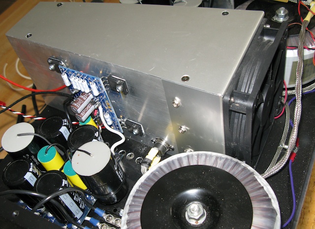

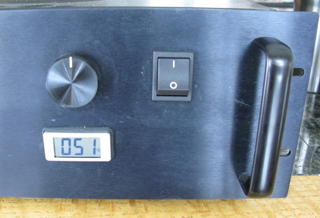

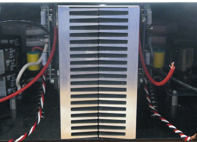

Answer to my own question: I don't have much thermal headroom to raise the bias anyway, so the R27 pots are sitting at 64k. With that amount of current, the temperature rise is ~32 degrees above ambient with silent airflow, 27 degrees with the fan 'barely noticeable', and 24-25 degrees with the fan at full speed of 1200rpm. If you are curious, images are the air tunnel, the front panel fan control with thermal readout, and the profile of the air exhaust. The power supplies have 75 degree thermal cutoff switches on the heatsinks.
