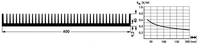

I found them at the Steeles Ave location of Active Surplus in Toronto. This was several months ago, and they had 3 or 4 of them for $75 each. It was actually one large heatsink that t I had someone cut in half to make two. I wish I had bought them all. As a surplus store, they were unsure of their source. I have also never seen them before or since. They were gone the last time I was there. Unfortunately.
For even better heatsink performance you could cut them in half again and join them length wise.
Tall heatsinks aren't as efficient as long heatsinks so if you need more cooling cut them in half again
No way would I cut them again. If ZM says they'll be OK then leave them. They look really great the way they are.

Should be fine but if you need more then you have options.Hopefully they will be big enough as they are. It was a lot of trouble getting them cut.

Does anyone know of a silent fan scheme that could be used to increase cooling on a Aleph J with undersized heat sinks, or allow for a hotter biasing on properly sized ones? From what I can gather online, it seems that even a very low speed fan would greatly increase the efficiency of a heat sink by creating turbulence and helping move air through the fins. Some of the computer fans i've seen are rated at 11-12db.

Hi Zen Mod. What I was looking for is something that would be outside the chassis and separate from the amp. I built a "quiet" computer last year, but it's still too noisy for a listening room. An external fan circuit recipe would be great that allows the fans to be added to any amplifier and slowed down enough so that you can't hear them. No rush though as I haven't started soldering yet and, as you said, it will be OK as it is. Seems to me that it would save a lot of space and money in big heat sinks if there was a recipe for a fan set up that was quiet enough to use in a listening room.
