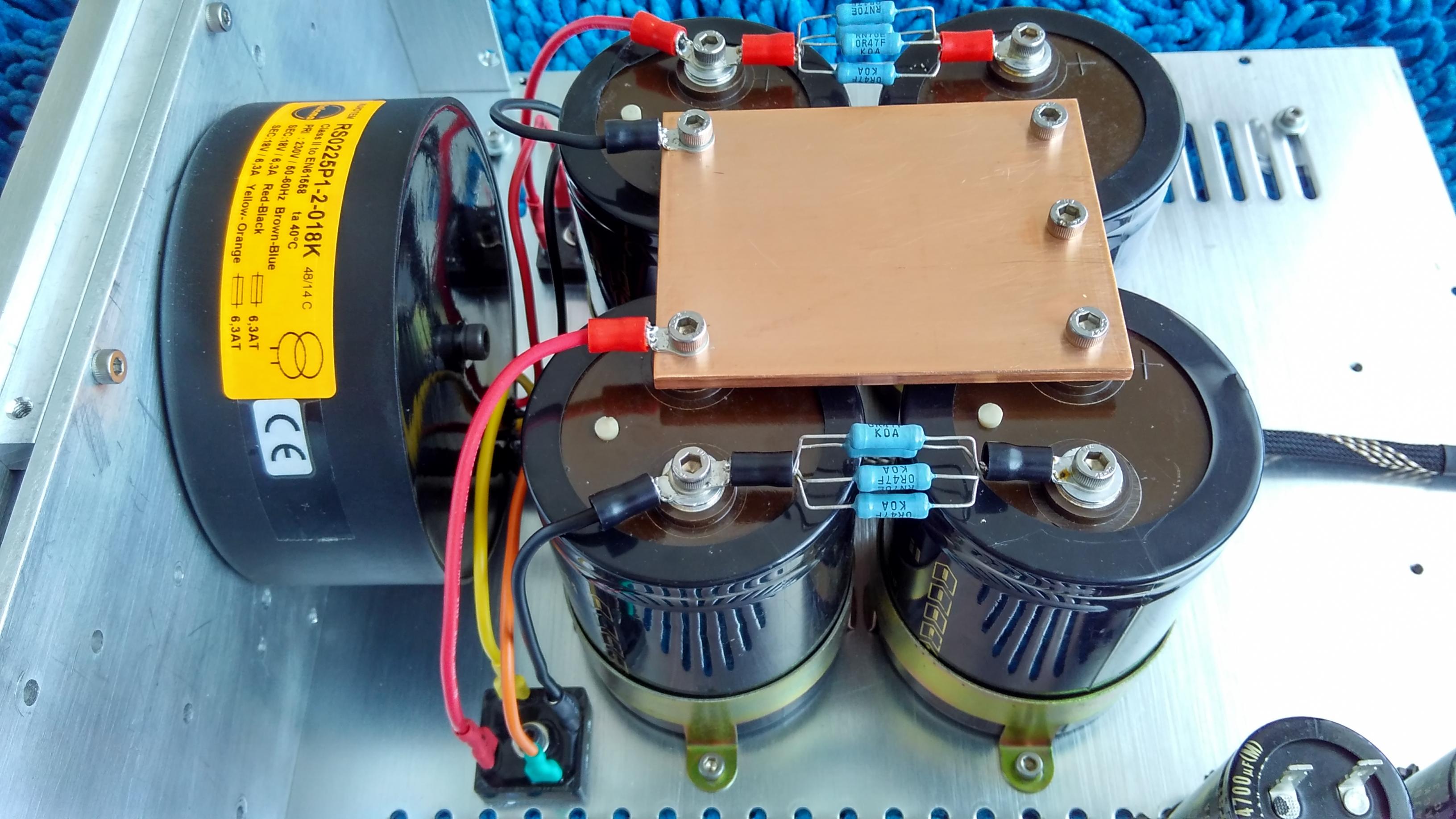

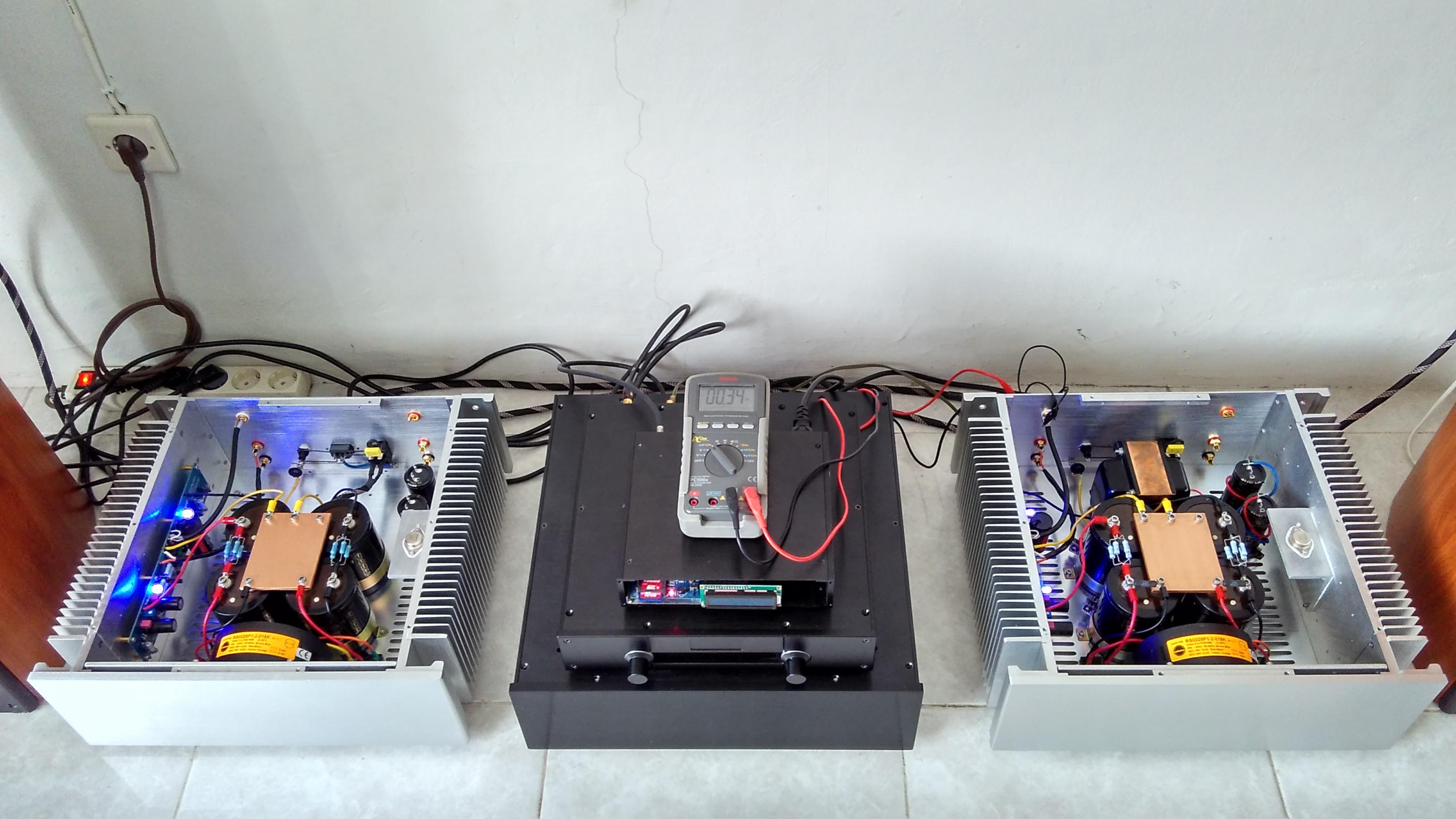

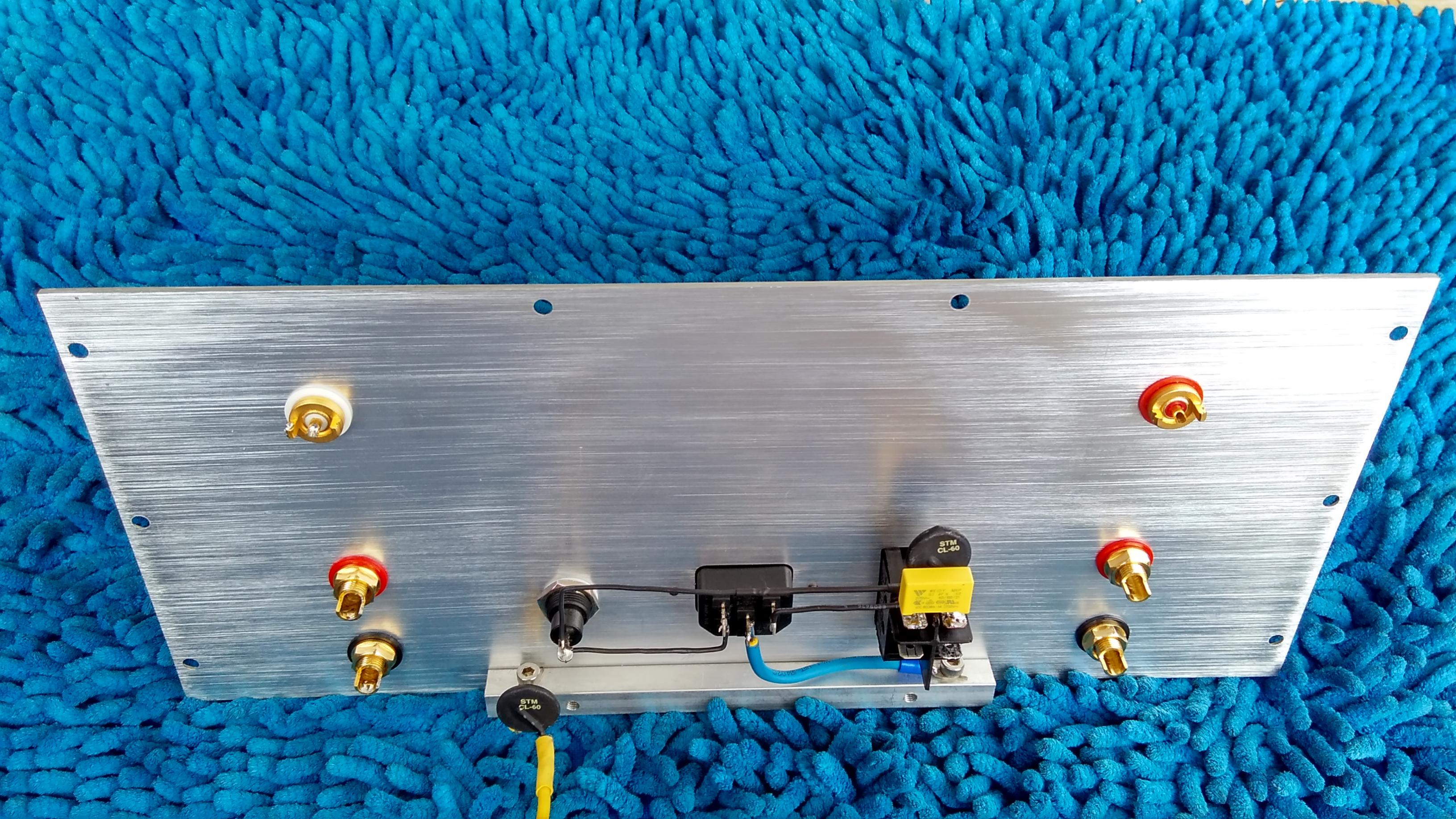

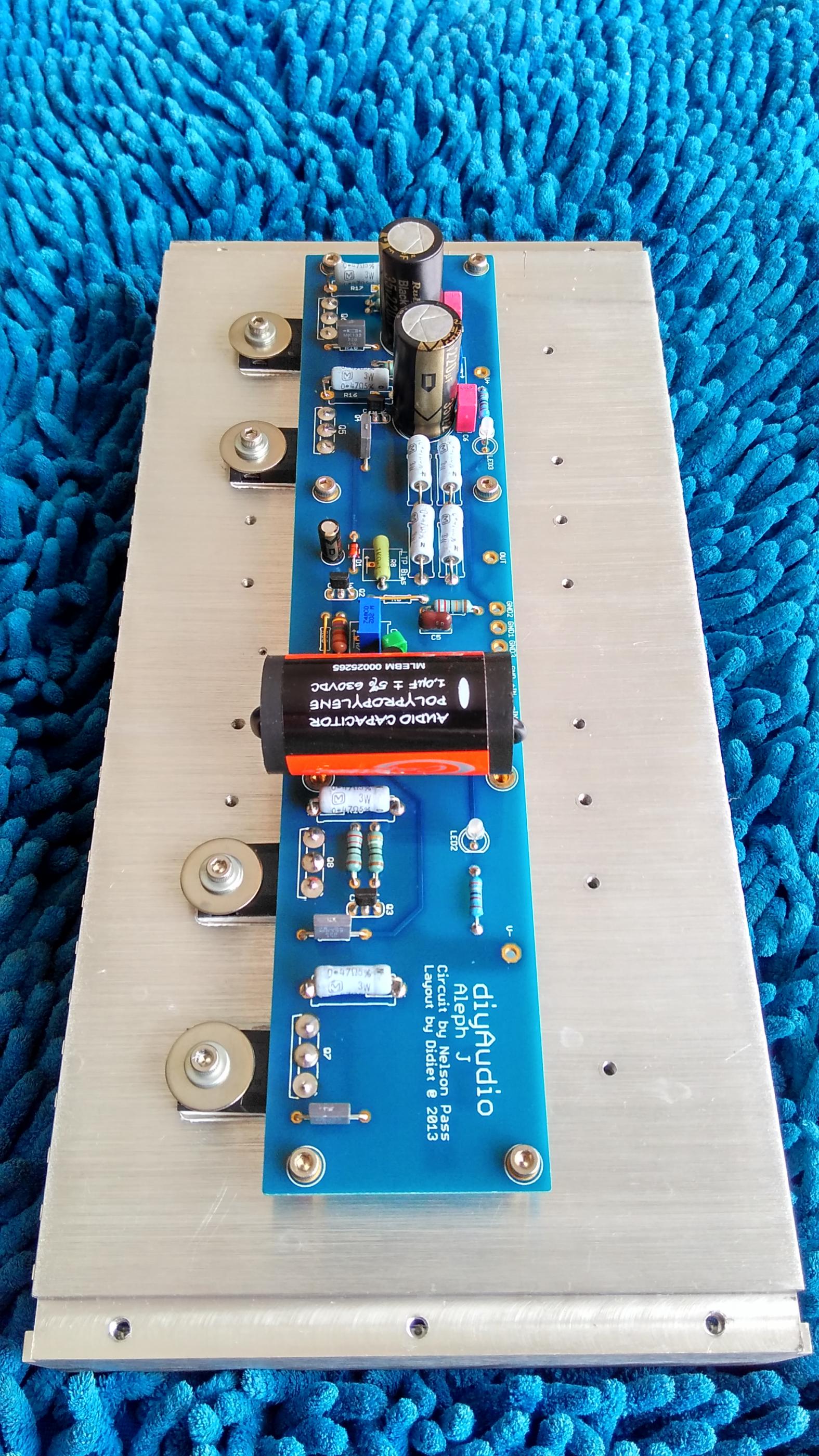

finally another block AlephJ is almost completed, both are biased to 400mV, dc offset is great. I have tested with 500mV bias and it's 52°C with air conditioner air blow directed to them, but it's just for testing.

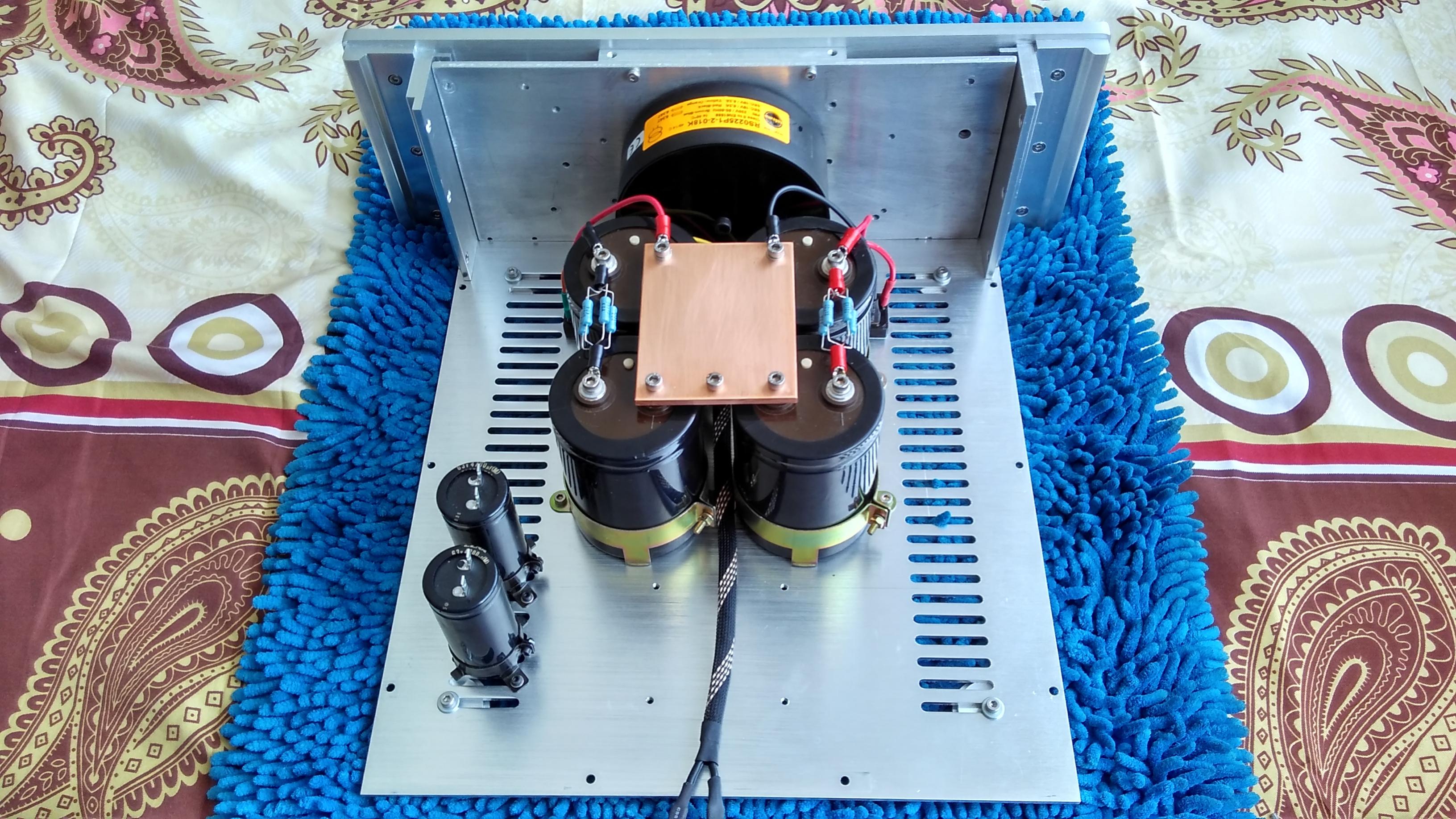

since this is my first use on copper plate, just find out that my finger sweat react with copper and create ugly surface with so many finger print. air humidity also seems create darker colour on the surface after days. i have to brush and paint with clear coating, not to forget using gloves. it looks shiny now, eventhough square area around connector is uncoated.
the problem now is that i dont have 1 power cable for preamp and 1 channel still dont have 2K2 bleeder, the joy must wait for stereo listening.

so it's worth to get best you can get on each part of it. I have got my choke 300mH 3A with M6 core, 4pcs elna cerafine 4700uF for output caps. ordered it 1year ago before currency xrate going crazy. I cant wait to compare both of them using fullrange driver, I'll test my rig on my friend's listening room with fostex206 and 3way floorstand with sba satori driver.

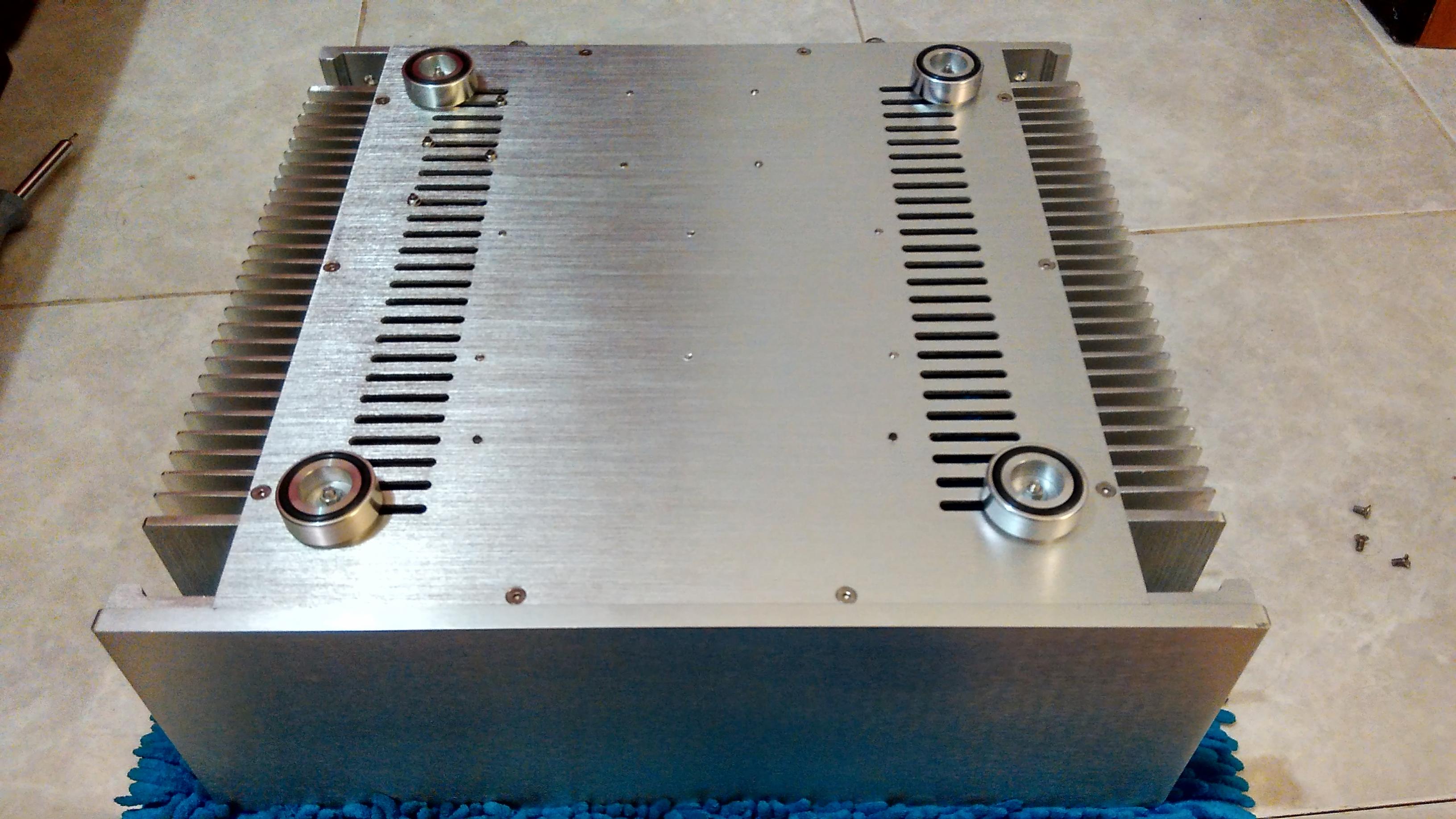

no switch for swapping AJ/SIT, it's bad idea. I only need to remove some psu cables. it takes a long time and multiple layout until i got this final one. As papa mentioned, power supply and chassis is the heaviest and most expensive parts on your amplifier, but UMS idea and Papa design that occupy same power supply is incredible

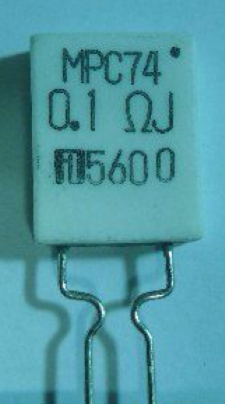

Stay Gadut with yours and if you have curiosity first change only one 0.47R
this of output transistor and it is immediatly audible and after
you can change all source resistors mox Panasonic's if your taste.

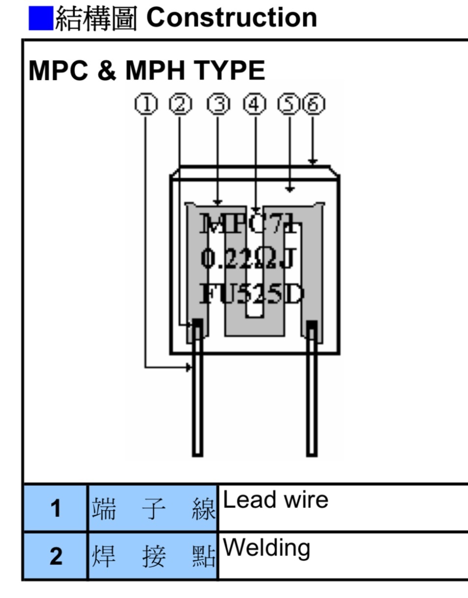

This resonable cost Futaba MPC74 from Japan are very interesting
resistor in audio path but some match is necessary:
NOVA Elektronik - Metallband-Resistors - MPC - Fukushima Futaba

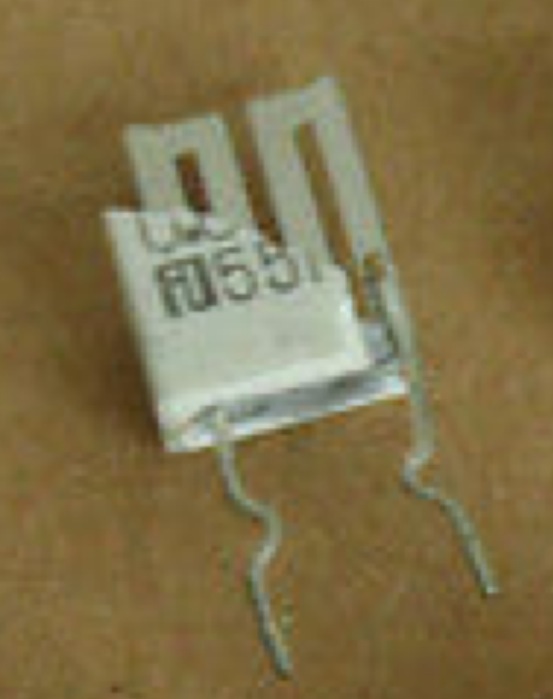

After more research i see what MPC inside and surprise
not real wire wound , not real z-foil but minimalism of metal band.
This Japan brand is not produced in Fukushima area
so resistors don't glows in the dark sadly 🙂
