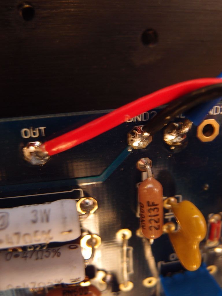

Aleph J illustrated build guide
A small sketch is better than a long speech:

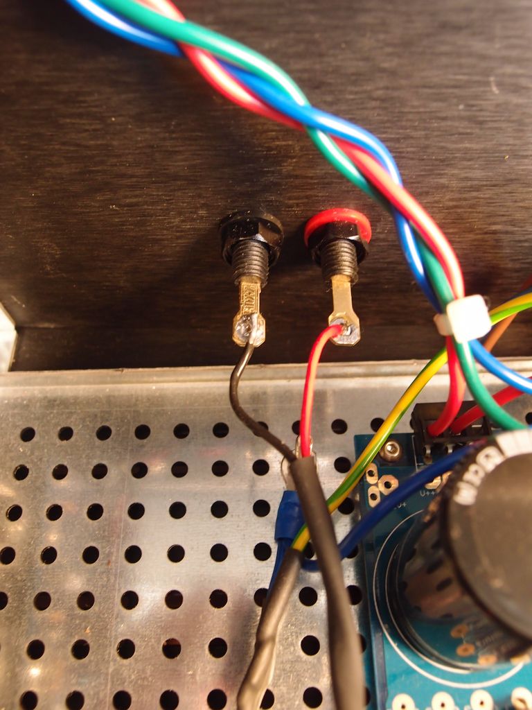

Outputs are easy to check:
Everything seems to be OK here.
Inputs are more tricky to follow:
Signal is wired with Cat5 cable (coloured for right channel, white for left), ground with black wire. Everything looks fine.

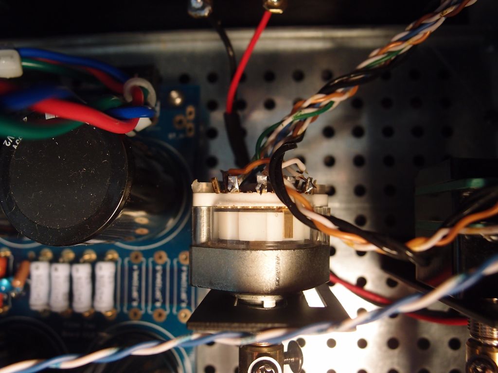

The signal cables go to the selector switch, the ground cables bypass it and go directly to the C terminal of the potentiometer, so there's no chance of inverting them here.

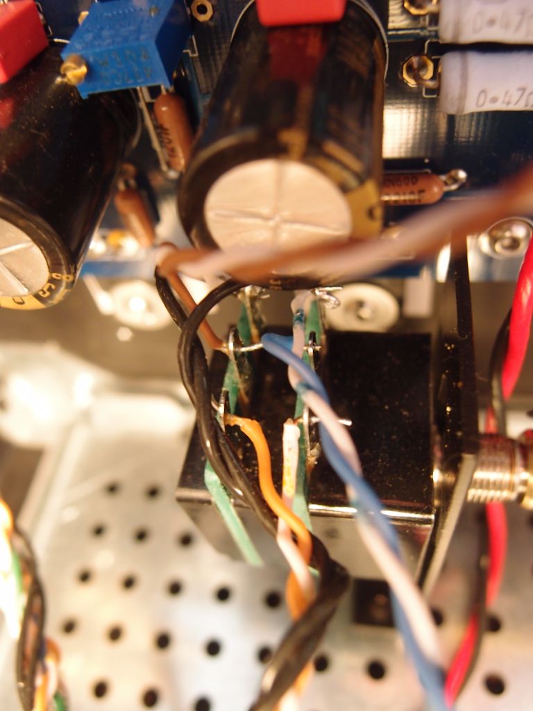

Then the signal goes from the selector to the input ("1" terminal) of the potentiometer (orange and white wires).

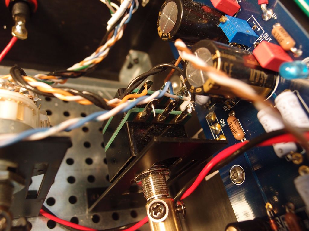

After that, the signal goes from the ouput of the pot ("2" terminal) to pcb's input (brown and blue wires).

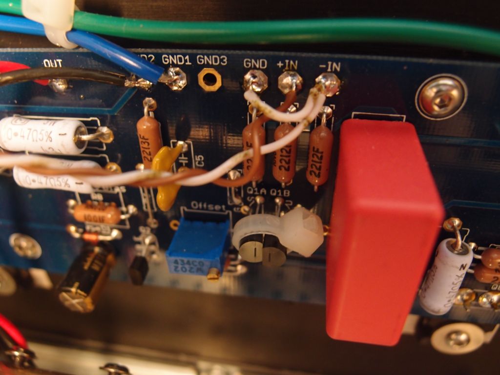

Do you see any mistake?
instead of wasting my old and tired eyes ....... why don't you just use continuity (beep!) function of your DMM ?
:clown:
in fact , last picture is everything what's needed ; neg. input is grounded ,so everything seems ok , at least regarding wiring
look further - interconnect used etc. ......
one thing I know for sure ........ when properly made , J is non inverting
😕 mine was inverting ... I just switched the output terminal wires to correct it.

I checked every input with a DMM; everything is OK from RCA to pcb's input. Every thing is OK from pcb's output to binding posts. Can't say waht happens between, but I don't know if there's a possibilty of mistakes in the PCB stuffing that invert phase.

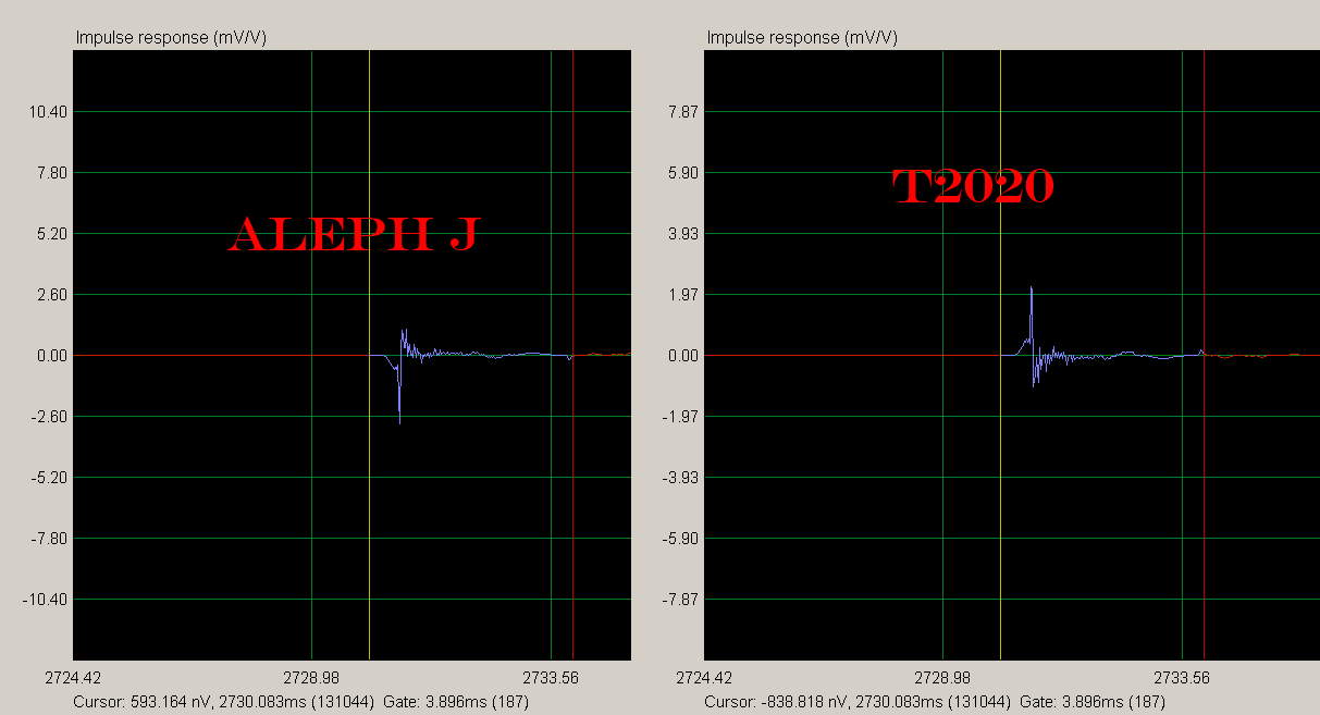

Well, the measurements was made with Arta on a laptop computer with external soundcard (Miditech Audiolink 2) and a Behringer ECM8000 microphone. The interconnect was a cheap one (checked with a DMM). When I saw the result, I checked with a Populse T2020 amplifier.
I'm quite sure Arta doesn't invert phase.😀 Maybe the soundcard does, but that means the Populse does it too 'cause phase is correct with Audiolink/T2020 combo. It's possible.

I made a new test a few minutes ago. I made new measurements without using my soundcard (I used de headphone output of the PC). Impulse is OK with the AlephJ and upside-down with the Populse.
Conclusion: it seems that both my soundcard and the Populse amp invert phase and I made no mistakes when building my Aleph.
(Unless the integrated chipset inverts 😱😀)
