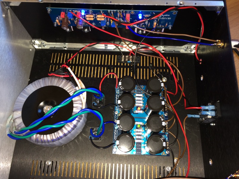

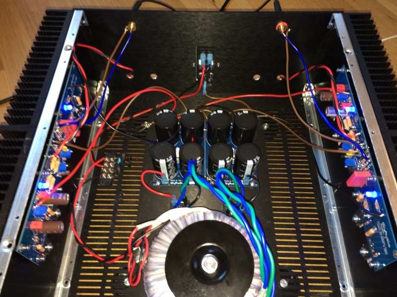

Enclosed are some pictures of the amp.
Wiring is not finalized, but I think you should be able to get the picture of how it's done.

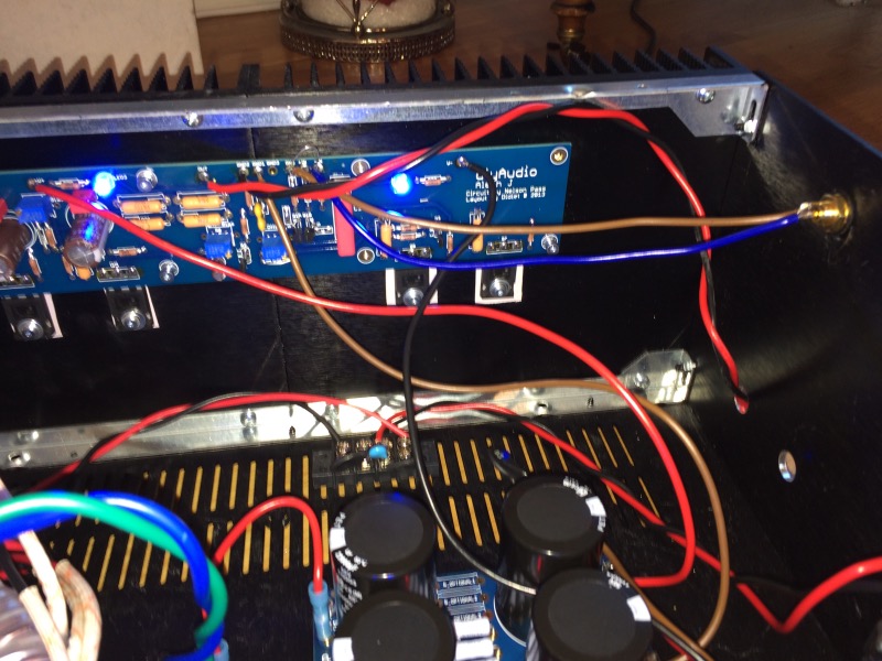

I have after pictures replaced input wires with a shielded ones.
My issue is equal hum in both channels. According to an RTA app. I have on the phone, the hum is at app. 90hz, but appears abit lower to me.

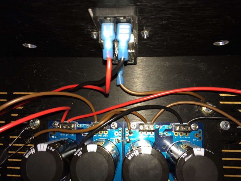

Hum decreased from being audible from 2-3 meters in quiet room, to about 0,5-7 meters after I separated safety ground and PSU ground, latter through CL-60.
Regarding RCA, center pin is wired to in +, outer pin/shield to ground, and ground shorted to in -.
PSU ground is soldered to ST_G2, GND2.2 and GND3.3 is solder together with pin, and GND1 and GND4 are jumpered with a pin.
Right channel GND is wired to PSU negative pcb/rail, and left channel to PSU positive pcb/rail.
Transformer is Antek AN5218.
Edit: Hum is with no source connected.
Any suggestions?

MARRA: Looking forward to it, knowledge you know 😉
6L6: The hum is almost the same with source connected, as it is with no source connected. A tad less on the latter.
When you say inputs shorted, do you mean closed loop, rca connector center pin to ground?
Stefan
When disconnecting left channel from psu, there is a slight hum with no souce connected, and no hum with source connected.
Re-connecting left channel and disconnecting right gives no hum with or without source connected.
Both channels have a hint of hiss, really not much, but I guess this is to be expected from a fullrange with no passive filter.
What do I do next to fight this?
Stefan
check that RCA jacks and all pcb points (ground?) are isolated from case
sole place where audio gnd can be connected to case is from PSU pcb via NTC to chassis
PSU wires to channel pcb - twist them or not , your choice
signal wires to pcbs - twist them tight and route either fully to sides or fully to mid of case
if noting else helps , make bridge between channel pcbs main gnd points , one fat wire ,direct from one side to other , shortest possible
Thank you Zen Mod for your assistance and advice, but I seem to be missing something.
Last nights test as per your instruction gave a result that to me pointed to the psu as being the culprit- psu ripple?
After doing some reading, I cannot see that this phenomenon, psu ripple, is related to grounding issue, as seems to be what your lates post implies, but then again I might be completely off.. 🙂
I would really appreciate if you or someone else would care to explain the mechanism behind the result I acheived last night, both if it seems related to psu or not.
Fyi, signal cable is shielded now, running comletely to the sides and top, and all pcb's are supported by brass standoffs. Only one audio gnd through CL-60.
Stefan

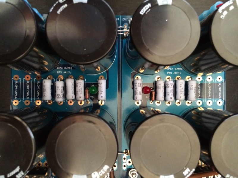

I have used the the UPS V3, and followed 6L6 excellent build guide, without the discrete diode bridge.
Caps are 22.000uf 50 volt Panasonics, R1-8 are 0,47 ohm 3 watts, bleeder 2.2kohm and led with a 3kohm resistor.

Are you certain the RCA connectors are not touching chassis? It's worth checking.
I also suggest taking an old Cat5 cable, and using 1 twisted pair inside for the signal wiring from RCAs to PCBs - keep it close to the chassis at all points.
