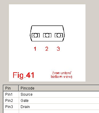

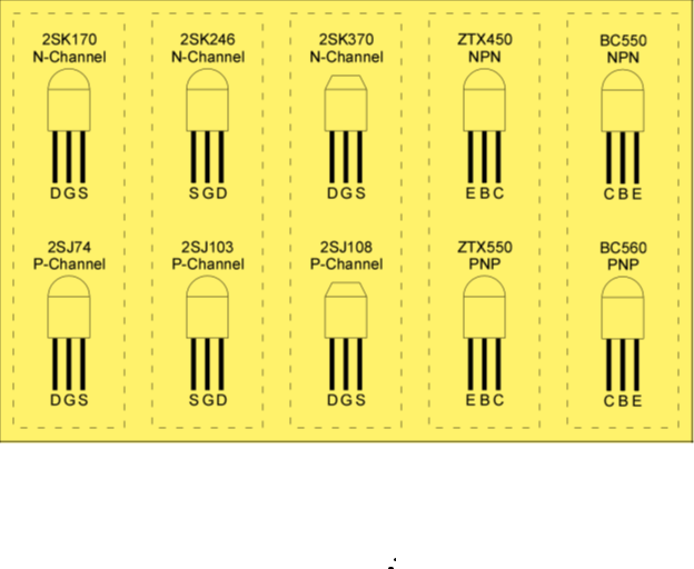

I feel like an idiot for this not being readily apparent to me, but looking at the datasheet for the 2SJ108 it isn't all that clear which pin is which.
I suppose the easiest way to ask this is, do the sides of the 2SJ108 with writing on them (the longer flat side) face towards or away from each other when placed in Q1A and Q1B?
(This would be easier if there was only 1 flat side!)
ZM you are an absolute champion. Thanks!
Lucky for me, it is the exact opposite of where I was leaning too. Never been so glad to ask a stupid question in my life 😀
Out of curiosity, how can you tell from that drawing which is the front, and which is the back ?
This may be help you ...
I've had the same issue before...took me awhile to realize some of these pics are like a X-ray view from above, not looking up at the pins. You really don't want to fry those rare fets! BTW, post 1175 is a bottom view...
