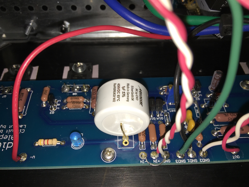

Question: is it OK to replace C1 in the Aleph with a jumper, considering the fact that the pre amp always has a cap in its output?

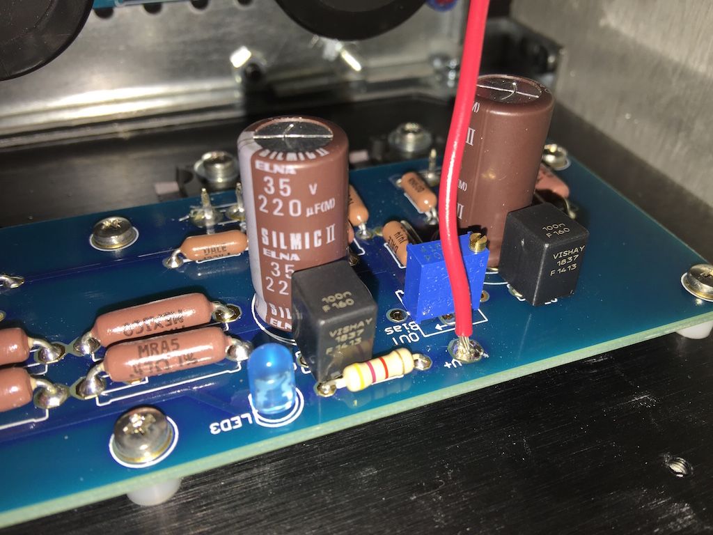

Nice choices. I have the Mundorf caps like that, but only the Aluminum in Oil ones. I found some polycarbonate bypass caps that barely fit next to the higher voltage Silmic II caps that I had in my junk box. The ones you chose would not have made it on my board, not without replacing the Silmics II with smaller voltage ones.

So initial impressions:
1. The first 5 minutes were torture ... this is with a cold Aleph J and new caps ... 🙁
2. Bass - my room is 11' x 14' and I listen on the short distance with Cornwalls stuffed into the corners at a 45. With my RH84SE, I had bass resonance in the room. The Aleph J took those away but gave me more detail and imaging in the bass. The new caps kept the imaging and accuracy but now my room resonances are back. I am thinking of getting some Auralex Grammas for the speakers next.
3. Midrange - hard to describe ... with the RH84SE, instruments had good detail and imaging but sounded just on the other side of the far wall of the room. The Aleph J brought the instruments into the same room as me from an imaging perspective. The new caps added a new level of detail. For example, the resonances on a wood bodied instrument existed before but were very muted but now those sounds exist in the same location and plane as the fundamental instrument sounds. More realistic.
4. Highs - NIGHT AND DAY! I use "Canon in D" from "Percussion Fantasia" as my reference here and I can FINALLY hear the mallet impact on the xylophones! I could hear the notes before but now I can hear the actual impact like I did on the RH84SE. Imaging is also much better with the new caps. Before highs were in a general area, now the instrument can be pin-pointed.
I can breathe a sigh of relief now as I was a little hesitant about the sound of the Aleph J after spending all that time and money building it. The highs were eating away at me. No more! I imagine they will only improve as the new caps break in.
So for anyone getting ready to build the J, do yourself a favor and do NOT put the WIMA caps in there! Get a good quality film & foil for C1 and I highly recommend the Vishay MKP1837 to bypass the Silmic II's. But don't take my word for it ... go read the Cap Shootout from Humble Homemade HiFi ... I will say I concur with his findings on these particular caps.
One more thing to note before I go is I use several reference tracks on a CD that I typically get to the "good part" and then skip to the next track. With this new combination, I found myself listening to the entire track. Two of the tracks in particular I never listened to the whole thing before until now. 😀
Keep the cap.
That is what I am thinking ... when I first built the amp, I liked the sound but was not a fan of the muted highs. After replacing the WIMA with the Mundorf Gold EVO and allowing many hours of burn-in, I think I can now say this is my favorite amp to date! So much so that I am now going to go ahead and sell my prior "reference" amp ... my beloved RH84SE.
The highs have no far exceeded my expectation with the cap in place.
