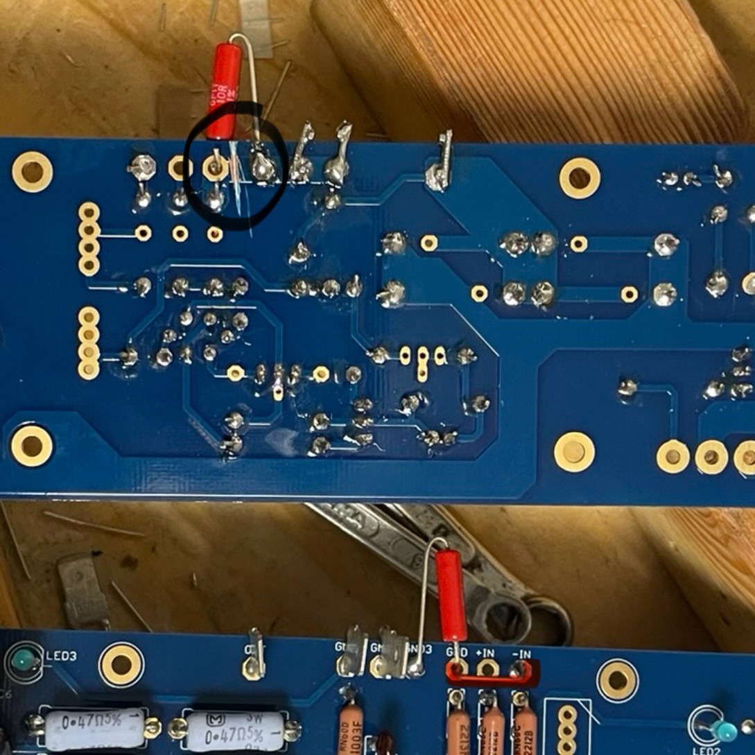

The tweak with jumper in place:
10ohm and a cut trace

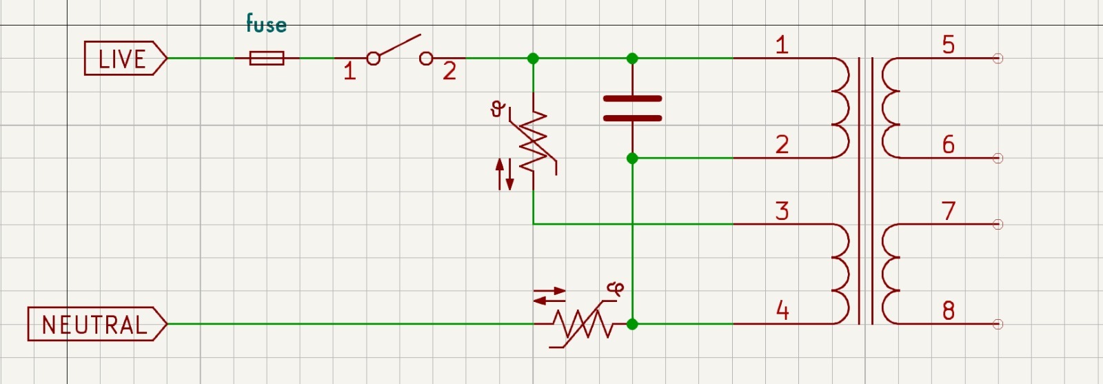

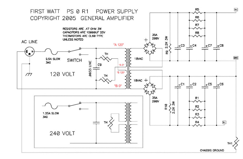

I found a (perhaps the) mistake I made... I had mixed the transformer primary wires. I was wiring it like this:
After swapping 1 and 3, the buzz coming from the transformer is significantly reduced. The buzz coming out from the speaker also greatly reduced...

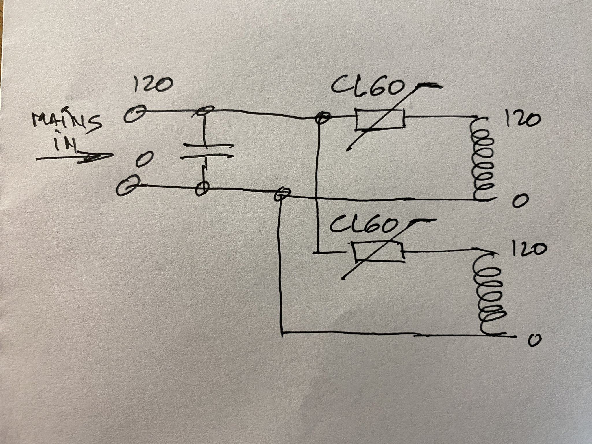

I happened upon freejazz00's posts while I was looking for ideas to try. I wonder if he had the same issue. The thermistors would definitely get hot.
My wiring definitely still needs to be redone and will try the hum breaker as well. I also have rectifier snubber boards from ThatcherDIYAudio I can try.

"There is no buzz if no amp boards are attached. It buzzes with one amp board is powered. It buzzes more when both channels are powered. So it seems to increase by load to the power supply. This is with no speakers attached! " ... so it ain't DC-on-mains issue

It seems that you have possible oscillations that might be causing excessive power drain from the toroids... measure the voltage drops across the PS PCB CRC... across Rs, and see what you have there. Then compare to see if the voltage drop across those resistors is the sum of the quiescent current from both AMP PCBs. Or, put an oscilloscope on V + and V - OUT, and check...

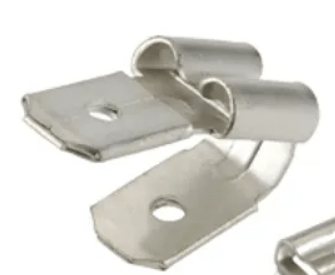

The best place for the snubber is as close as possible to the secondary wiring.... hence, you could install the snubbers on the bridge rectifiers... just use dual lugs and re-crimp... or use something like this:

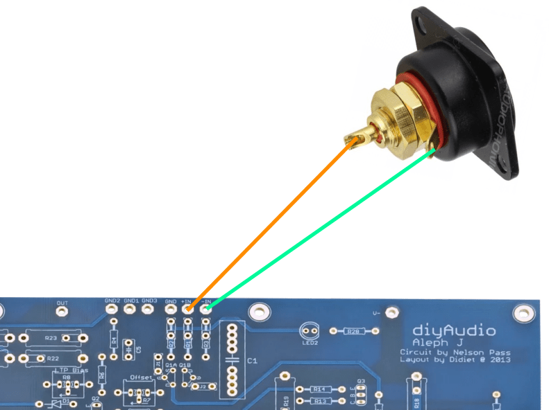

The fact that your speakers are buzzing as well tells me that you need an AMP PCB ground lift mod. Do you really need to keep RCA INs?
