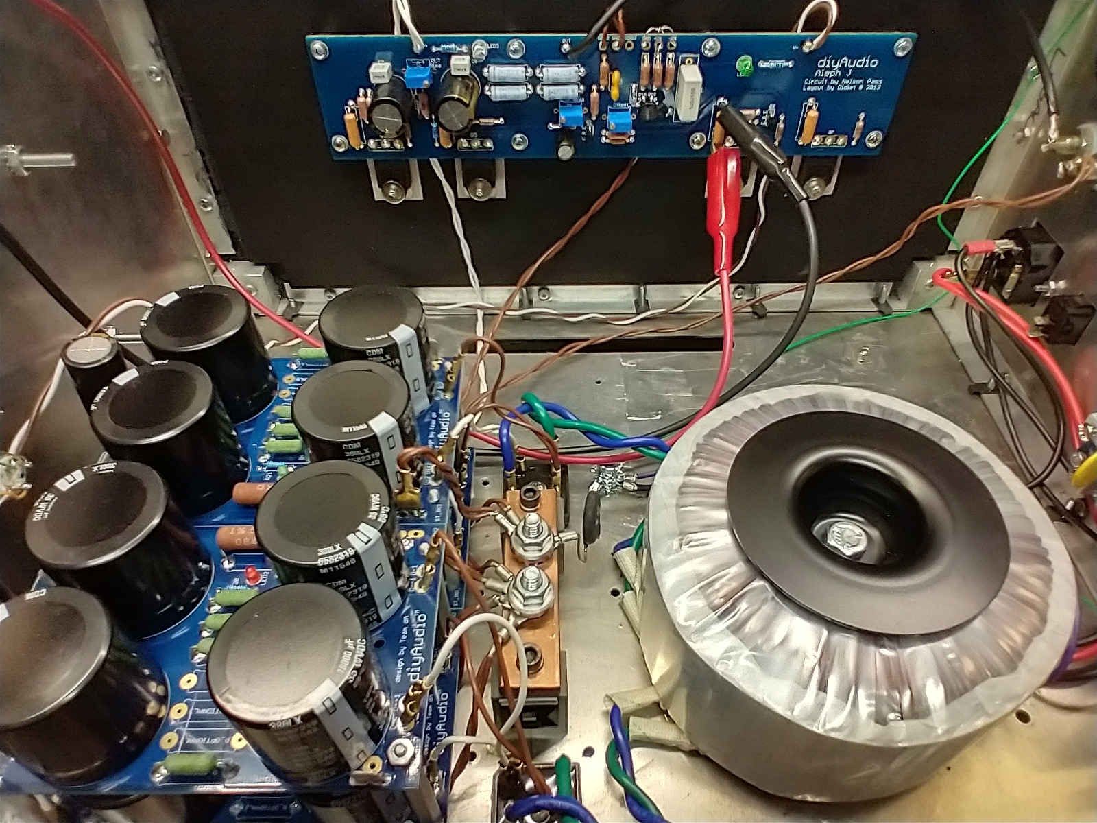

Did a bit more testing. Following the "build guide", I tried to adjusted R27 BIAS first, but it doesn't move from about 600mV. I also checked orientation and type of Q2 (BC560C) and Q3,Q4 (BC550C). These were new devices. It seems suspicious that the problem is the same on both channels (bias not adjusting) but the left is a bit lower at 460mV. Picture of chassis attached.
Working! Didn't have jumper R27 in place. After installing, let it warm up for 20 minutes or so, then was able to get bias in range. All good.

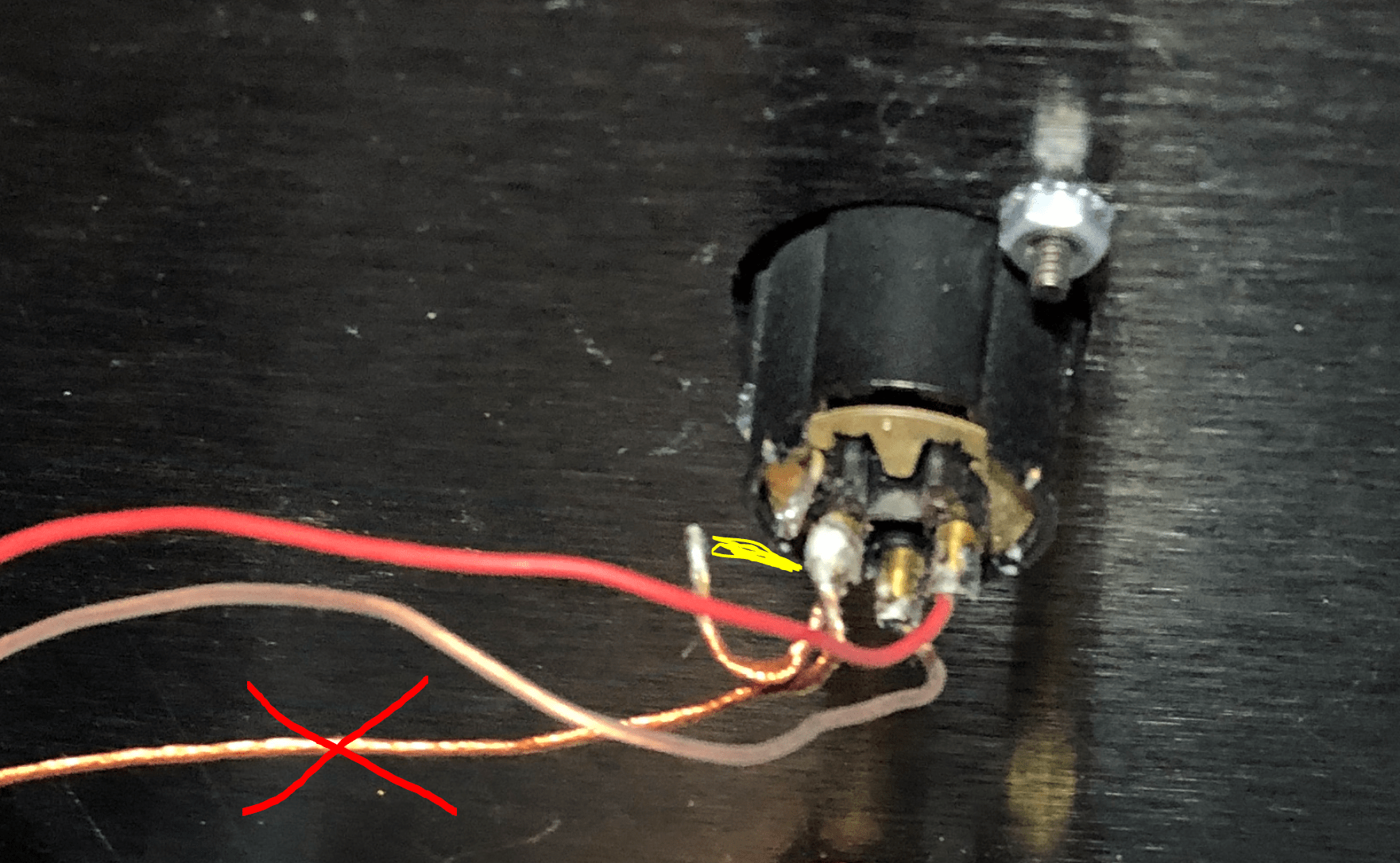

I am about to wire mine and I am still a bit undecided as to which way to wire it.Alternate Input Wiring for Reduced Hum and Noise
When I finished by Aleph J back in May, I intended to use it only in single-ended mode so I wired it according to the build guide. While I achieved 70-80 microVolts of hum/noise with inputs shorted, I had 100-200 microVolts when connected to my B1, B1 Korg preamps or directly to my Bel Canto DAC3. Not terrible, but not within factory spec of the commercial version. After some though, I decided to wire it up the inputs as balanced and found mbrenna's post, #4971, where he referenced a great document by Rane Commercial about grounding protocol.
So, following mbrenna's and Rane's recommendation, I came to the following wiring scheme which gave me 70-80 microVolts of hum/noise with inputs shorted and with preamps/DACs connected:
Key is to run a twisted pair of the plus and minus signal to the inputs and ground the XLR ground or single ended ground at the cable entrance. See the Rane document for more info. Now I have a very quiet amp and did not have to resort to cutting traces as some have done to reduce hum.
In your example, XLR pin 1 is attached earth/chassis which is consistent with the Rane document. What is the rationale for connecting the unbalanced ground to earth/chassis? The Rane document seems to suggest otherwise (output configuration 17), but I may not be interpreting this correctly...
Thoughts/opinions?
Thoughts/opinions?
You are interpreting it perfectly...
Rane's implementation/suggestion applies to XLR input, and assumes a few things (that exist only in professional audio gear... or FW Clone builds that are being converted as per below):
- Rane's implementation can be tried (and will work well) only if used on the XLR input - the RCA and its associated connecting wiring to the XLR connector, should be removed (they can stay, but it is not easy to make it work correctly from the noise coupling point of view, as Rane intended)
- The NTC between PS PCB common, and the chassis will have to be removed (replaced with a short thick wire)
- The back panel, mains earth, amplifier chassis and the PS PCB & AMP PCB common, have to reside at the same RF / HF potential. Long earth wires, long (and thin) NTC wires, NTC in itself... are a no-no...
- The XLR pin 1 (shield coming from the source) should be dumped to the amplifier chassis potential (to the XLR connector shell lug) only via a very short wire as shown below in yellow (the black paint should be scraped away, to ensure the XLR shell makes good RF / HF contact with the back panel - with the rest of the amplifier chassis)
