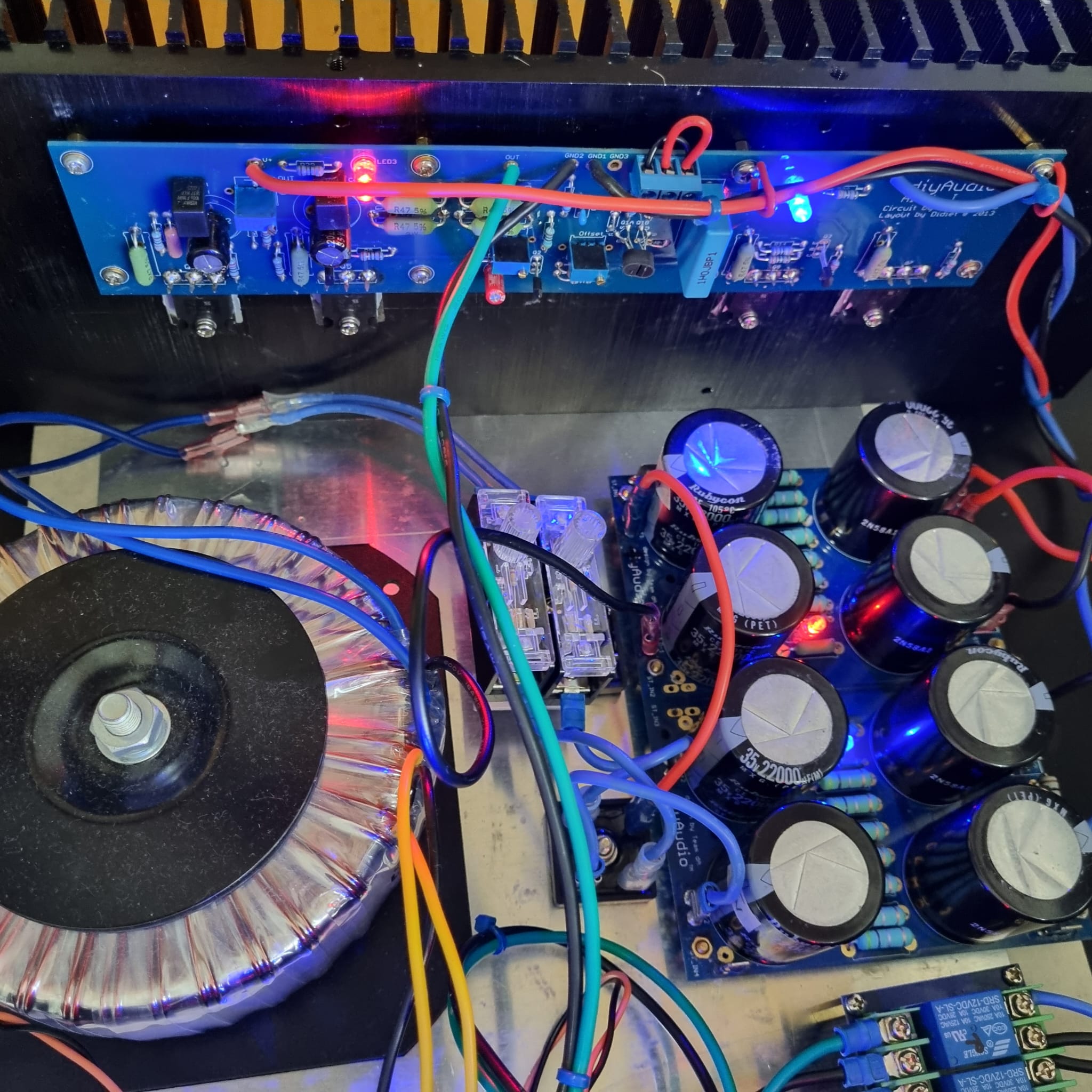

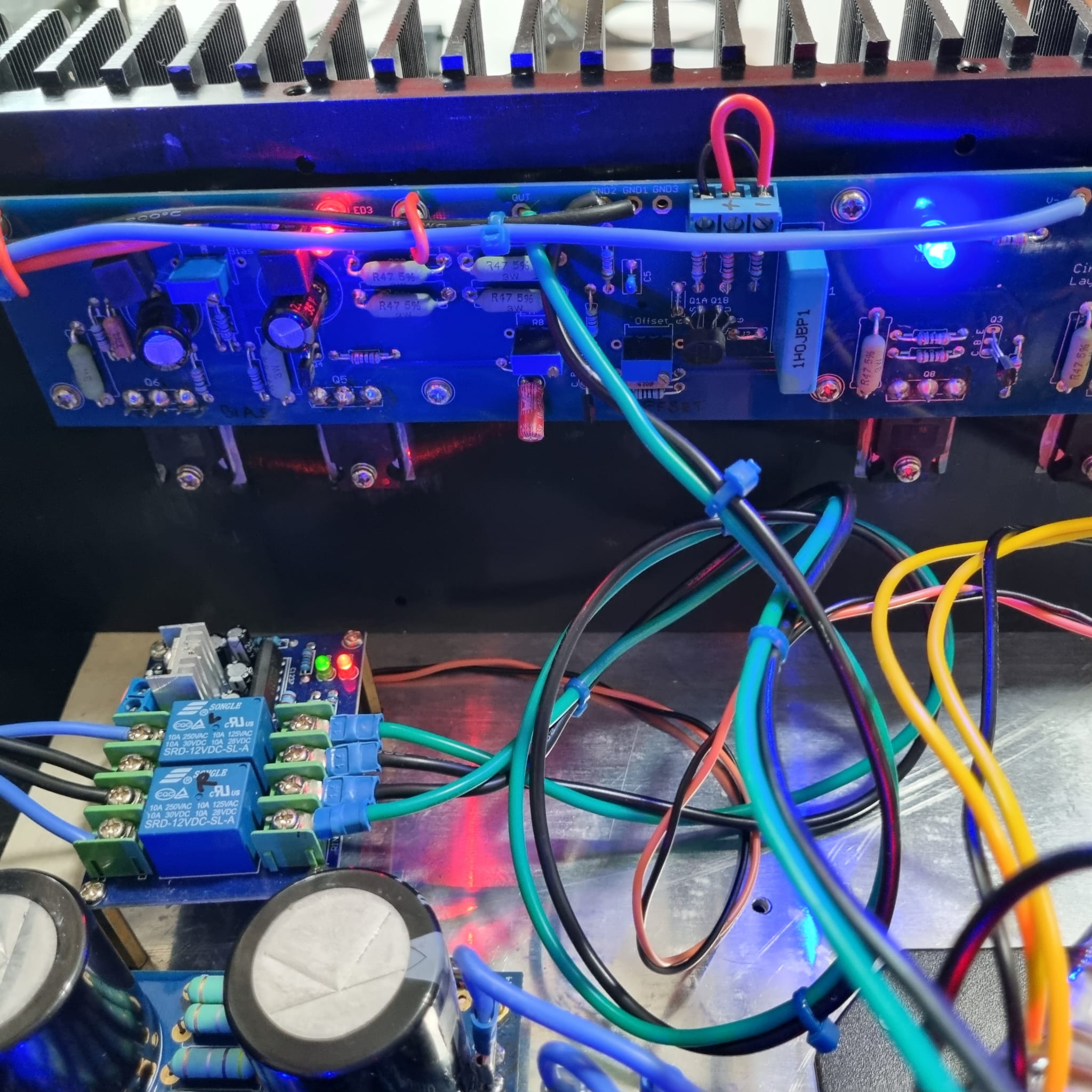

I did short the inputs and measured on no load. O/p bias was set at 350 mv and off set at 0 mv (though it kept moving up and down for both channels by about 1 mv). Left channel rusn hotter by about 2-3 C, Q8 of left being the hottest at 49 C. Here are some pics if that helps.pics?
triple check that you have equally set Iq and output DC Offset on both channels
while doing that, inputs shorted to GND, no load at output
That's a fairly small case for Aleph J, so high running temps are expected. What will hurt even more than heat is an inability to set the appropriate bias (around 400mV minimum)... because you won't be able to dissipate the resulting heat. Furthermore, the bottom plate is not perforated, so you can expect quite a high internal temperature.
If you want to short the input, you should short differential input -IN and +IN separately to ground...
I think your build is fine; you just need a larger case and a perforated bottom plate...
so, you're good
there is no (neither significant nor practical) difference in temperature between channels

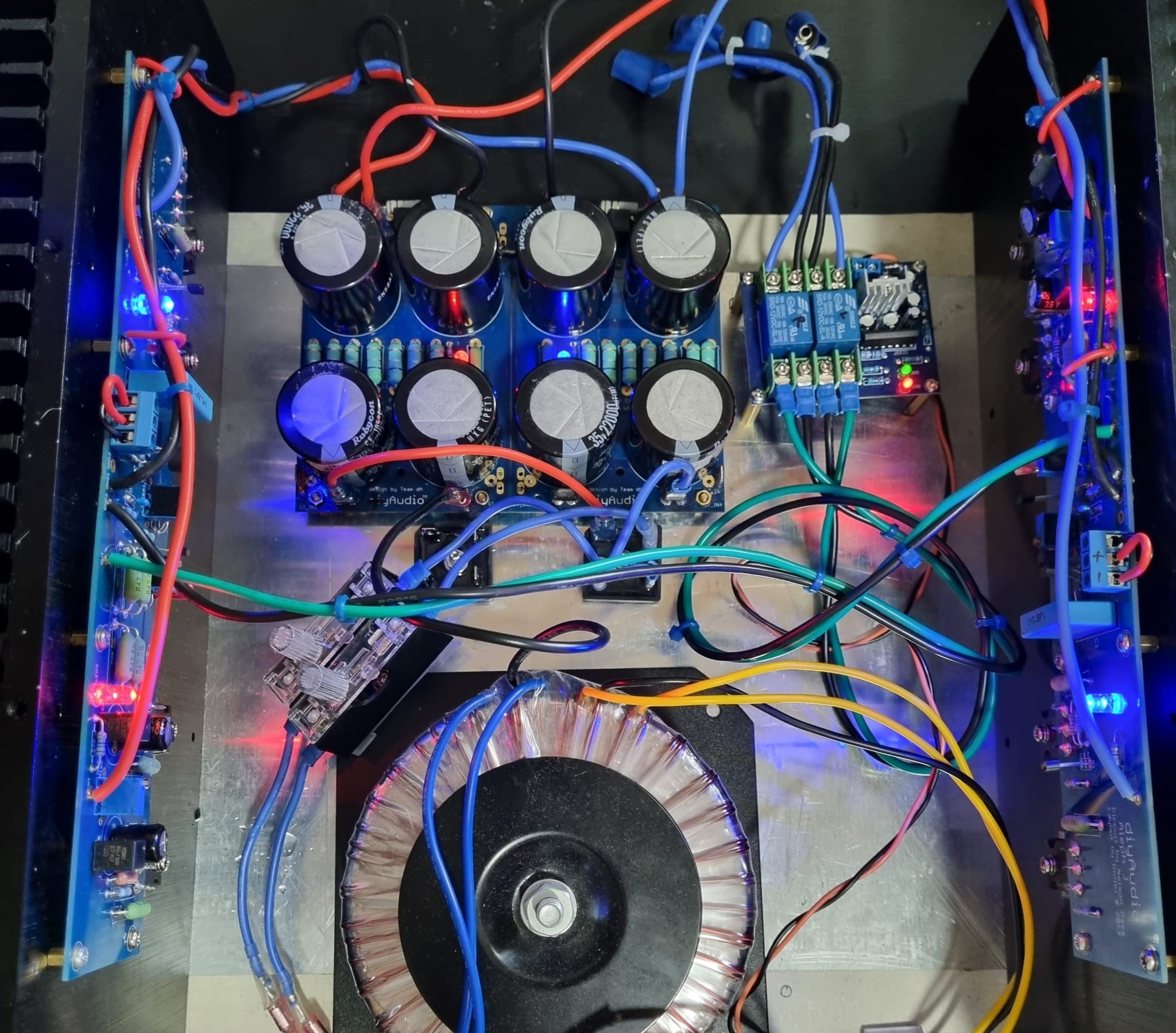

Hello There, Thank for your reply. Actually its not in the case yet - its a 1 mm plate that I use for pre-assembly and testing before transferring to case. My case is 430x150x415 mm with perforated like you suggested. And heatsink is 50x150x400 mm (approx. 2x6x16 inches) I am hoping its adequate as the temp is holding at room temp in tropics. Noted about the input short - Thank you.That's a fairly small case for Aleph J, so high running temps are expected. What will hurt even more than heat is an inability to set the appropriate bias (around 400mV minimum)... because you won't be able to dissipate the resulting heat. Furthermore, the bottom plate is not perforated, so you can expect quite a high internal temperature.

Follow up question, if I may - the idle current draw in is about 1.49A. I am using a 10 A CT transformer and the voltage drops from about 26V DC to 23V on load of 1.49A. Is this normal? For testing bench, its 16AWG all around.
Are you gonna be using a single transformer for both channels? If yes, then the total power consumption is 3A with 350mV bias. Also, keep in mind that with 350mV bias the distortions might be a touch too much... see the first and second posts. The widely adopted bias setting is 400mV... you may like even higher bias, maybe 440mV...?
I expected to see a slightly thicker secondary wire. Aleph J burns around 150 - 200VA, so if you apply a safety margin that most DIY-ers do (x 2), you'll arrive at a 400VA transformer. This will ensure a stable operation (no transformer overheating) even with the bias set at above 400mV.
With all that being said... there's nothing stopping you from using whatever transformer you have at hand.... see how that goes. And see if the transformer runs too hot... then you can simply get a 400VA transformer at a later stage.
I have a 400VA 2 x 20V secondary transformer that gives me plus and minus 24-25 V DC rails with 440mV bias.
If I were to build another Aleh J, I'd go with a single transformer, but separate windings for each channel, with 2 PS PCBs; one for each channel.
Thanks again. Yes, I intend to use a single transformer for both channels. I have a CT 18-0-18 10A and a Dual 18-0, 18-0, 6.3A - latter is much smaller and I was hoping to use that as I read in many forums about dual rectifier being better than a single on a CT. I see from your suggestion to stay higher. What was perplexing me is whether 3V drop is expected with a 4A load on 10A winding - I infer from your post that voltage drop is inevitable (20V X 1.414 = 28V DC, but you are getting about 25V) .
