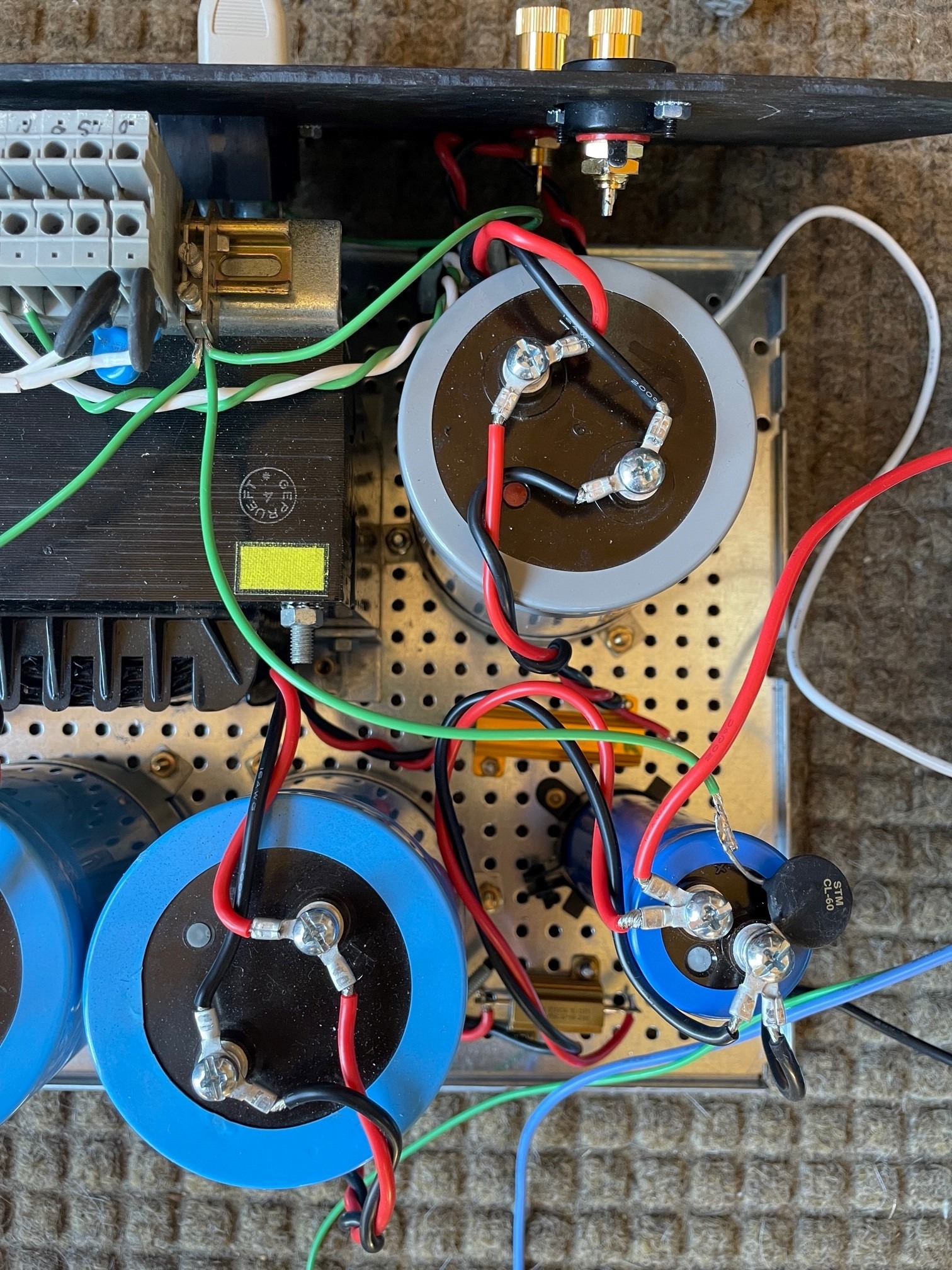

though, I can't say did you wire it properly, to have least amount of hum and ripple
what I can see on that picture, that's most likely very far from optimal wiring
though - that is separate issue per se, first you need to solve what's wrong with setting of amp
you have DVM, confirm rails voltage

Rails voltage 26.1 both channels. This power supply was used in my ACA dual parallel amp and despite the sub-optimal wiring produced no hum, equally quiet to ACA stereo w/ 2 bricks. Only change made to this supply since the last dual parallel amp was to increase one of the power resistors from 0R5 to R1, which dropped the rails by 3V.

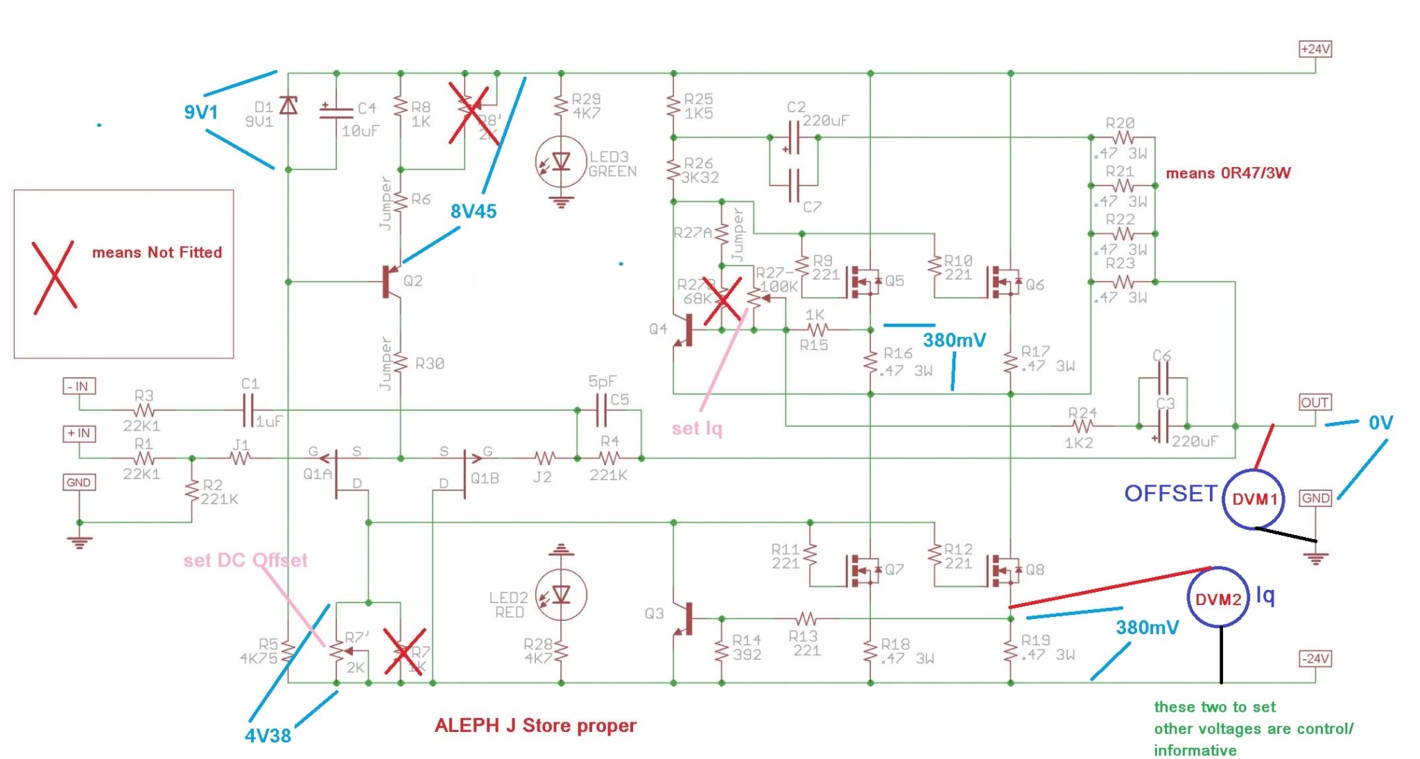

Your diagnostic mind hard at work! Results: (L) = left channel (R) = right channel
Zener (L) 9V06 (R) 8V99
Q2/R6 to R29 (L) 8V49 (R) 19V24 I am going to guess this is the telltale to our offset problem
R16 (L) 402mV (R) 400mV Bias holds well, I set yesterday at full temp at this level, same values just now
Offset (L) 4V76 (R) 4V76 I had set R7 at R1k. Turning pot counterclockwise yields fast high voltages, other way increasing resistance has little effect
R19 (L) 407mV (R) 400mV
R7 (L) 4V75 (R) 4V72
What say you Mighty?

L channel everything sounds OK, except output offset, and that's enough of wrong; I don't know what can be wrong if everything is done by, say, schematic I edited
R channel - 19V24 across 1K (R8) means something fishy with with Q2,
I can't think of nothing else than - replace all small bjt transistors, taking care of their pinout , and try again
btw. I don't care for set value of R7; I care for offset and Iq, I don't care too much what ohmmeter is saying for trimpots
nor I care too much for trimpt CW or CCW , I can't remember that even for my own pcbs; I'm simply looking at DMM to see am I turning it in proper direction
you have some systematic error common for both channels; again, I can only suspect that's issue with small bjts - maybe you did damage while soldering

Would it be of value to measure 27.5v output from last PS cap to ground both + and - side of the cap? I wonder if my PS is causing the offset imbalance, as the power resistors reside only between the positive poles of
the cap cans.
the cap cans.
well, I hope you have positive rail, GND, and negative rail - all 3 connected to amp pcbs
and that rails are of same value, ref. to GND
I mean - that's the very start to make an amp
I do have all 3 wires connected to amp pcbs.well, I hope you have positive rail, GND, and negative rail - all 3 connected to amp pcbs

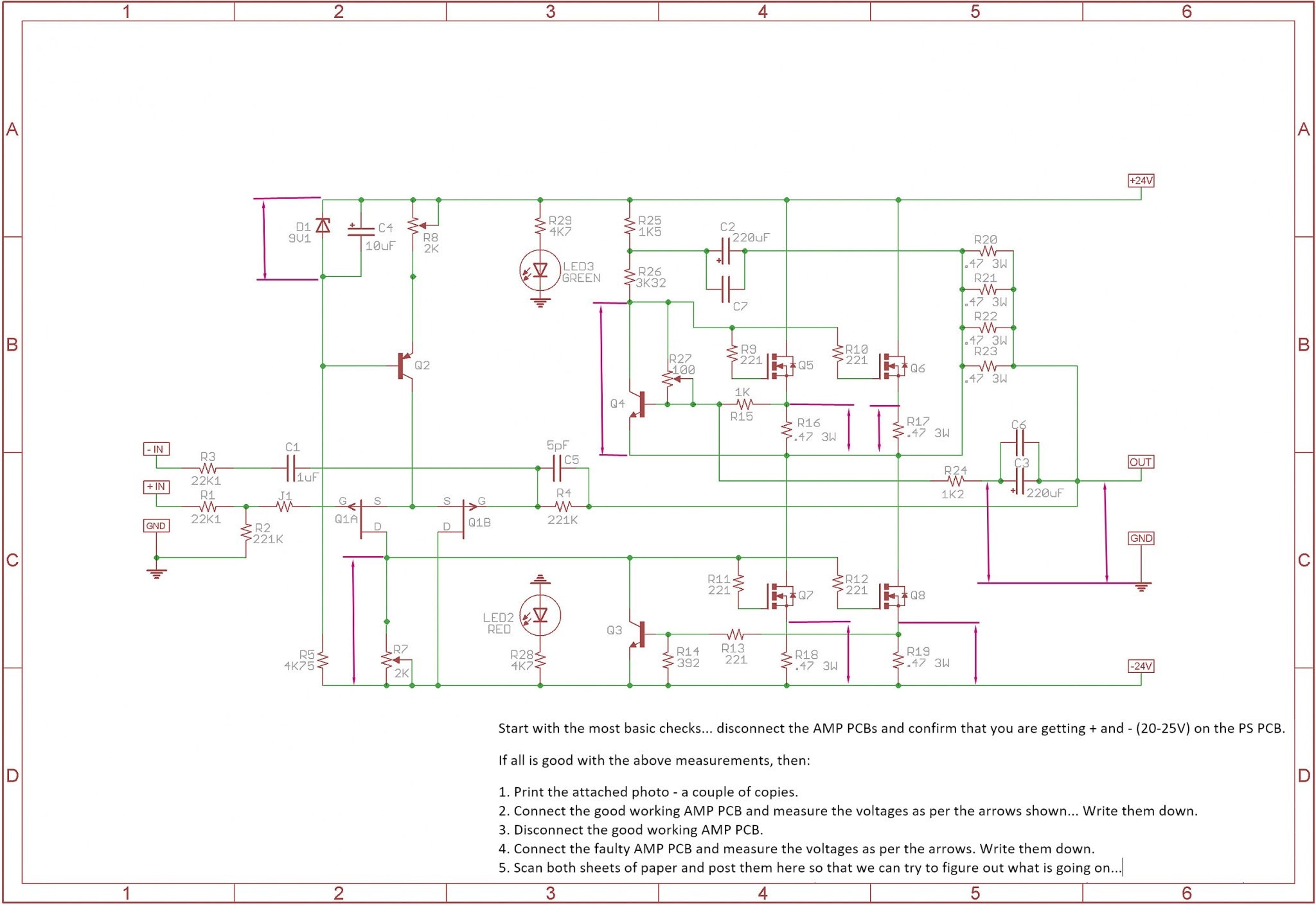

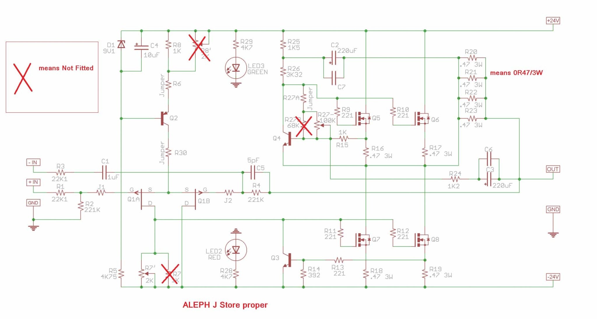

This will make life easier (I also removed the resistors connected in parallel with the trim pots 🙂):
... fill in the voltage readings.... so that we can have a full picture; it'll help diagnose the problem.

(L) Last + side of PS cap to GND = 27V26, - side = -99.8mV (R) Last + side of PS cap to GND = 27V38, - side -99.8mV
@Extreme_Boky thank you for your QA chart. Comparing it to @Zen Mod post #9468 jpeg above, you have in addition R24 to GND and measuring across Q4. I will do that and come back to you.
It seems your negative rail is only about -0.1V. What's going on here?(L) Last + side of PS cap to GND = 27V26, - side = -99.8mV (R) Last + side of PS cap to GND = 27V38, - side -99.8mV
I think you should disconnect the amp boards and make sure you can get symmetric rails before continuing.
