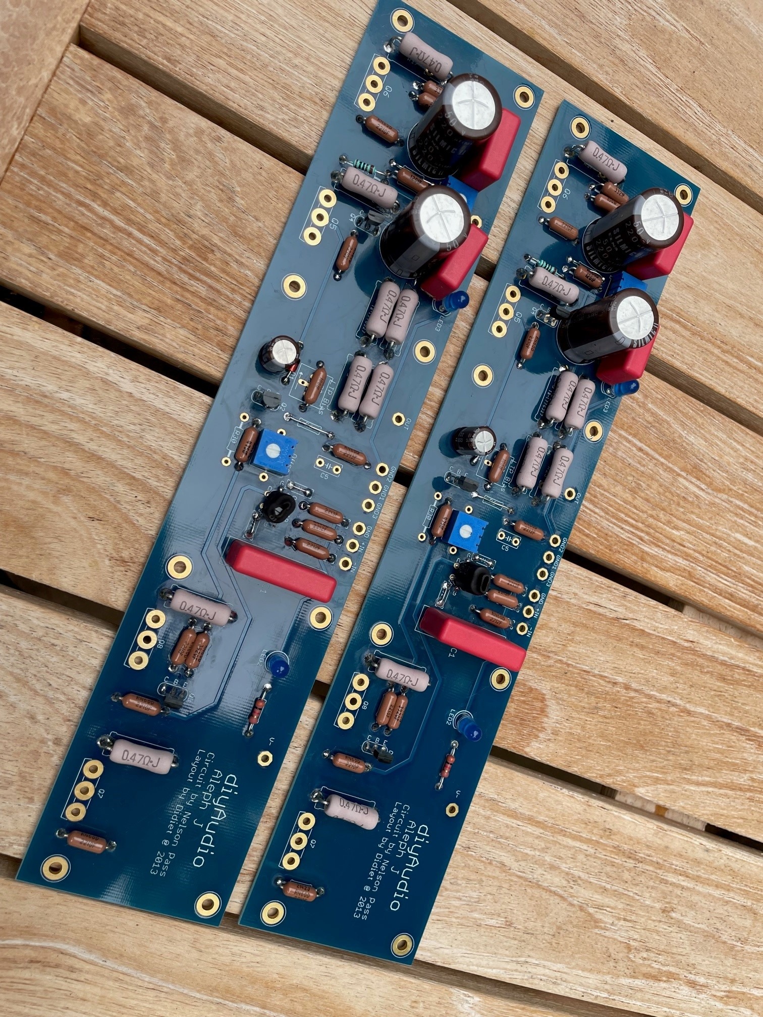

First attempt at an Aleph J. Boards complete with the exception of 7pf silver mica C5 and 200R for R30. Toshiba's from Punkydawgs and employed 50V electrolytic capacitors having read tons here and the ubiquitous raving expecting long term play. Plan to drop these into the 4U chassis with upgraded heat sinks in place of the dual mono parallel ACA boards currently residing. Last two components due in mid week along with nice input hookup solid core wire.
Early morning plein aire soldering session followed by flux cleaning. With Gratitude to you all.
Grazie. Isopropyl alcohol 99, soft bristle toothbrush, swabs, and an old linen serviette also known as napkin.
