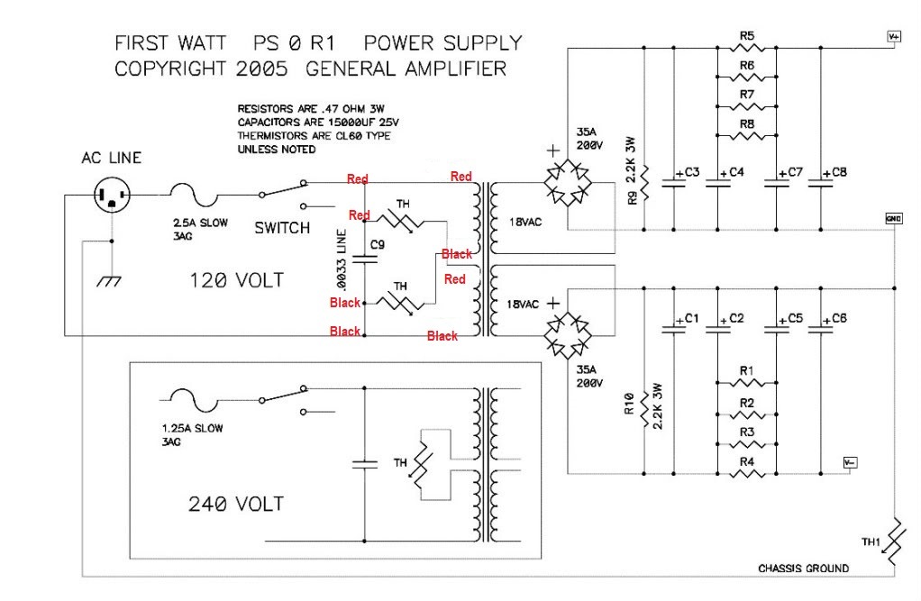

I noticed only two thermistors at the transformer primaries. Since it is dual mono, each transformer should have its own set of thermistors. Each transformer should also have its own fuse. So AC power into chassis, then one fuse to each channel's power transformer, then each channel's transformer has their own two thermistors. The only thing shared by the two channels is the AC power into the chassis and switch. Some people have even provided a switch to each channel.
It is then best to work on one channel and get that working. Connect the AC in, fuse, thermistors, transformer primaries. and bridge rectifiers . Double and even triple check all connections. If you have a variac or dim bulb tester, use that for the first power up. Connect your meter, or if you have two meters, connect them to the DC plus and minus of the two bridge rectifiers and measure the voltage. If everything is connected properly, the voltage should be somewhere around 25V when fully powered up. If no DC voltage is measured, then there is something not correctly wired.
Power supply schematic attached. Antek transformer primary winding colours added.
Connect the power supply board only after the correct DC voltage is at the two bridge rectifiers.
