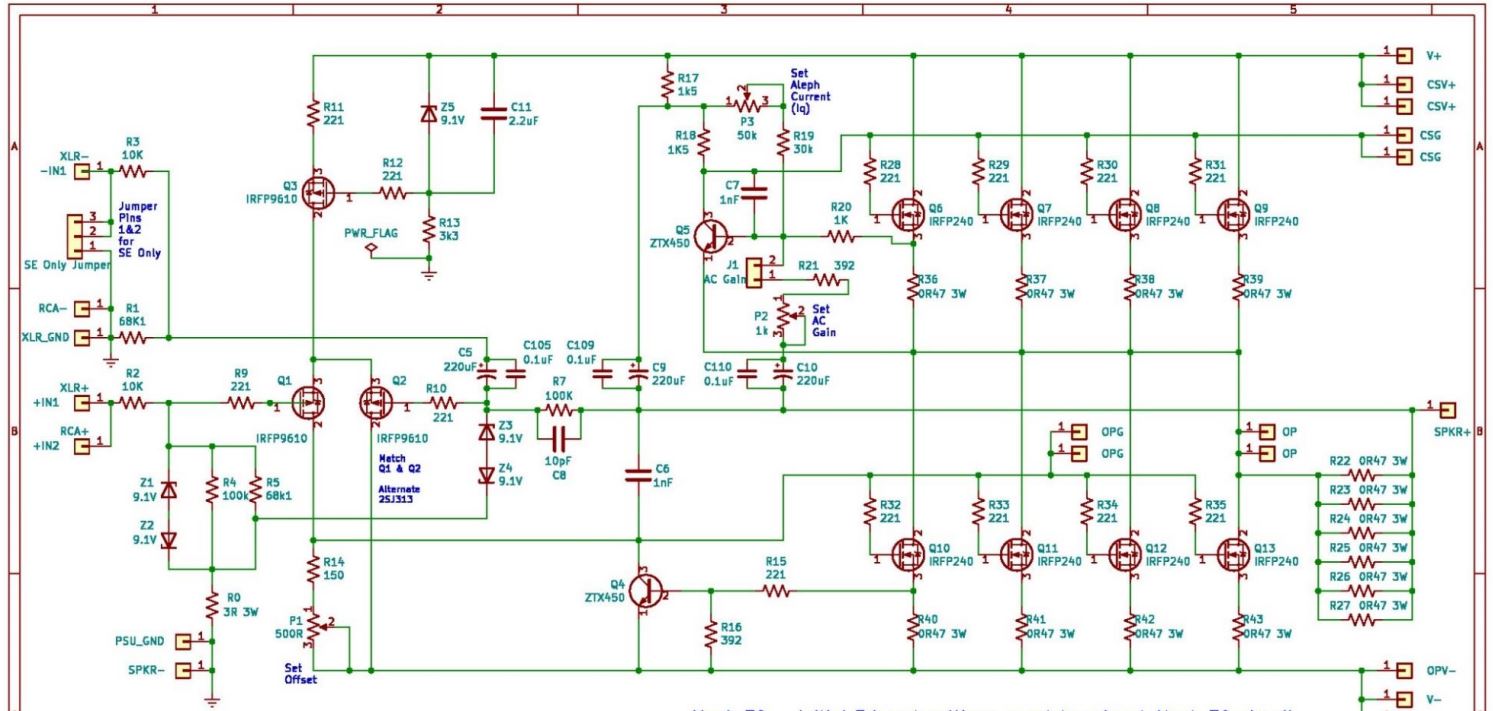

^ Dang... I may have just had something sink in re: RC filters. I had no idea their importance in that location. I've never had a perceived lack of bass response in any of the Alephs, but I may try that mod in the Aleph J myself. Easy enough. Will try to learn re: "phase twist" too.
For my own goofy brain... looking at other Aleph schematics, are the relevant parts R1 and C5 (bypassed with C105) in the schematic attached? I ignored the MOSFET vs. JFET input stage etc,.
Would the F in this case be ~0.01 Hz?
R 68K1
C 220.1uF
H 0.001Hz
Am I on the right track?
Thank you! :worship:
Edited - What's a 0 after the decimal between friends.... :joker:

increase that to 4u7-10uF, or simply short it
there is your bass missing
F=1/(2*Pi*R*C)
R 22K
C 1uF
F 7.2Hz
means that you have phase twist well above 20Hz
Jumpered C1 and now the offset will not behave. Offset and bias do what you'd expect until I hit about 90V a/c on the mains. After that the offset jumps to 20V and bias drops to 0V. Any thoughts?
Couldn't find anything in this thread about phase twist. Can you explain or point me in the direction of some light reading?
I placed a 10uF in there but Q3 was already toast. The offset started climbing as soon the variac was powered on.
there was some other problem, no doubt
I was routinely doing my iterations of Aleph J (Babelfishes known around) without cap in that position and even turn on/off thumps were mild, while no smidge of problem with DC Offset
No doubt there's another issue. The other channel dialed in with no problem. Offset fluctuates by 1mV but it has always done that. Q3 was fine, it just measured a little different that a new one but still within spec.

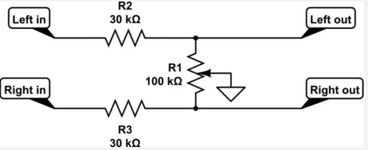

XLR in, or RCA?
The crude way would be to just place the pot across the left and right channels... this should work
The better way (if you do not need the full attention of R or L channels(, is to place the 2 resistors in series with the pot... this way you won't be shorting the hots to ground... Note: make sure that the ground point for the wiper is the GND eyelet on the AMP PCB !
The best way to do it is at the input of a buffer... Here, you could get creative... adjust the volume only for R and L independently... no need for two potentiometers 🙂 , i.e. no need for a separate balance pot...
.. or, adjust the negative feedback only, for L and for R, only as much to -> meet your needs... and not more than that..
Adjusting the volume for L and R channels independently would do the trick nicely... you could use a ladder-stepped attenuator switch... maybe only 6 steps??? -> they work nicely.
