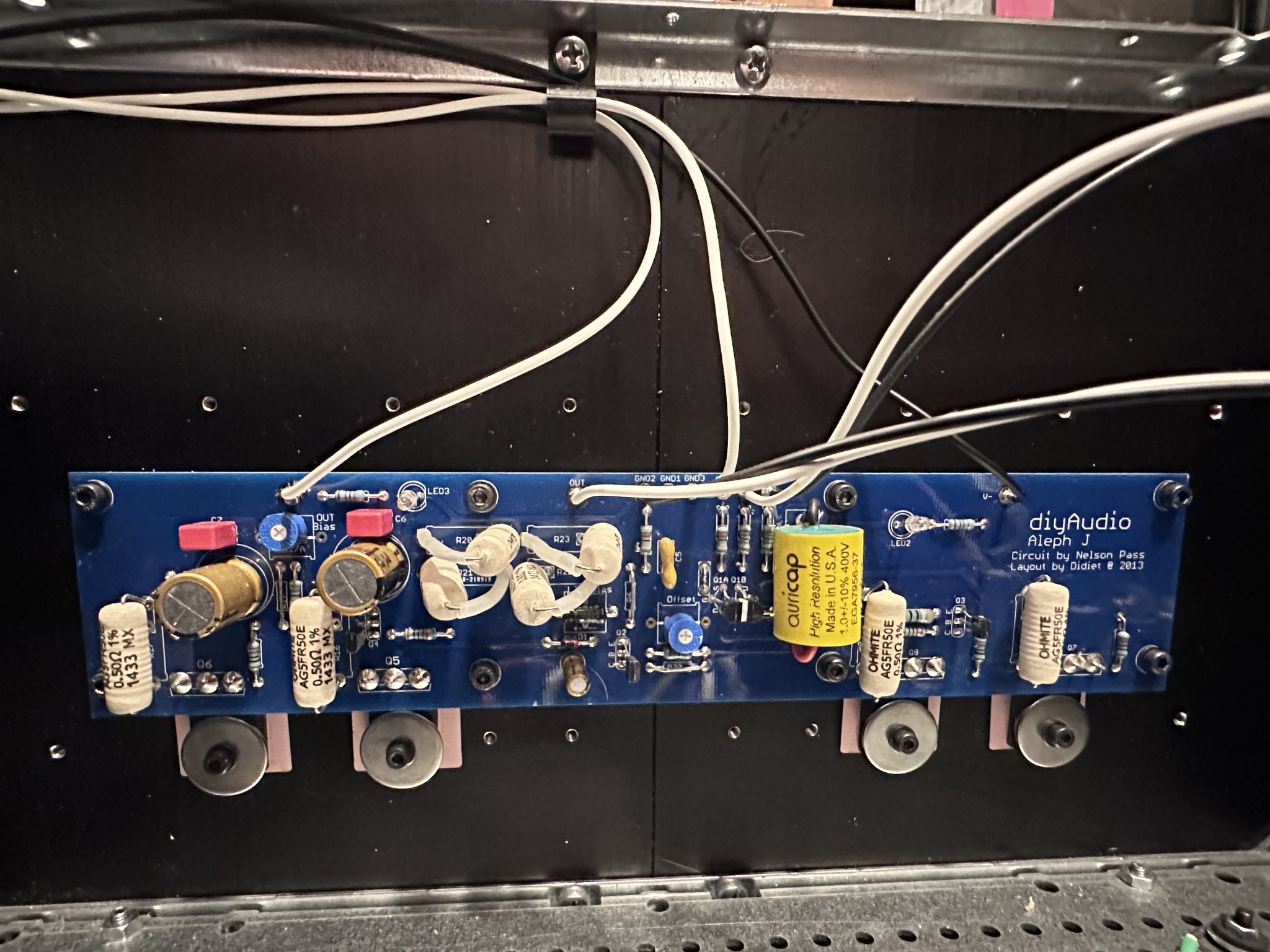

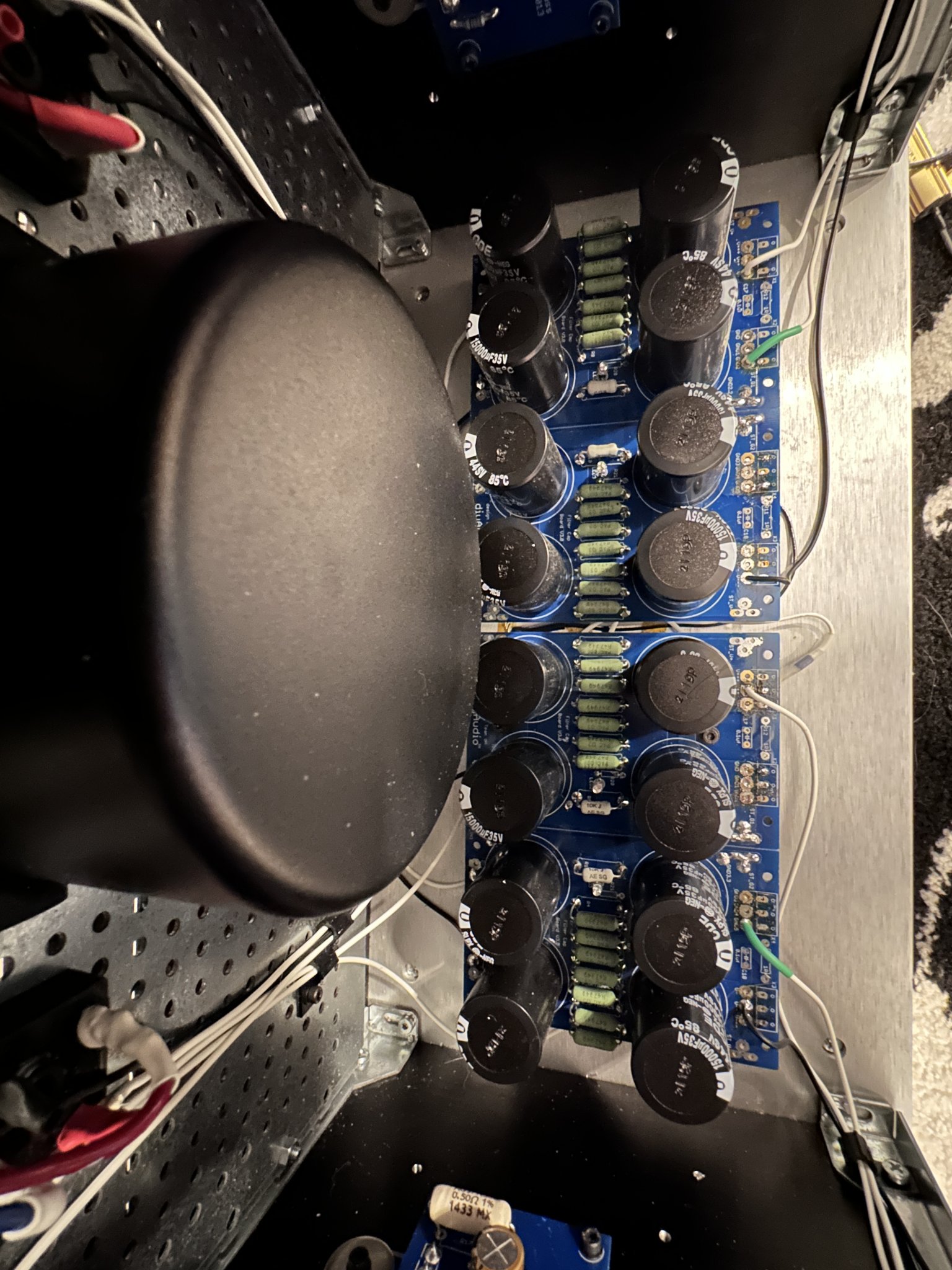

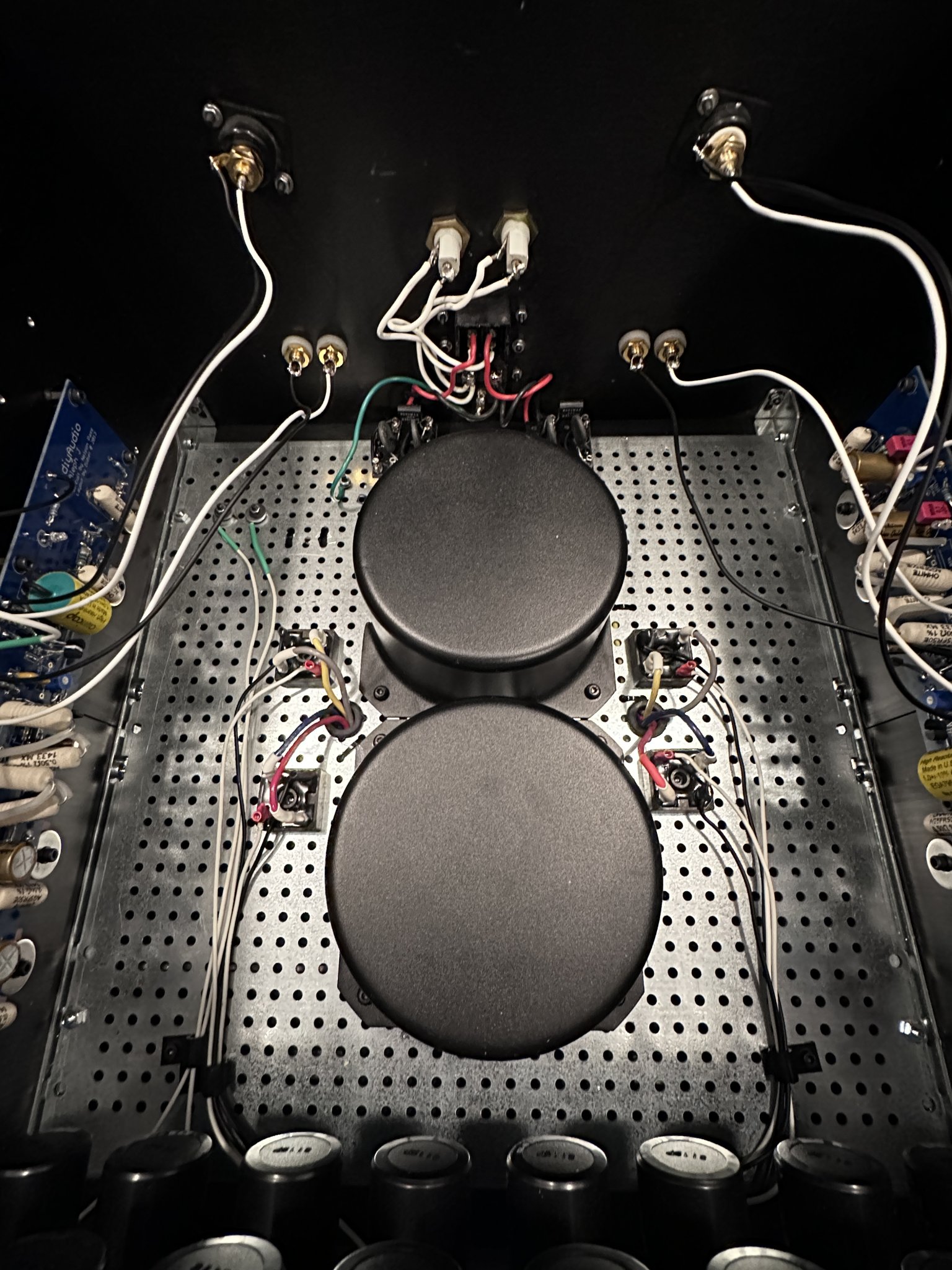

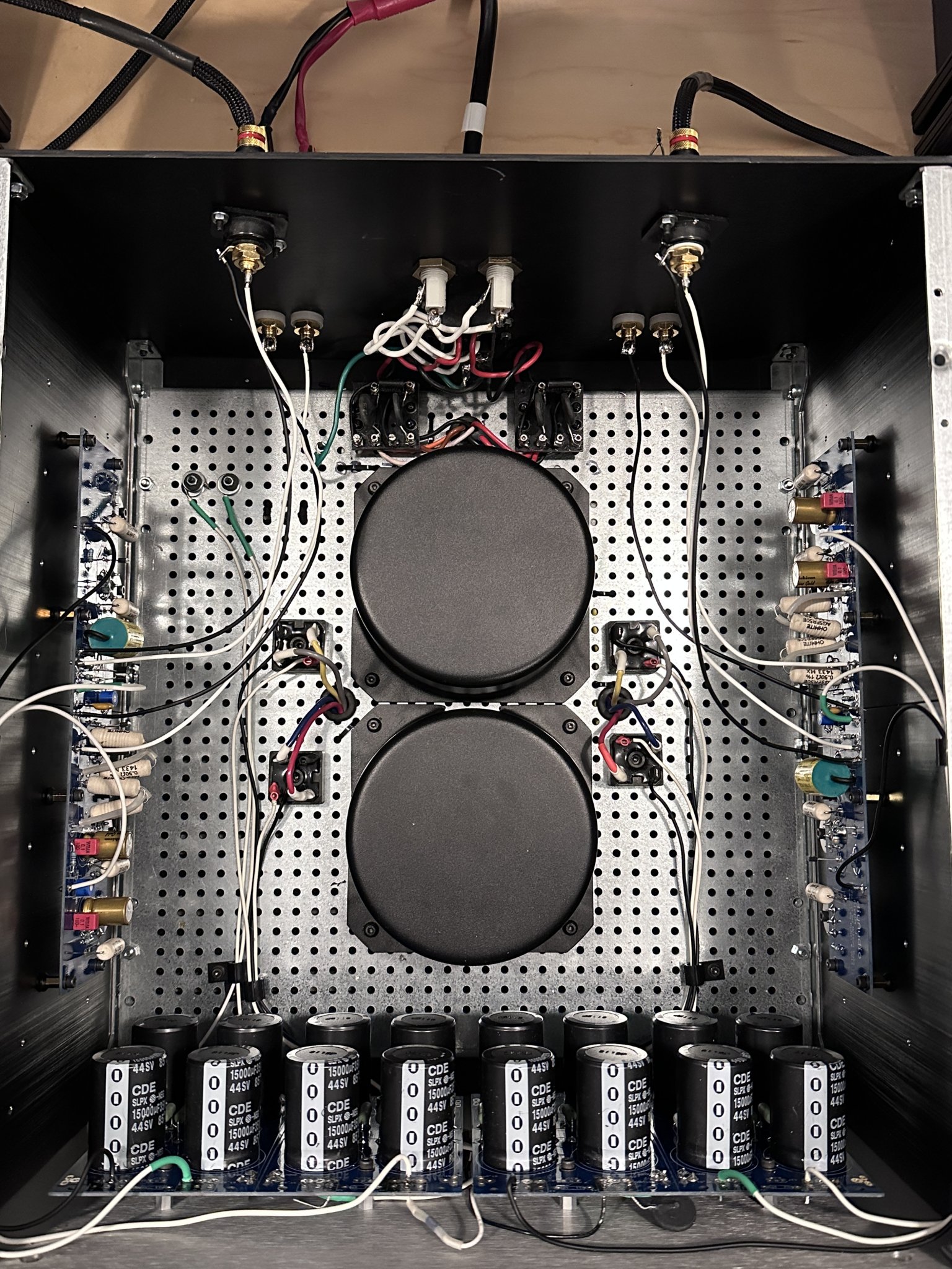

post some pics of your Aleph inside

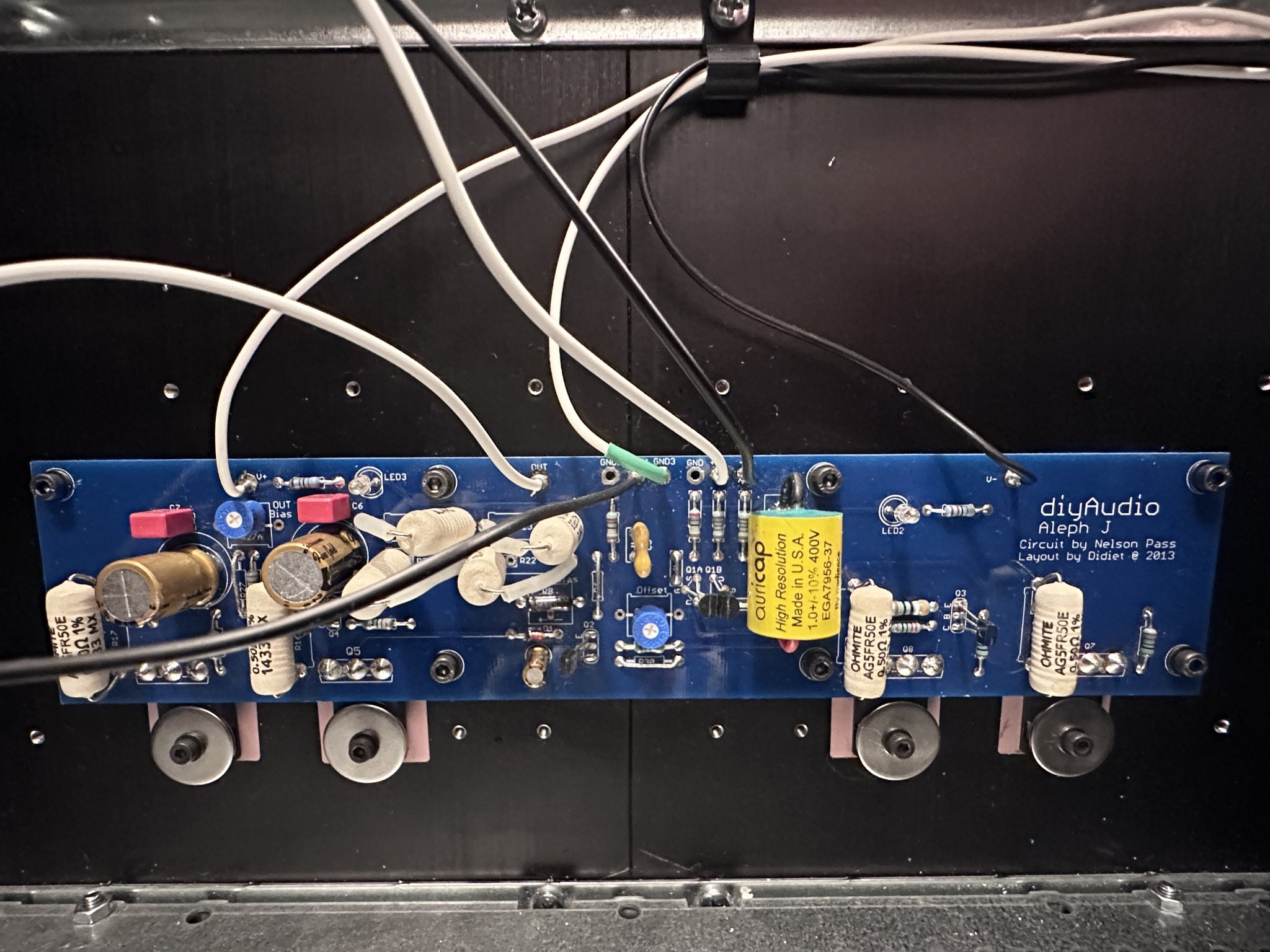

I'm not sure if this will cure what ails you (or if I'm not seeing it correctly in the pics)...
Do you have a jumper between In- and GND?
If not, give it a try.
Lovely build, BTW. 🙂
Yes, I think that's it. Please try:
GND2 - Speaker out
GND1 - PSU GND
GND 3 - NC
IN+/IN- input + and -
IN-/ GND - jumper
GND2 - Speaker out
GND1 - PSU GND
GND 3 - NC
IN-/ GND - jumper
^ GND, GND1, GND2 and GND3 are on the same trace ... Why have them move other wiring. Did I miss something?
Edited - After your correction, that's what I said.
Yes, I made a typo when I first posted it and realized the mistake. Corrected!^ GND, GND1, GND2 and GND3 are on the same trace ... Why have them move other wiring. Did I miss something?
