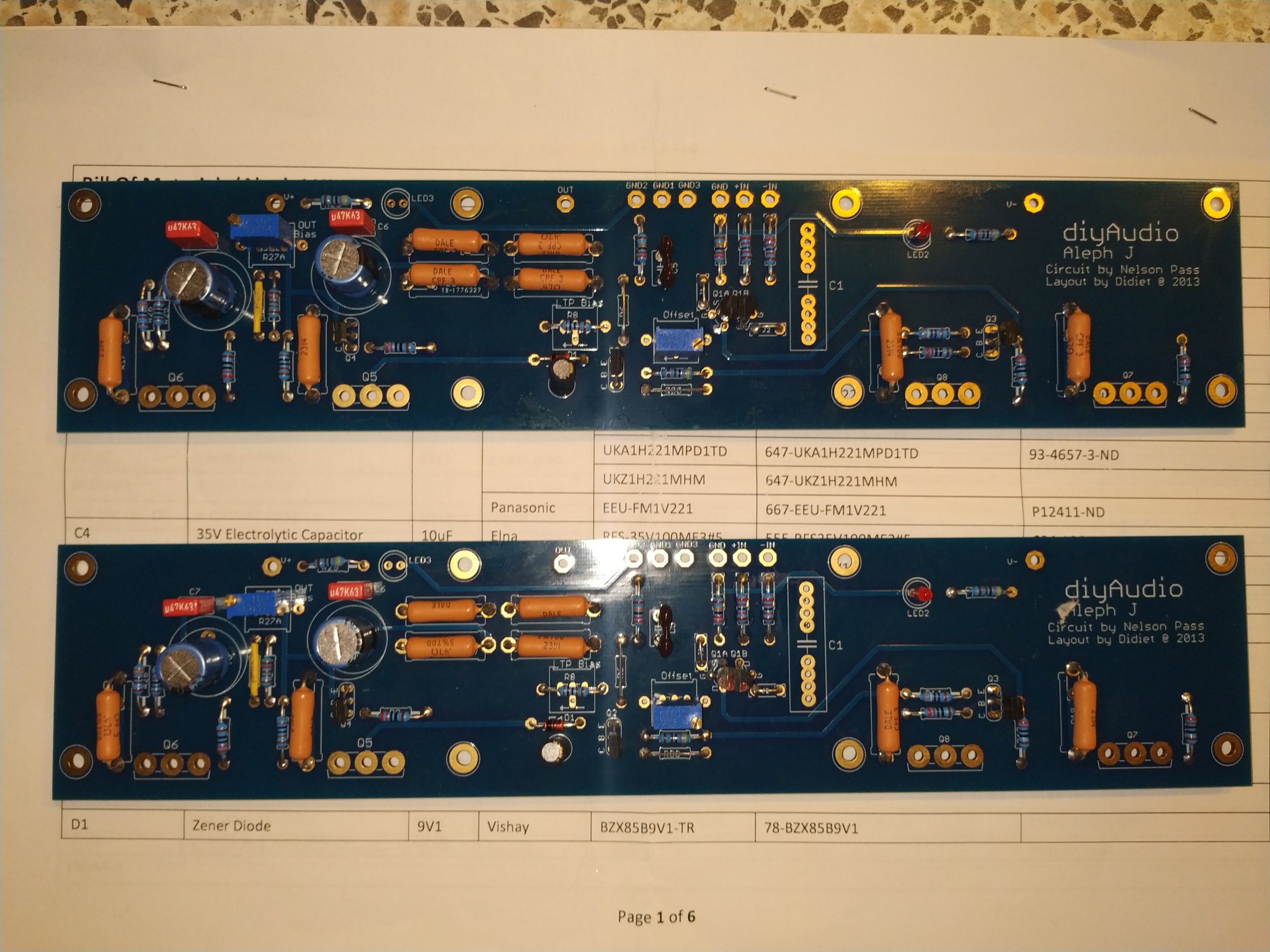

I can’t tell if you have something around Q1A and Q1B to keep them close together. I’ve seen zip ties and or heat shrink used for that.Hi guys, can someone check my construction. Thank you.View attachment 1174427

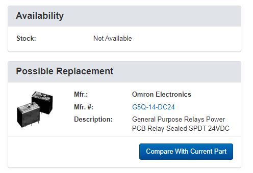

First, always list the original part number. A link to the spec sheet or providing key data within your post is very helpful and saves other people some work. They'll be more likely to jump in and help if it takes them less time to review your information.
Example - What is the original manufacturer's part number you are trying to find a substitute for?

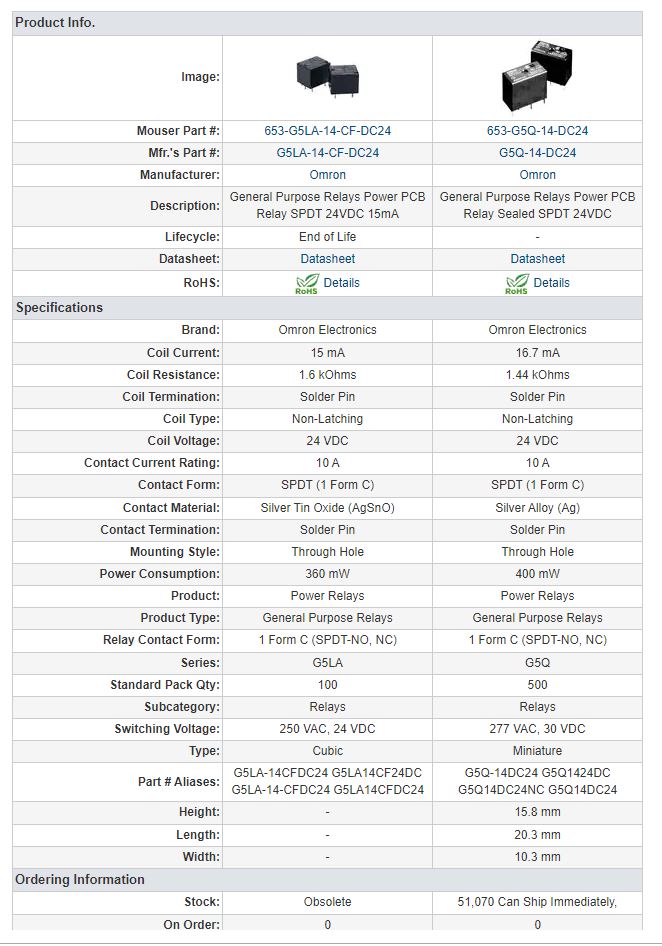

In post #9288 the link shows .... G5LA-14-CF-DC5. I don't think (from memory, but I could be wrong) that is the correct part.
I think the original part was a 24V relay like G5LA-14-CF-DC24. I didn't have time to look that up until this morning (my time). I checked the posted BoM from the sales page. Yes, it is a 24V relay. However, BoMs get old... is that the latest recommended part?
Then... you can use the awesome Mouser tool (if it pops up). See the Possible Replacement window? It will be on the right side of your page. Then, click the "Compare with Current Part" button?
It will give you ... this ...
I'd then go into the spec sheet for the original part and find the dimensions (comparing cubic to miniature form factors). If they match, then you know it will fit the PCB as a 'drop in'. If not, you can check the board dimensions / outline etc. or ask in the forum.
Also, you could ask some thoughtful questions like if the electrical differences in spec will make a meaningful difference in the circuit.
You'll then learn a bit about what matters in the specs for that particular part for that application. It can be both fun and frustrating. For me... it's still frustrating, but ... that's DIY sometimes.
Good luck!
Edited to add - I popped over to the other thread and did a quick search. I found this post very useful. I found it in response to an inquiry from @myleftear who had the same question as you....
The search function is very useful... Post #407 Gives a nice answer to the question asked in post #442

If I choose this relay :
https://www.mouser.fr/ProductDetail/653-G5LE-1-DC5

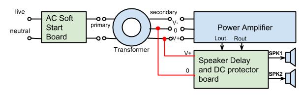

I have never built these... but... until someone much smarter than I jumps in, I will try.
My very limited advice would be to power your speaker protection boards from the same supply as your amplifier boards. No need for a separate transformer. Since the Aleph J uses a ~24VDC supply, I would choose the 12V relays.
This is a nice little diagram of how you could do it. Post #69
https://www.diyaudio.com/community/...ector-board-set-v3.247279/page-4#post-4112491
Please confirm in the appropriate thread with someone with direct knowledge... and that has built it successfully. As mentioned, I have never built this, and I could be looking at it all wrong and/or at outdated information.
Then... after you know generally what you need, choose the correct substitute parts.
Hope that helps.

Hello,
For the speaker protection board power supply, can someone confirm that I can plug it into the secondary of the Aleph J 500VA/18V (or20V?) transformer, does it 'is possible ? If so, which relay should I choose :
https://www.mouser.fr/ProductDetail/653-G5LE-1-DC12
Or maybe this 9VDC one : https://www.mouser.fr/ProductDetail...GAEpiMZZMtSzCF3XBhmW%2B7Dtixo7pgPGPiUWMek1sI=
Or is a separate transformer better?
