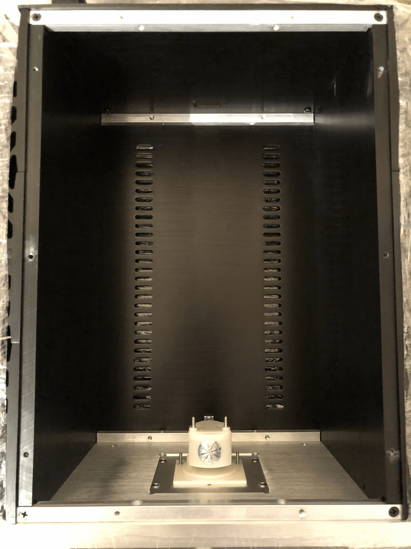

Case I was waiting arrived yesterday.
While inspecting new toy I was moving it from place to place, rotate it and so on. My back is hurt a bit now.. 😀
Internals are very small, about 240mm x 338mm. Making dual mono inside it would be a challenge.
Also thinking about to use Mark Johnson's H9KPXG soft start switch board. And also figure how to put VU meter to work.
Not in haste. Would be good to complete everything by the end of the year.

regarding space - Donuts stacked, cap bank pcbs stacked, and you're good

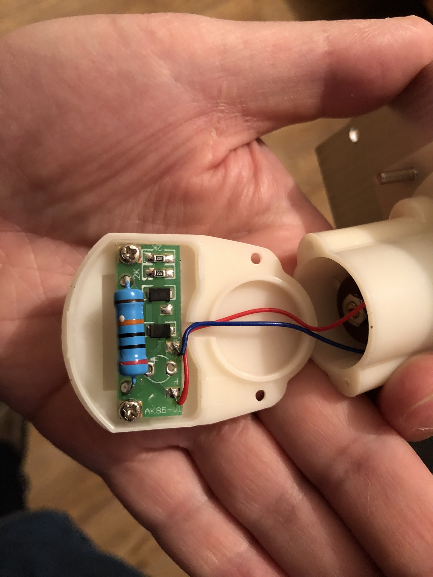

I opened this the first day. That's what inside.
If I understood correctly it is voltmeter that works from 240V. I didn't dare to check if it's true.
As you suggested I gently pull wires from the PCB, removed the PCB and then managed to screw naked end of the wires under the screws.
DMM shows 164.6 Ohm
ZM, by full tilt you meant needle at the center?

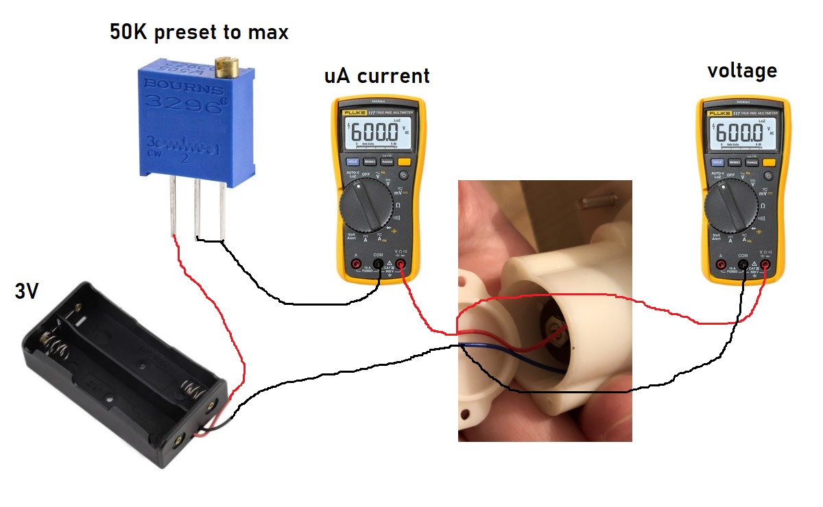

full tilt means needle going from rest to other end
1V5 or 3V battery, neg to blakck wire
positive to 50K multiturn trimpot connected as variable resistor (mid pin connected to one outer pin) preset to max, that to uA current meter (DMM) that to red wire
fiddle trimpot to get full tilt, read current, write
use second DMM, measure voltage between black and red wires, write

I got:
-1.402 mA
230 mV

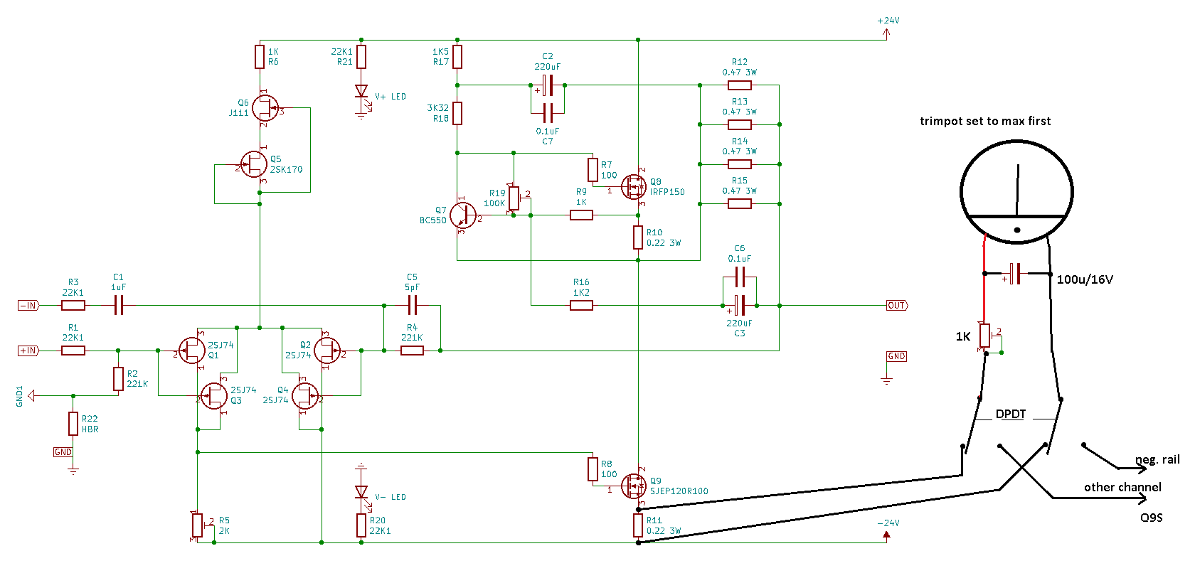

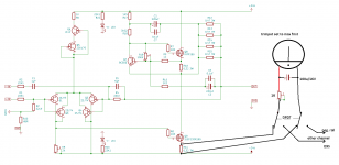

OK
now - post exact schematic you're using, and I'll be specific where and how to connect it
you'll need just one trimpot and, say, 100uF/6V3 cap
that - counting that you want to observe Iq
though, as you want periodically to check both channels, simple two sections-two positions toggle switch can be used, to switch between two channels

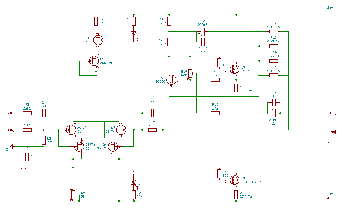

I thought to use it in this variation of Aleph J.
