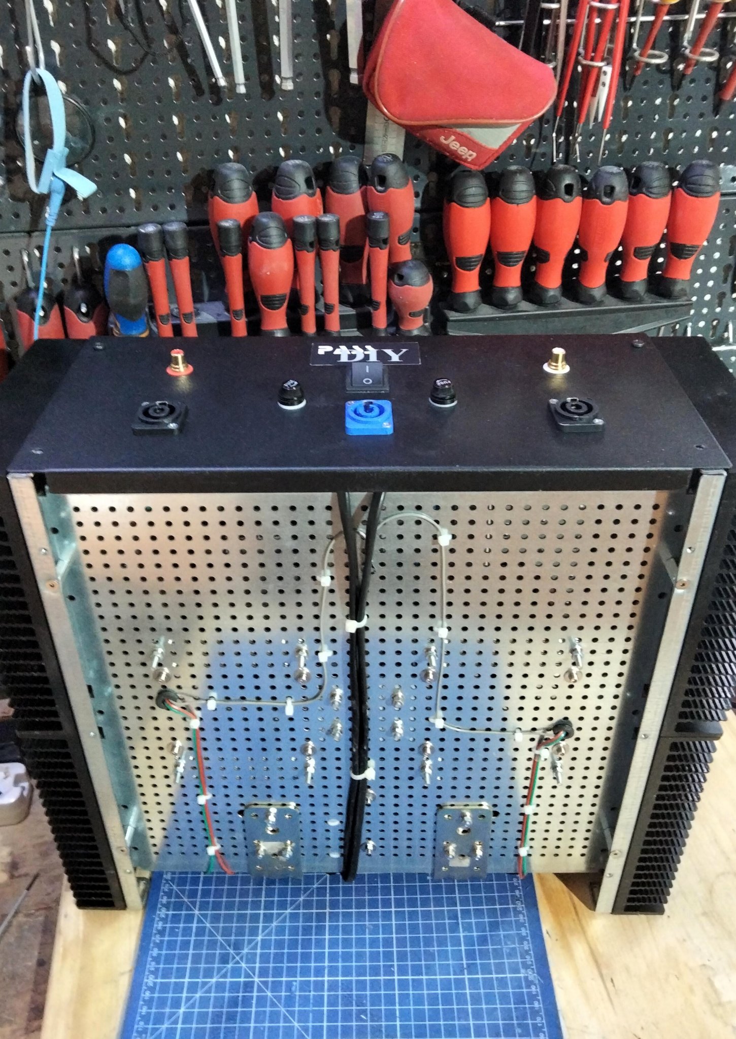

Right now I am waiting for one pretty Chinese chassis to arrive, wich I then need to tap with holes.
Don't forget to enjoy the music. 🙂
I have high hopes to finish mine this year.

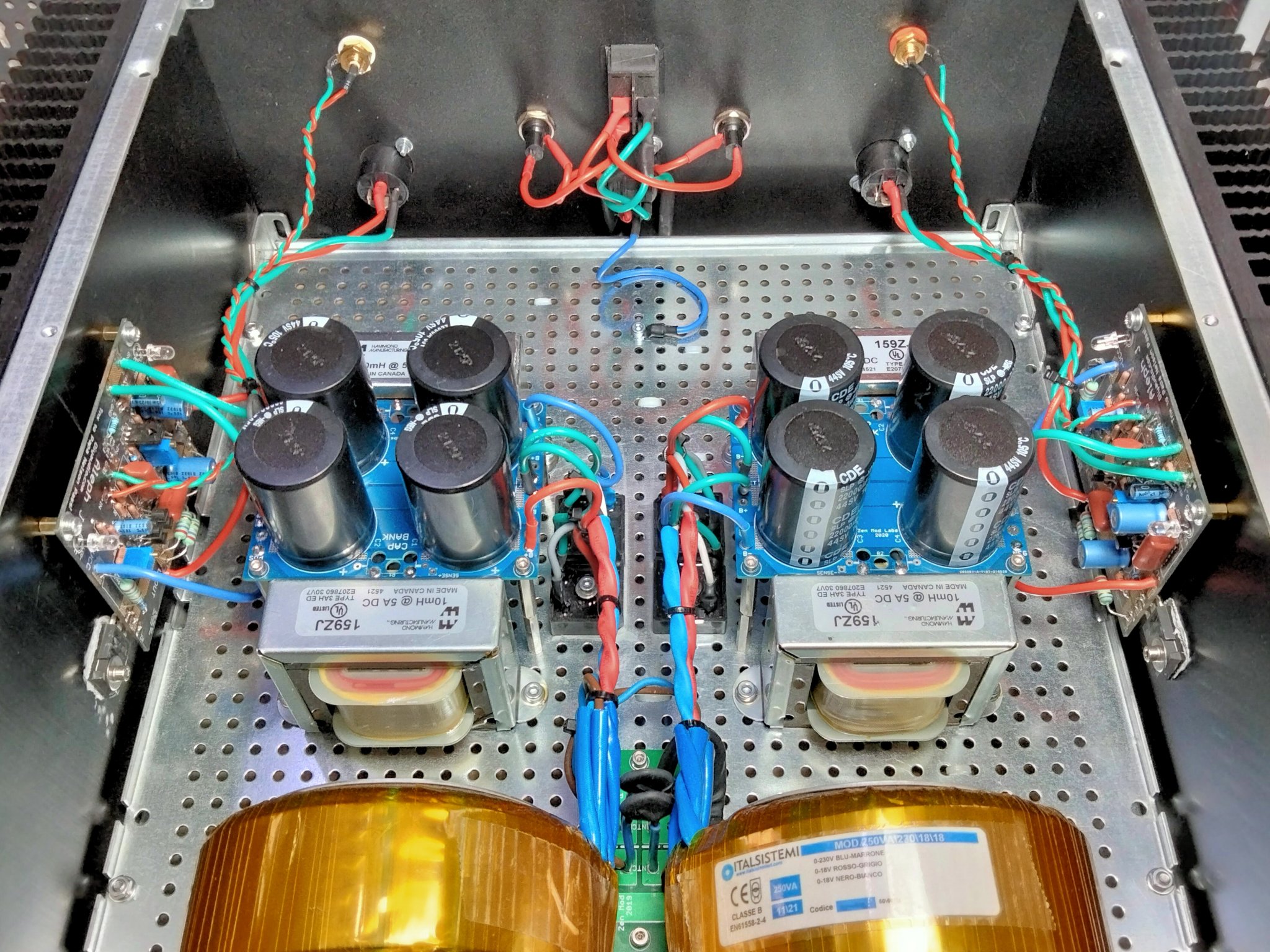

Peppennino:View attachment 1014642
Almost done...
It is very very heavyweight!

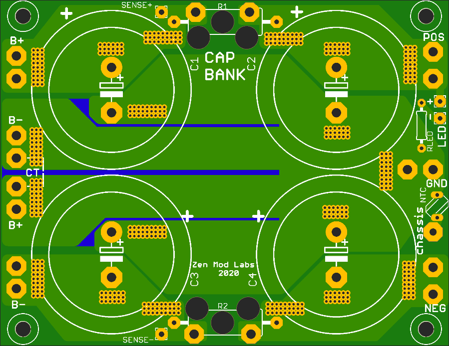

Dear ZenMod I saw in another thread the pictures of your PSU board that Peppennino use for his Aleph J.
I have plans to make PSU for my Aleph J as dual mono in one case so I gather the knowledge of various PSU designs and tricks.
I attached the picture of your PSU with lines in blue color that is of interest.
What are the advantages of these trace cuts? (the ones I colored In blue color)

Ensures as little ripple as possible in audio gnd junction, and hence ground plane itself and ground takeoff points. Notice takeoffs are dead center and as far away from equalizing currents between neg and pos side of plane as possible. It is basically T’ing off the gnd, also discussed by Bonsai in his Hifisonix article. lovely boards.

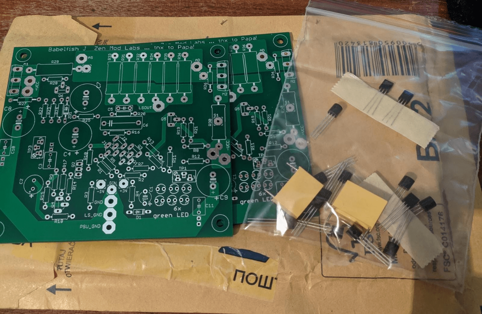

I'm a happy man, i received generously a BJ (babelfish j
) and some parts from ZM. I was asking around for p-jfet alternatives for the AJ, but in addition to some j271,also received bjt's and pcbs, and mkp caps. Let's try to make it sing now. Maybe i will even consider leaving it on when it gets to 33C (90F) in my room (facing sun, no climate control).
