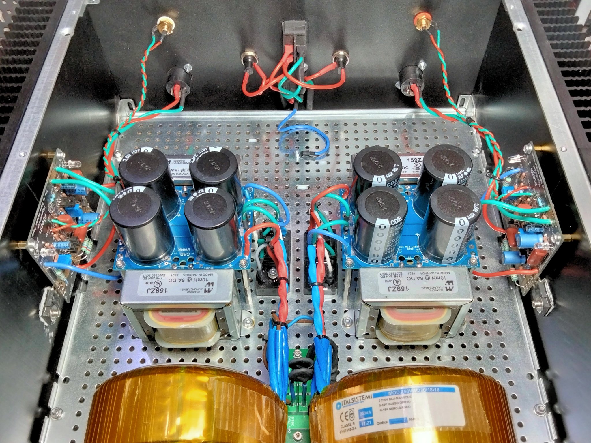

Please help me set Iq and DC offset with these boards![]()

First things first.
1: this is an extremely well designed circuit. It is very, very stable wrt bias and offset adjustments.
2: Expect a quite high minimum/initial Iq. Don’t be surprised if minimum is approx 1A. Don’t worry, have no fear. All is good.
Adjustments=very easy.
1: If you are unsure and cannot set the bias pot to minimum value, set it to mid position (12,5 turns from click).
2: Offset pot is really not that important, but mid position is fine.
3: One DMM across one of the source resistors, alternatively two DMM’s, one across each. I used one.
4: One DMM across speaker outputs, to measure offset.
5: Turn on, and adjust 🙂 Normally it is good practice to adjust a little, zero offset, and adjust more. It is probably a good idea here too. But I am not known for being careful, so I did not care too much about that with this particular circuit. Felt very safe to set up.
In 4U and using goop @ 0N85-9, I would target approx 35 watts dissipation per device for starters, and see how it goes - measuring temps at devices center pin/device body, sinks close to devices, and sinks in general as it reaches equilibrium.
35 watts @ 21V5 is a drop of 0V440 across source resistors 🙂
Iq @ 1A62 per device.
My amp in 5U has higher voltage rails @ 24 volts, and is biased at approx 1A75 and 42 watts dissipation per device. All chill. I could sleep on it.

no load on output, inputs shorted/grounded
final setting with lid on (probe wires/crocs to DMMs outa case); wait, read, open, fiddle, close, wait, repeat
Forgot those important steps. That said, and kudos to you Mighty, I could not measure a difference in offset with inputs shorted/not shorted. Also, when I after three days of use in listening position/in an open cabinet decided to verify/null out offset, it hadn’t drifted more than 3mV. A beauty 🙂
