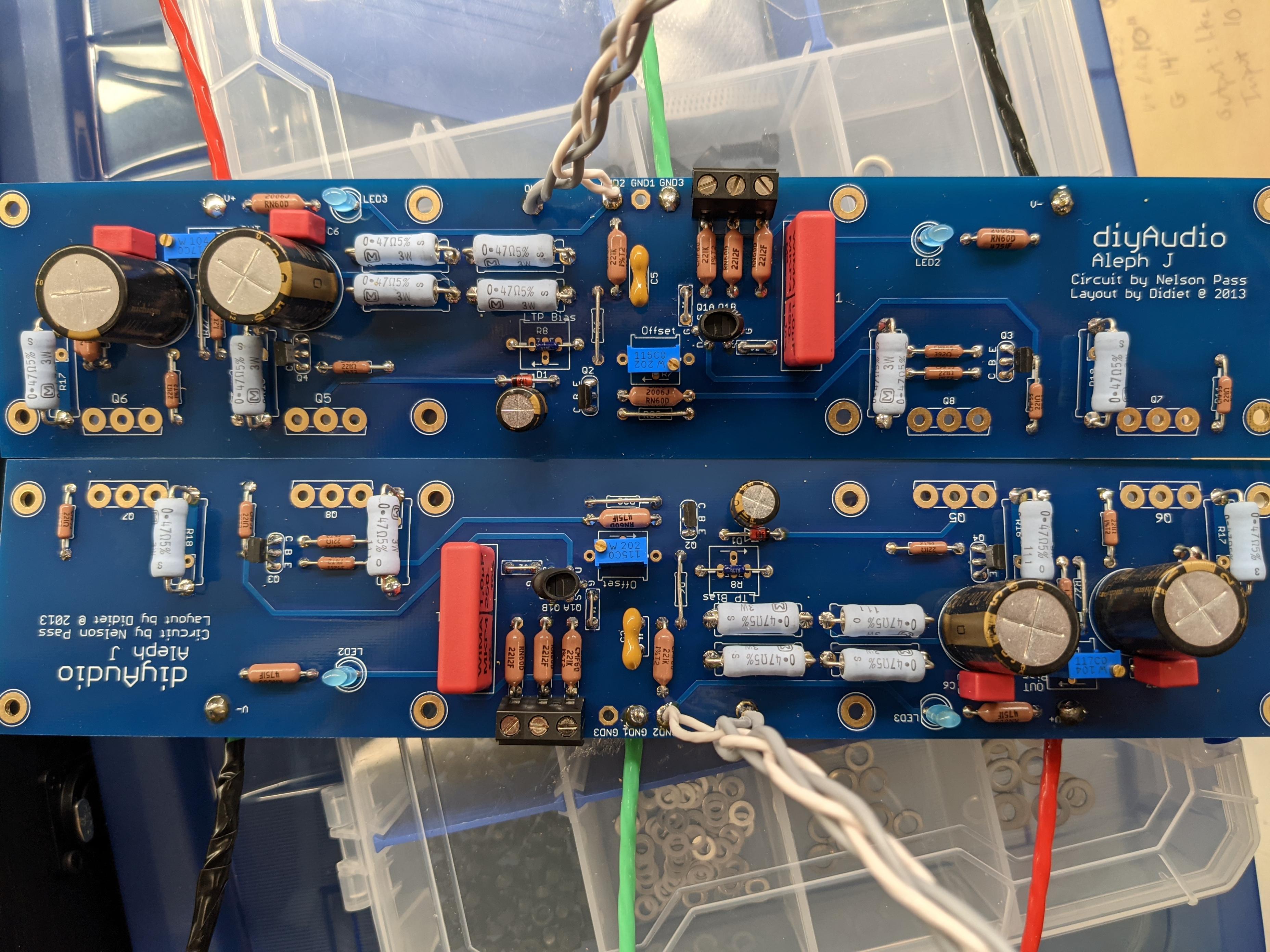

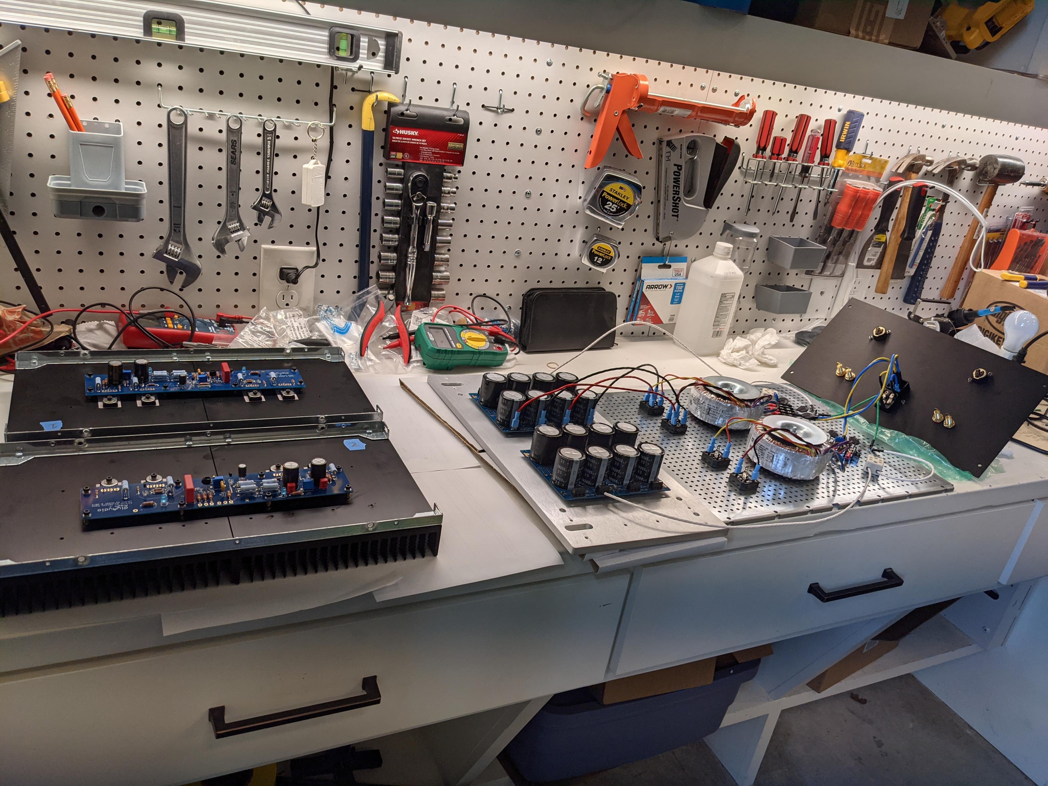

Speaking of dual mono Aleph Js, I'm making slow, but steady, progress on mine.
I had never built a power supply before. Now I've built two. Both outputting +27.7 V and -27.4 V.
I got the amp boards all wired up last night.

Me: "I think that for J I'll go for Dual Mono in a single cabinet"
ZM: "Take a Dissipante 4U/400"
Me: "It's too big for my rack"
ZM: "Change rack"
Done

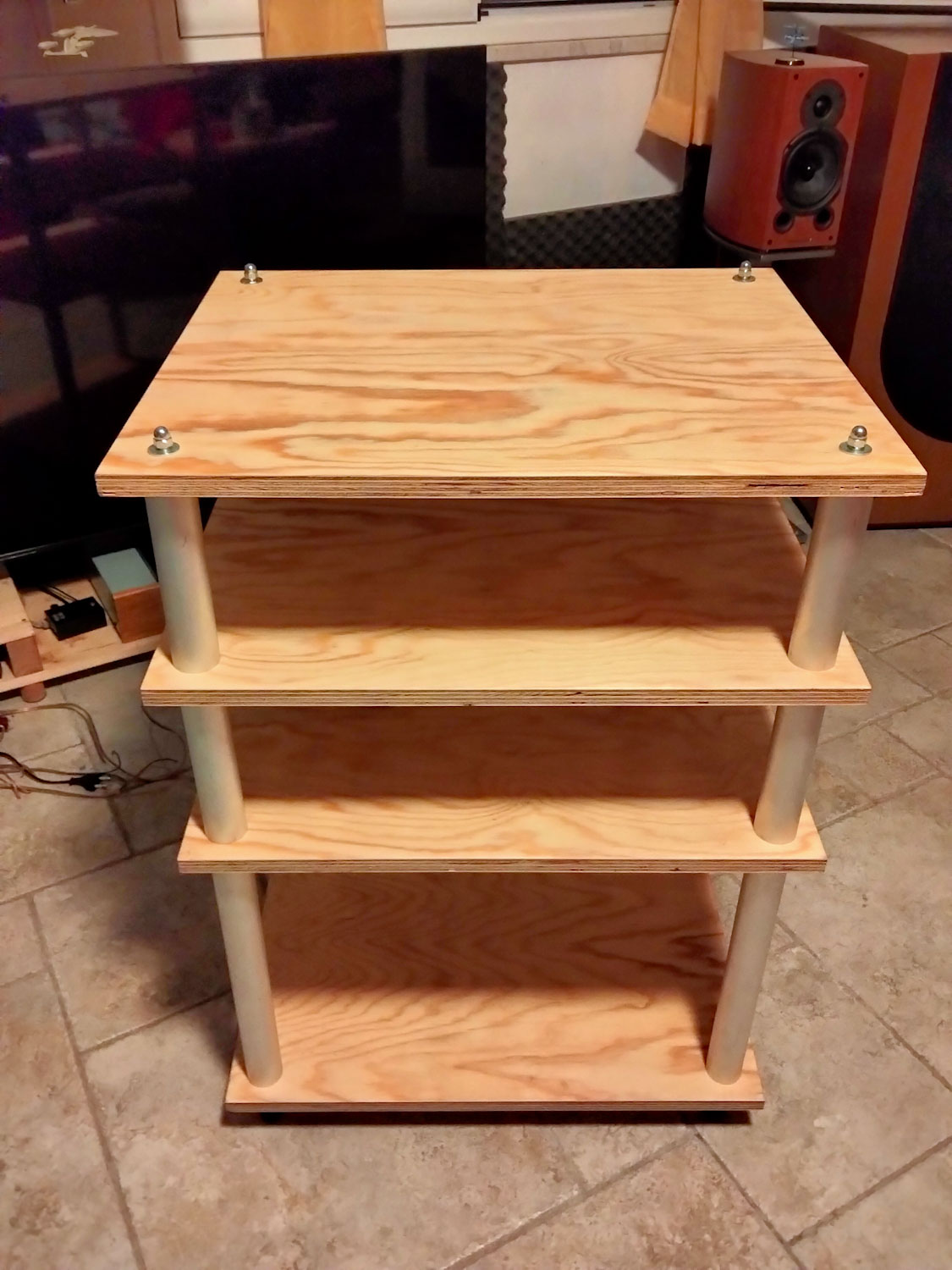

The Infinite Improbability Audio Rack

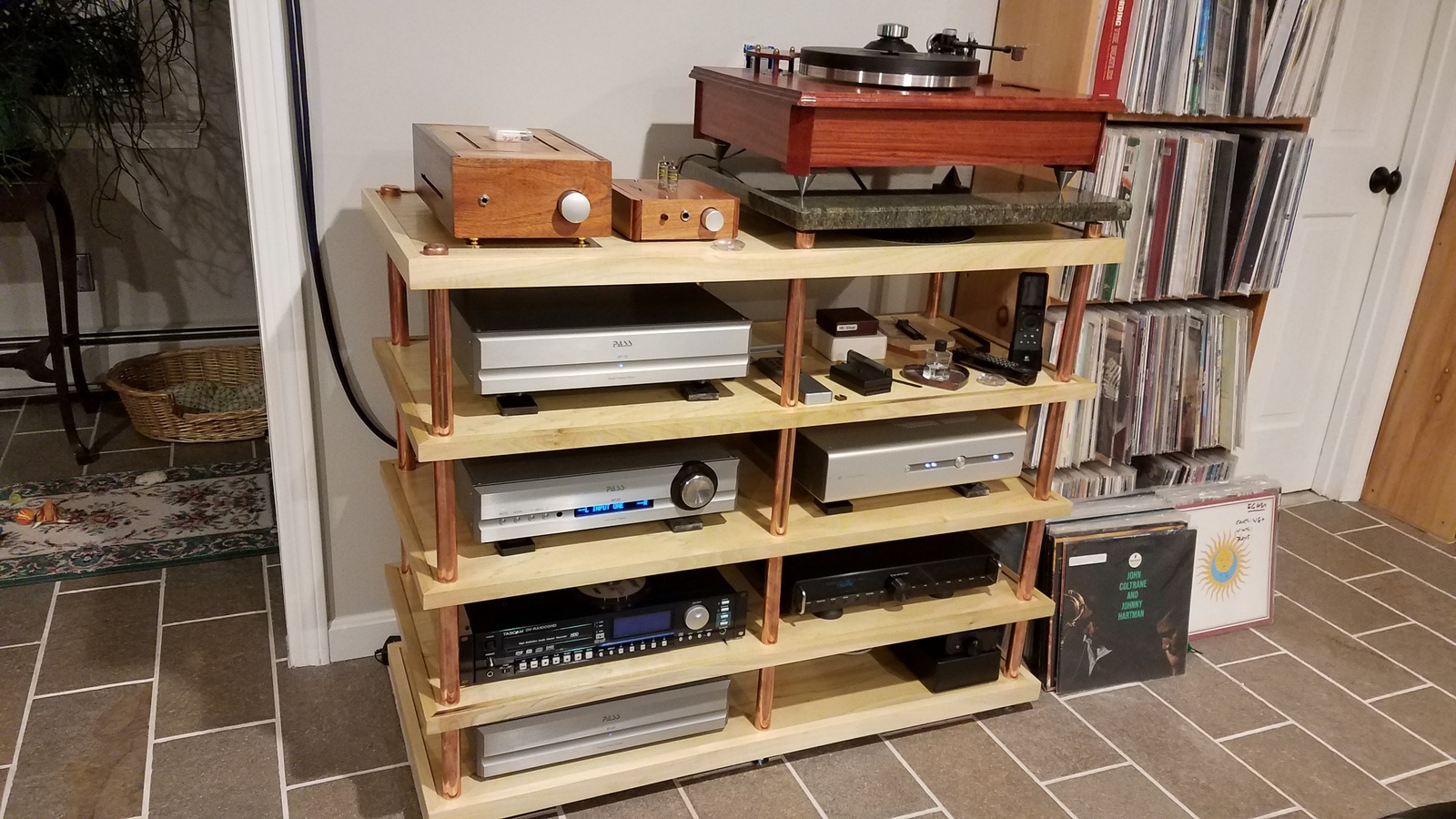

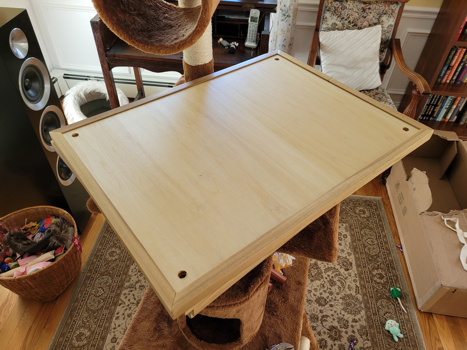

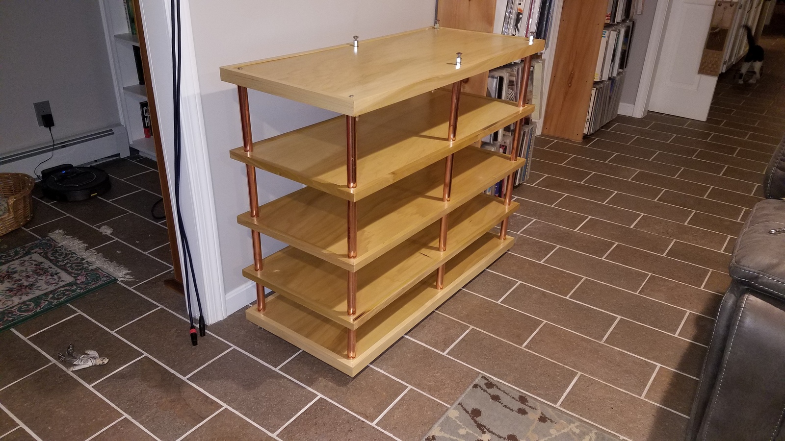

That's somewhat similar to a couple racks I built last year. The main differences are: I used poplar plywood; copper plumbing pipe; and I put a poplar border along the edge of the plywood. There's a dado that runs down the middle, so it fits right onto it.
If you want to finish the edges of something like this more simply, you can use edge banding. It just irons on, very easily. Quite cheap. Then you have to trim it, using one of these. It takes a couple tries to get the hang of it, but also easy.
perfect
you can implement Babysitter fan in lowest plank, for Summer months
Did you intend a fan per side under the heatsinks, with two holes on the plank?

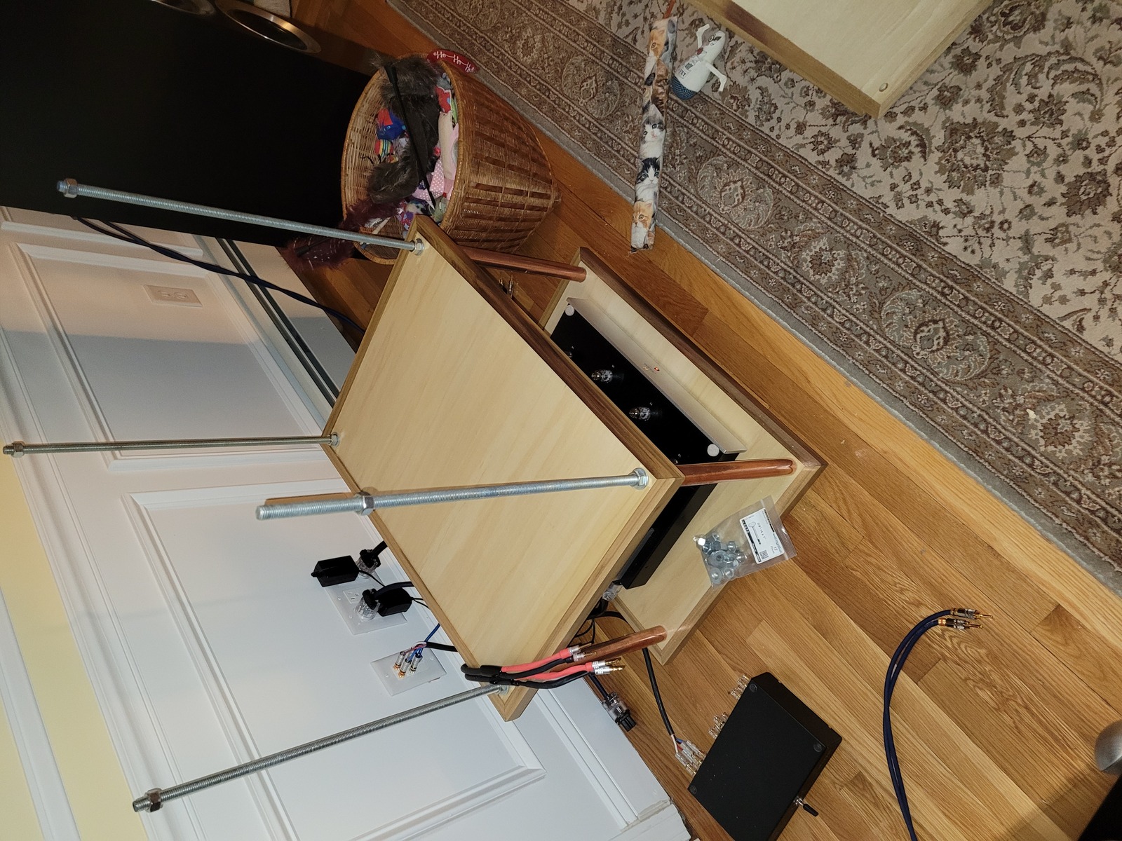

Riki: that’s a great looking rack you’ve built! It seems that everyone but me used some sort of tubing to hide the allthread - though I made mine about 18 years ago.

Nope. I have one in basement with exposed threads. lot of fiddling to redo now...
