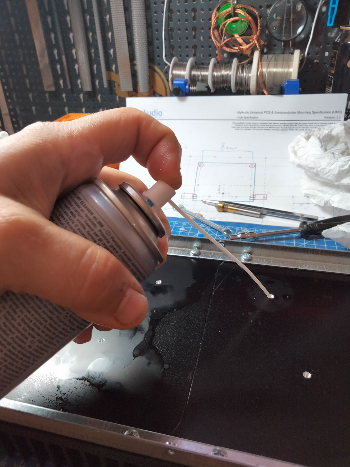

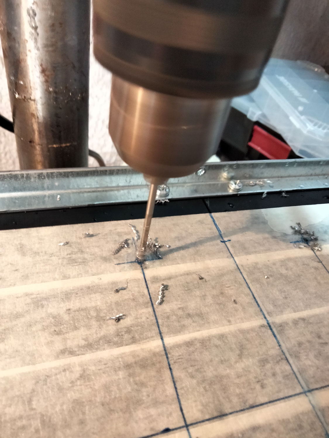

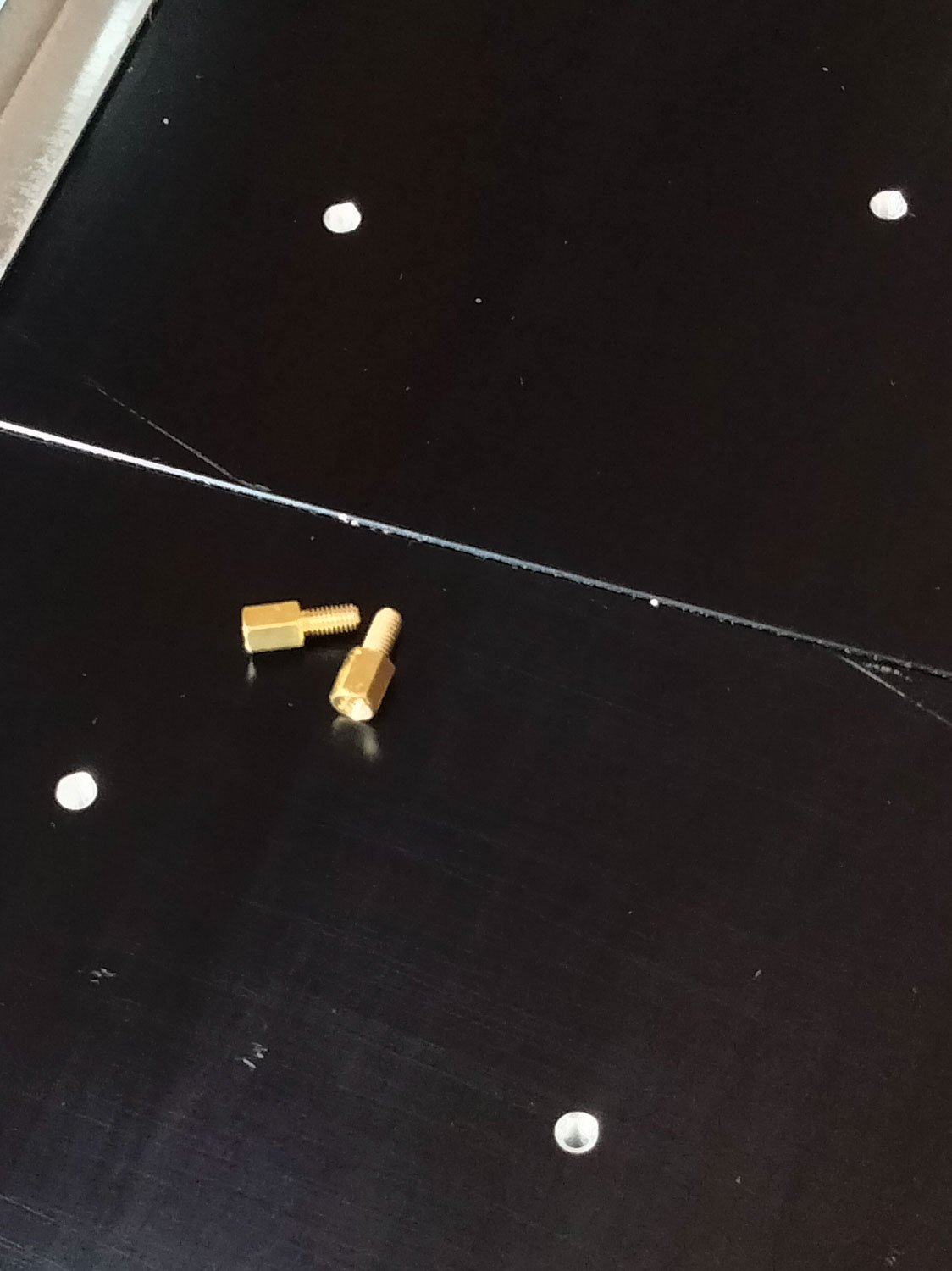

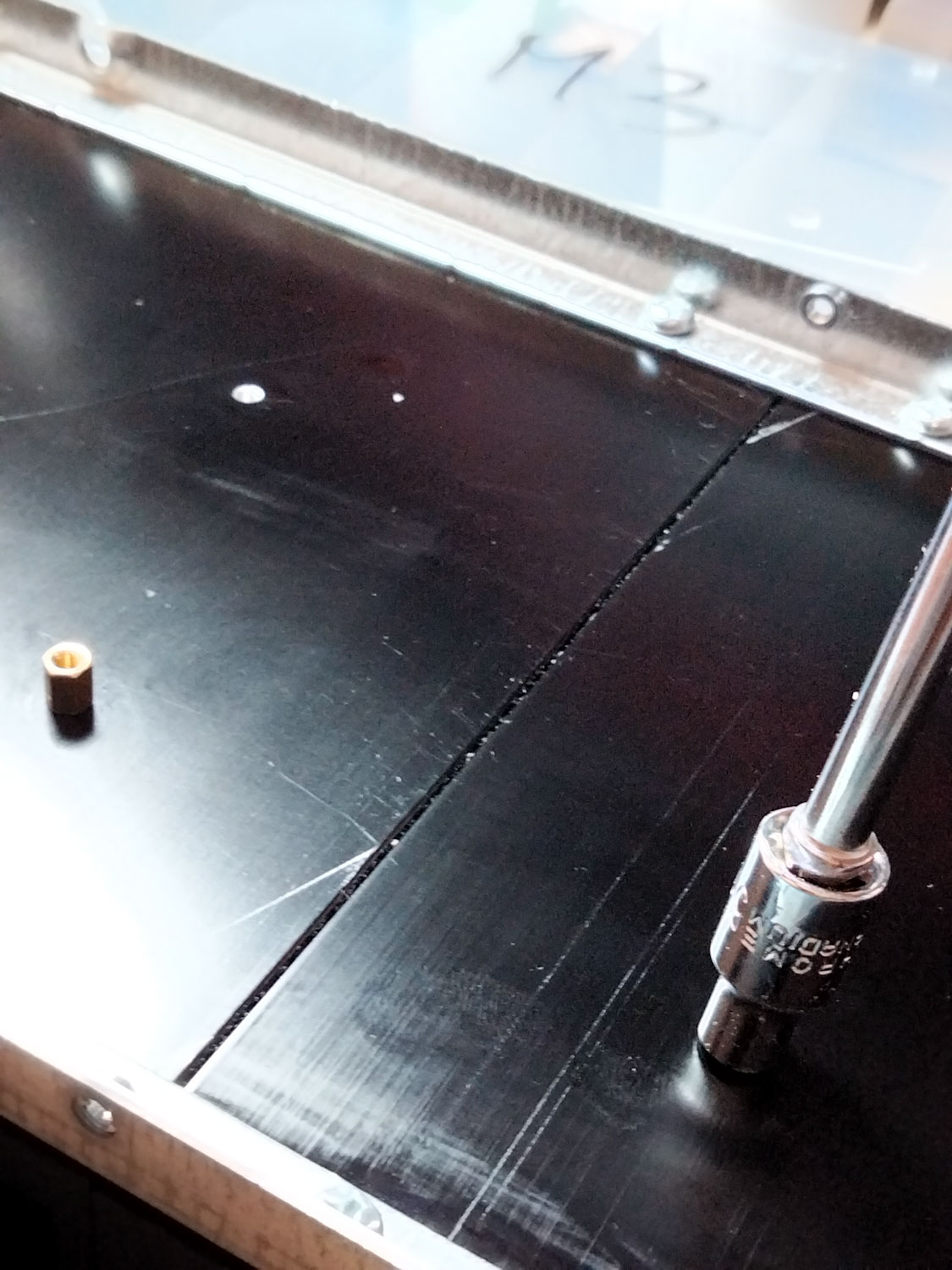

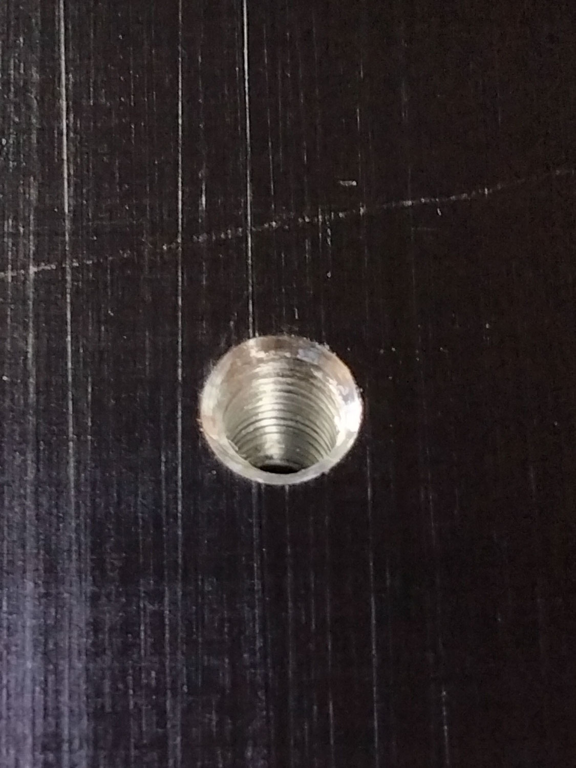

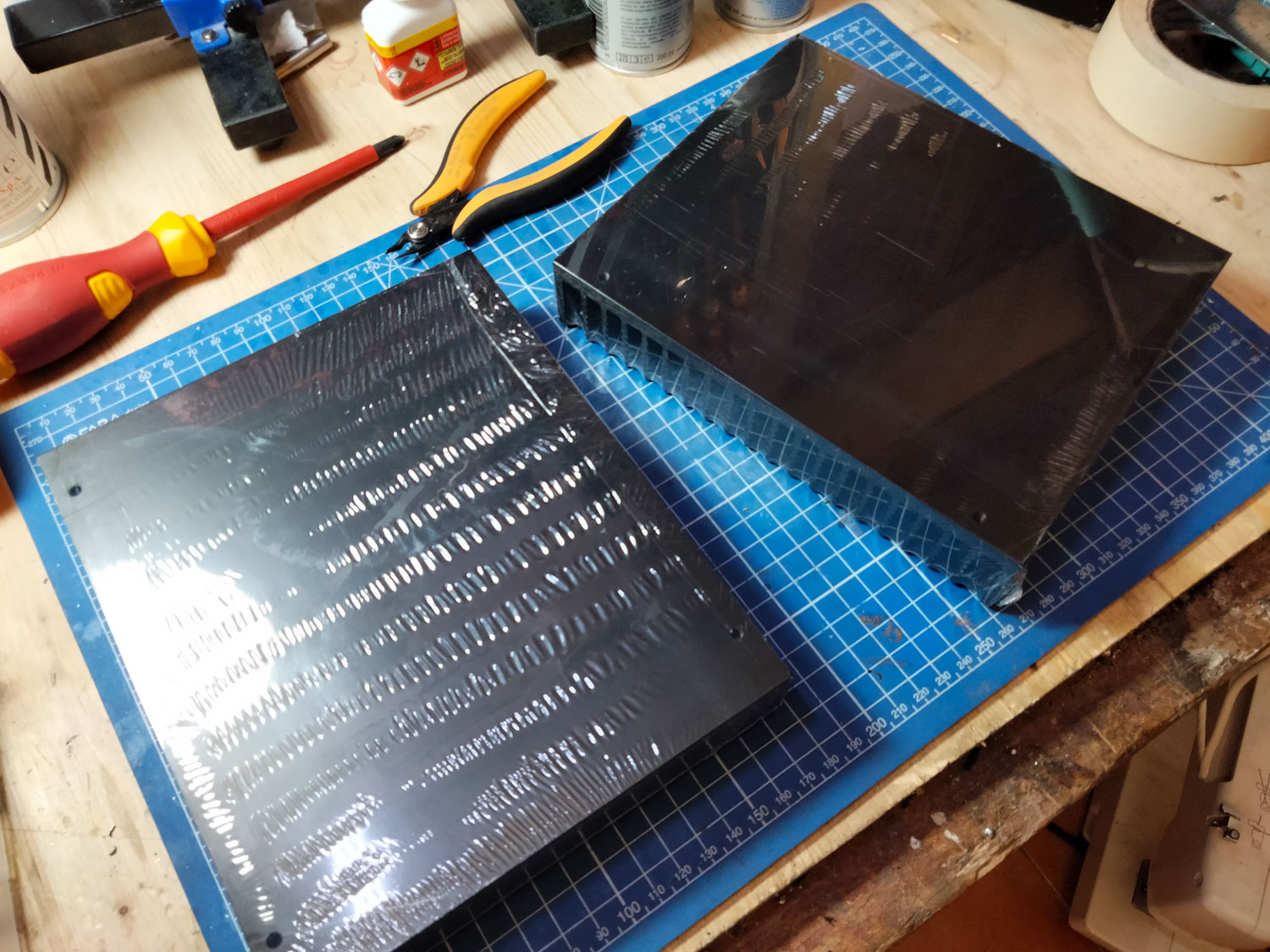

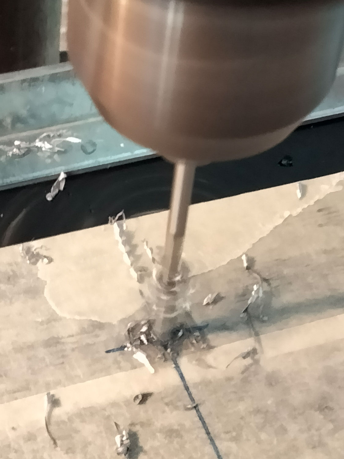

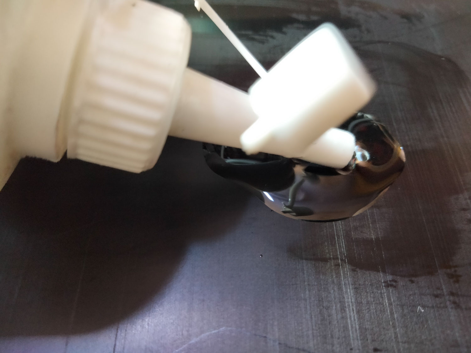

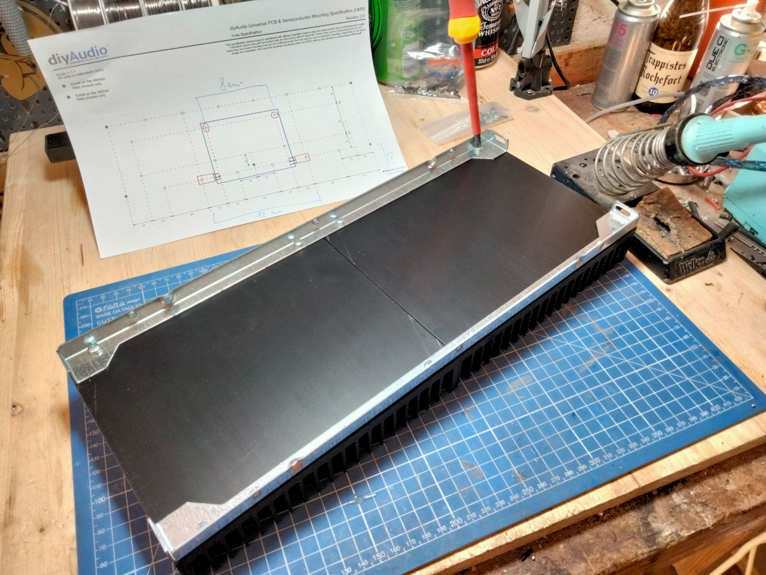

Let's resume the JZen journey...

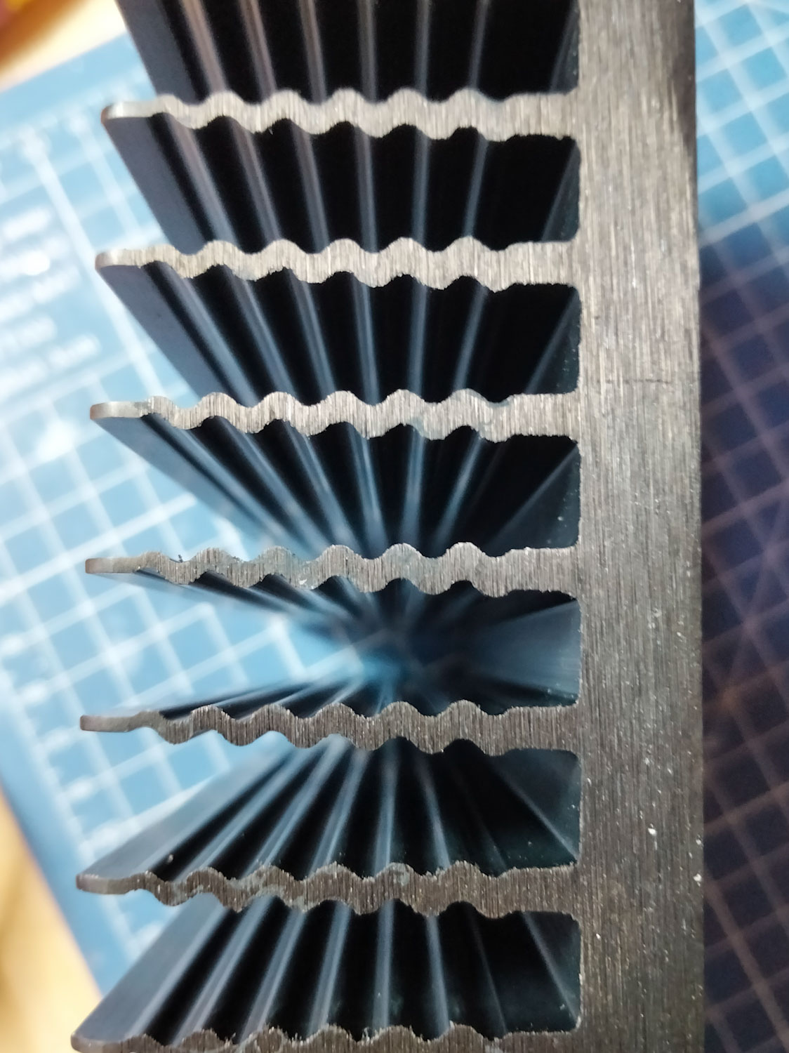

As I'll do a CLC dual mono PSU, I needed a BIG cabinet for PCBs, Irons, Donuts, Life, the Universe and Everything....

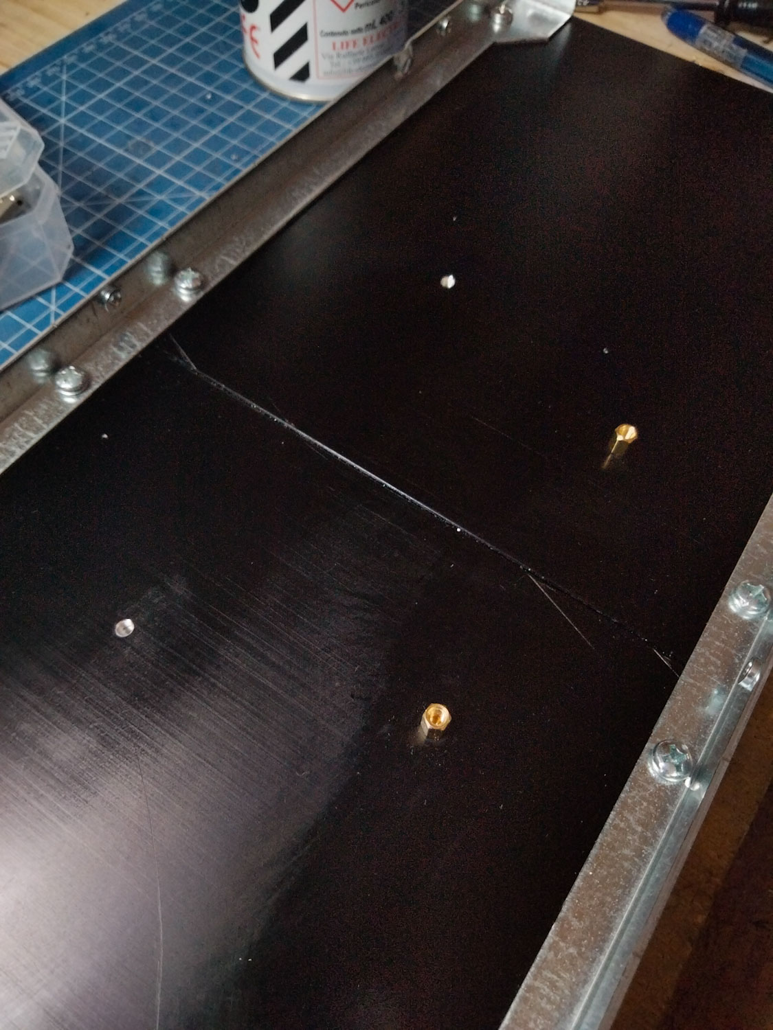

As Mighty ZM suggested, I bought a 4U/400 cabinet from the well known 'talian company. So, the first step will be the tapping for the M3 screws in heatsinks.
They're Biiiiiiiig!!

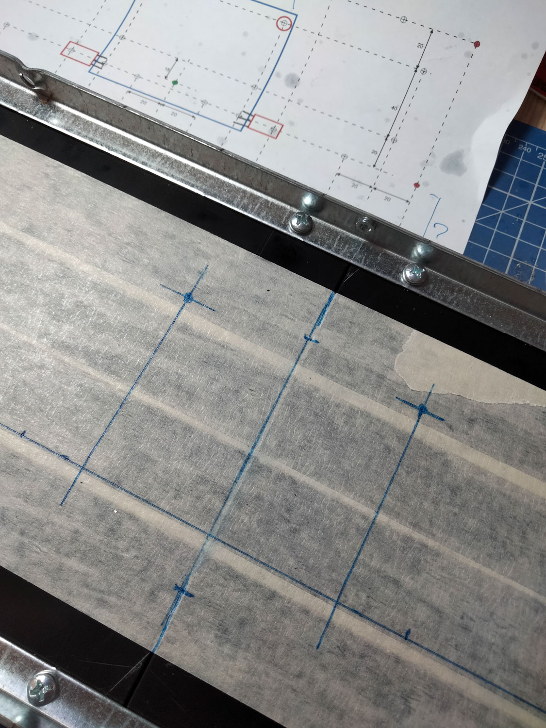

I have to fasten the brackets with 6 M4 screws

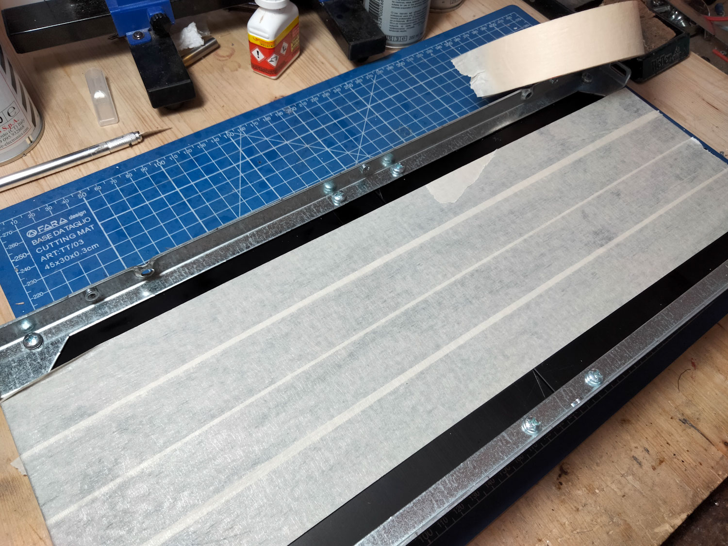

Some masking tape for the drawings

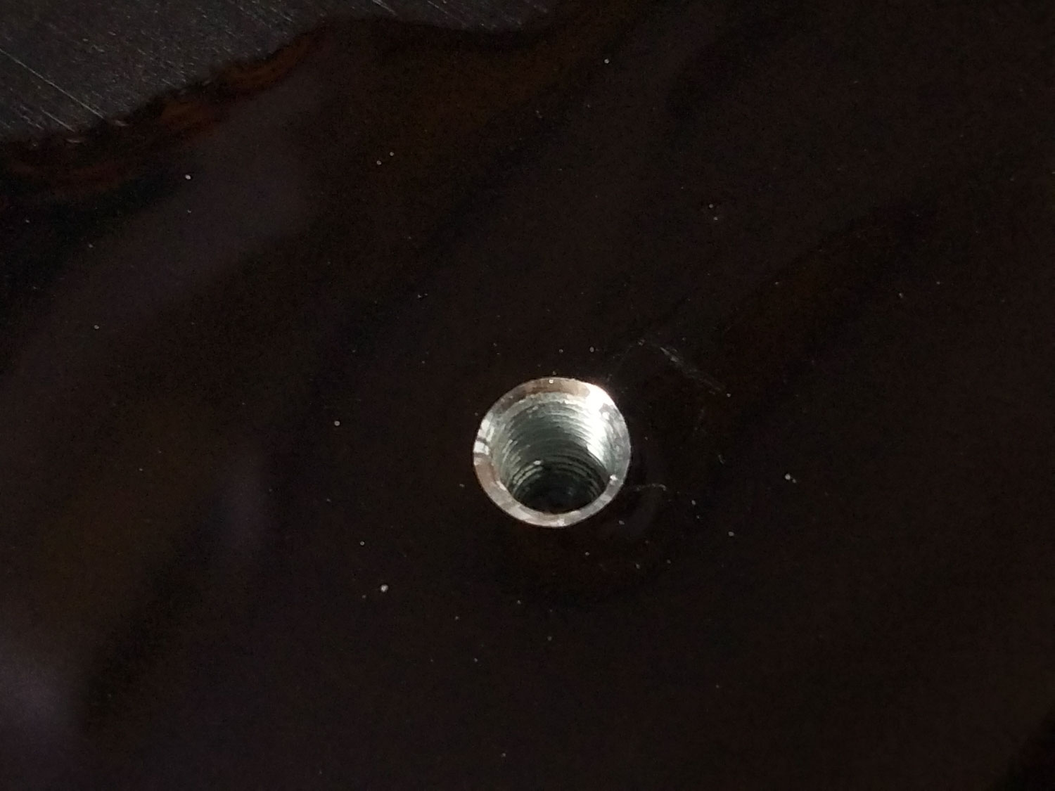

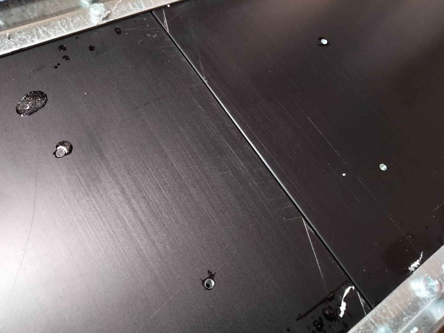

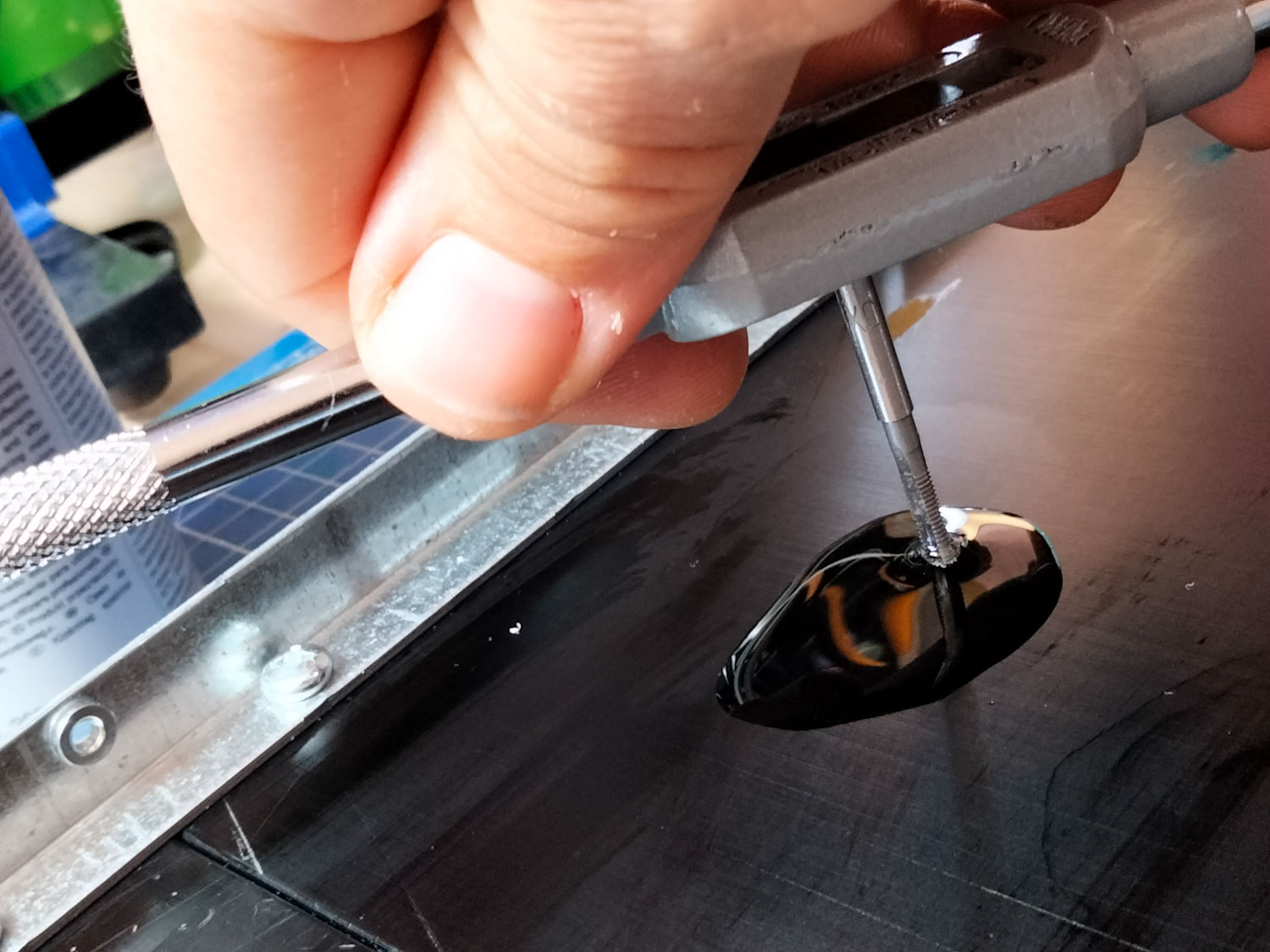

Drilling with 2,5mm bit and some cutting oil

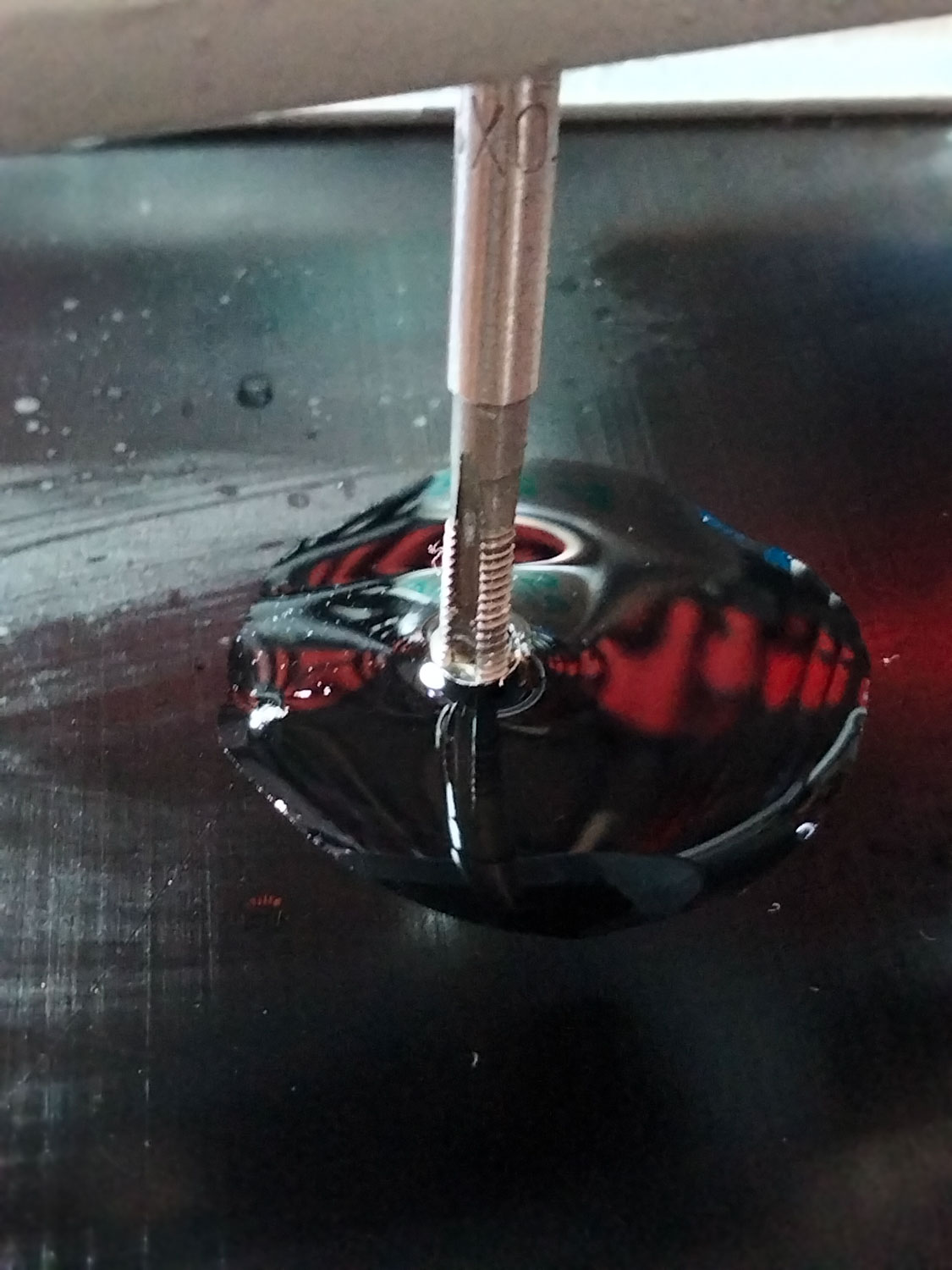

Now it's time for tapping...

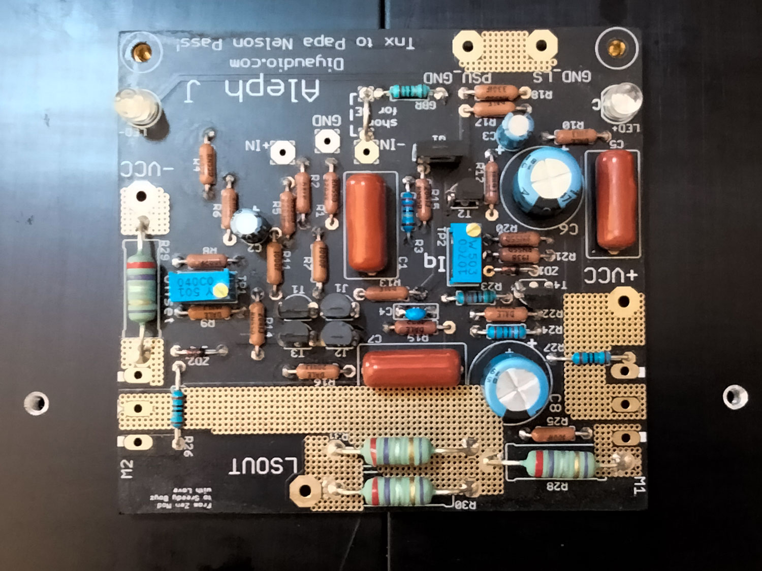

Dear All,
finally I finished my building and just started testing.
The PSU seems correct: light bulb test OK, red and green leds switch on and I measure plus and minus 23V DC at capacitors output with 220 VAC at my main power input (I live in Europe).
I tested both my amp boards and things are not going as indicated by the building guide. First of all, when I switch-on the amp, the light bulb switches on and then quickly switches competely off instead of a lower level light.
The blue leds of the amp corretly swtich on and remain on; but when I measure VDC at input resistor as suggested in the guide to adjust BIAS, I measure 0mV in practice. Things do not change by adjusting R27 resistor (as suggested by the guide I make this test with a clean power wire, no more light bulb).
At AMP output (to be connected to the speakers) I measure 700mV on one channel and 400mV on the other one.
In addition I expected the heatsink to warm up but they remain cold.
Can you suggest me what is going on?
