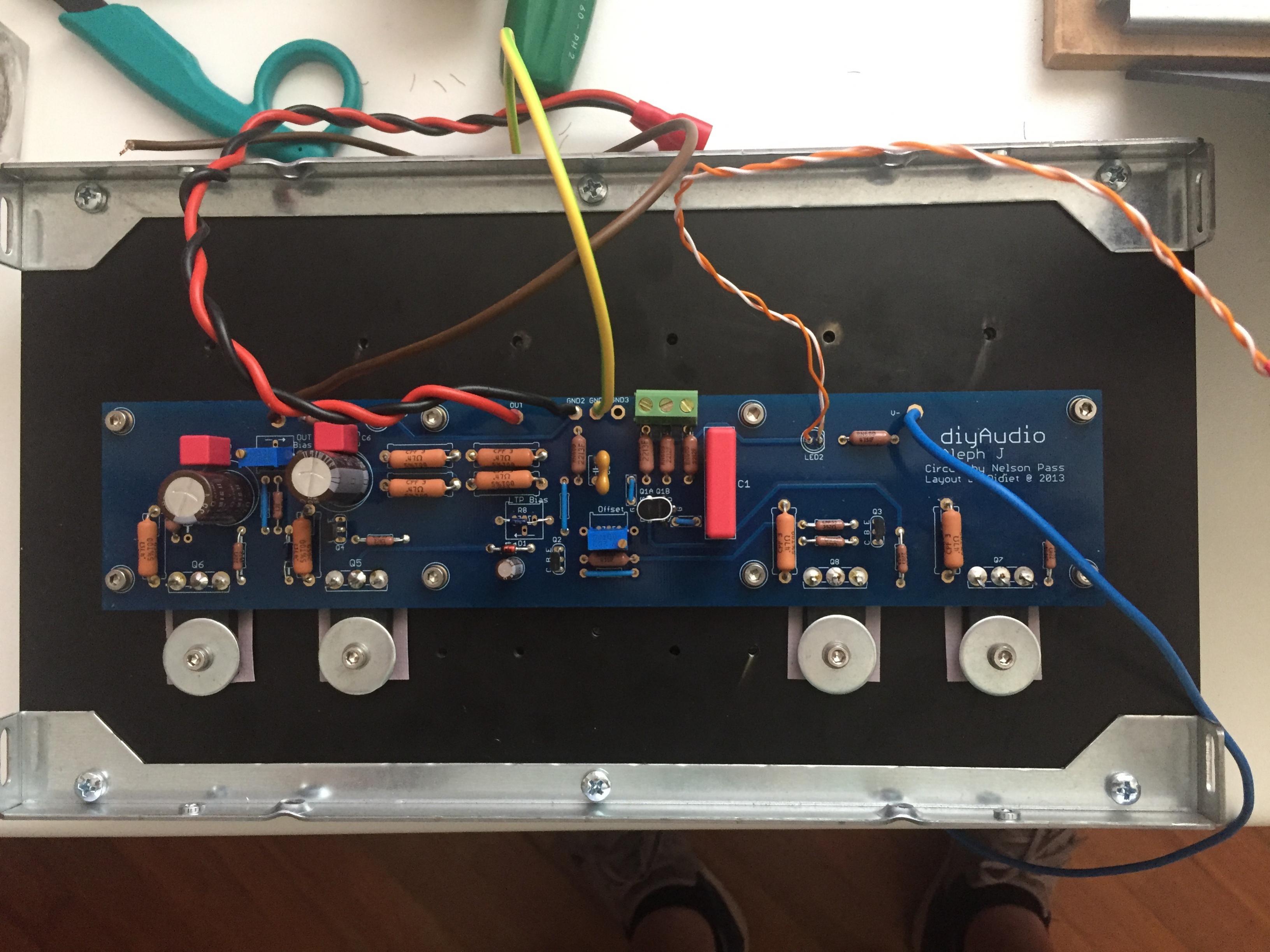

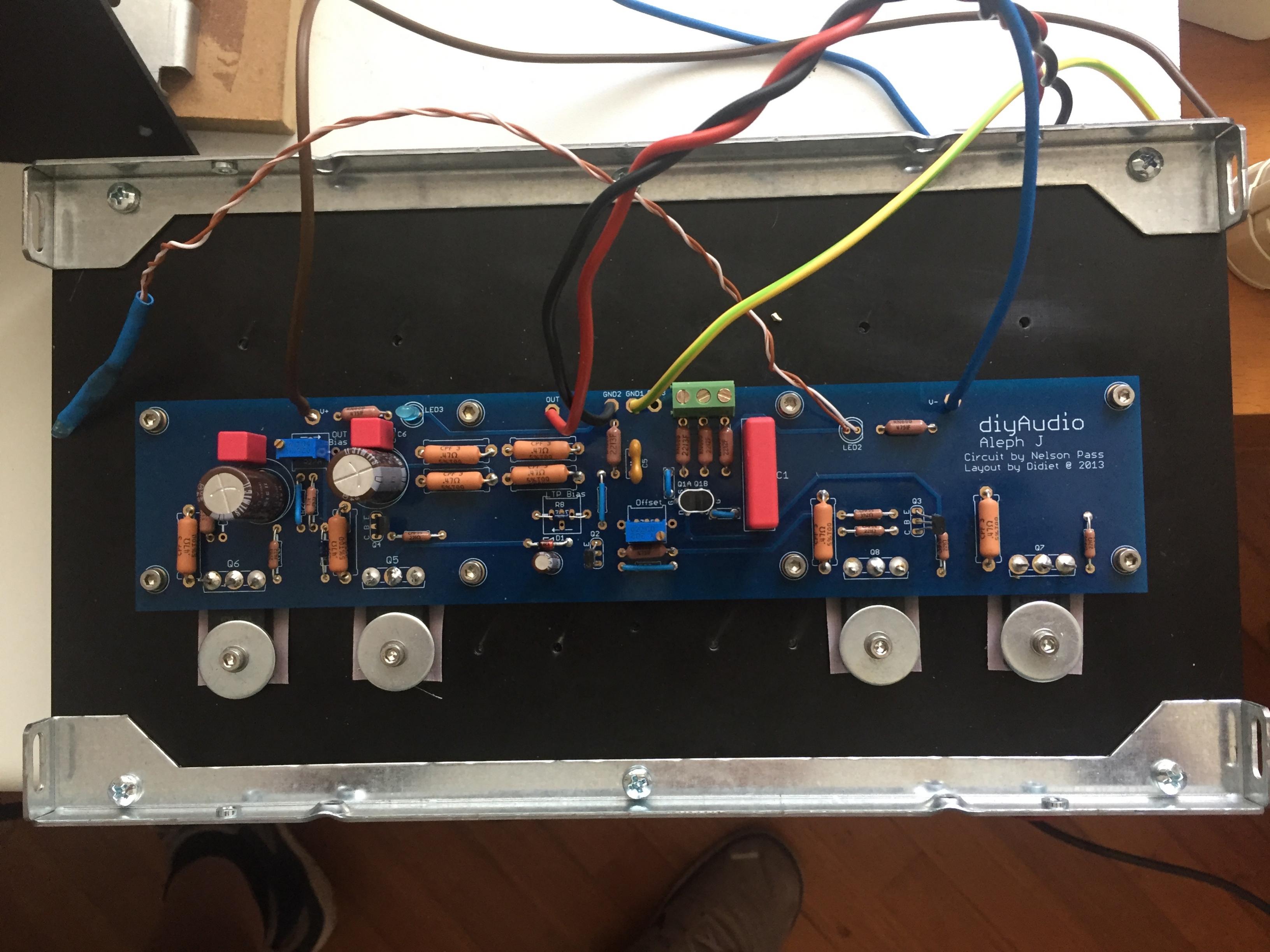

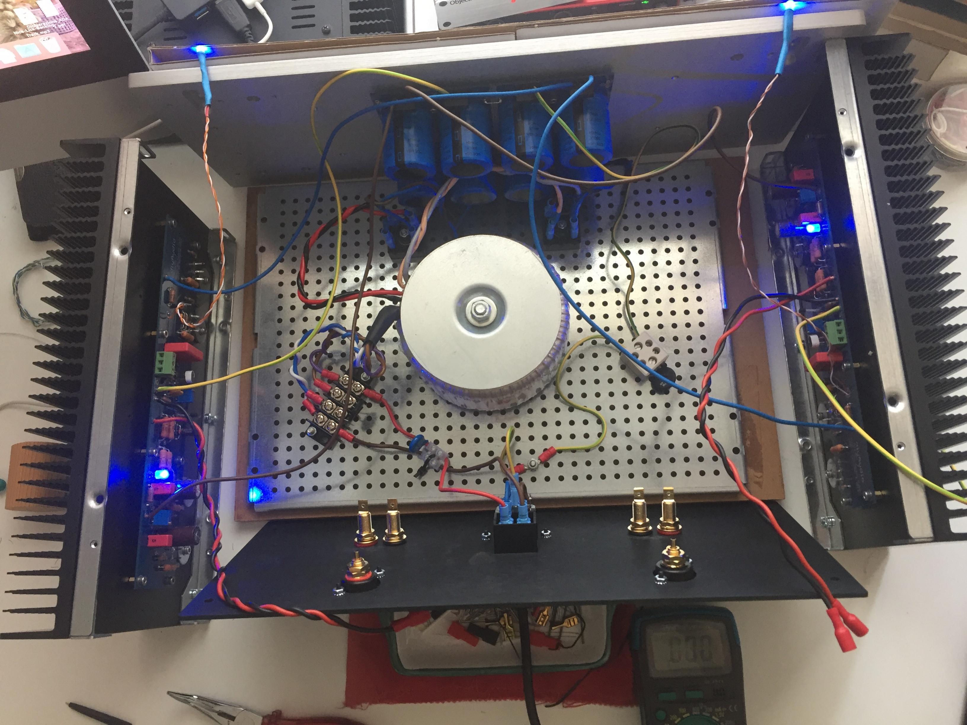

Here the pics.
In the order: PSU test, left channel, right channel, all amp switched on

I can't see R25 resistor mounted. Is it there?
Agreed. Where is R25? It should be next to C2 on the board and it appears empty in your pictures.
OMG! I completed tha amp boards a couple of months ago, and I thought I finished.
Thank you, let us see if this the only error 😱

Adding R25 was a success, obviously... you would say! I could adjust bias to both channel. Not sure if this evening I have the time to try to get some music out from the amp 🙂
Thank you for your invaluable help

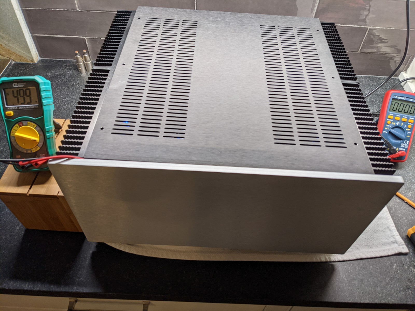

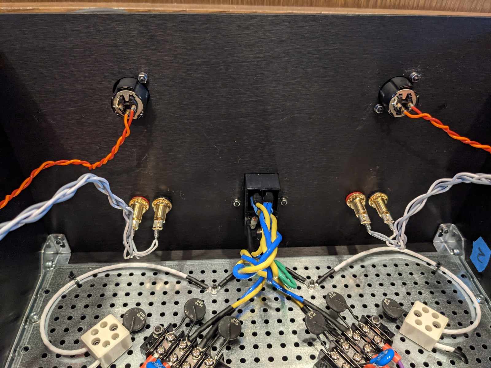

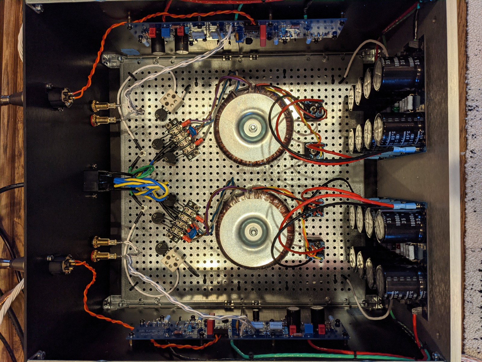

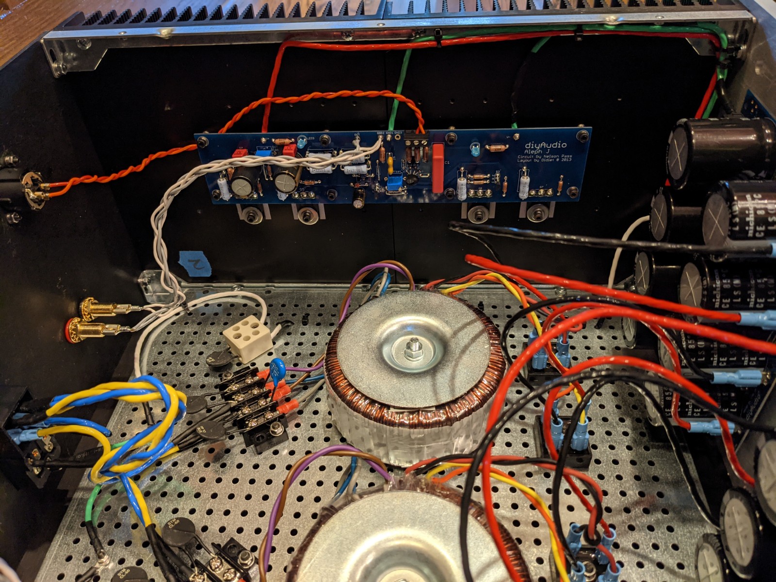

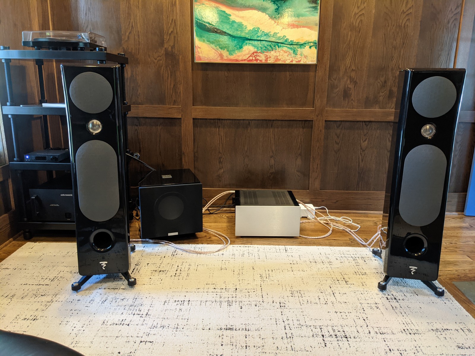

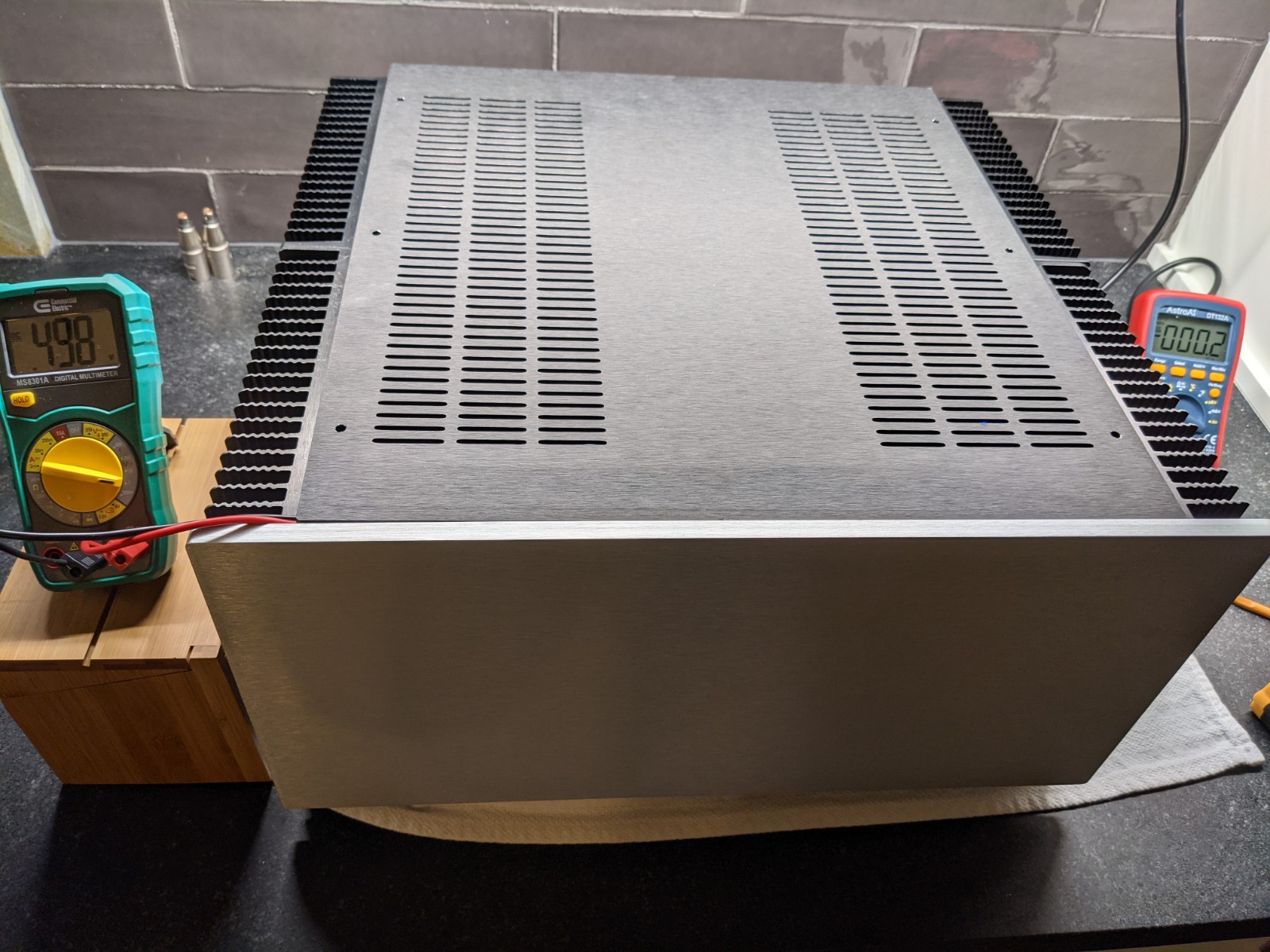

And another Aleph J is born! Finished it up last night. With the 5U chassis, I'm running about 500mV across R27. One of the MOSFETs is up at around 66C after running for a couple of hours with no signal, but I figure (hope) that should be fine.
I hooked it up to my system, and it sounds fantastic! I wouldn't say it sounds better or worse than my old ARC Ref 110 - just different. Couldn't have asked for a better result.
I also just want to say how fabulous this community is. The resources you all have put together are incredible. It's amazing that someone (me) who has never used a soldering iron before was able to build this amp relying almost entirely on the various posts and information you've put together. So thank you!
Now onto the next project - either a F5 (so I can swap boards out) or a preamp.
P.S. Eric - I assure you that my workbench is nastier than it looks in the previous picture that I posted. Though, I do use cut up Amazon boxes (which are in unlimited supply around here) to protect it from too much paint, etc. getting onto it.
