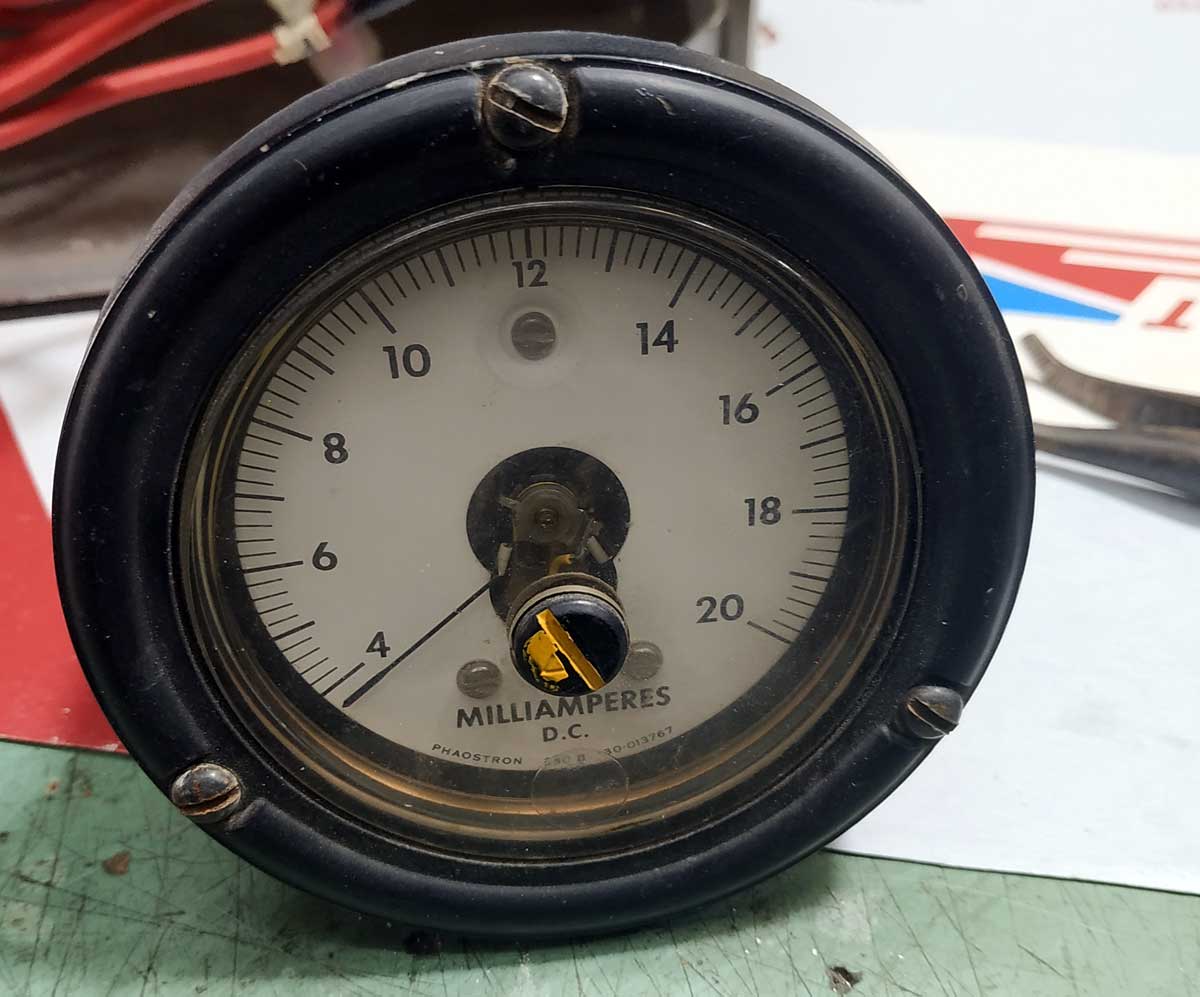

Just a curiosity: what is the best way to implement a bias meter like in Papa's .8 series?

Pa is using sensitive instrument, measuring voltage sag across one wire in PSU
while steady - it's A Class
when it moves, it's A Classsssss
when it bounces, you're stone deaf - you didn't heard KlunK!
connect your meter across any of source resistors, put 10K ( or more if needed) trimpot inline, put 100uF across instrument
if you give me data for instrument, I'll be more precise about trimpot and ease of setting

It would be nice to find a similar scale in a meter
easier than you think
local surplus places/junkyards
obviously - any bigger Vendor
and of course - fleabay and Ali
do not expect to find PL knockout meter ( even if you can find them, together with case) ; if you want same look - you can't avoid CNC work
if you are content with any other style - plenty of meters to choose from - our Chinese brothers are making everything, and more
example of lucky find (persistent one is always given) , post #678 The Singing Bush
you need to search for either mAmeter or Vmeter
in core, they're all the same , what's different is just printing on scale - so you need to choose what's available
nowadays is easy yo make your own scale ( whichever way - paper, Alu sheet, plastic) and print even ZM is Smartest of them all), if you want to
me - I'm happy with mA, maybe if V are printed that would bother me more ..... but frankly - I'm pass the stage of being nitpicky about anything I'm doing for my self - I just postpone it to time when I can do it exactly as I wish, without too much efforts
read wiki page about D'Arsonval meters, and you'll know basics Ammeter - Wikipedia
they're simple and surprisingly sturdy, considering how easy you can ruin them , with fingerpoking
usually important data is how many uA or mA is needed for full tilt, sometimes you'll also get Rdc of coil, sometimes V needed for full tilt
in praxis - 95% of meters you can stumble on can be used for your purpose

though - being Ameter, count on some fingerpoking inside, to remove internal shunt
remember - you already have source resistor in circuit, all you need is to sample some voltage across it
I need to fingerpoke also to place two LEDs inside 😀
Voltage reading is across 51K R23, right? Setting is @400mV, so do I need a 1V meter to match the center or something with a scale in Ampère that would display the real current (maybe better)? as standard current is 0,85A, I could pick a 2A full-scale, remove internal resistor and add a trimmer...
