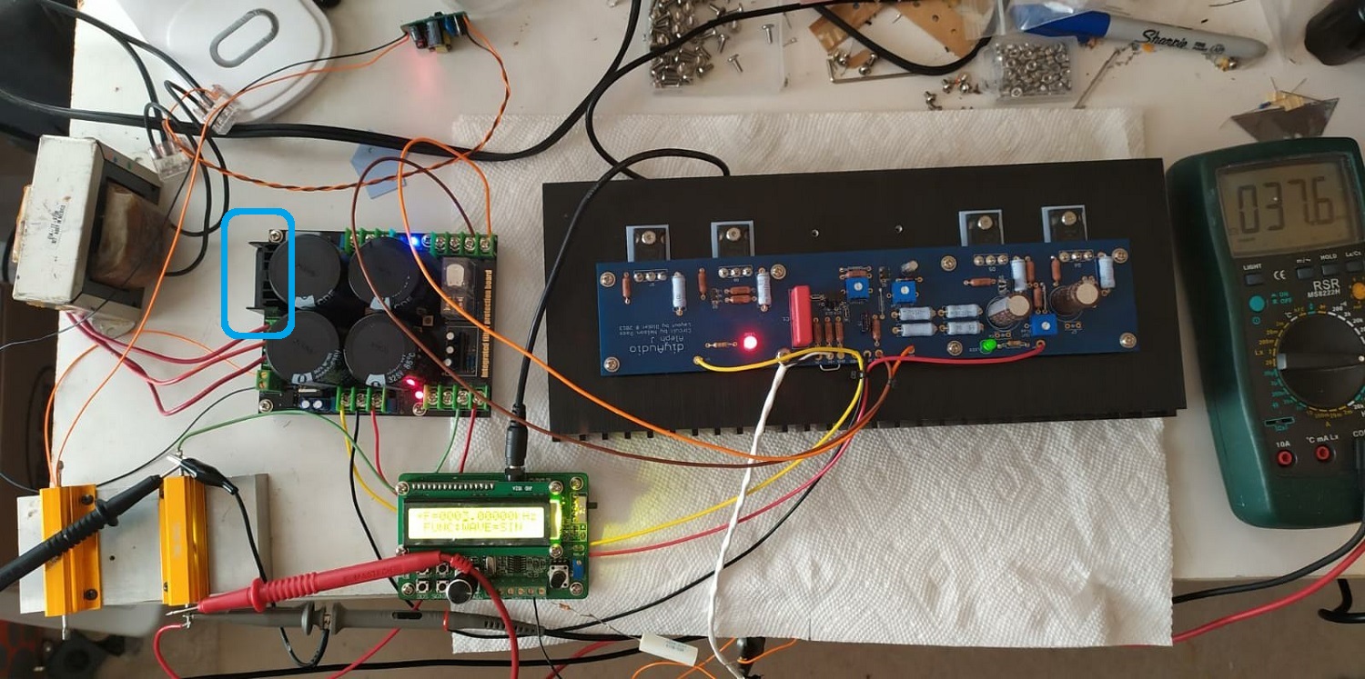

Some progress on my Aleph J build
I just tested two individual channels of my Aleph J using a +/-12V transformer and both boards are working fine!
During testing, the bridge rectifier which is on a small heatsink, got pretty hot to touch. I am using the following part. Do I need to go for anything bigger?
GSIB1560-E3/45 Vishay General Semiconductor | Mouser
For now, I am going to assemble this in a smaller chassis, so I am thinking of using 2x16V toroidal transformer on each side.

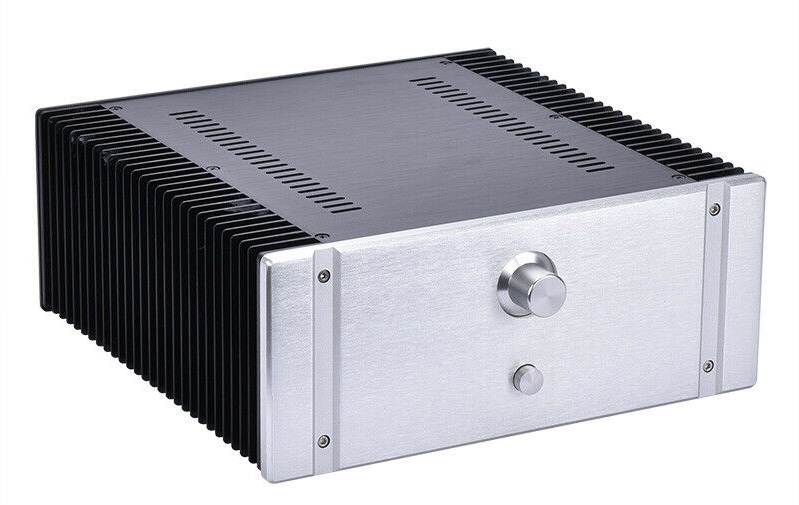

Chassis size:
External: 320x130x313 mm
Internal: 220x122x300 mm
Heatsinks: 300x50x130 mm (approx 3U x 300mm)

Bypass capacitors C6/C7 were out of stock when I ordered the BOM:
MKP2D031001F00JSSD WIMA | Mouser
Would these work for those two bypass capacitors?
FG26X7R1H474KNT06 TDK | Mouser
I am under the impression that MLCC's are good for bypass

I'd go with WIMA polypropylene dielectric, which has the lowest distortions for audio coupling duties. You do not necessarily need to use 0.1uF. Consider 0.47 or 0.68 or even 1uF will do nicely as well.
I'd avoid the Multilayer Ceramic dielectric at all costs - in audio signals coupling applications.
