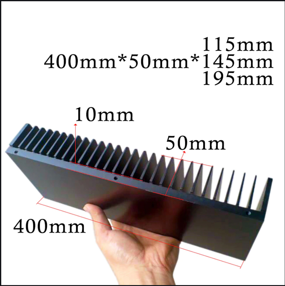

I'm in process building Aleph J. I have relatively small heat sinks measured 400mmx115mmx with fins 50mm.
Mounting fans directly on heatsinks outside of chassis is not what I want.
Is there any benefit mounting fan (or two fans) on the back of the chassis blowing air in side???

That heatsink is indeed quite small.
For the best results, you would have to place the fans underneath the heatsinks, blowing upwards. Maybe 4 or 6 fans in total, 2 - 3 per side...?

You can put two heat sinks together and make some kind of tunnel. Then you can put 100x100mm pwm fans on the ends of the tunnel. It would be more silent then smaller fans underneath.That's exact heat sinks that I'm going to use...
Probably it would be the best solution to put small fans underneath... I'll figure something
Thank You very much on Your help

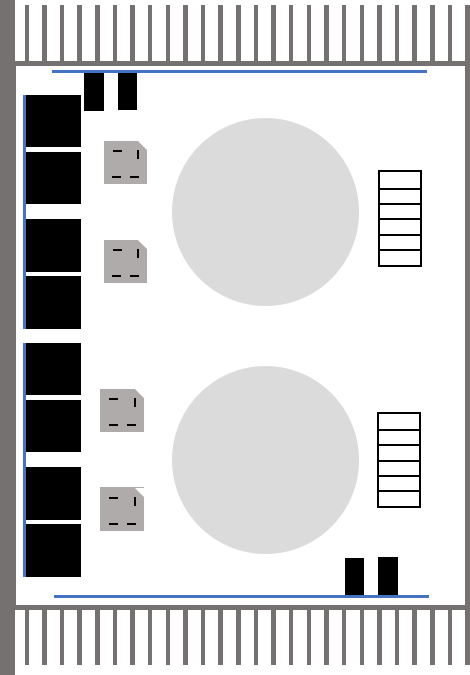

I’m hoping to guild an Aleph J set up as dual mono and I’m trying to see if it can fit in the DIYAudio Store’s 4U deluxe chassis. I was thinking about putting the filter capacitor boards on the front of the chassis and leaving the toroids flat against the bottom. I started to put together a wiring schematic for myself, but I noticed that C2 & C3 on the amp board might not squeeze by the filter capacitors (see the pictures below – the location of the caps on the amp board are approximate; the rest should be pretty close). Using shorter caps on the amp board could help, but is there a concern in having the amp's caps so close to the filter caps? Has anyone else attempted this, or am I just trying to squeeze too much into too shallow of a chassis?
That's the exact heat sinks that I'm going to use...
Thank You very much for Your help

Consider what dabochkarev is saying as well.
If you stick with something similar to my suggestion, run the fans at 10V DC, which will provide sufficient airflow, and will make them less noisy.
You can choose very quiet fans as well, like Fractal Design, 12V DC. Running these at 10V DC will make them completely quiet!

The good thing about C2 and C3 is that you could try to mount them parallel to the AMP PCB, by extending their leads a bit to allow for a 90deg bend, if you absolutely must do so... The PS caps and the C2&C3 can reside close to each other, as long as the exposed aluminium surfaces at the top are not touching.

As ZM wrote me, better to go for Dissipante 4U/400mm for dual mono and make holes by your own
