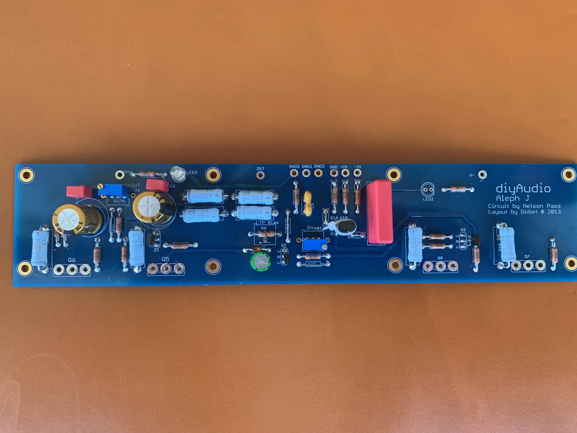

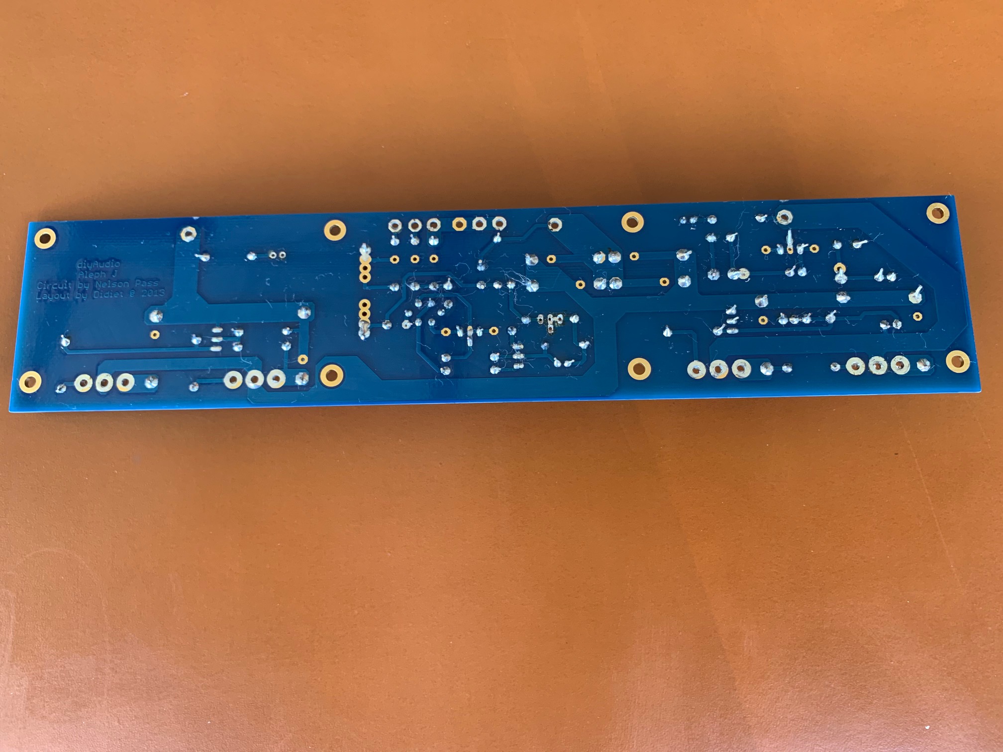

Patrick suggested that I reup the photos of my bad board so that anyone could offer suggestions as to potential errors. I cleaned the board of most of the flux to make things clearer so please forgive the blue lint from the shop towels that I used to dry the isopropanol. I didn't see it until after I took the photos. If anyone has any suggestions or sees any obvious errors please let me know. Greg was wildly generous and sent me some matched MOSFETs, which should arrive this week. An enormous thank you to him. I hope to be able to help someone else similarly in the future. Thanks for everyones input in advance,

Keep at it, this amp is worth the trouble to go through. You will be so glad you did.
I really hope this thing straightens out in short order. You seem to have followed all the basic instructions with great care. Also you didn't introduce any "better ideas" or "improvements" like many with problems have done.
You read and take everyone's advice. I know I am stumped!
Russellc
This probably isn't it, but check your jumper in position j2 next to the big wima on that one board. The backside looks like it could be reflowed with a bit more solder.
R17 looks like it may have seen the heat of battle. That is most likely a result vs. cause. If upon closer inspection, it looks discolored - I'd consider replacing it before installing the new MOSFETs. There may be other things too. That's why I love posting pics to the forum.
