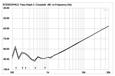

It may well do the job adequately. The only Aleph crosstalk measurements I can find quickly are for the Aleph 3 as measured by Stereophile: Pass Labs Aleph 3 power amplifier Measurements | Stereophile.com. To my knowledge, both channels share a PSU. Can you hear this? I don't know.
If there is no electrical connection between the two channels, this crosstalk is effectively impossible within the power amplifier itself (it may still occur in other devices in the signal chain). Using two power supplies - each with its own transformer - moves the shared direct electrical connection to the AC power connection, far away from the signal and with lots of filtering in between.

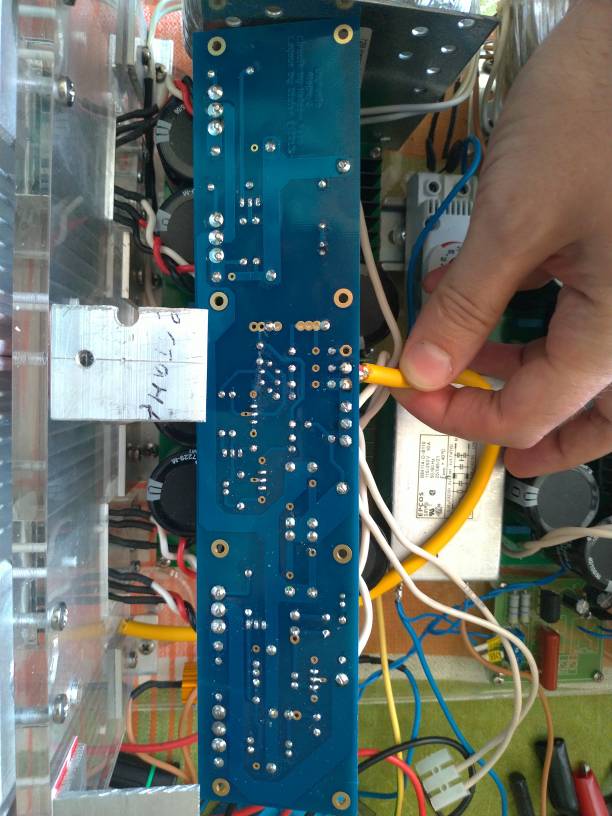

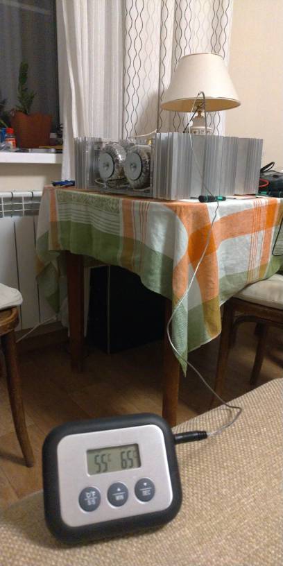

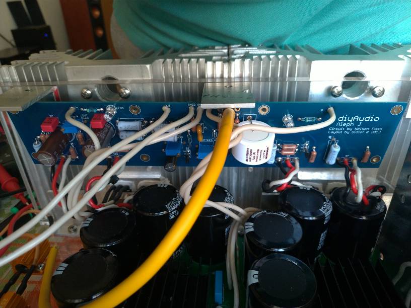

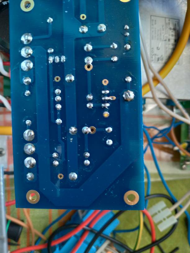

Hello, guys. Today's morning i tried to fire up my aleph j boards. One channel started perfectly. I can't control output bias in other channel. Rail voltage is 22-0-22. R27 is set to 68k. I measure 0.56V drop on the R18 resistor. Turning of the r27 makes nothing. Voltage drop across the R18 is constant.
Please help me.
Please help me.
Thank you all. i solved my problem. the problem was fear) i was afraid to rotate R27 to much. Now i set output bias on both channels.
