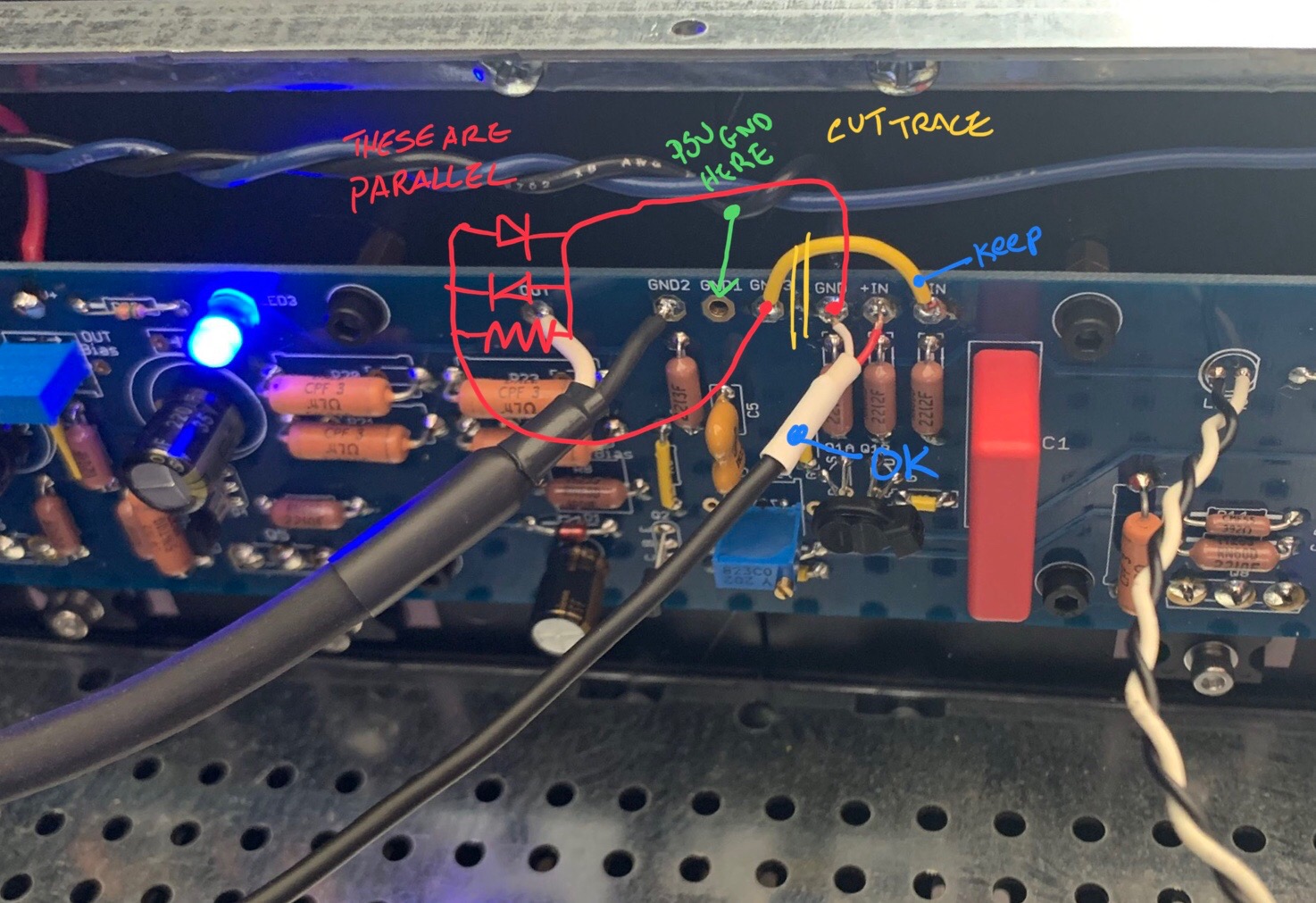

back with an odd question that I dont think I've seen asked here at all.

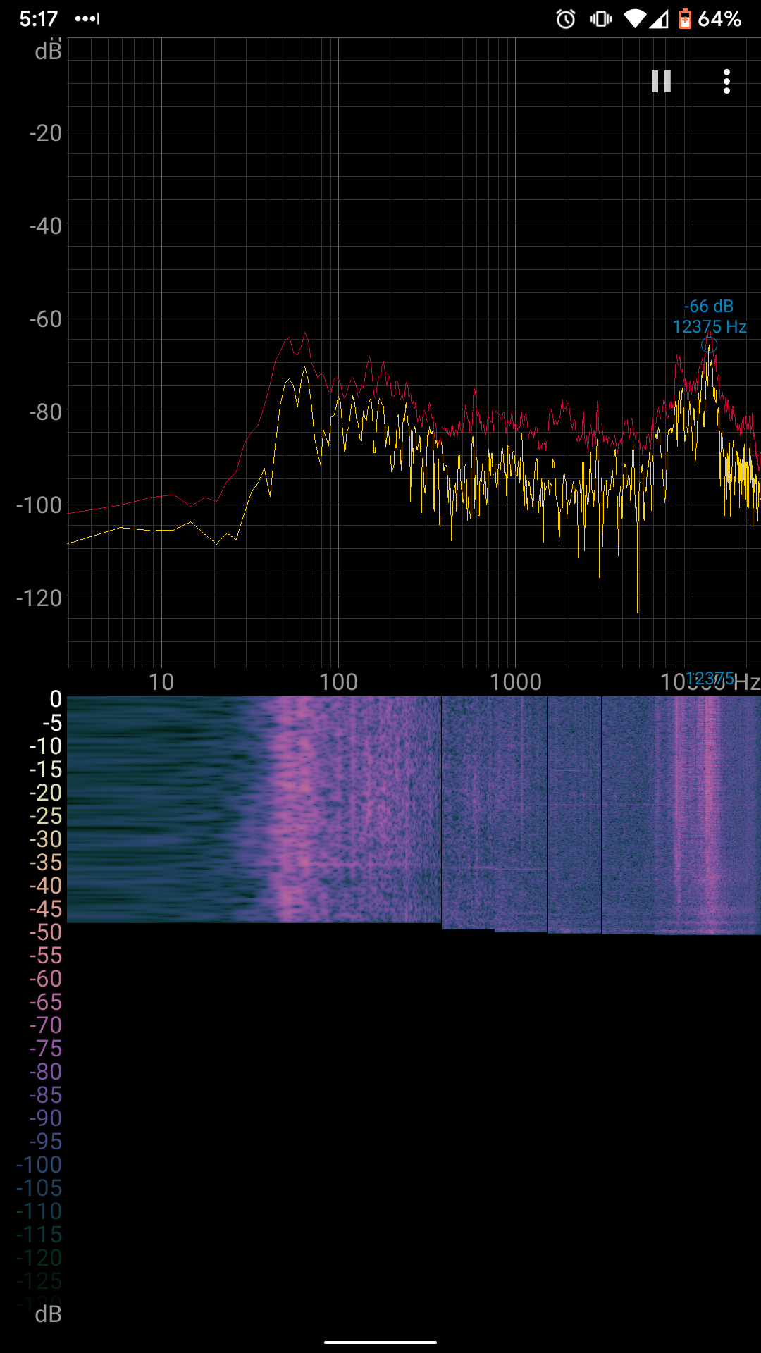

The aleph output to the speakers itself is dead quiet for me, but im now just noticing a high frequency whine near 12khz (according to a cheap0 spectrum analyzer app) coming from the chassis. Is this normal? Any component I should focus my attention toward?
Didnt notice it till now because i just moved the amp somewhere it's easier to see/hear/reach and I fixed some loud buzz on a different component.

since ive posted this I've noticed that the 12khz whine stopped but then came back, at least on two different occasions. When it goes away I can more clearly hear a more typical? 60/120hz noise that one might associate with transformers and rectification. I'm assuming this mechanical noise coming from the chassis is somewhat normal. That right?
still a little unsure about the 12khz whine though. Just to be clear, this noise is unrelated to the signal amplification at my speakers and is noise at/from the physical object itself. Was expecting the unit to be more or less mechanically quiet.

The 12kHz noise comes (and then disappears <- a common symptom / common issue) from the mains supply; try using the IEC connector with an RF Filter, or make one (the filter) yourself. The transformer snubber (I think it is called Quasimodo around here...) can help as well.
It is unlikely that the oscillations come from the PCB (MOSFET's), but this can be confirmed with an oscilloscope whilst the input RCA's are "shorted" to ground.

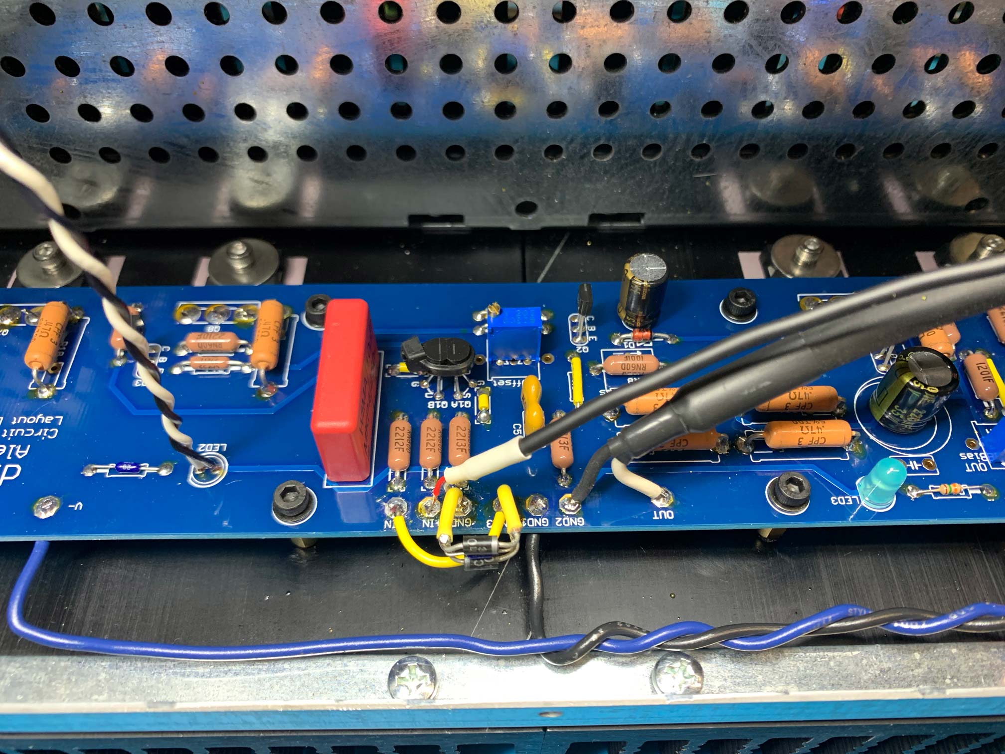

The 120Hz buzz: a 10-20ohm ground-break resistor is required to stop this buzz; see post #4909.

...The 120Hz buzz: a 10-20ohm ground-break resistor is required to stop this buzz; see post #4909.
Here ya go. (credit: 6L6)

Input snubber is already in place per quasimodo.
Will look at an RF filter for the mains. Likely have no room for the IEC's with the built-in filters I've seen so it would have to be a ferrite bead or something. How do I go about selecting the right one? I briefly looked into this during my build but was overwhelmed with the options so figured I'd delay it until it ever became a need.
