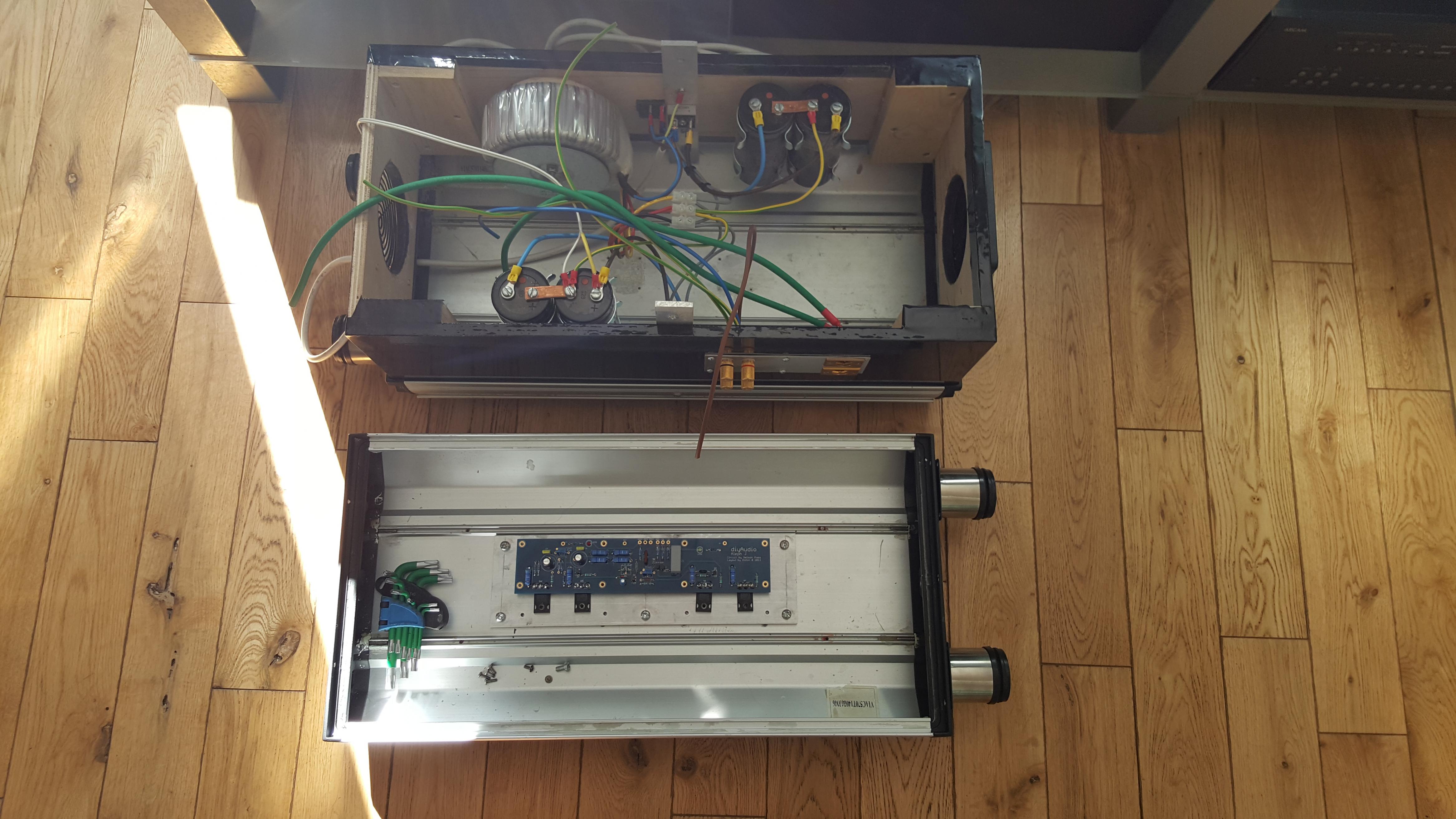

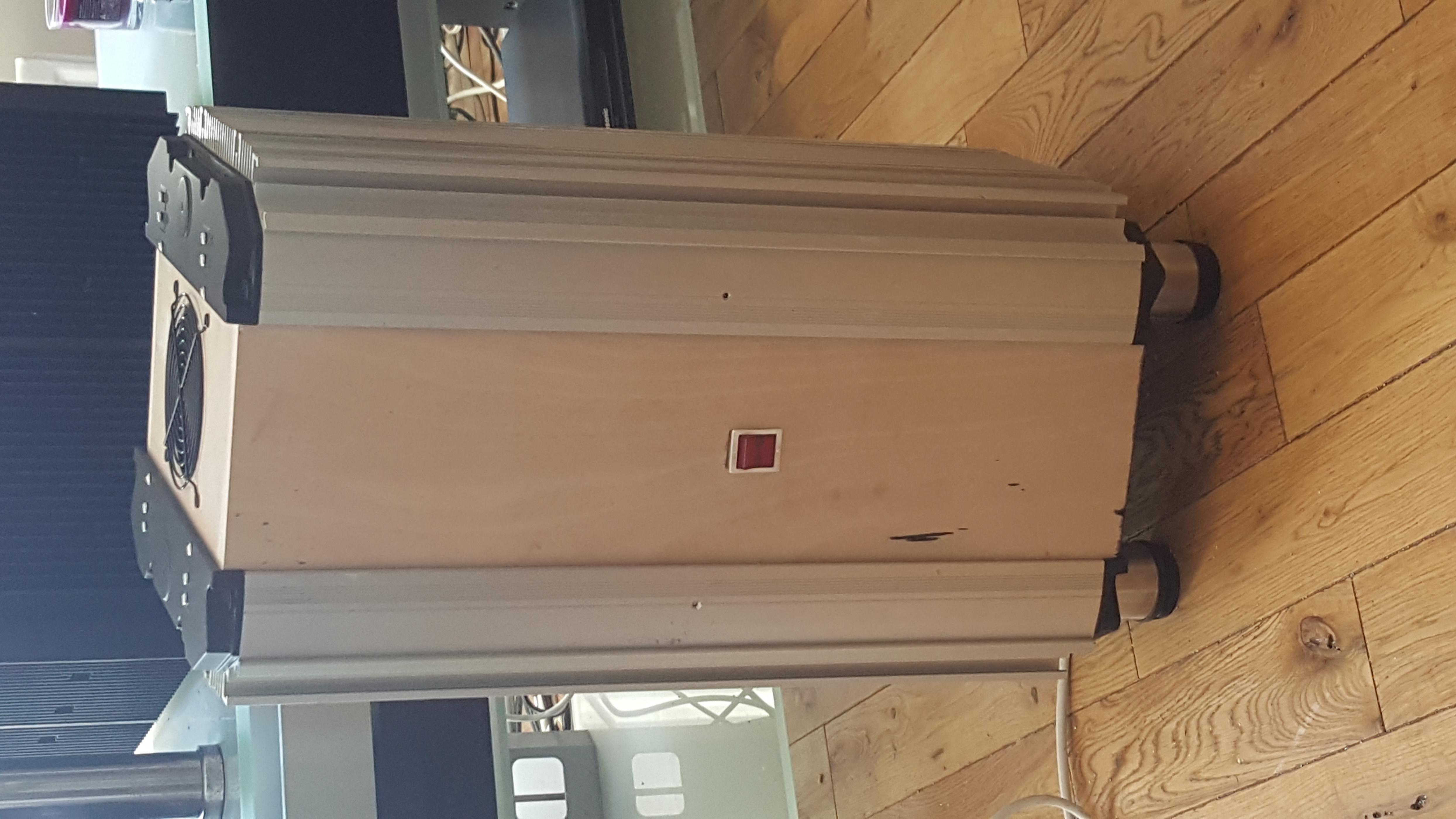

Almost ready for final assembly
I'm now just waiting for some hardware (bolts) to arrive in the post.#
The Aleph J is almost ready for assembly.
Since my last post and learning from some other posts, the 300VA 15-0-15V transformer has been replaced with a 500VA 18-0-18V.
The woodwork has received a piano black finish.
I've removed the fan so it is now just a chimney.
You might question why the Aleph J is on an aluminium plate instead of being mounted directly on the heatsink. The simple answer is that the heatsink appears to have become hardened and I was breaking 2.5mm drills trying to tap into it.
You may already have taken care of this, but if that mounting arrangement is going to be permanent, I'd put a good layer of thermal grease between the main chassis and the plate that the board is mounted to. You want to make sure you have good thermal contact between the 2 pieces. :)
