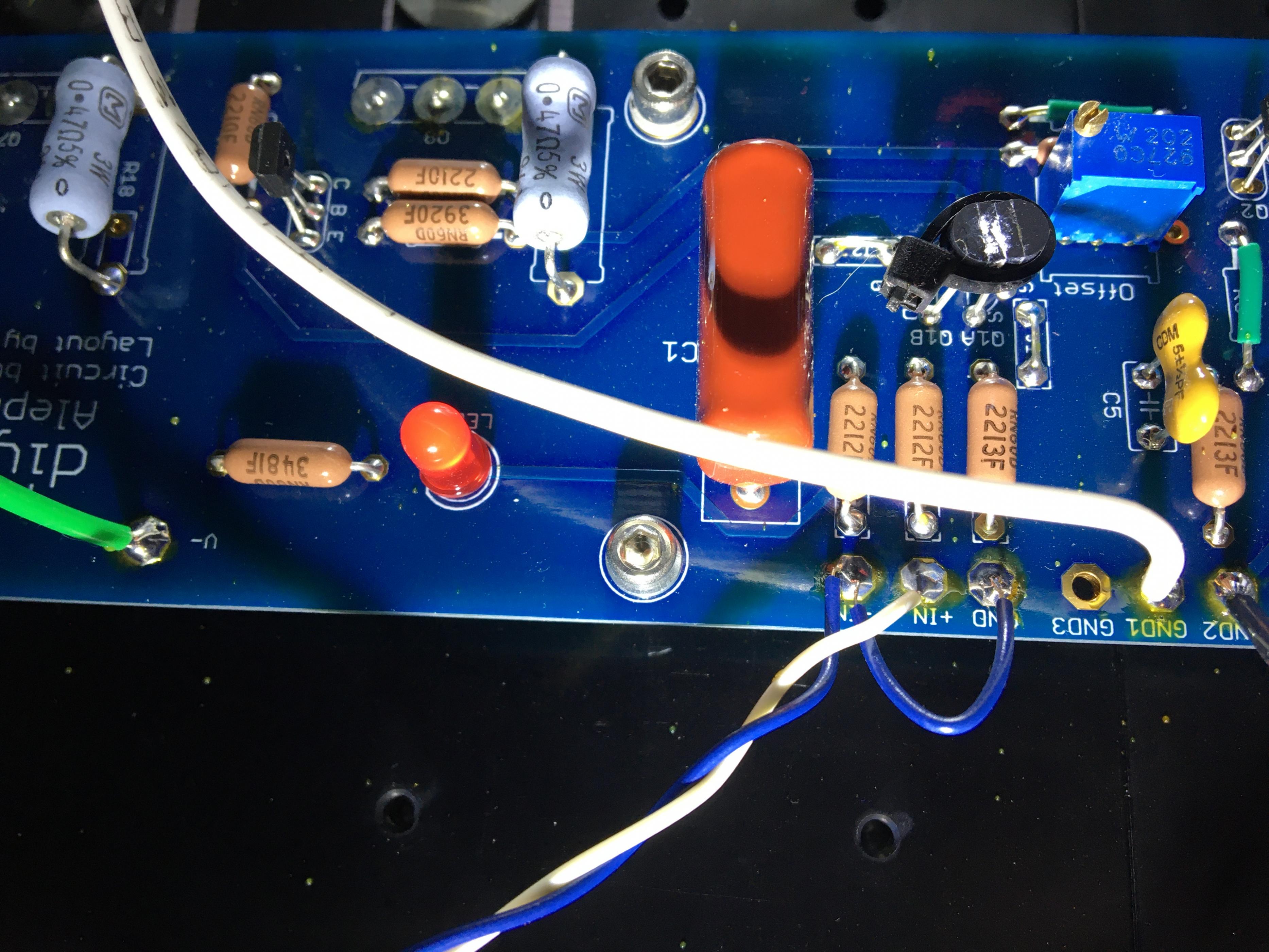

Do you hear that white noise when your Alep J is not connected to anything, i.e. no interconnects plugged in RCA's?
With only speakers connected and nothing plugged in RCA's, the white noise shouldn't be audible. If it IS, please post detailed photos of the input wiring and PCB's.

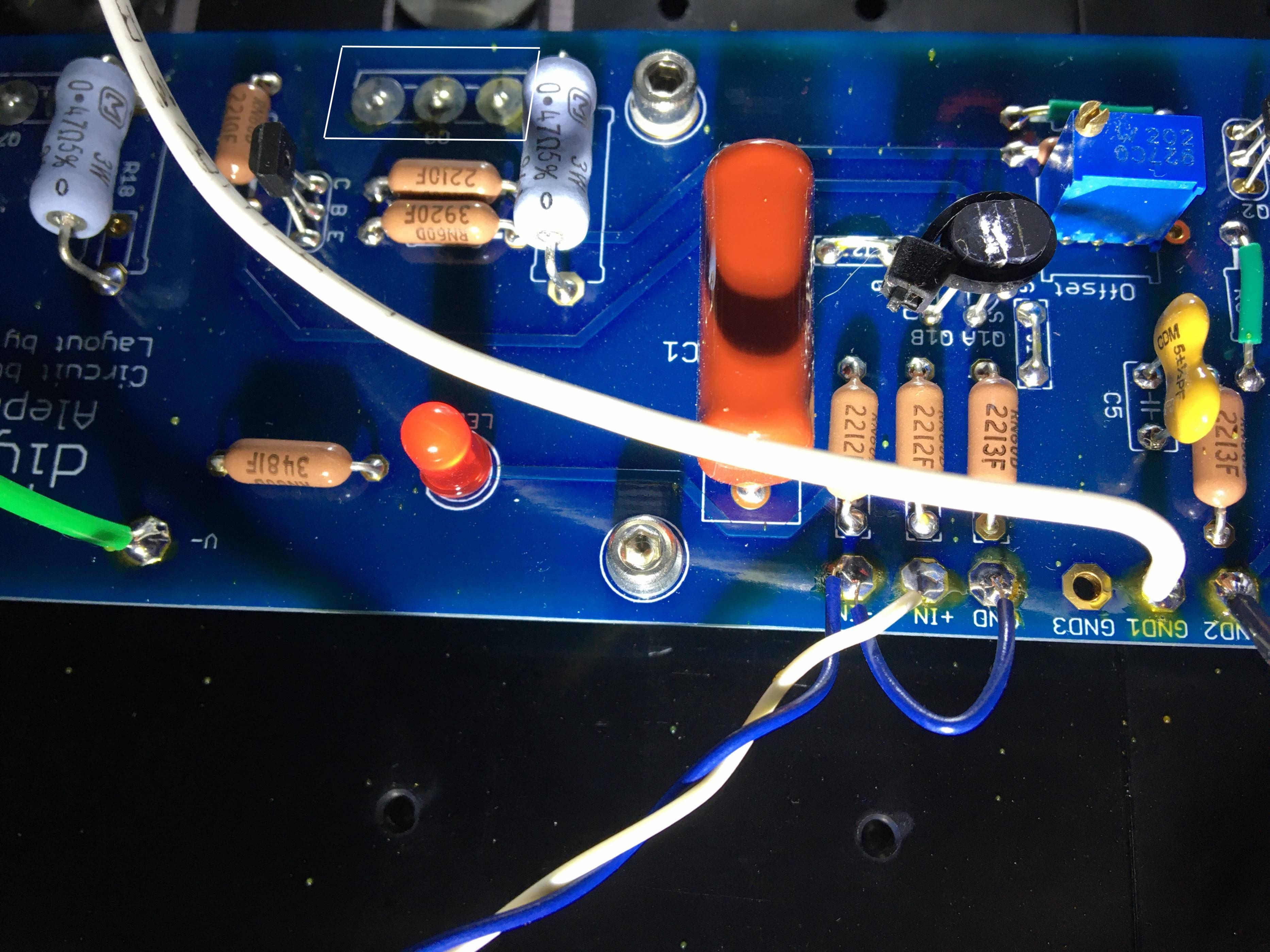

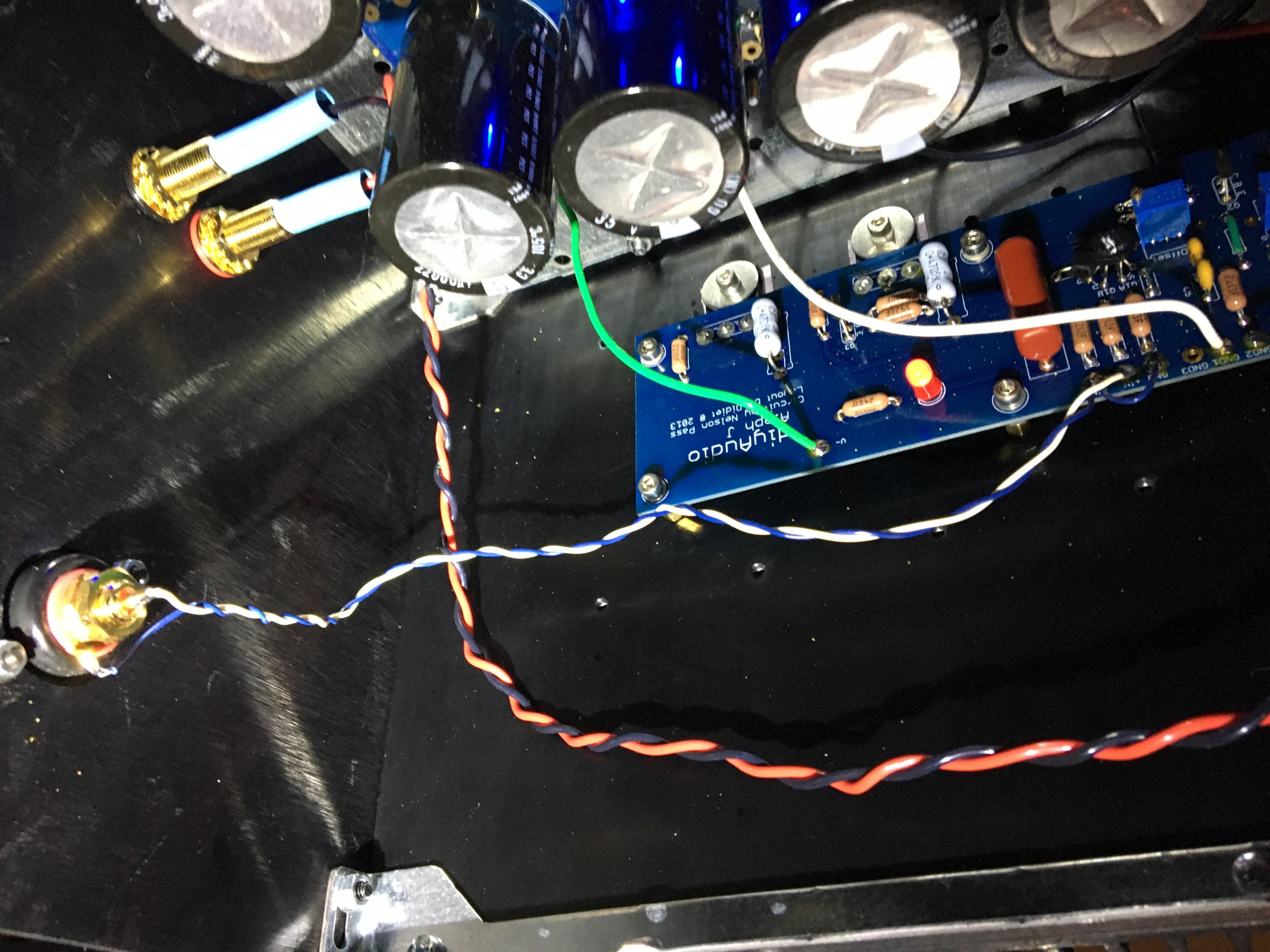

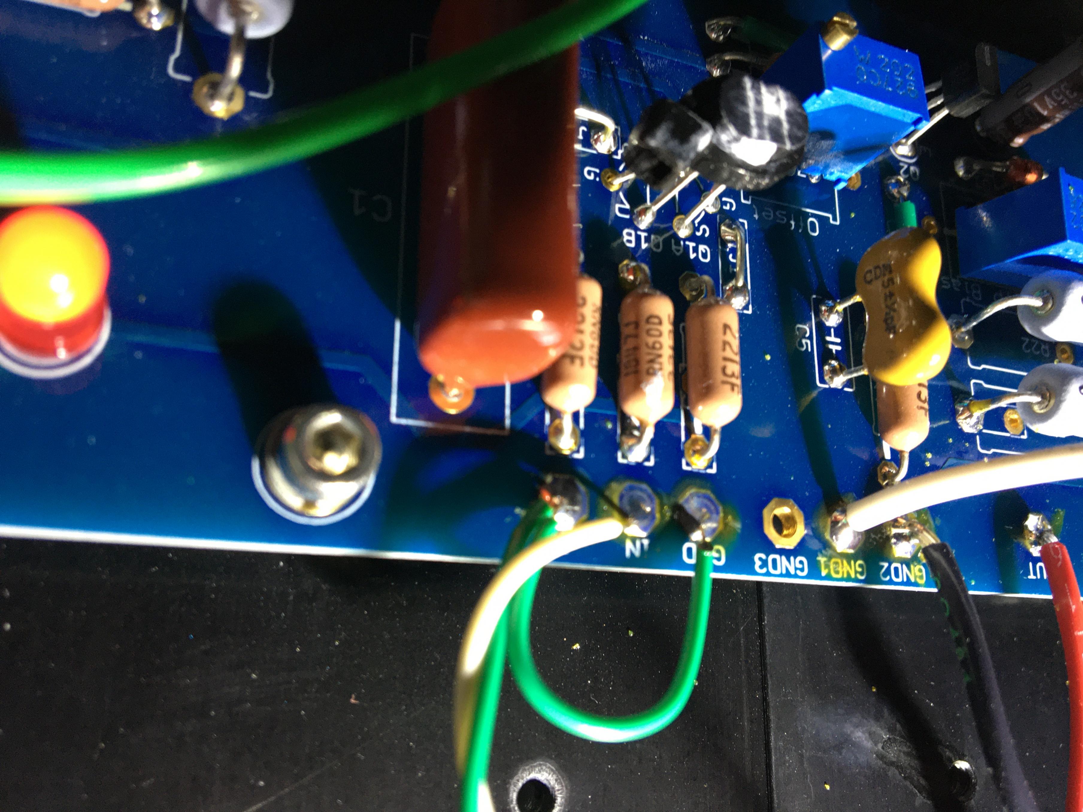

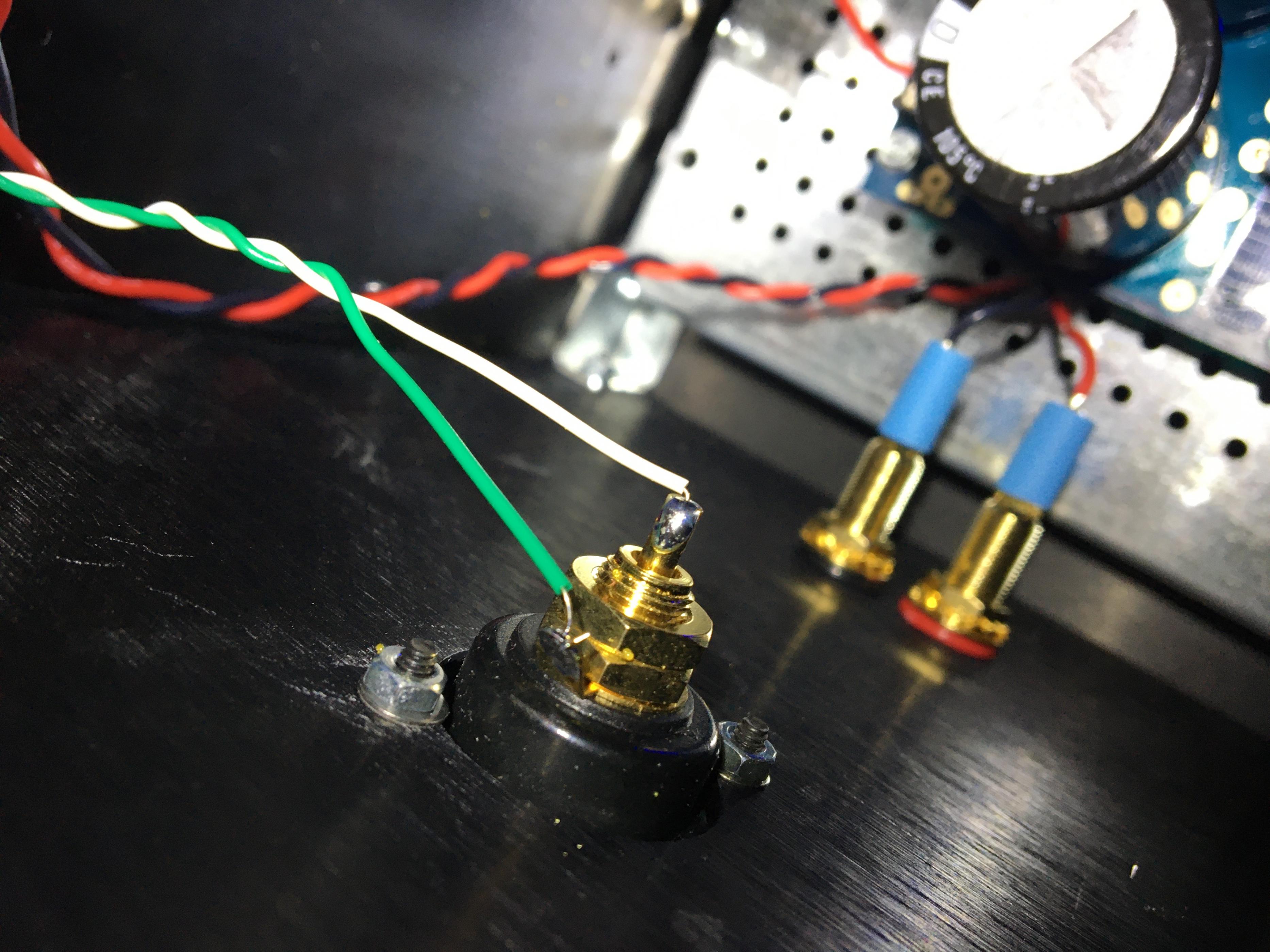

Well, the white noise was still there when I unplugged the RCA interconnects. It is faint, but still audible. Here are some photos of the input wiring. Thoughts?

Are you able to test with the inputs shorted? (You can make a cheap shorting
plug from a junk RCA cable by just shorting the signal and ground together)

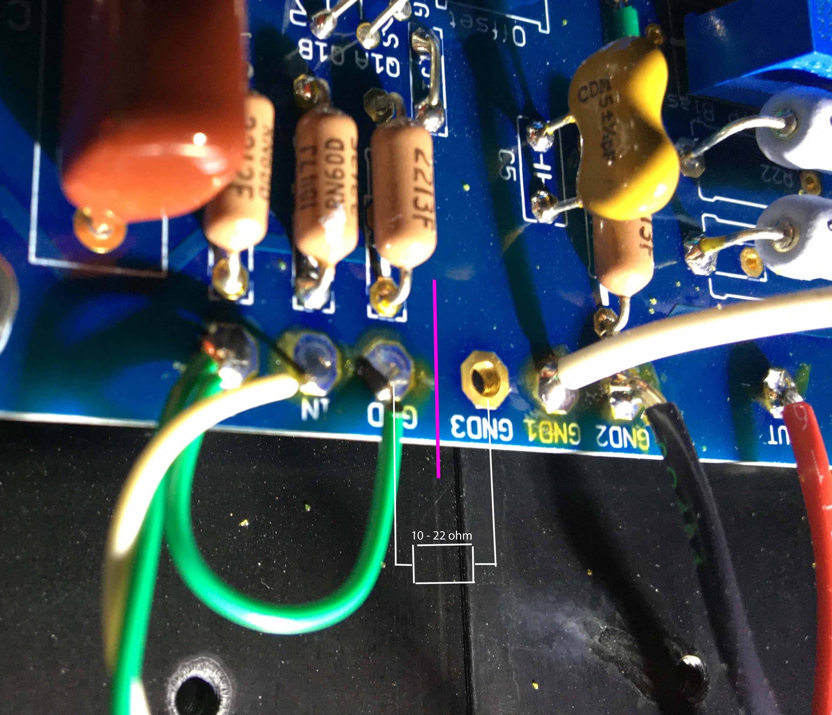

Your soldering is good. Just do the Extreme_Boky's hum elimination mod, as per attached photo. The pink line is where you should cut the PCB track underneath the PCB board. I used the 10ohm / 5W resistor without back-to-back diodes.
The second photo I attached will show you how to position the input wiring -> it should NOT run in parallel with the speaker wiring, but as close as possible to the chassis and/or heatsink.
Once you're done, and you mount/connect everything back together, MAKE SURE there's no conductivity between MOSFET's pins and the chassis.

Thanks, Dennis. I hadn't tried shorting the inputs yet. Just did and it virtually eliminated the noise.
Hi EB,
Why would it be required to use a 5W R in this position, just so I understand? I have already put in a 1/4W 10R on the back side of the board. Not sure what currents would be in the input ground?
Just in case of a fault current needing to go through that resistor.... you probably recall that others use a "back-to-back" diodes, to ensure the fault current would flow irrespective of which potential is the fault current sitting at, referenced to chassis. But, in whole honesty, I am thinking now that it is maybe better to use a smaller power fusible resistor, that will OPEN / BLOW in case there's a fault, which will ISOLATE the fault condition.
