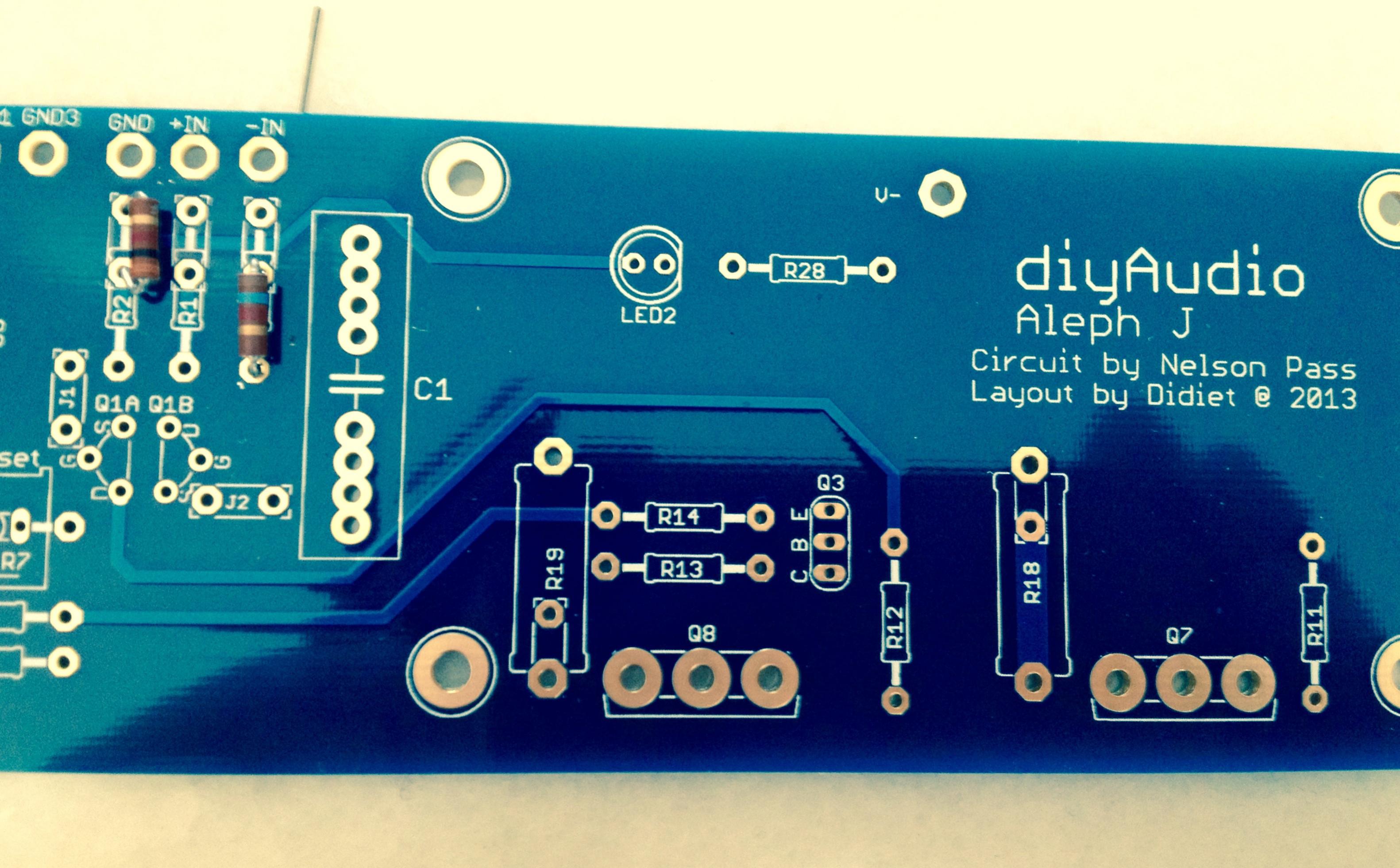

...or is it me? I bought the (2013 layout) boards from the diyaudiostore in Dec and have been accumulating parts, etc since. Last night I rough-filled one board and thought I was near to powering up when I tested resistance from input to ground (rca / single ended) and it was open. ??? said I. In the attached photo, I've put two allen bradley 1/4 watt Rs in alternative positions where Rs 2 & 3 go. The silkscreen for R1 is the same. Last night, the spacing and graphic led me to solder up the R3 alternative. In fact, the R2 alternative works (with kinda useless awkward spacing) and the R3 alternative (which is sized correctly) leaves the resistor shorted across itself. Same applies for the R18 alternative mounting(s) on the right side of the photo (and its kinfolk). So I'm desoldering eleven components. Has this not come up before / does everyone use large format resistors?
Always best to check the track traces on the board first.

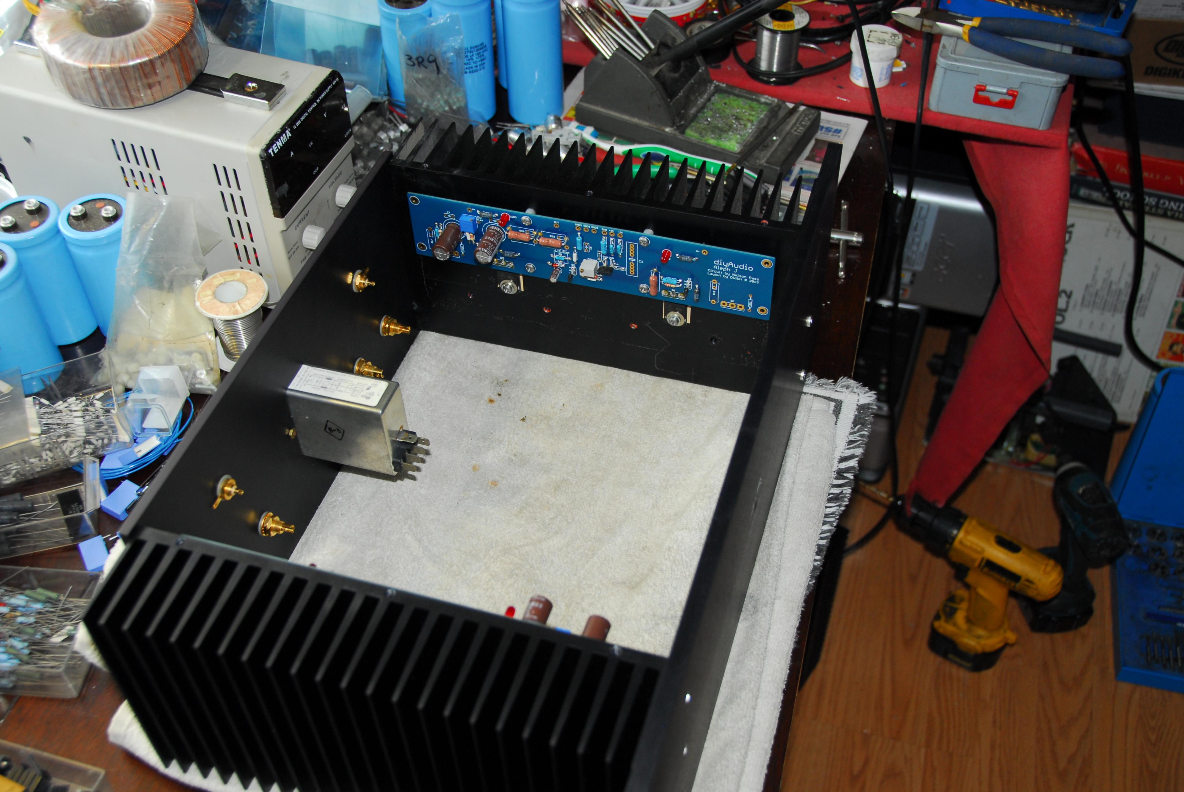

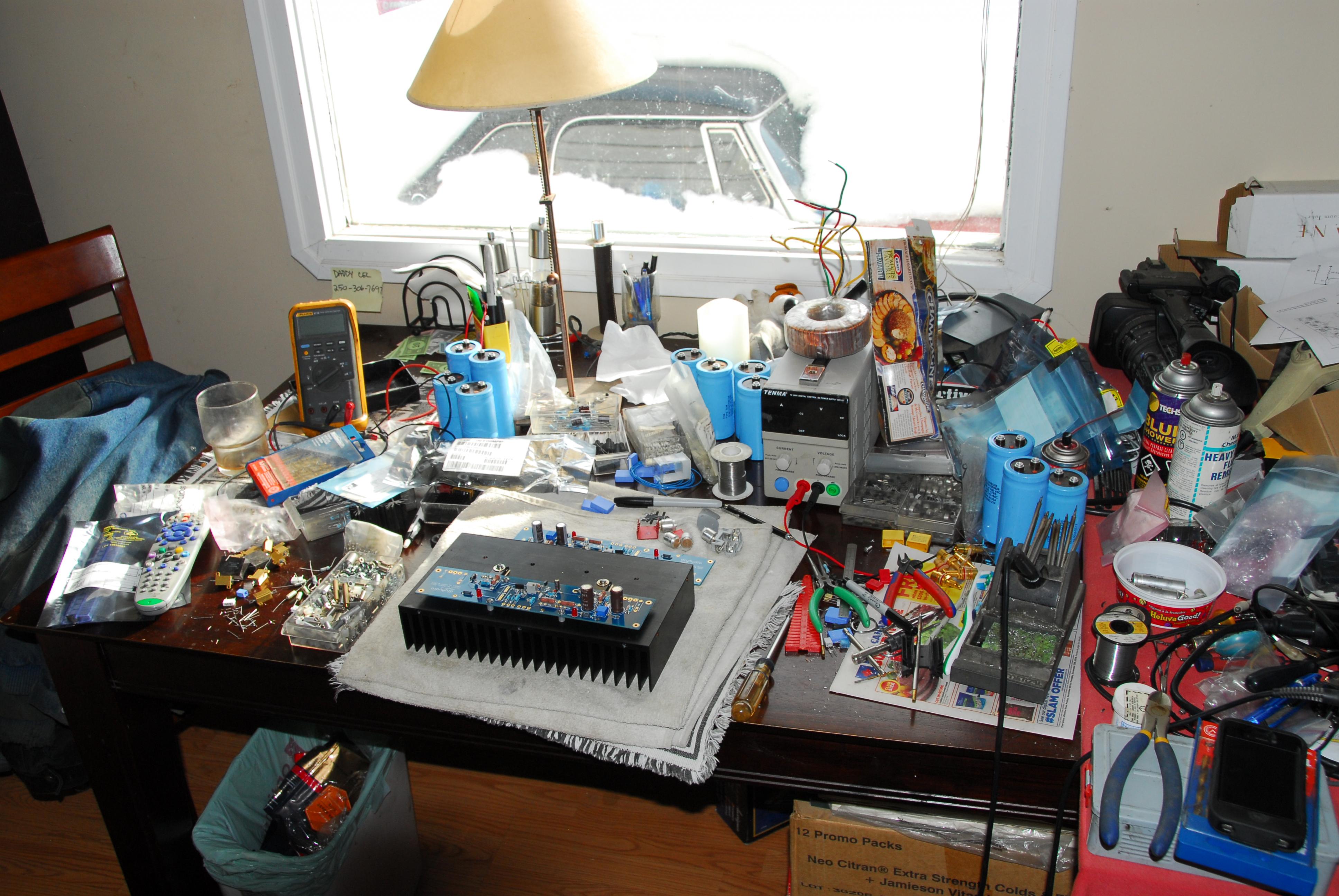

A few pictures of Muppet Labs attached. 😉
Cheers

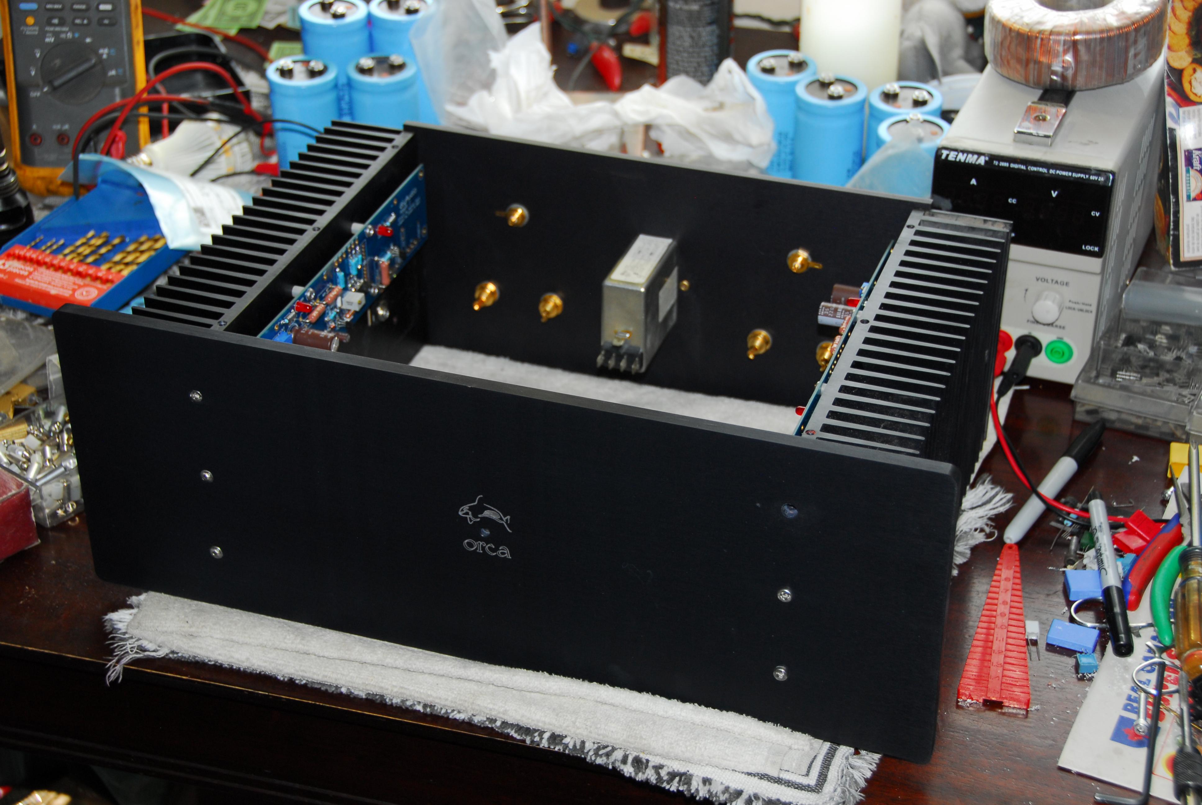

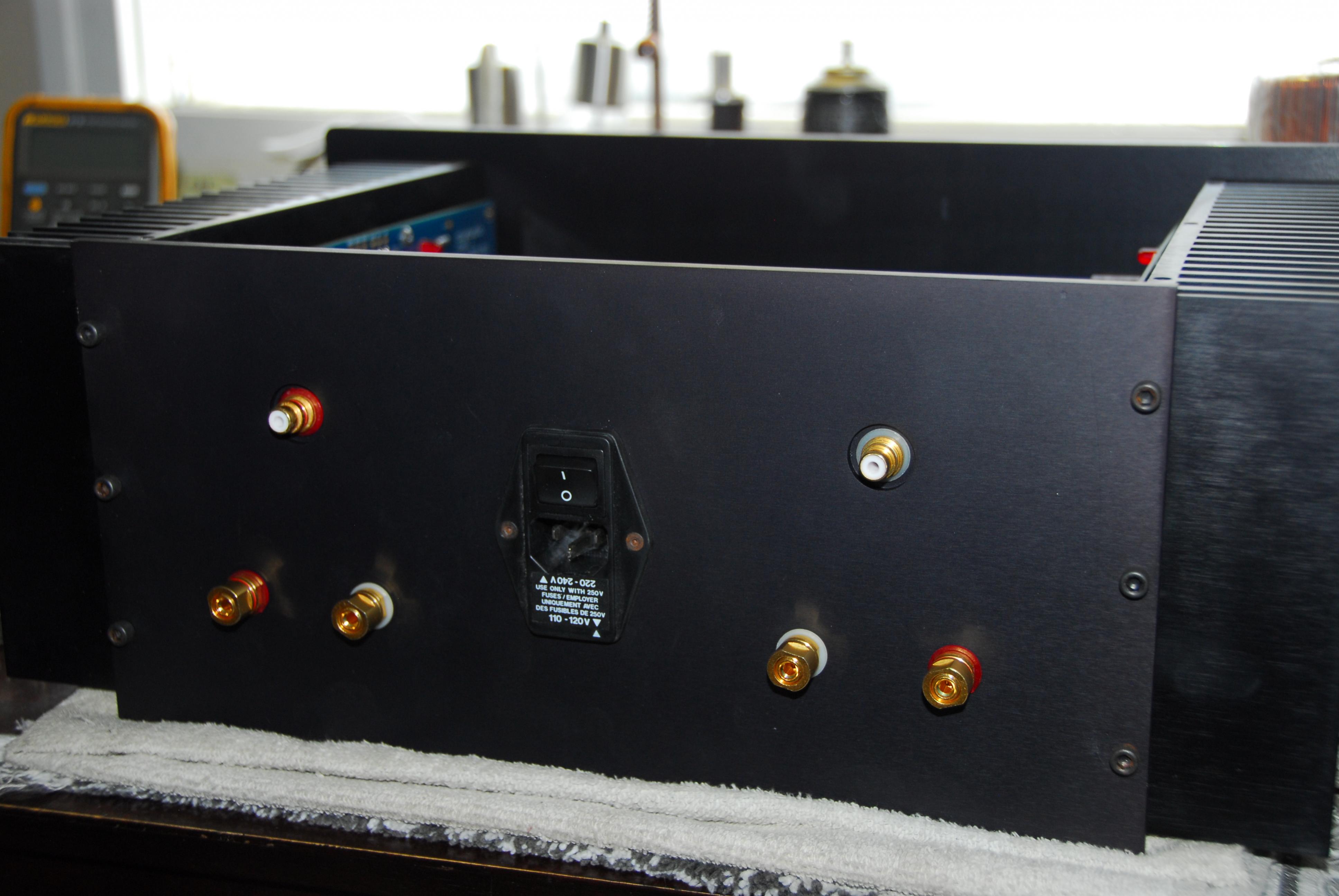

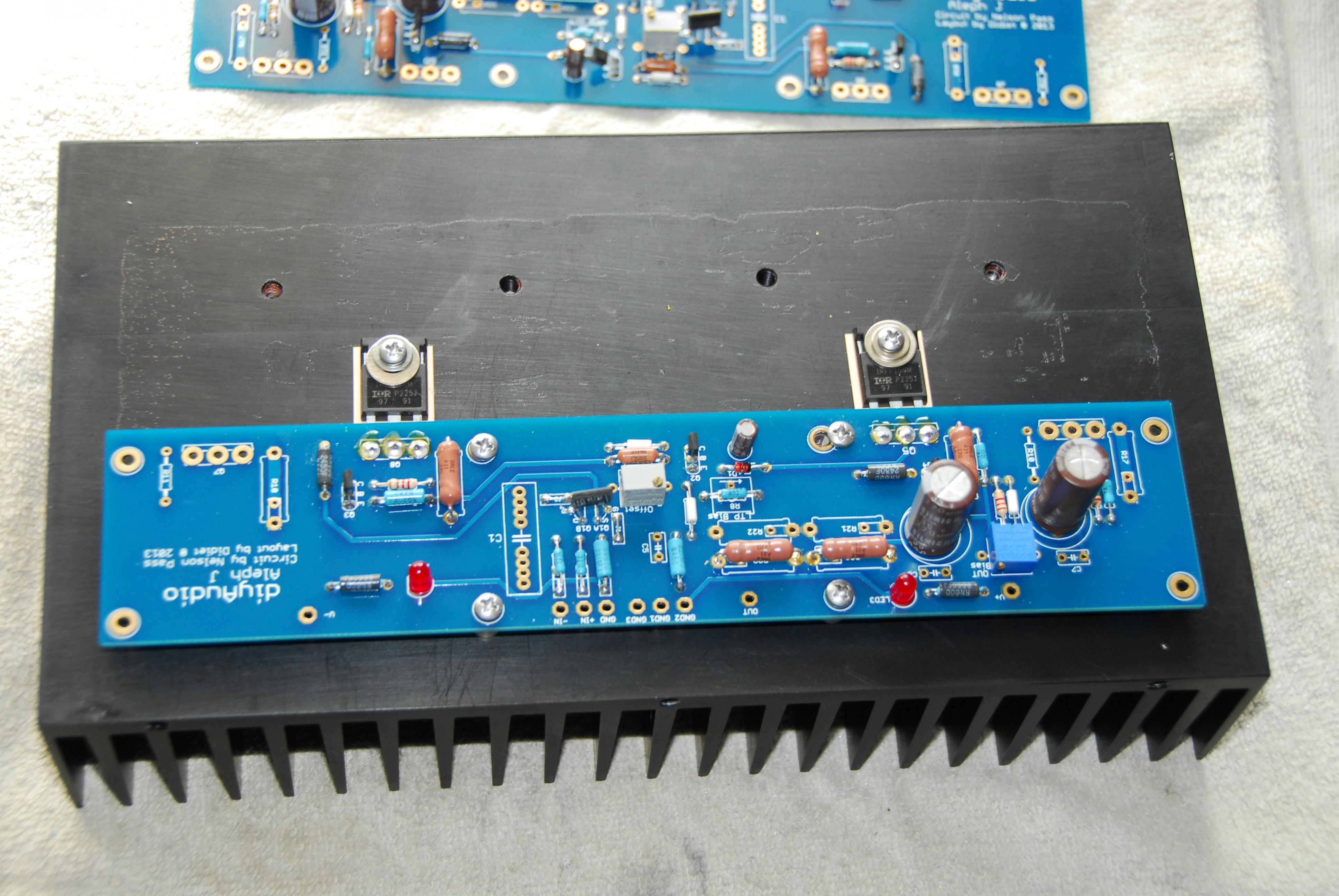

A few more pictures
And here it is assembled and ready for power supply mock up. Lots of room for 8 capacitors and a xfmr, 8 TO-220 diodes with heat sinks, and 16 resistors. As I am using single IRFP150s I am using 0R27 source resistors, but I will use 4 of the 0R47 for R20-R23 which will be here Monday, but this weekend I will at least be able to power it up and get it close to dialed in. I still need to drill the holes for the XLR jacks as back in 1993 when I built these chassis, I wasn't using XLRs. 🙄
When I do the final assembly I am going to use a little thermal grease between the front-back panels and the heat sinks, for a little extra dissipation. 😀
Cheers

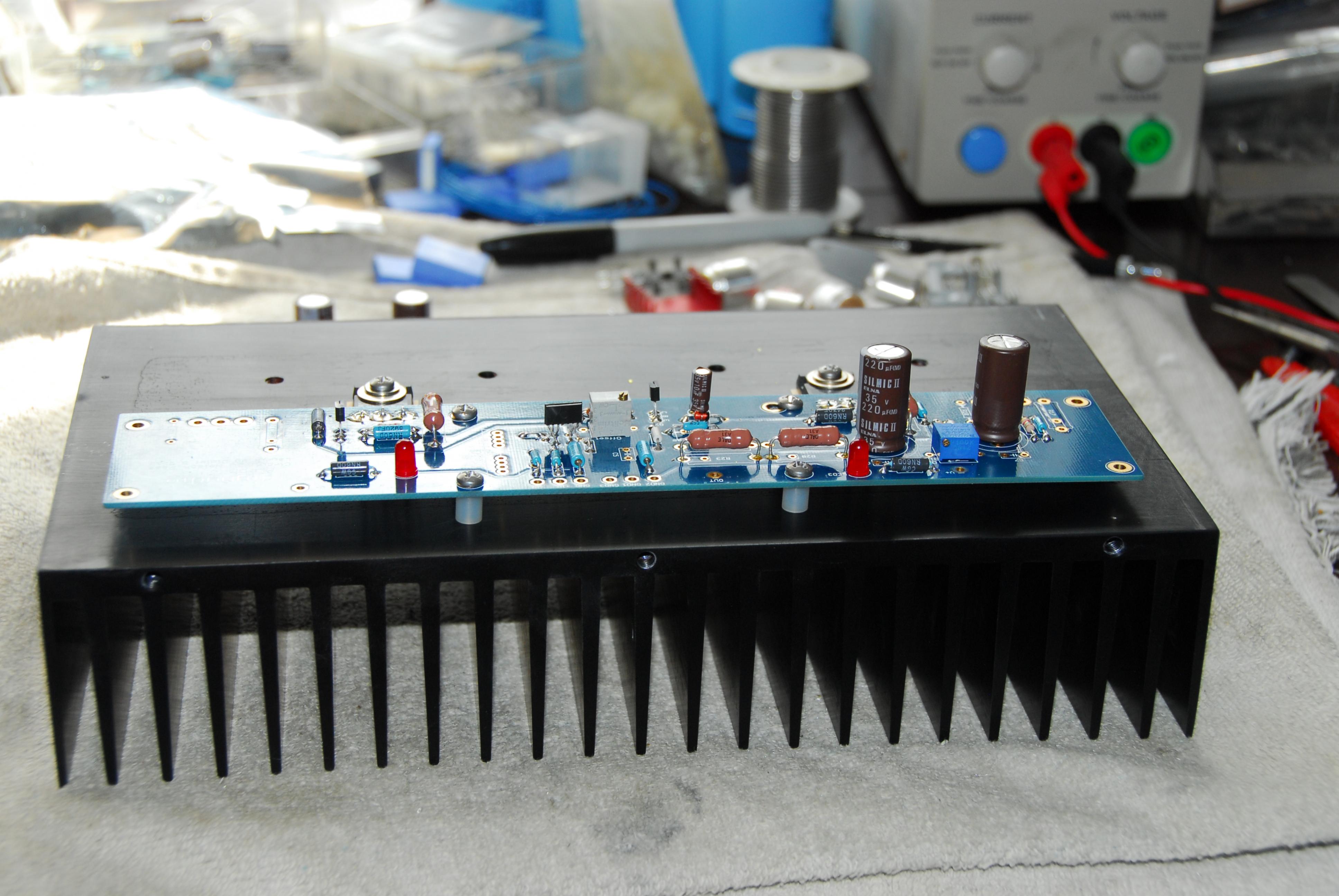

It's alive...it's alive
Rigged up a simple single section power supply and powered up one channel successfully, set the bias and offset (which was very close to begin with) and set the idle current to 1.85A total, .5VDC across the 0R27 source R and let it run for 20 minutes or so, monitoring the temps all along. It eventually hit 58*C on the fins and the plastic case of the IRFP150 was 80*C so I backed off idle current to 1.6A and it seemed to stabilize around 55*C on the fins and 78*C on the device. This is all with the channel just standing by itself on a couple of large Allen wrenches to keep it off the bench, I think I will be able to turn up the idle current when I assemble all the chassis and have that extra mass to help dissipate the heat. PS voltage is +/- 25VDC. I could also just leave it as is, as my speakers are Big Reds with Altec 16 ohm 604E2 drivers and 20 watts will be plenty. 😀
Another thing I wanted to say was that there was mention of wire size earlier in the thread, I want to confirm that even my little simple test setup with 18ga wire, there is virtually no voltage drop across 1.5' of wire so I am going to wire this amp with it as it is very nice Teflon coated silver plated stranded wire and the runs from the caps to the board will be short anyway.

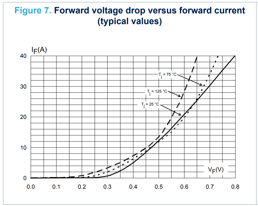

If your PSU design accommodates individual TO-220 rectifiers with 3 legs, as for example the Universal Power Supply PCB in the diyAudio store does, then the Field Effect Rectifiers from ST Microelectronics are appealing. Their forward voltage drop is amazingly low, thus they dissipate far less power and require less heatsinking. Have a look at their Vfwd at 25 amperes. Amazing!
