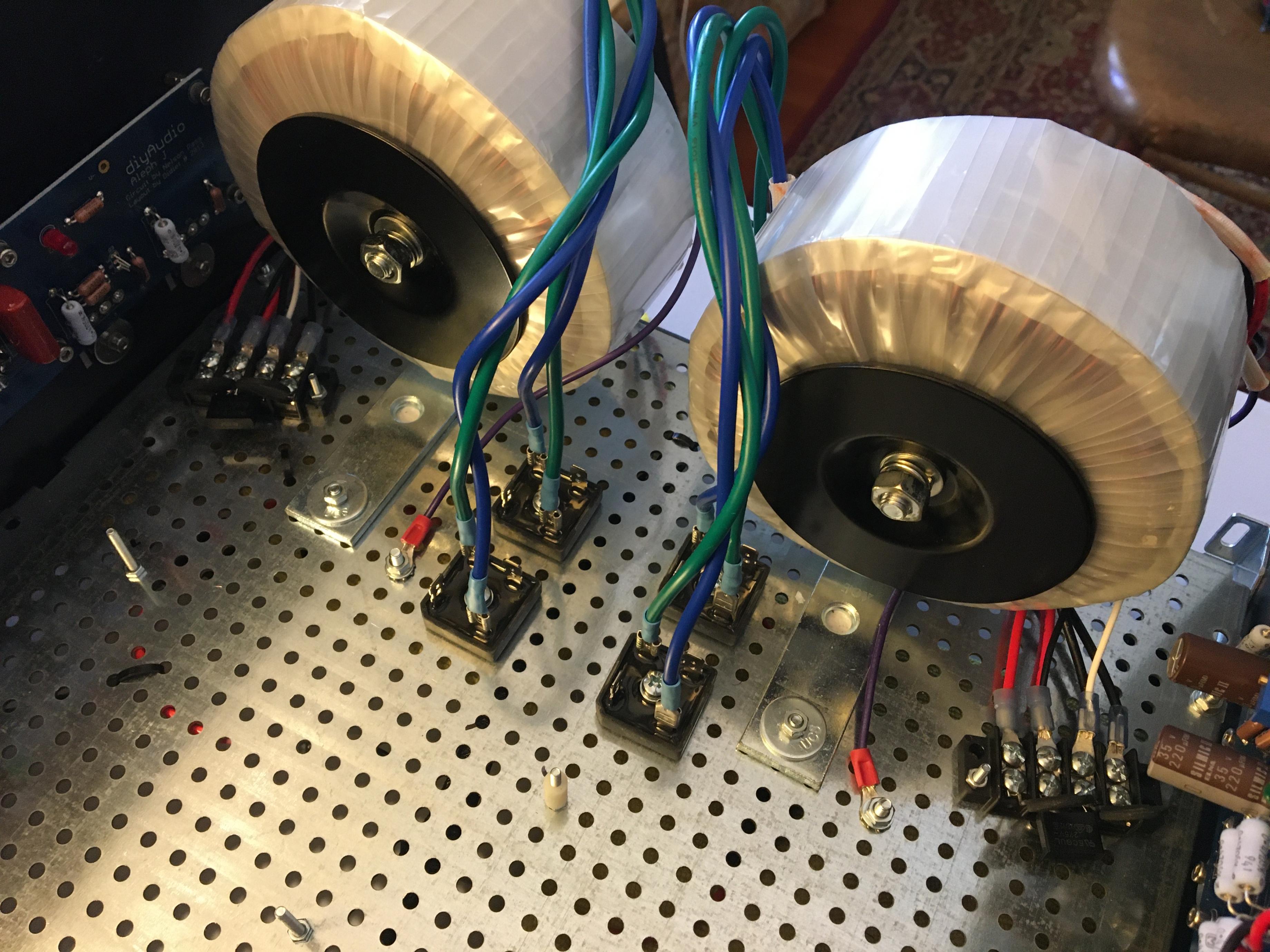

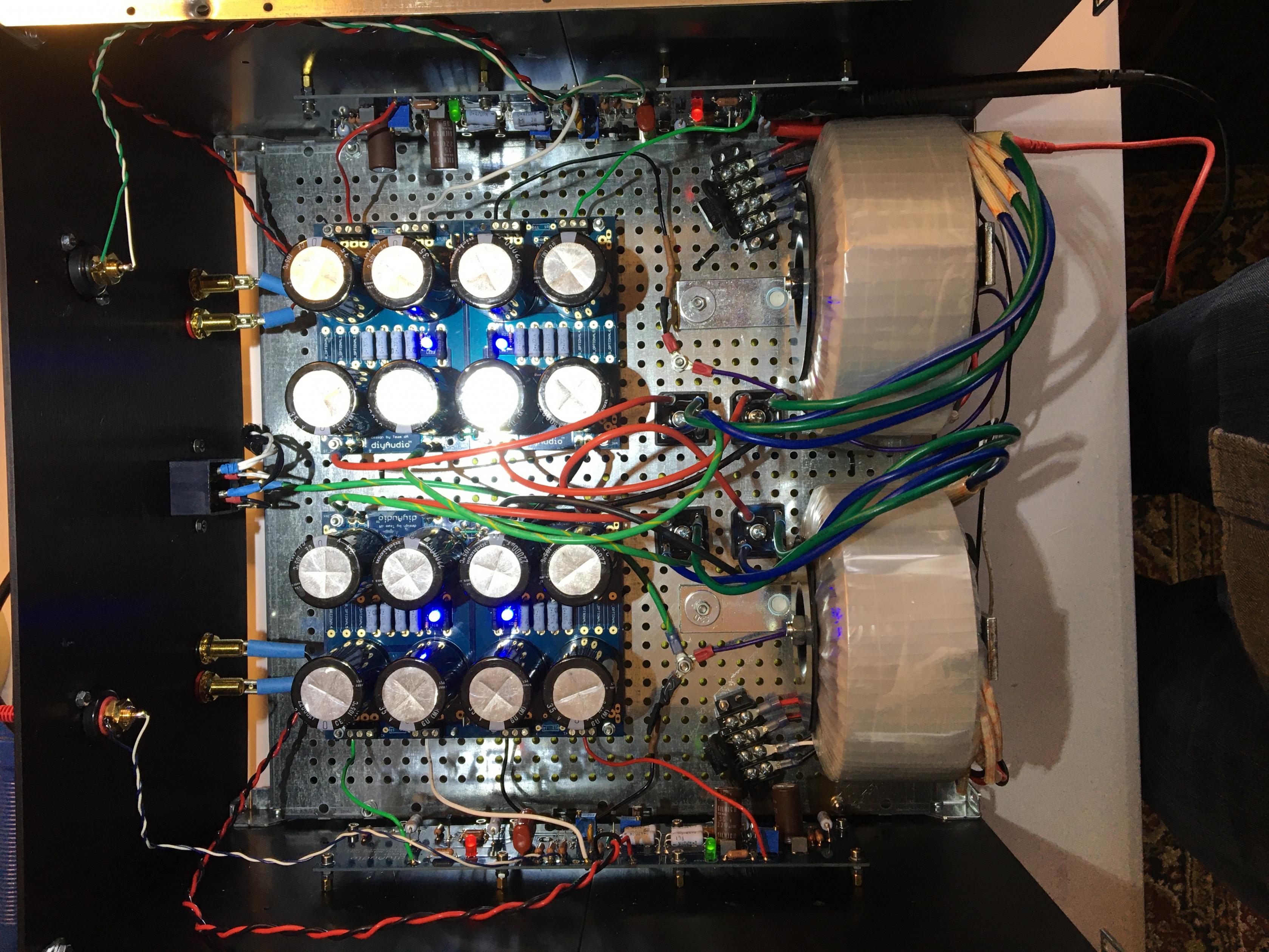

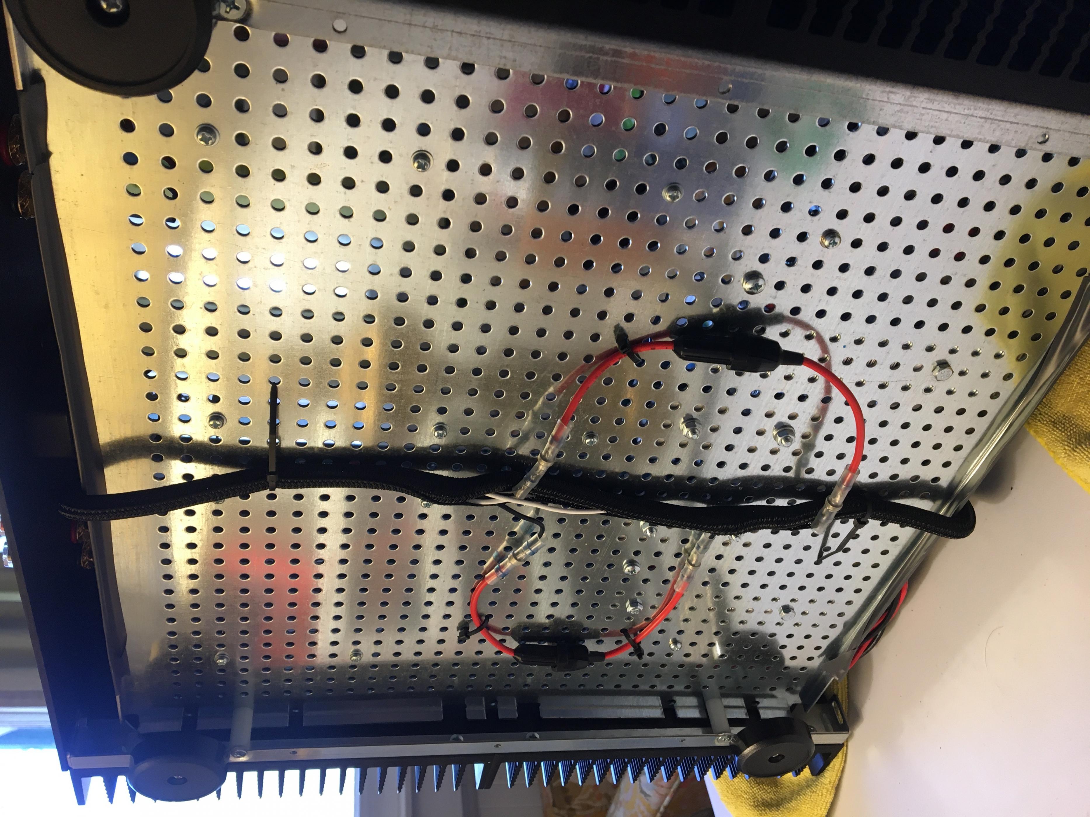

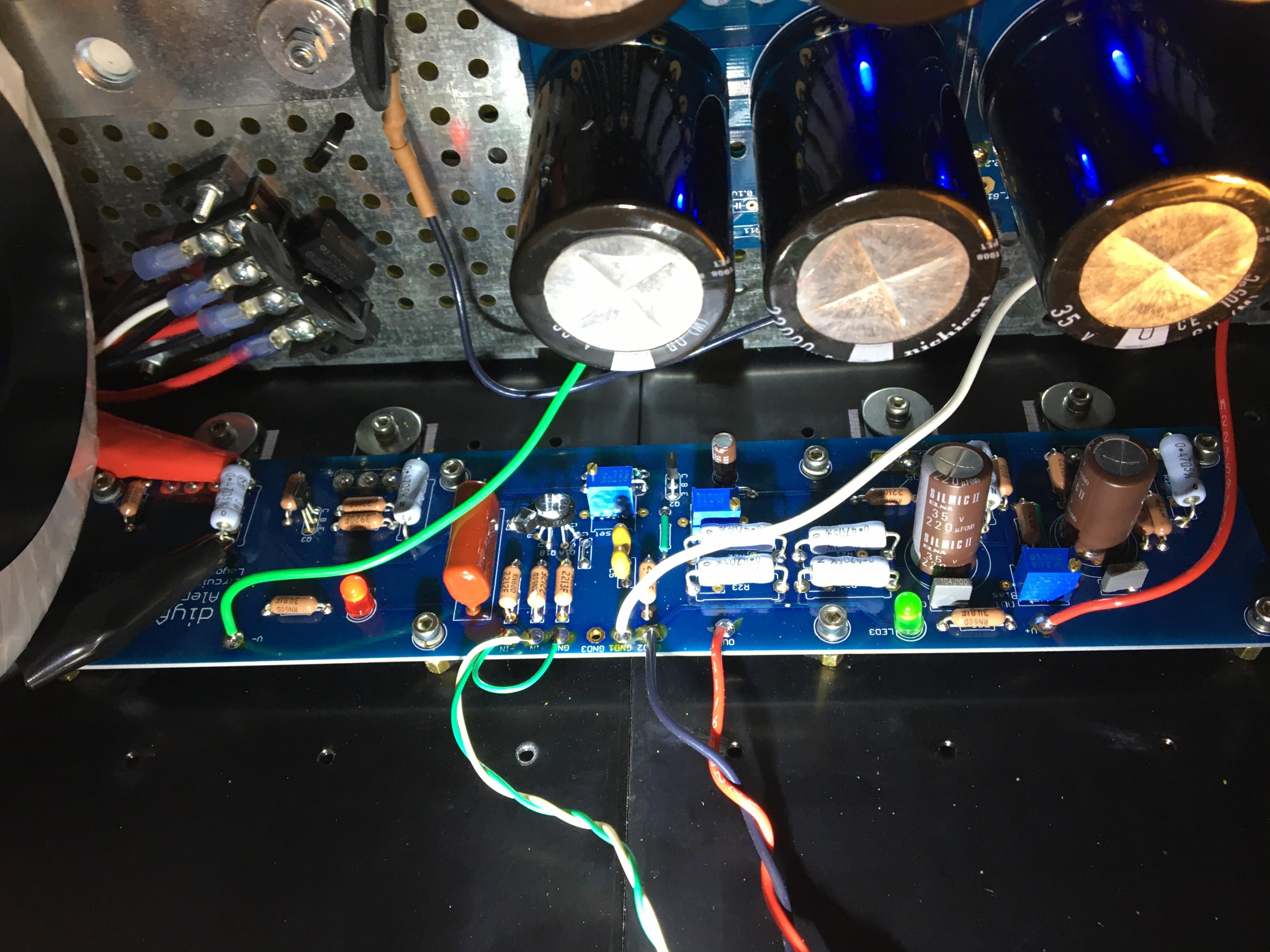

Another Aleph J lives! Enormous thanks to all the help from members on this forum, 6L6 for the build guide, and of course to Mr. Pass. Special thanks to Dennis Hui for walking me through the process of matching the MOSFETS, which, after I figured out how to wire everything up, was super easy.
I'm pretty pleased with the layout I came up with. I took ZM's suggestion to run the mains underneath the riser, and, since I went dual mono, decided to put the fuse holders underneath as well.
I'm getting a little bit of high frequency hiss from the speakers, but nothing I can't live without. I'll probably give Extreme_Boky's hum elimination technique a try at some point. Otherwise, at first listen, it sounds absolutely fantastic. Elegant was the word that came to mind.
Signal chain: Pro-Ject turntable > Lounge Audio Phono Pre > BA3 FE Preamp > Aleph J > Back loaded horn enclosures with Fostex full range drivers.

Excellent job. Can you take a recording with your phone of the noise and post it?
Thanks! I don't see a way to post a recording, but hopefully this link will work: Nueva grabación 6.m4a - Google Drive
Note: I cranked the volume way up to accentuate the hum for the recording. At normal listening levels it isn't nearly this noticeable.
It's a combination of 100Hz buzz and broadspectrum noise...
To fix the mains frequency buzz, do as you mentioned already: "I'll probably give Extreme_Boky's hum elimination technique a try at some point."
For the white broadspectrum noise, it should disappear if you short the RCA hot pin to ground. If this is indeed the case, your source has a highish output impedance; try using a volume pot between BA3 FE Preamp output, and Aleph J input.
Thanks for this diagnosis, Extreme_Boky. I haven't had a chance to try shorting the RCA hot pin yet but will give that a go soon. If that's the issue are you suggesting I should re-wire the BA3 FE so the volume pot comes after the BA3FE board (I currently have it wired according to 6L6's build guide - before the PCB), or that I should add an additional volume pot to the chain?
