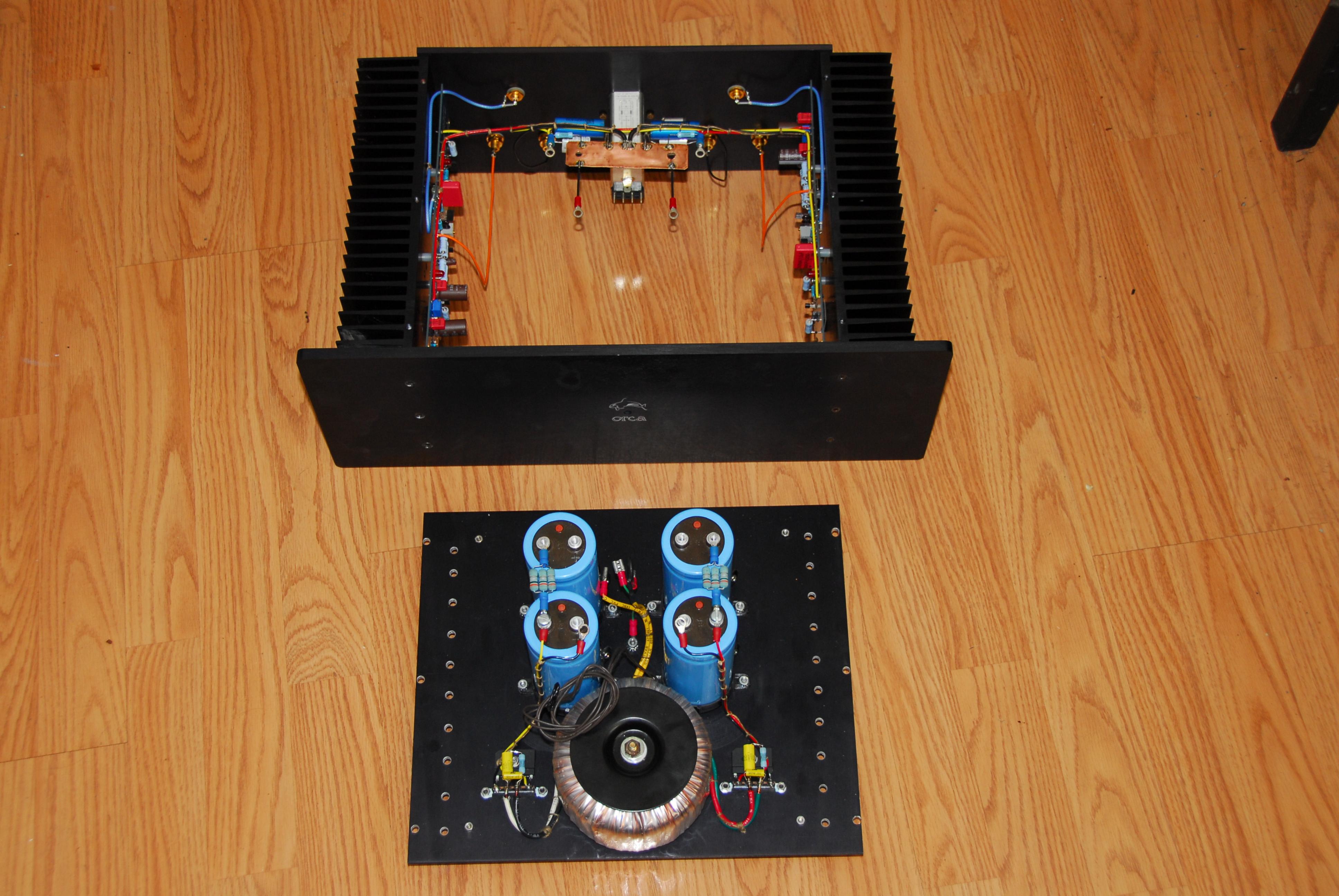

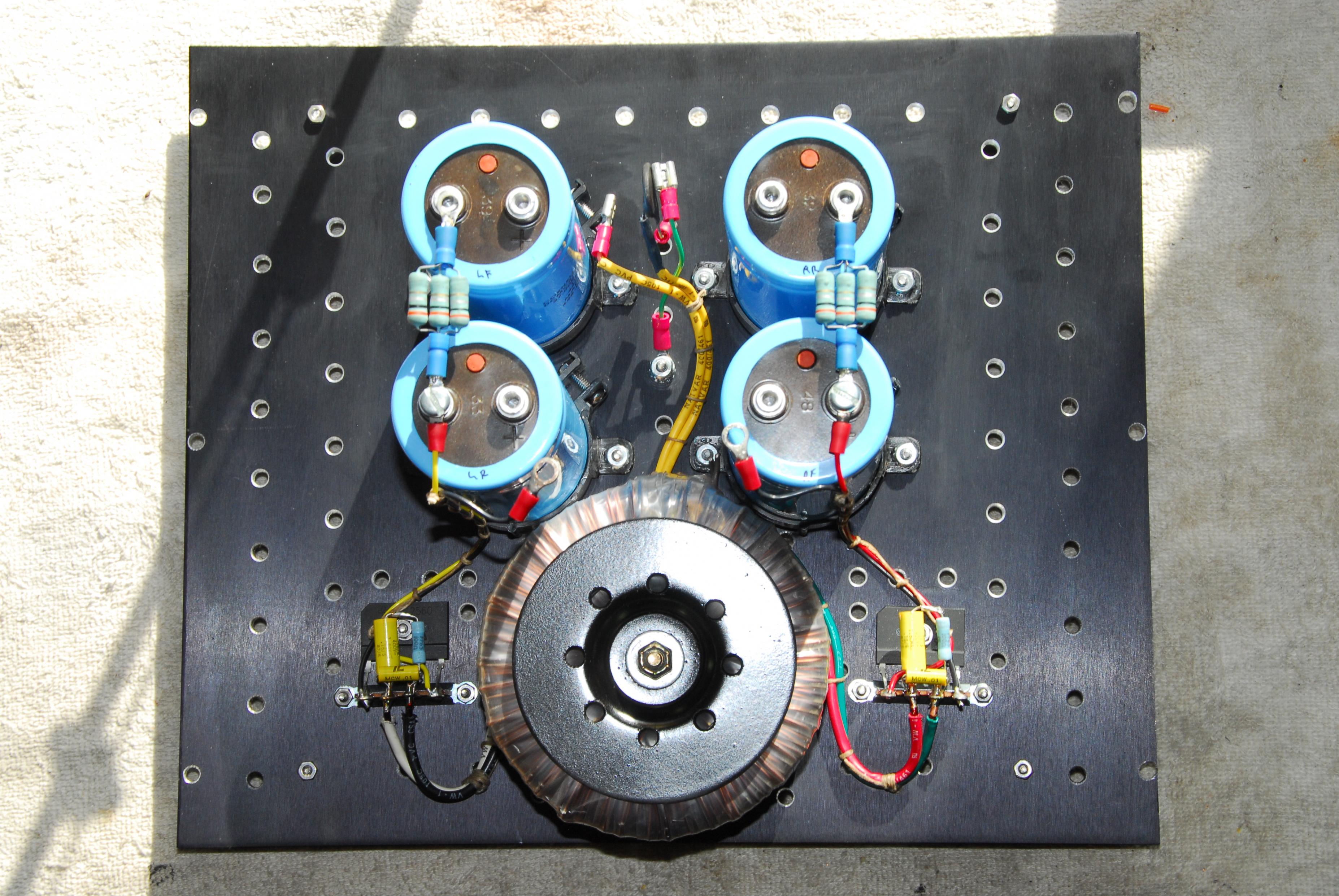

bridge dissipating more than 1 watt can benefit with the use of a heatsink... i will put insulation pads on the power traffo instead...heatsinking is all about surface area, so the bottom plate adding extra surface area can only be a good thing for me...
Agreed, I used thermal grease between the bridge rec and bottom plate and as these are low Vf ~.75VDC, power dissipation is very low. I was also thinking of leaving the bottom plate intact, insulate the xfmr with proper material, and vent the center cap holding it, and drill some more vent holes in the bottom plate.
The DC rails & returns, and the speakers' hookup wire, is very thin. I'd go with at least triple the cross-section. Even better, you could extend the copper plate to cover all 4 capacitors' screws🙂
The transformer, if damped correctly (quasimodo snubber) , could dissipate a lot less heat... The speakers return wire should go straight to that copper plate.
If this were an 400W into 2 ohm amp I would agree, but as this is only a 25W amp, and idling at ~2A, I believe 18ga wire is adequate. After all, the R47 resistor leads are ~24ga and the length of internal wiring is short. 😉 I setup the copper plate as it is to reduce the ripple current from the first set of caps from getting into the ground, keeping the ground as a single point and yes the speaker returns go right to that center connection point on the plate, not the PC board. Quasi snubber in place right at the bridge rec. 🙂

The only change I would make is to remove the insulation from the crimp terminals and solder them for long term reliability.
They actually are soldered, I just left the insulation on them, you can see a few of them where I slightly overheated while soldering. 🙄

I finally have just about finished the Aleph J. I just need to install the blue LED and find the top cover. All the proper parts have been installed, all the .47Rs as they should be, all wiring is Teflon coated silver plated including the input coax. All of it came from the Boeing surplus store over 25 years ago, what a treasure trove that was. I even laced the wiring, something I learned back in the early 80's at BCIT.
I am very happy with the static results so far. Heat sinks ~55C with idle at 1.9A. The LVB2560 bridge rec. stays at the same temp as the chassis, about 45C. ~75mV of ripple on the supply and ~3mV AC on the output with inputs open. AC draw from the wall 220W.

Waxed string cable wrapping is a welcome sight. Looks so much better than nylon cable ties and is very effective.
I was a Hydropower Electrician for many years and am familiar with the technique, but let myself get lazy and craftsmanship usually suffers then.

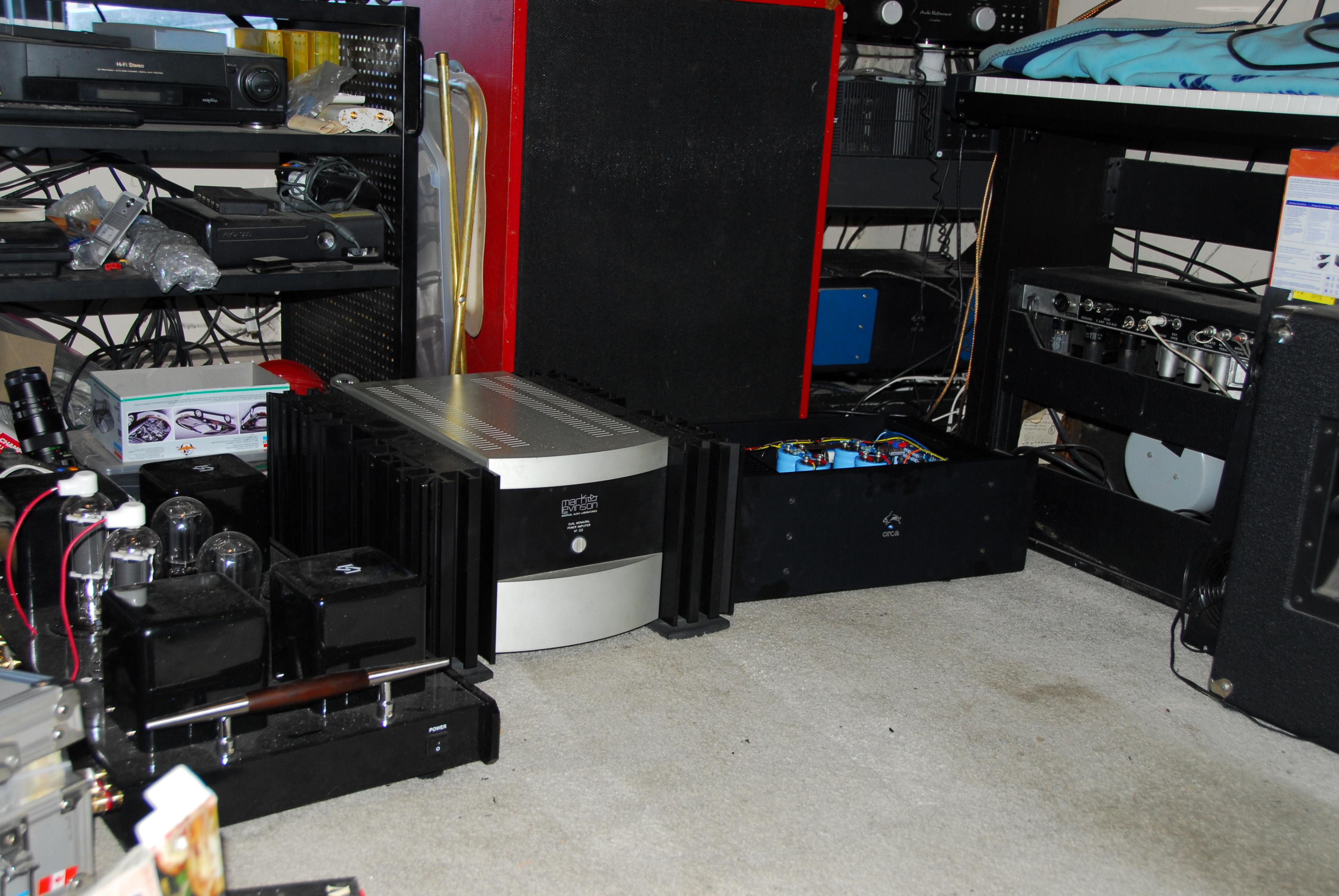

I spent a very long time listening to 3 amps tonight….Nelson’s Aleph J, ML's No.332 and an offshore 805 SET tube amp, and the results weren’t what I was expecting.
I started with the Aleph, and was really discouraged when I first heard it, I thought something was wrong, it just sounded awful, like something was missing, no highs, muffled, WTH I thought, gain was very low, not like I have been told, that it is a high gain amp. I listened for a few minutes then thought I better try the No. 332 for comparison, after all, it’s a “Levinson”. Well, it didn’t sound any better, in fact it was worse. Turns out, warm up time is really important, and the Aleph had zero hours on it and the 332 had only been on for 20 minutes.
An hour later I now had 3 amps going in the rotation, as mentioned above, and observed the following.
The Aleph turned out to be amazing, it started out sounding like a Dyanco ST70/PAS3 combo, not bad, very musical, but veiled, just dull, very musical but dull, but after it warmed up, it came to life. Then I switched to the 332, and after a few minutes found I wasn’t listening to the music, it was boring, but found myself thinking about what it was like for Mr. Levinson to be in the Threshold building, what those two must have talked about. I went back to the Aleph and the music just seemed to jump out at me. I found myself just listening, very musical, it made me happy. I will say however that it is very sensitive to interconnects, I tried 3 before I found one it was happy with.
I then moved to the tube amp, a JAS Array 2.1, a 150 lb 805 SET beast. It immediately jumped out as the winner in terms of depth, clarity, and dynamics. It just was more musical. The way the Aleph was more musical than the 332, the Array, was again, just more musical, better depth, dynamics, toe tappingness.
So, one must realize that this is very subjective, and results will vary WILDLY with different systems. My system (currently) consists of a Technics SP-10, Audio Technica AT1005 arm, Shure V15 IV cartridge (don't bug me, I play a lot of old jazz records and it's tough as nails), I do have many better but they are so much more fragile. Preamp is a Yaqin MS-12B and the interconnects that worked are some old home made Mogami 2534 based cables. Speakers are Big Red monitors with Altec 604-16LN drivers and Mastering Labs crossovers, 16 ohms.
