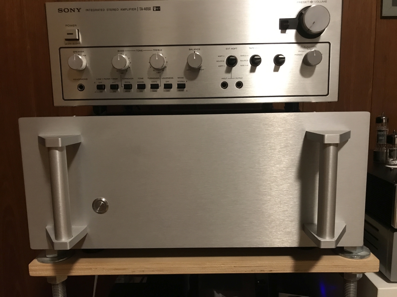

I bought the front plate and top plate from Modushop.
The perforated bottom plate and the back plate I ordered cut to my specs from a German supplier (www.prokilo.de). That's also where I got the 10x10 mm square aluminium rods that I cut to length myself.
All the drilling and tapping courtesy of me 😉 Hand-tapping can have a somewhat meditative side to it ...
Only challenge are the large holes for the front panel power switch or the XLR connectors on the back, and the IEC inlet. Careful work is required there.
The front plate is actually mounted off-center, shifted downward a bit. In that way, it forms something like a "skirt", so that the tall feet (that are good for ventilation) don't show. More harmonious proportions that way in my opinion 🙂

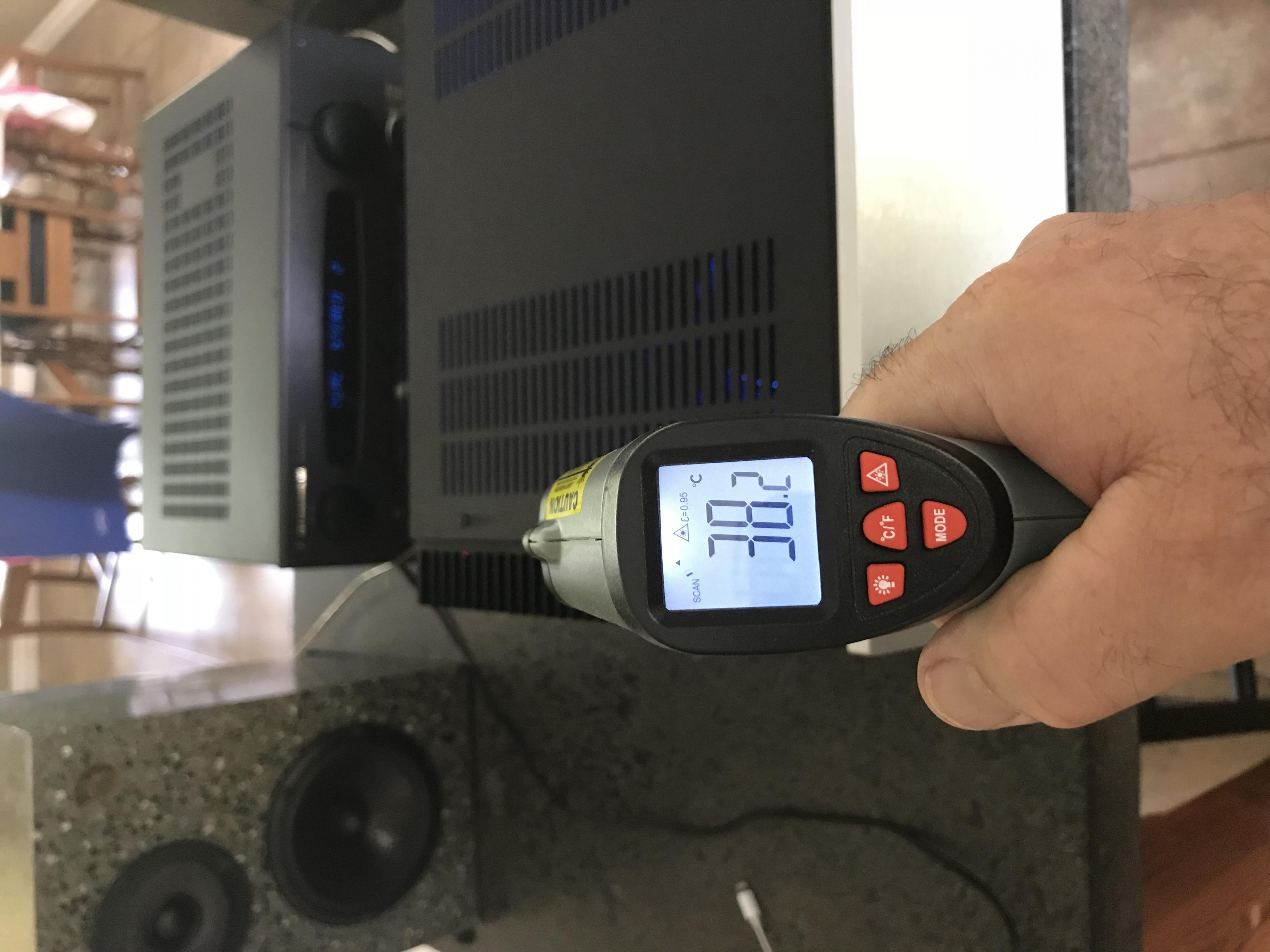

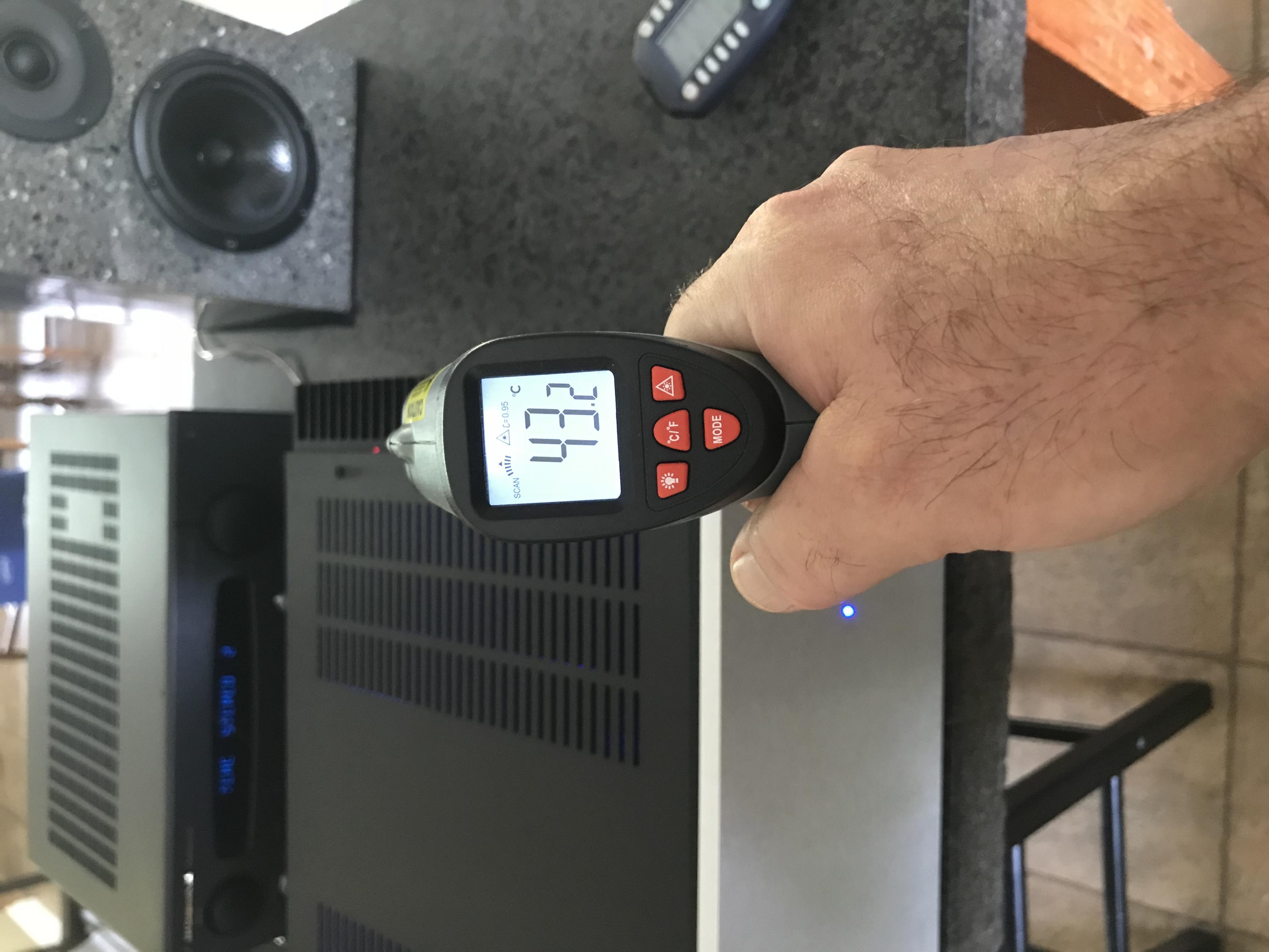

Build complete and sounds wonderful. Interesting that the temperature is lower on the left channel, should I recheck bias again after running it for an hour or two? I initially set bias then again after 30mins. First amp project and already thinking about building another one for my son!

Hi pggriff,
I suggest checking the bias after running the amp for at least one hour and adjust as needed. I find 30 min isn't enough for things to stabilize.
Dennis
Dennis
