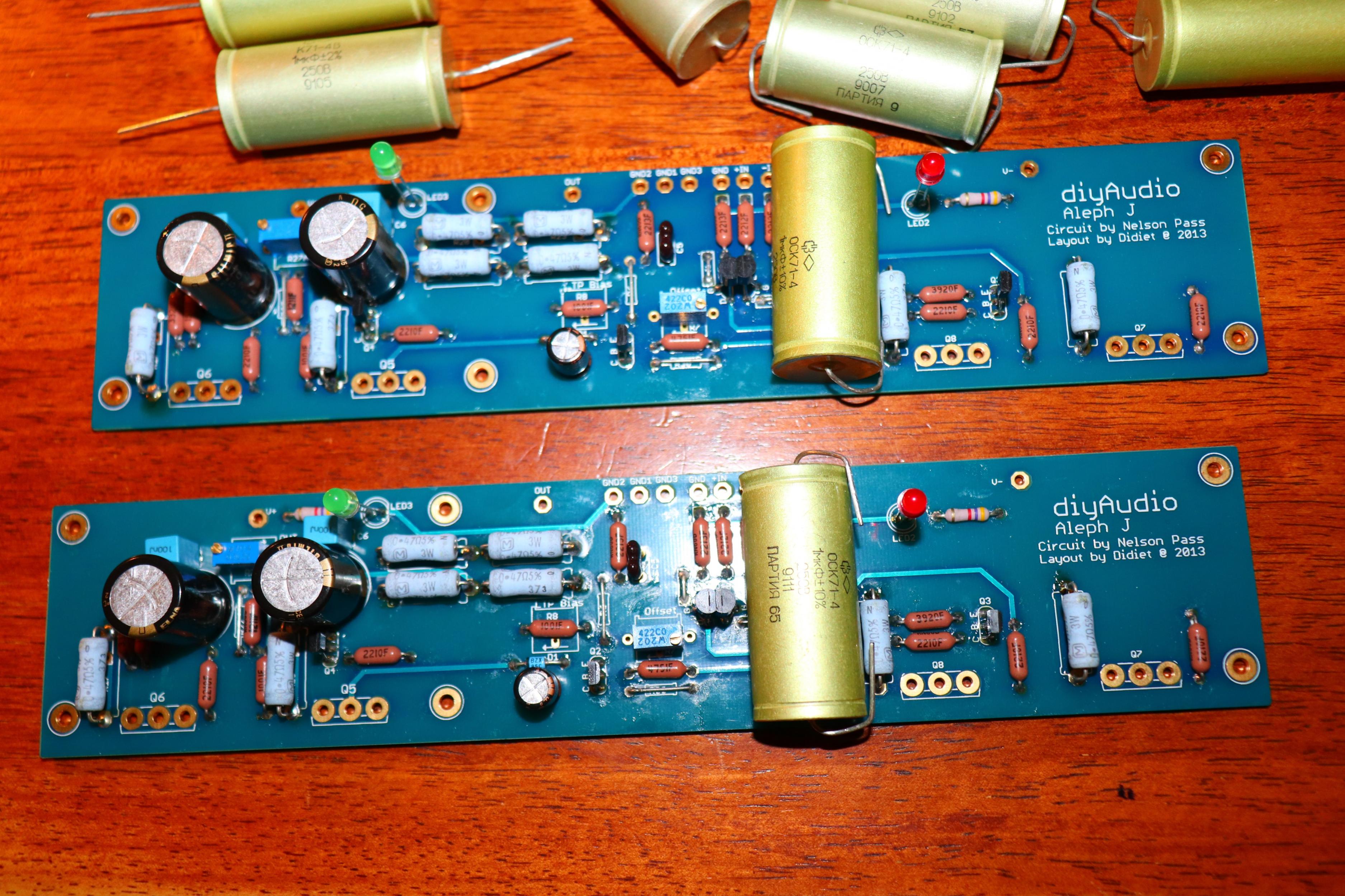

Today I started work on my Aleph J.
I managed to almost completely populate both amp boards as well as the power supply board.
However I have a couple of polarity questions before final soldering on a few items.
In particular does the 5pf mica cap at C5 have a polarity and if so how can it be fitted correctly.
Same problem with the large block 1uf cap at C1.
I managed to get the wrong caps for C6 and C7 so when the right ones arrive I'll be wanting to know which way they go as well please.
Then I need advice to fit the LED's properly. I see a flat on one side drawn on the board and I see one leg is shorter on the LED. Just not sure which way that goes. No indication on the power supply board either. I may just wait till power up to see if I got them in the right way as I took a stab in the dark.
Will the amp work without them being fitted right?
I did get some of those small voltage zener diodes in the transistor kit from DIY as mentioned above but luckily I had already ordered a 9v one. Perhaps they need to be made aware that they are supplying wrong parts there.
Your help will be most appreciated from this novice.

Here's a pic of one of my new boards.

Mica capacitor has no polarity, the big WIMA red capacitor also no polarity.
With the LED, the short leg is negative side, long leg positive.

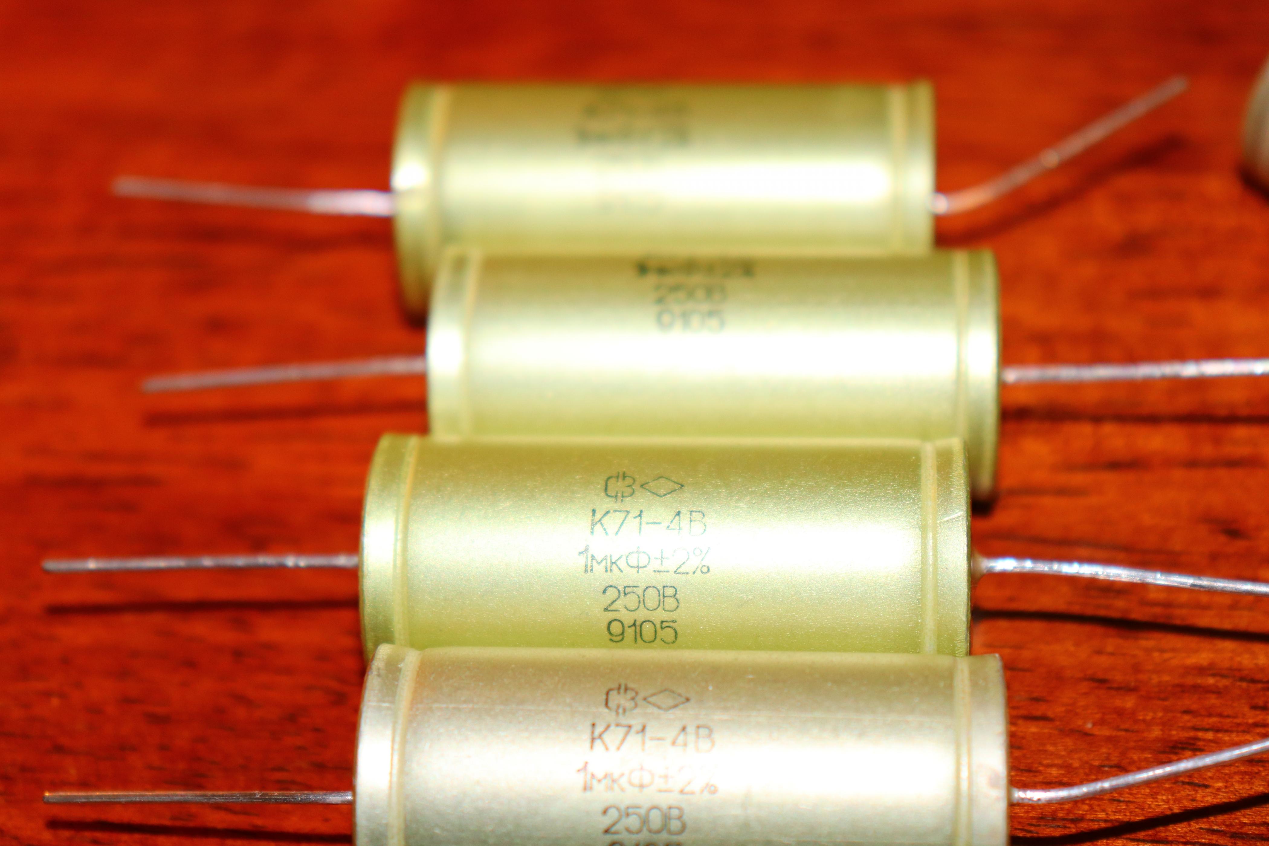

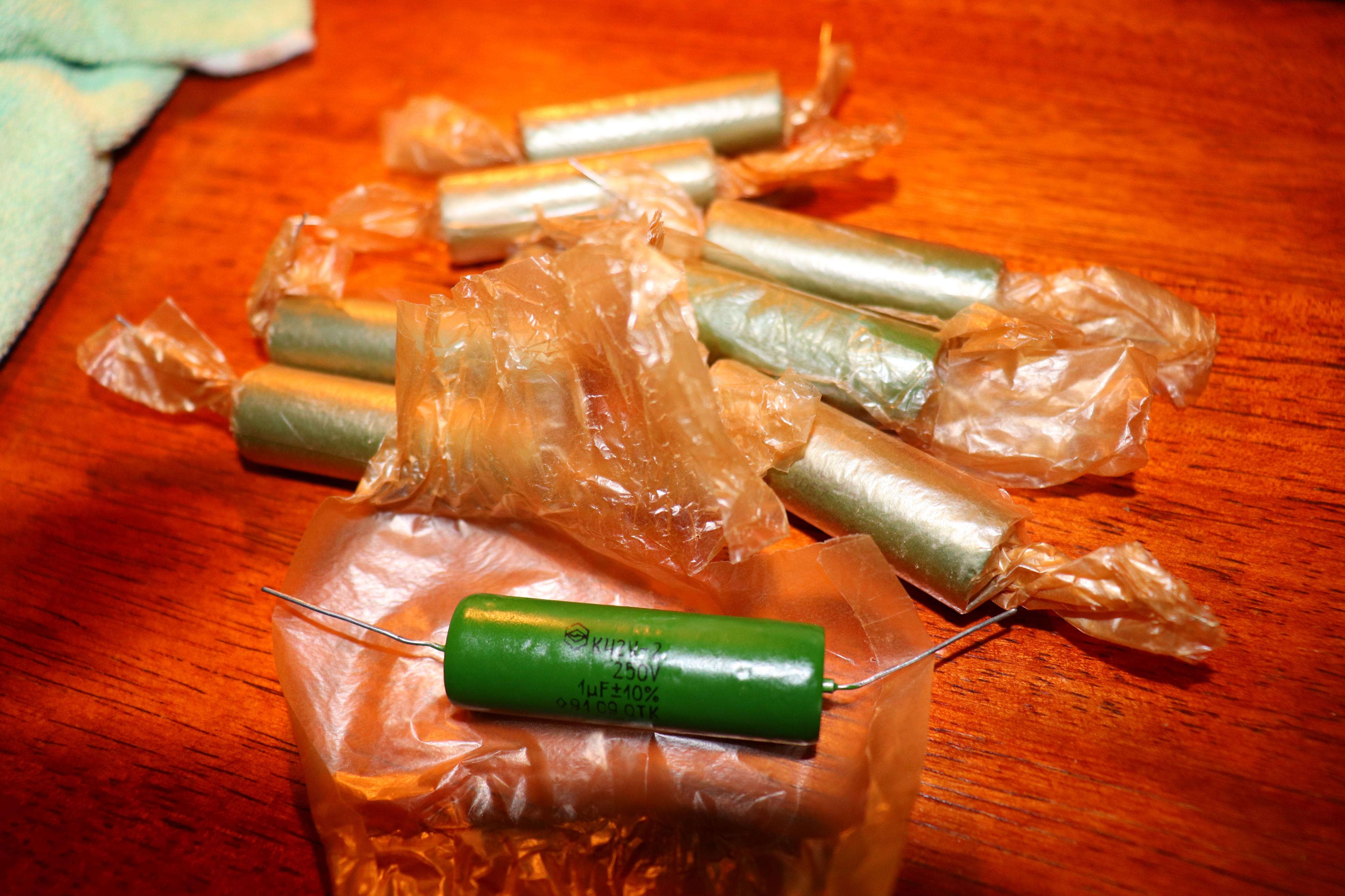

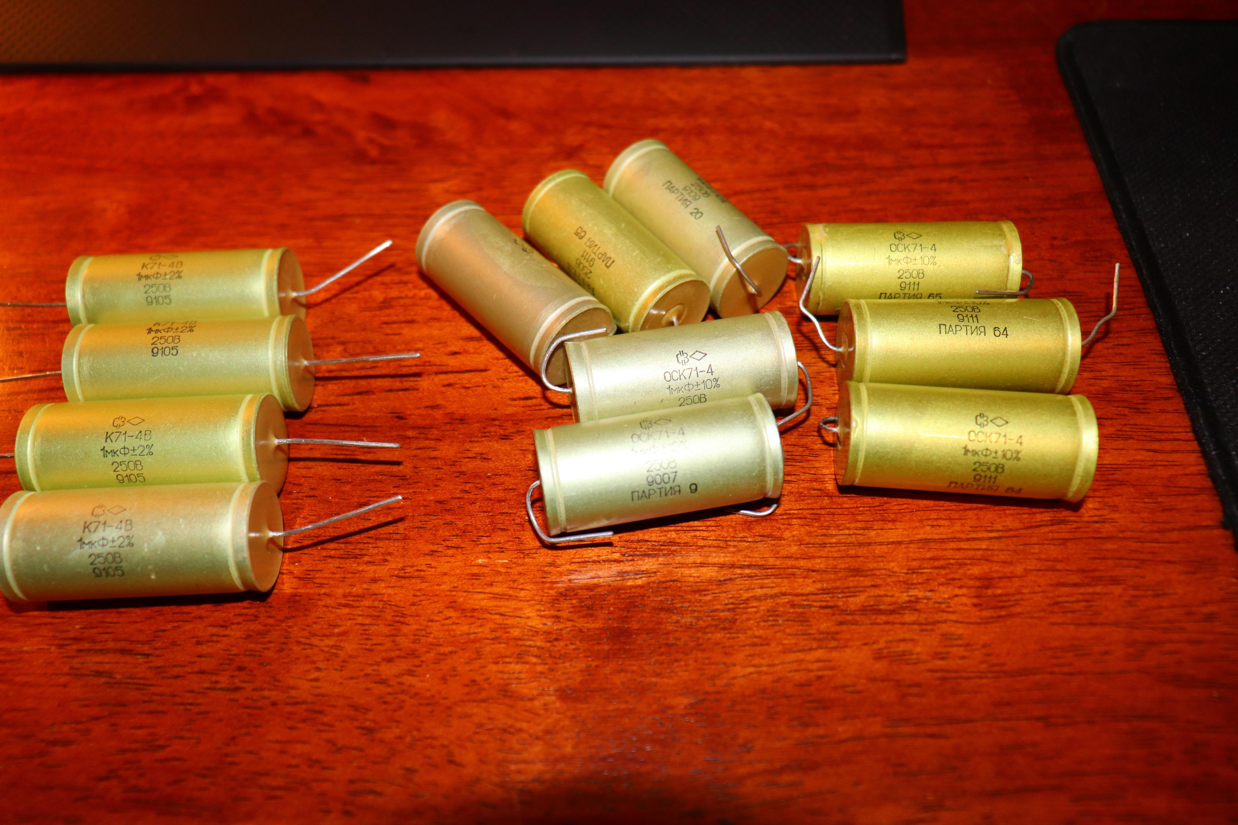

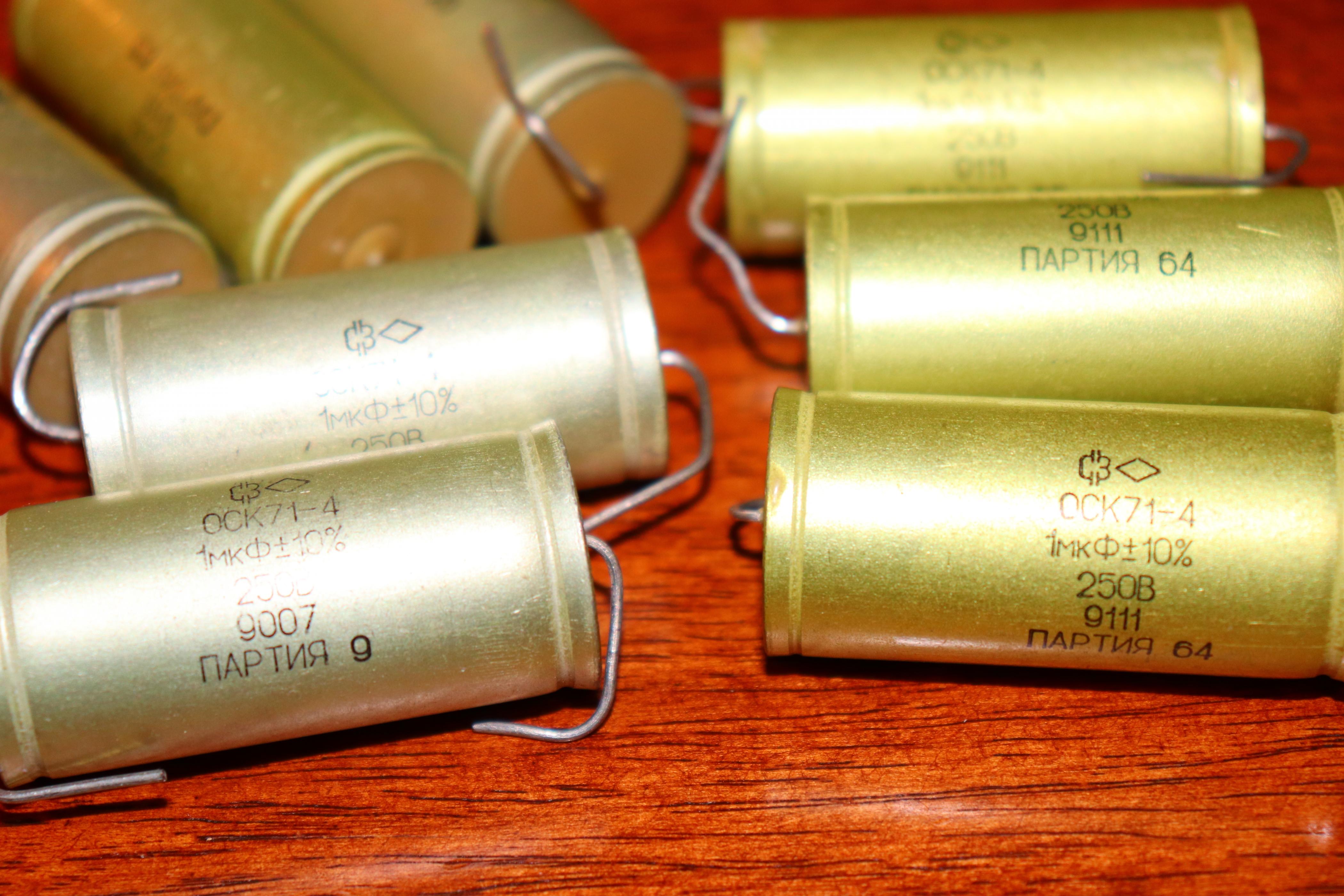

Using Russian caps for C1 input capacitor in Aleph J
I don't know if this has been mentioned already, but there are several interesting Russian military-grade capacitors that could be used as a replacement for the input capacitor C1 in the Aleph J, and they are cheap compared to the high-end capacitors by Mundorf and the like.
One of them is the K71-4 / K71-4B, with a polysterene dielectricum, which is seen as the second best after teflon for audio use.

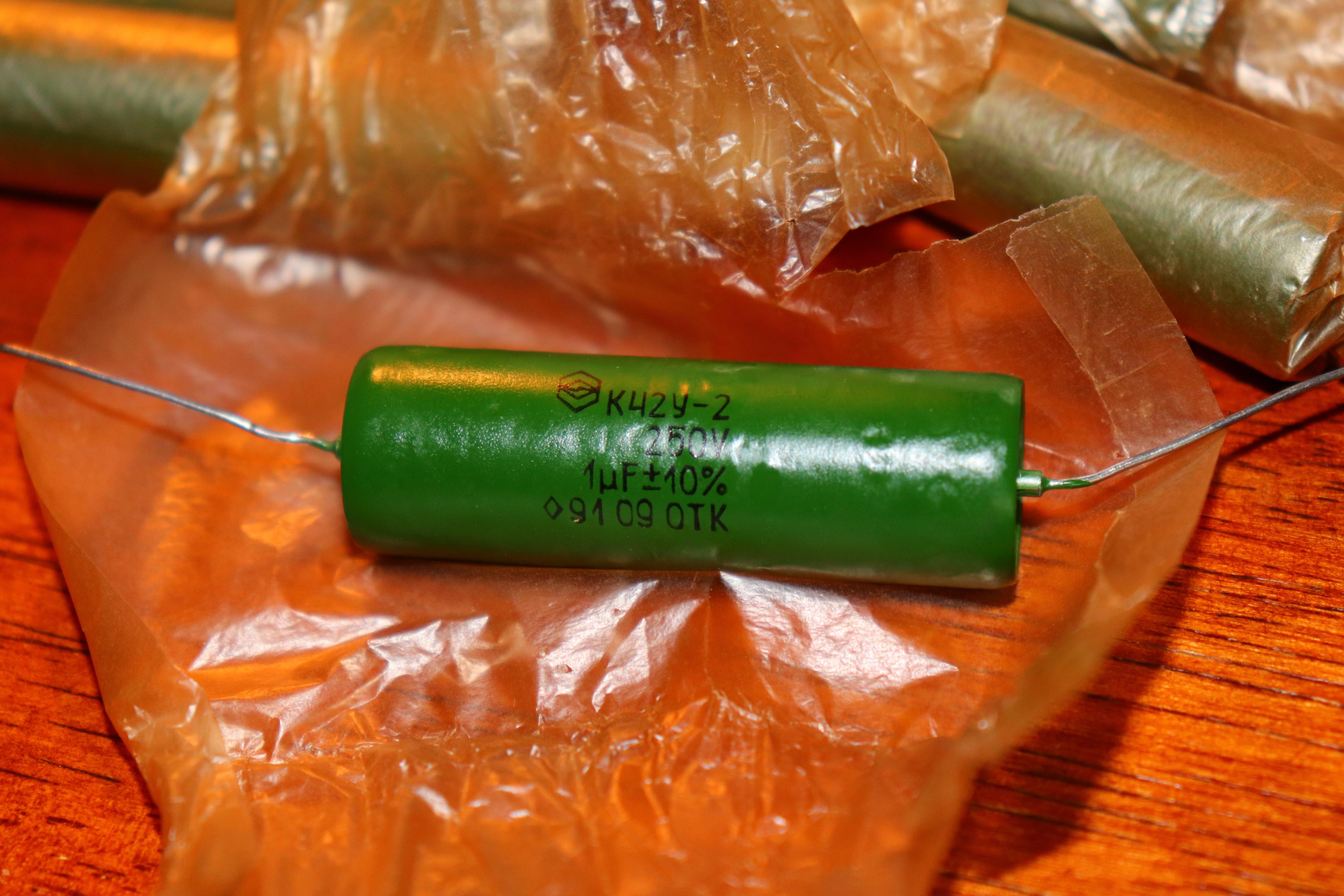

The other one is the K42Y-2, a paper-in-oil (PIO) capacitor.
Both capacitors should have a distinct sound if I have to believe audio reviews on these caps.
Does anyone have experience using these caps in audio circuits?
They are much bigger than a polypropylene cap, so on the Aleph J PCB's the short leads have to be extended and insulated with heat shrink tube and maybe fastened with a dot of hot glue.
