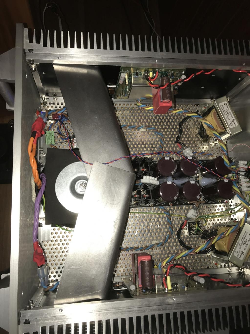

I have built F6, M2, Aleph J, in Deluxe 4 case. If you want dual mono things will get tight. I used Antek 500 va transformer in each of the mentioned cases with plenty of room.
Russellc

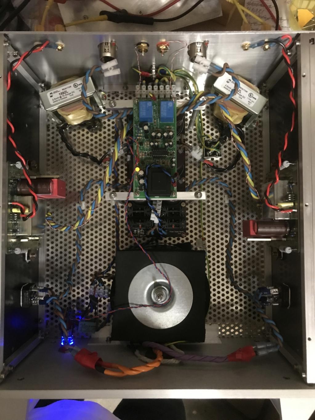

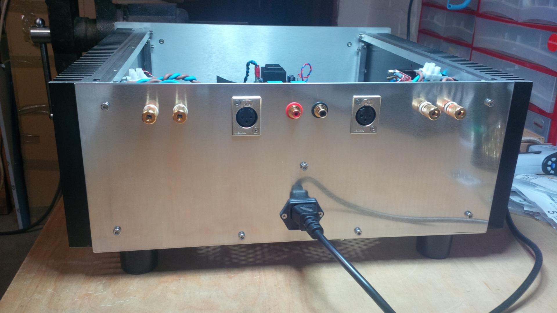

I have built my DIY case on a pair of 4U / 400 mm heatsinks (160 x 400 mm) that I had a machine shop cut for me from a bigger one that I got used.
With a well-ventilated baseplate and top plate, and set on somewhat taller feet (40 mm), this case is good for up to 100W per side.
With that, I can leave my hands on the sinks indefinitely (well, except for the hottest weeks of this summer 😛)
Best regards,
Claas
