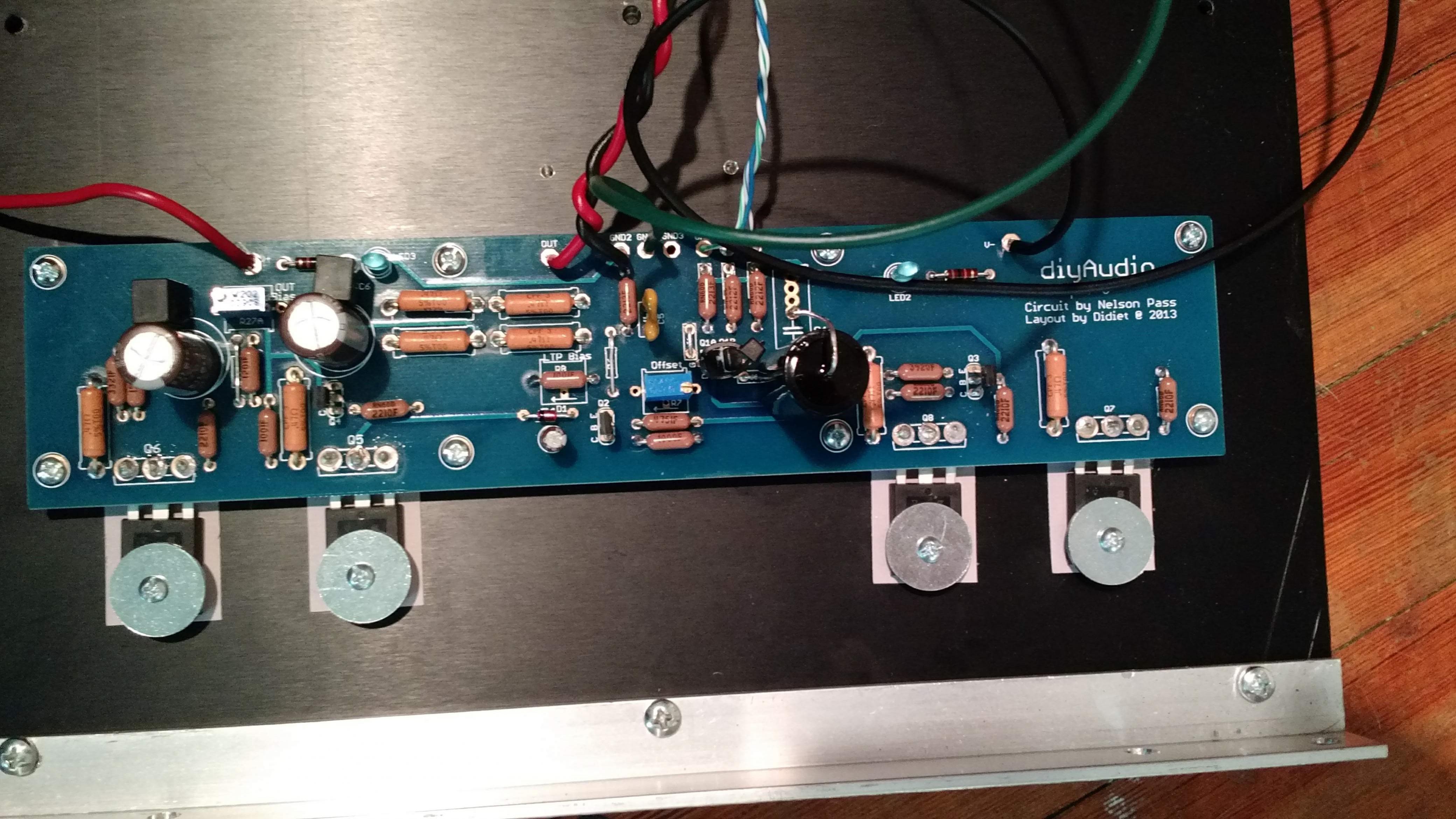

I'm trying to finish up my first build and have run into a problem. Everything is assembled and I am measuring +25.5 dcv and +25.5 dcv leaving the PCU. I am not able to get the Mosfets on either the right or left channel to heat up.
The source resistors are measuring 0v . the voltage across R8 is around 8.43 volts, I'm assuming that since the voltage to the amp board is ok, that is where the problem lies. It also then appears that I made the same mistake on each amp board but I can't figure out what that was. I am new to this and can't figure out the schematic enough to figure out where to start looking.😕
I've attached a poor photo and will take some better ones later if needed.

Have you pre-set the bias pot as per the build guide? Also, what value resistor is that for R8? Should be 1kohm, looks like 100 from pic. A few of the solder joints look like they should be redone.
