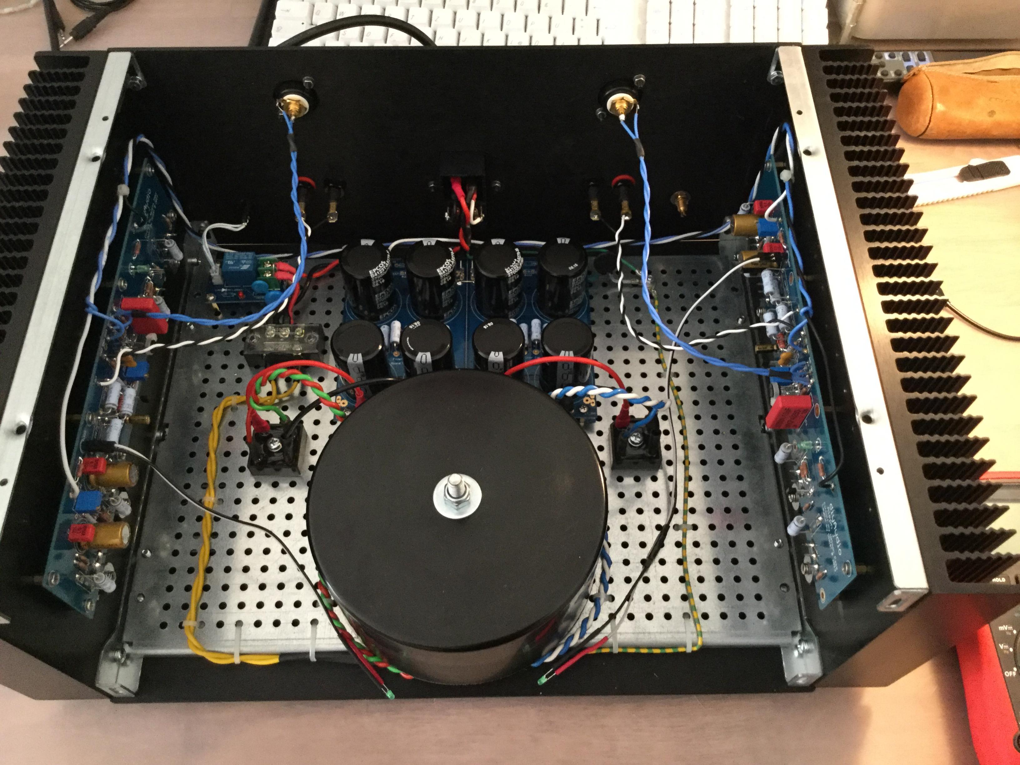

Hi members,
I think I did it.....first adjustments done.....seems to run fine.
I went with adjustment guide from 6L6 on the thread start setting bias to 0,4v and zero dc offset.
Now powered on bias is up over 4,5v settling down to 0,4v.
Highest temp on device just under 65C and 55C heatsink.
But I found another post with adjustments posted by ZenMod that needs to put 10r,100r or 1k for R30.......i still have jumper at R30....should I change?!
Another question......I’m still not sure with the fuses.....I’m running 240v 400va transformer
What fuse value makes sense?!
Gregor
Hallo Gregor,
congratulations!
Fuse value should be the lowest that doesn‘t blow on start-up. 😉
A good starting point is half the value that the folks with 120 V AC mains use.
In my Aleph J build, I have 1.25 or 1.6 amp rated fuse. I use a single CL-60 in series with the mains for slow-start.
Best regards, Claas
Here it is .... 🙂
Hope image shows up ....
