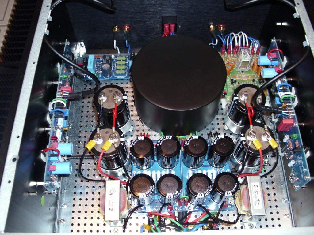

Hi, this is my first posting to this forum.

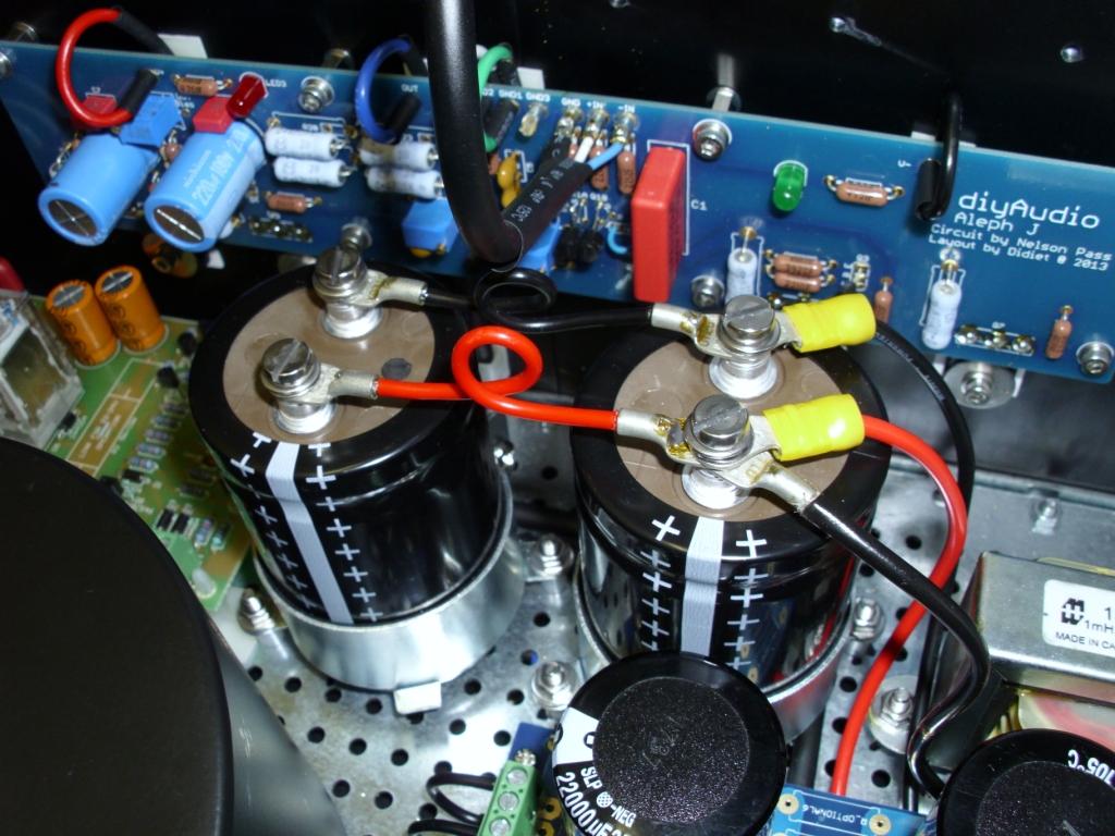

I have recently completed construction of an Aleph J amplifier. It took me many months because of the time involved in obtaining parts and bits and pieces from various overseas sources and in making decisions on the build and layout. This gave me the opportunity to read every item on this forum which proved invaluable in both providing useful information but also in averting many pitfalls.
I would like to take this opportunity to express my sincere appreciation to all involved in this site who took the initiative and effort to make available the essential components necessary to construct the amp and the follow up support and encouragement to DIYers like myself. Many thanks also of course to Mr Nelson Pass who has been so generous in making the circuit available and providing key expert advice.
At switch on both bias and DC offset were much higher than anticipated given that I was using the recommended pot settings. However I was able to quickly correct these and after a couple of iterations reach a stable state with the correct values. Since then the amp has remained remarkably stable.
Listening to the amp has been a delight and I have been very pleased with the result.
I have attached a couple of photos in case anyone is interested. Sorry for the quality.
Thank you all once again.
Peter

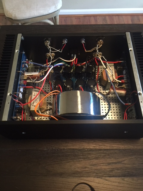

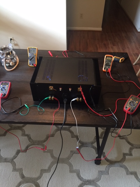

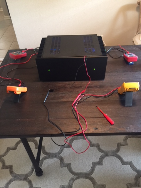

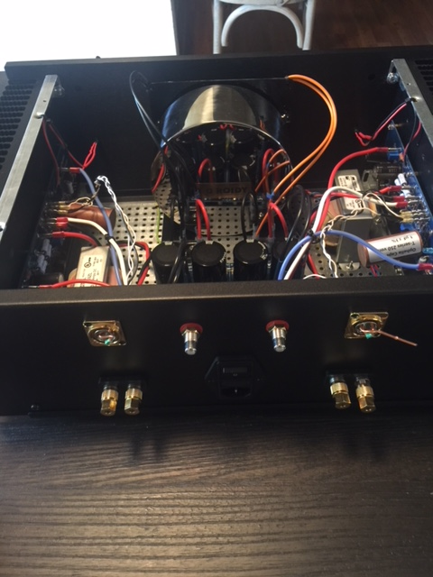

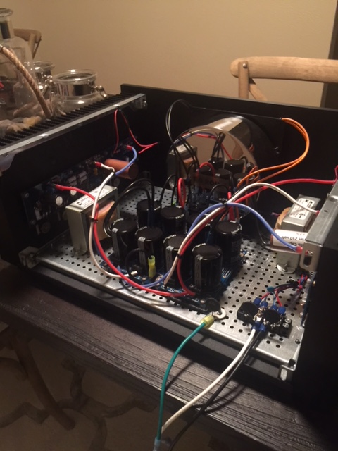

Big thanks for 6L6 for answering my endless questions as this was my 1st amp build and Papa for sharing his work I was finally able to give birth to a 40lb bouncing baby Aleph J. A few complications in the 3rd trimester but all came out great. Just a few tidbits; I used a transformer from Toroidy and CLC filtering for the power supply. The binding posts, XLRs and chassis RCAs are from Cardas. I was also able to source some Toshiba Jfets as well. For C1 I decided not to use the Wima (I’ve heard them before and didn’t like them, just preference) and instead had Jens Nielsen of Ophelia Caps custom make the film caps for me. Jens spaced out/strengthened the leads to fit the boards and also fortified the casing to withstand the internal heat. Just like the Humble Homemade review the caps really don’t add much to the sound, being a tad warmer from neutral. I tried them w the Elnas and wasn’t my cup of tea (maybe I didn’t let them burn in enough) being congested in the mids but after changing the Elnas w/ Nichicons, everything smoothed out and opened up. I think the Ophelia’s like other parts that are on the neutral side hence why the Humble reviewer had slight congestion, either way I really like this cap as I got no congestion after the change and will use it on other builds if a film cap is needed.
I’ve never heard a First Watt amp so was going on forum members reviews and I must say this is an awesome amp! Very laid back w/ good sound staging and mellow highs. Completely different from the previous bridged Classe CA-100s I was using which were on the darker side in the mids. I look forward to building more of these as the Aleph J needs some siblings!

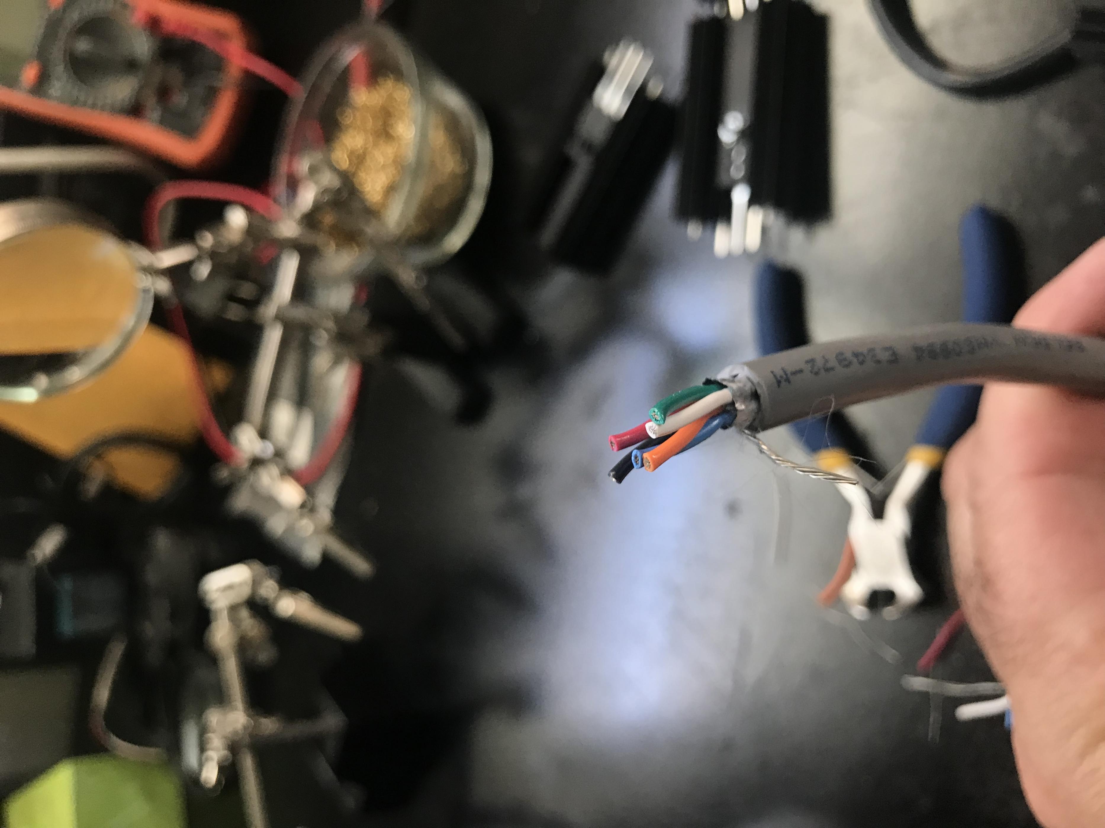

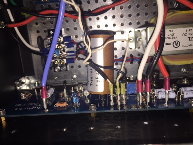

Getting near the end of my Aleph J project, it’s my first amplifier and has been a great learning experience, thanks everyone for all of your posts! Question on wiring both balanced and rca inputs in single chassis. I have some 6 conductor wire that is shielded and sports an uninsulated ground wire. I was going to run one wire each from +v rca and xlr terminating each to +v input on board, same with -v . Now I’m not sure if I should use the bare shield wire connected to the ground on the xlr and terminate on the chassis or use one of the other insulated wires in the package. From my reading here grounding is very important with respect to noise elimination, perhaps I should keep it simple and just use some standard wire. Does anyone see an advantage to the insulated cable?
