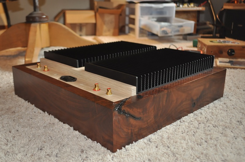

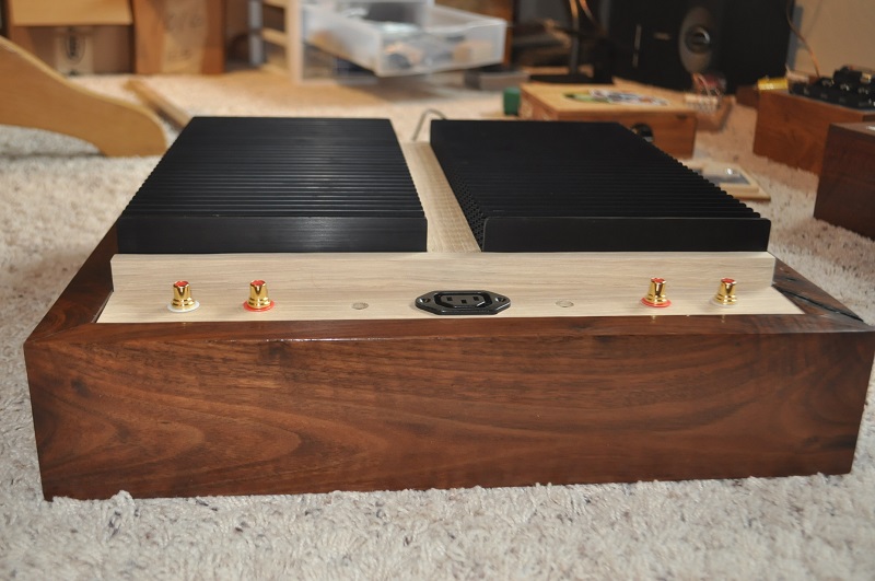

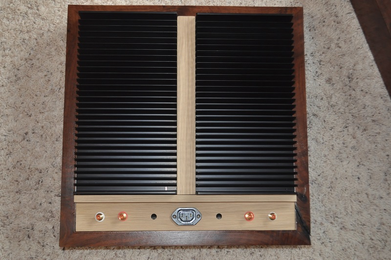

I was on a roll for a while building bases just for practice using wood from a tree we had cut down on our property. I modified this a bit to work. Light colored wood is White Oak.
Can use a heatsink for a grounding point?
Pass DIY Addict
Joined 2000
I always appreciate nice woodwork- the contrast of colors is very nice! Looks like a modified tube amp 😉 Do you have a way to measure the temp of your sinks? This is less than optimal orientation and I'm curious what kind of temps it produces.
I like the cracks in the wood myself. Gives it character but many would disagree. Do not use heatsinks for ground. Use star ground as per Nelson instructions.
That IEC power socket looks dangerous - the connecting power cord would need exposed power pins. Fortunately standard power cords do not have exposed power pins and would not fit that socket.
Haven't put together the ps yet. The bottoms open. It will have footers. I'll take some measurements when it's time.
That's going in the trash. I see where you're coming from. Thanks
And the wood piece I now have where the input/outputs are located will be changed out to a 4mm piece of aluminum for an easy grounding location.
