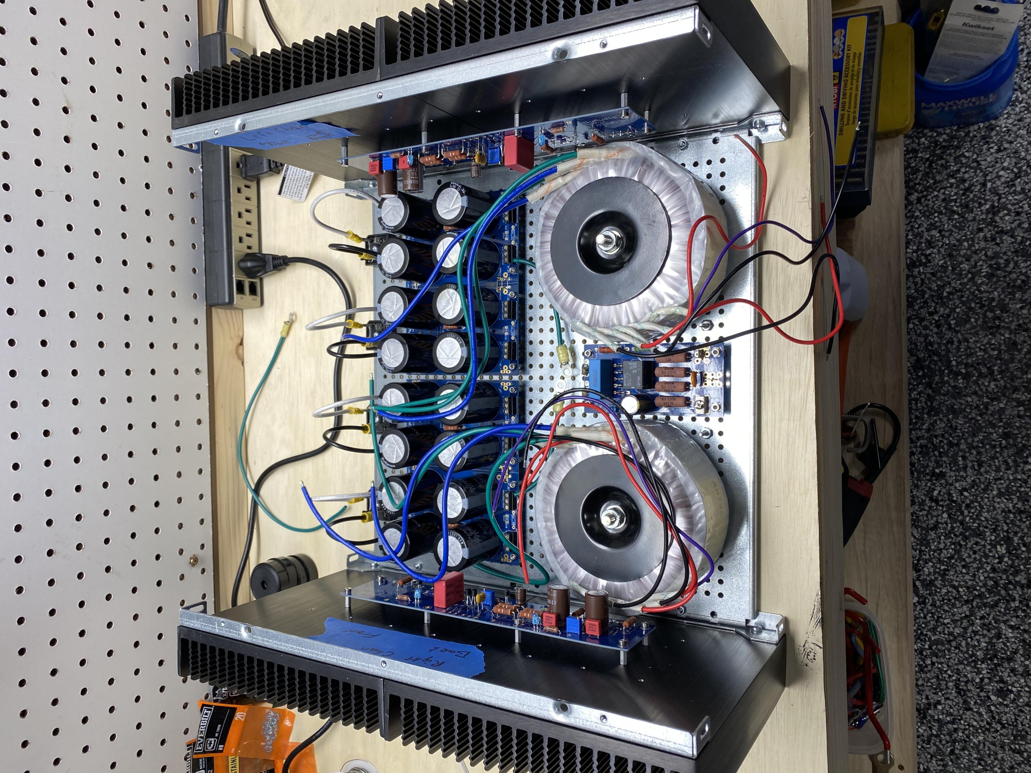

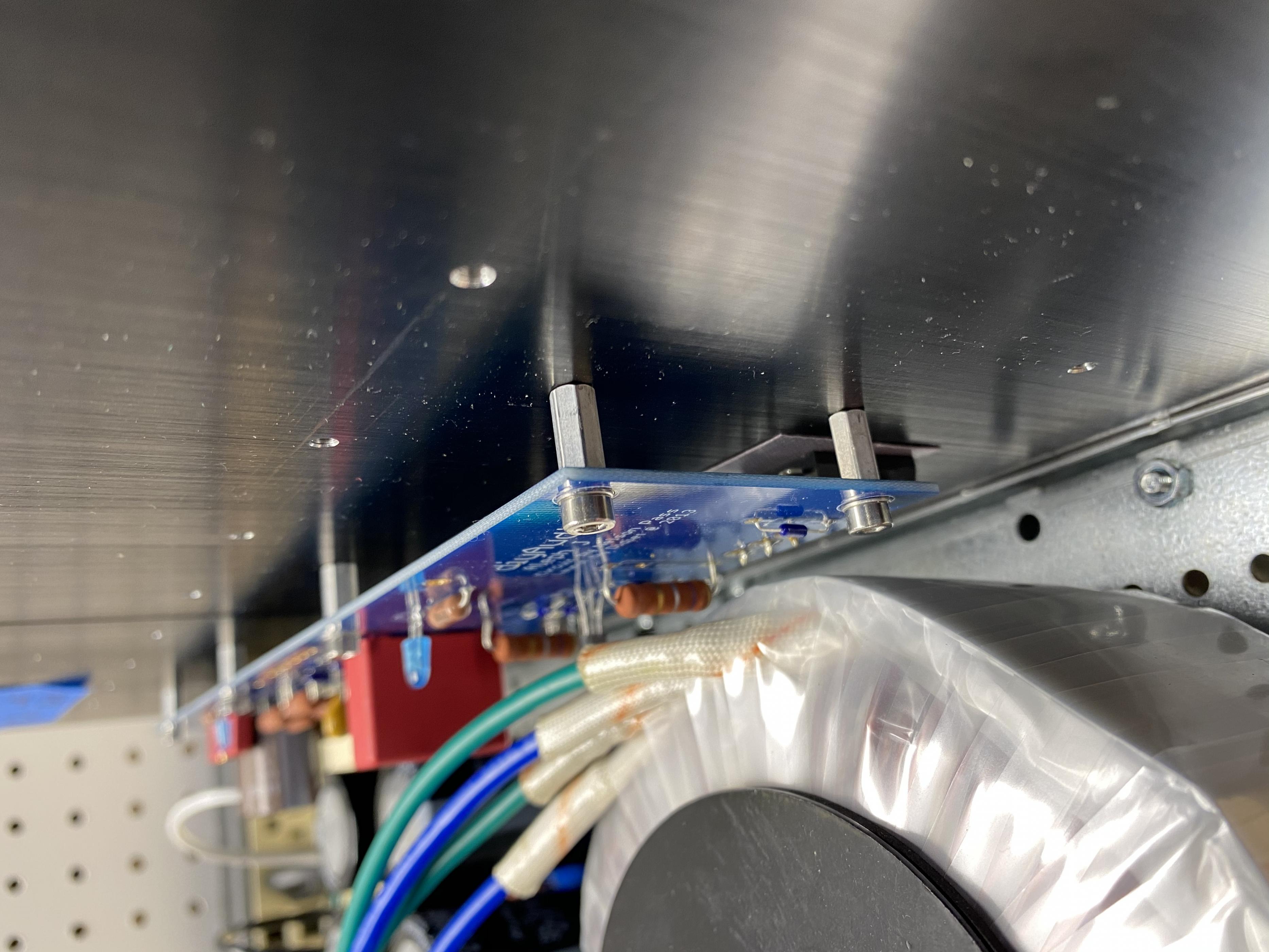

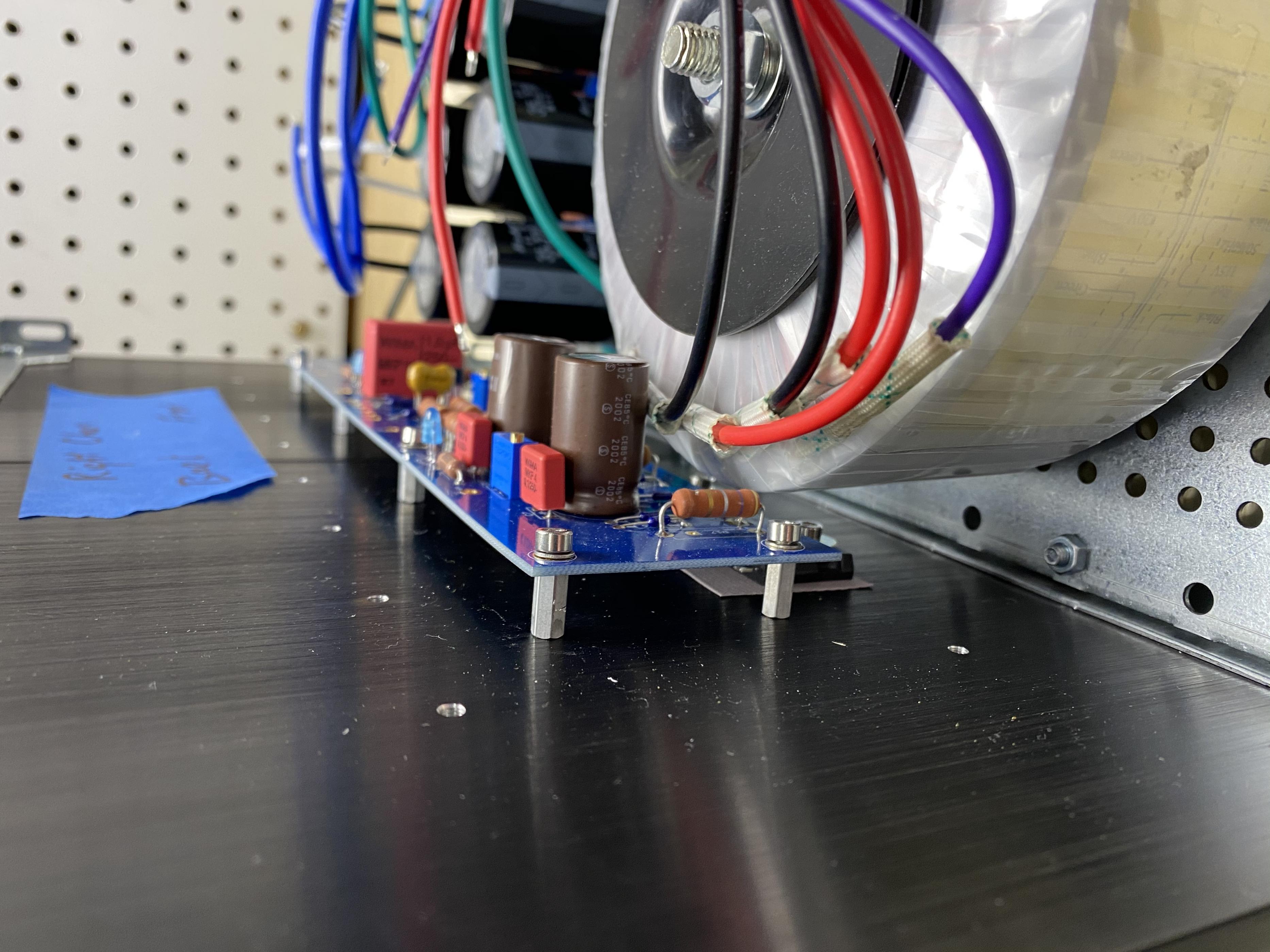

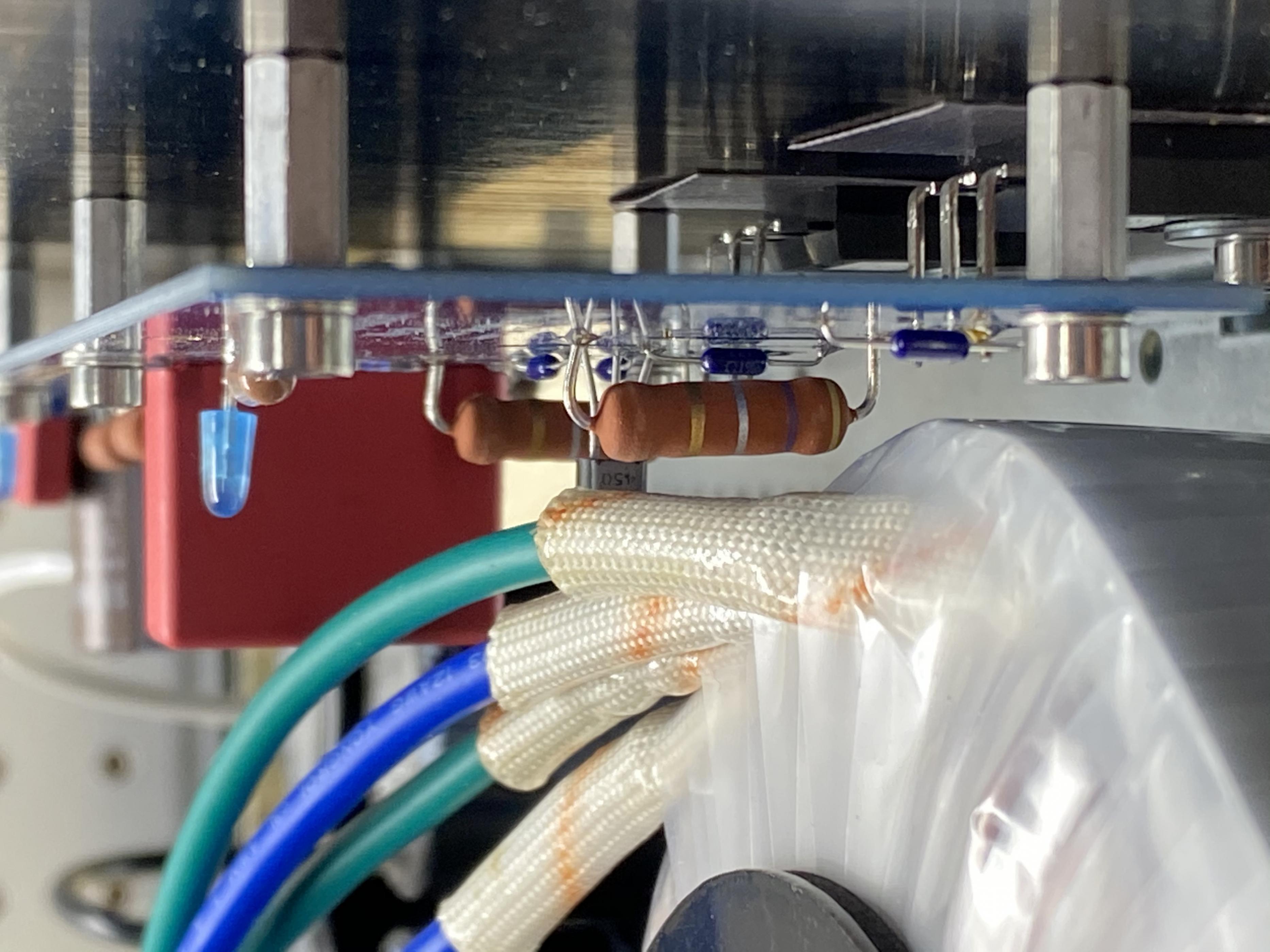

All - back to this after a few weeks and I’m doing my test for...and it’s really tight. Wondering if too tight; can’t rule out that the transformer wires might contact a resistor or such on the amp boards. What do you think?

First of all, have you tested the power supply without the amps wired up to them? This is where the dim bulb test referenced above really helps. You also need to verify that your V+ and V- voltages are what you should expect based on the power transformer AC secondary windings provide. Build and test in stages and you can rule out certain things if something is off.
Are you constructing a dual mono Aleph J? Without an overhead photo, it’s difficult to see why the transformer is positioned so closely to the amplifier boards.
If this is the case, you might consider orienting the power transformers 90 degrees so they are mounted vertically using L-brackets, or alternatively stack the transformers. With each transformer using the mounting hardware. If you stack the transformers, you’ll need a single long bolt to do this.
Yes, it’s dual mono. Stacked or side mount is a great idea. Probably turned sideways will be best for this. Photo of overall build here. I haven’t wired anything up yet.

You guys. Seriously. Thank you so much. I'm listening right now to my new Aleph Jason, hum free.
Had a chat with a forum member who looked over my stuff. My bridges were reversed, I didn't short my RCAs (I'm listening rn with XLRs), and one of my four amp board LEDs was wired wrong. But literally everything else was a breeze. All the measurements. It was a quick and painless process to measure--when told what to measure.

The toroidal are to close to the amp-boards for my taste—those will heat up to what, 60°C minimum? Underneath the torpid which I‘d guess won‘t fry but won‘t like it either...
