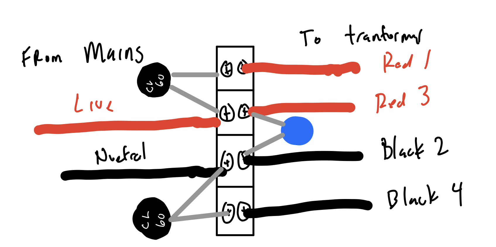

C9 doesn't go on the PSU board, but will run between the board and the chassis ground. You can see it on the First Watt PSU schematic here. I haven't gotten there in my build yet, so I'm not sure exactly how that hooks up yet. If you're eager to jump ahead, I think I've seen it in photos either in this thread or in 6L6's "illustrated build guide" thread. (Or if someone wants to explain it and show photos, that would also be nice.)

Hi, C9 goes across the transformer primary.
The only connection between the PSU board and the chassis ground should be the ground lift CL60 as shown on the bottom right of the psu schematic.
Andy
@Awh is correct, and I was wrong. Sorry! I was thinking of the ground lift CL60, exactly as @Awh said. The image for the correct wiring of C9 below comes from here.
711117d1540357845-illustrated-guide-building-f5-eb28128d-b35e-44ba-a648-c50db6e04717-jpeg

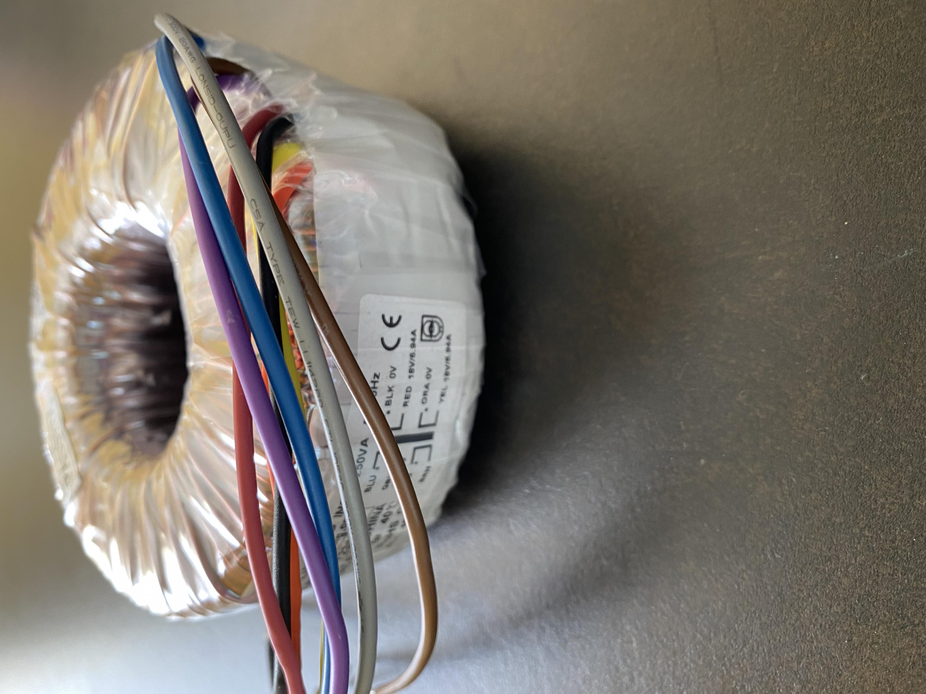

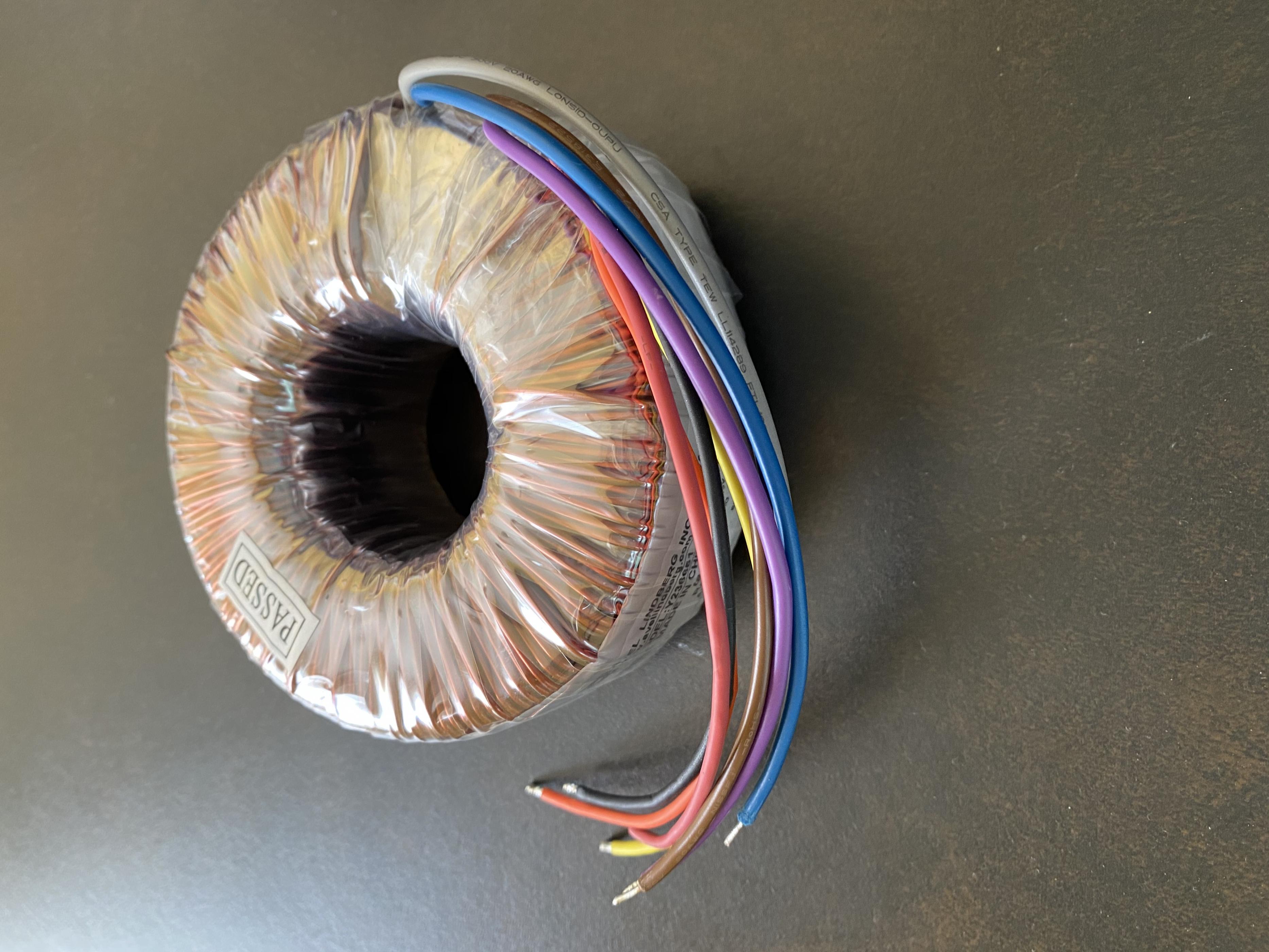

Question re transformer
I realize this sounds like a stupid question, but I will ask anyway. I just received my two transformers (I am building mono blocks). They are Avel-Lindberg 18-18 volt 250VA. They came in a box, but appear to be wrapped in a plastic covering. I assume I do not remove that covering, or do I? Here are pictures (they keep showing sideways, I tried rotating them but it does not work):
