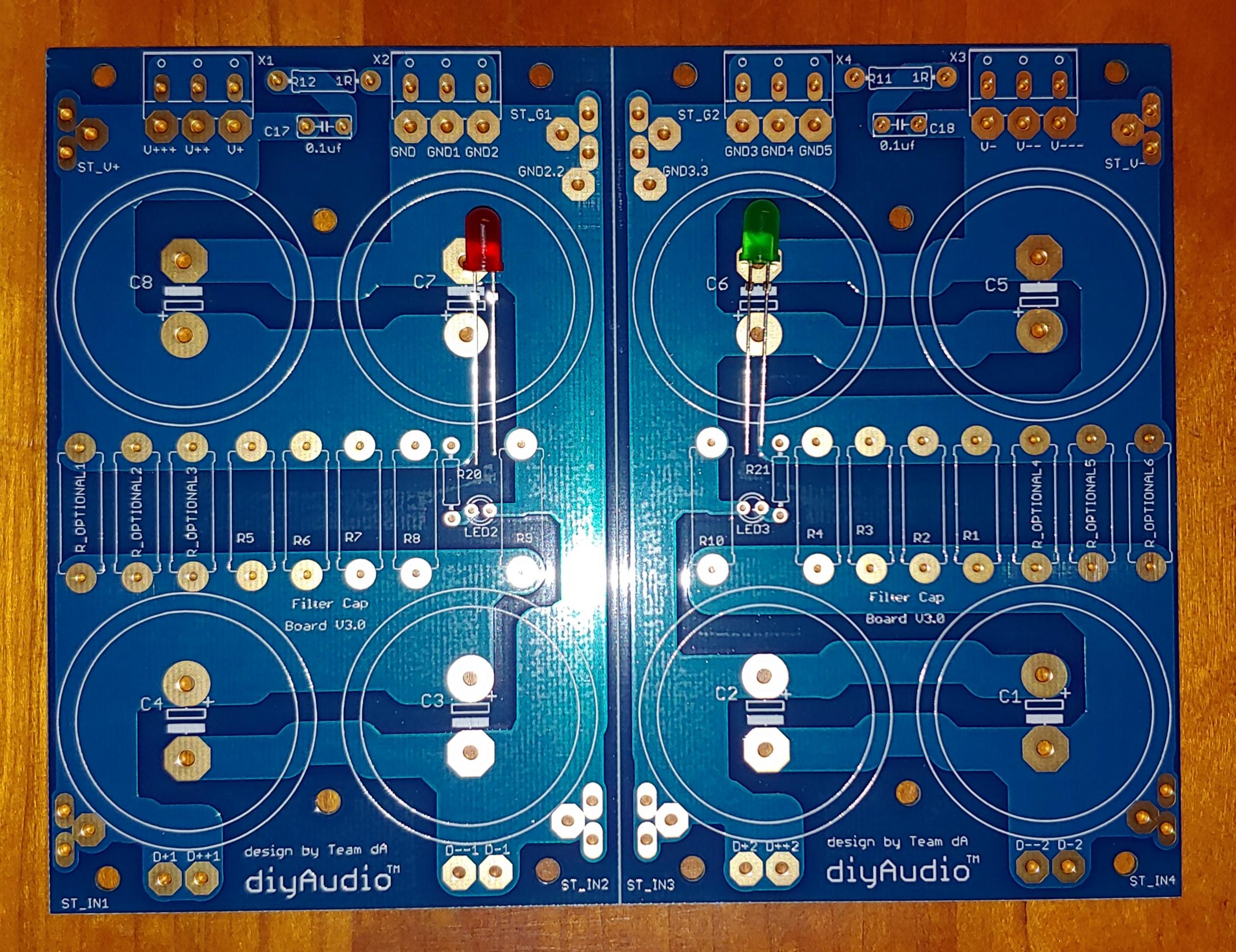

Something I just learned and don't remember if I did correctly: the LED's long leg is positive. On the amp board where the LED goes, there are two round circles. One side of the circles has a flat spot, like if a car that sat for years in a field had a flat, but then you moved the car a few inches forward so that the flat spot is on the side instead of on bottom. That flat side is where the long leg goes.
It looks like this: https://startingelectronics.org/beginners/components/LED/LED-polarity.png
Mentioning here because it, too, is not in the BG. If a newb like me has that question, there are sure to be others. Well, to be honest, I didn't even know that LEDs had polarity differences and I later discovered they did...
Unfortunately, it's impossible to tell from markings alone which side is the "flat" side on the PSU board. The solder pads break up circles so that both sides are identical. I ended up putting the anode (oooh, big word! [long leg]) into the side that had foil tracings in the board. Can I get a double check on this?
The long leg, (anode, +) needs to go into the PCB pad that is more positive.
On the V+ rail it’s straightforward... the long leg needs to connect to V+ and the cathode to ground.
It’s a little bit of a logic jump on the V- side, as ground is actually more positive than V-. So the anode needs to connect to the pad attached to ground and cathode to V-.
Also worth noting, the location of the resistor doesn’t matter, it can be on either leg.

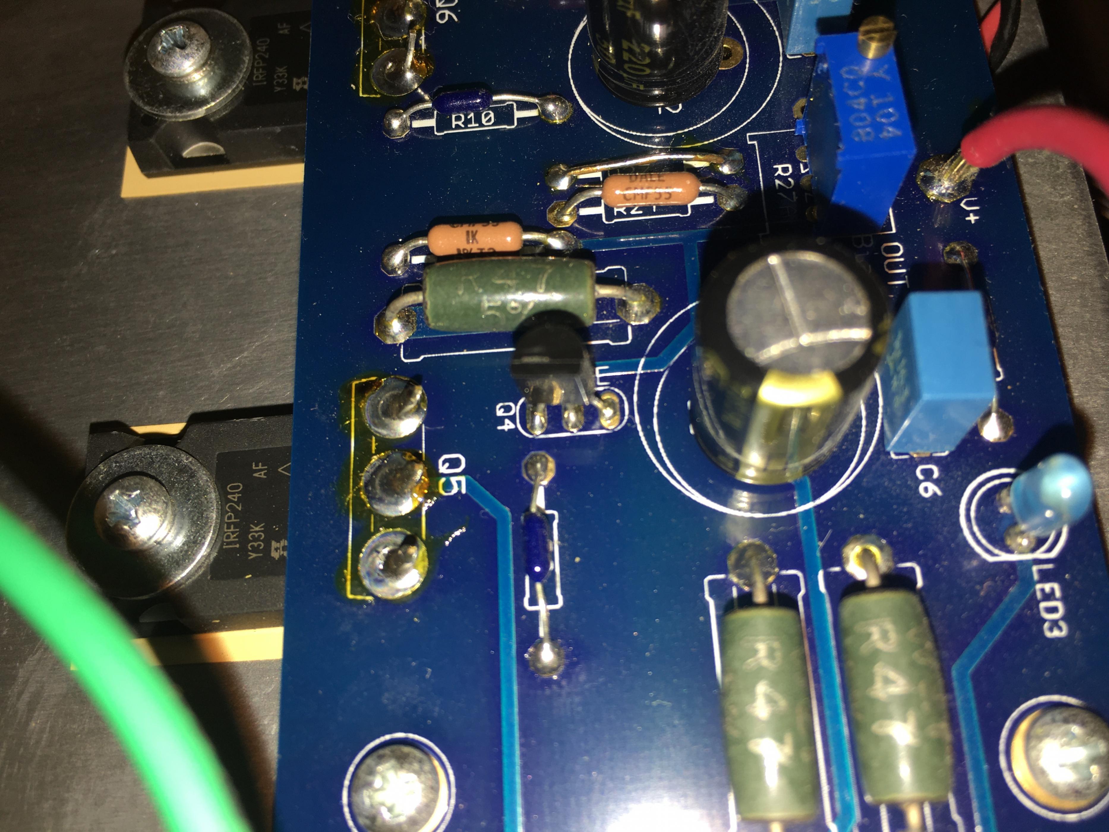

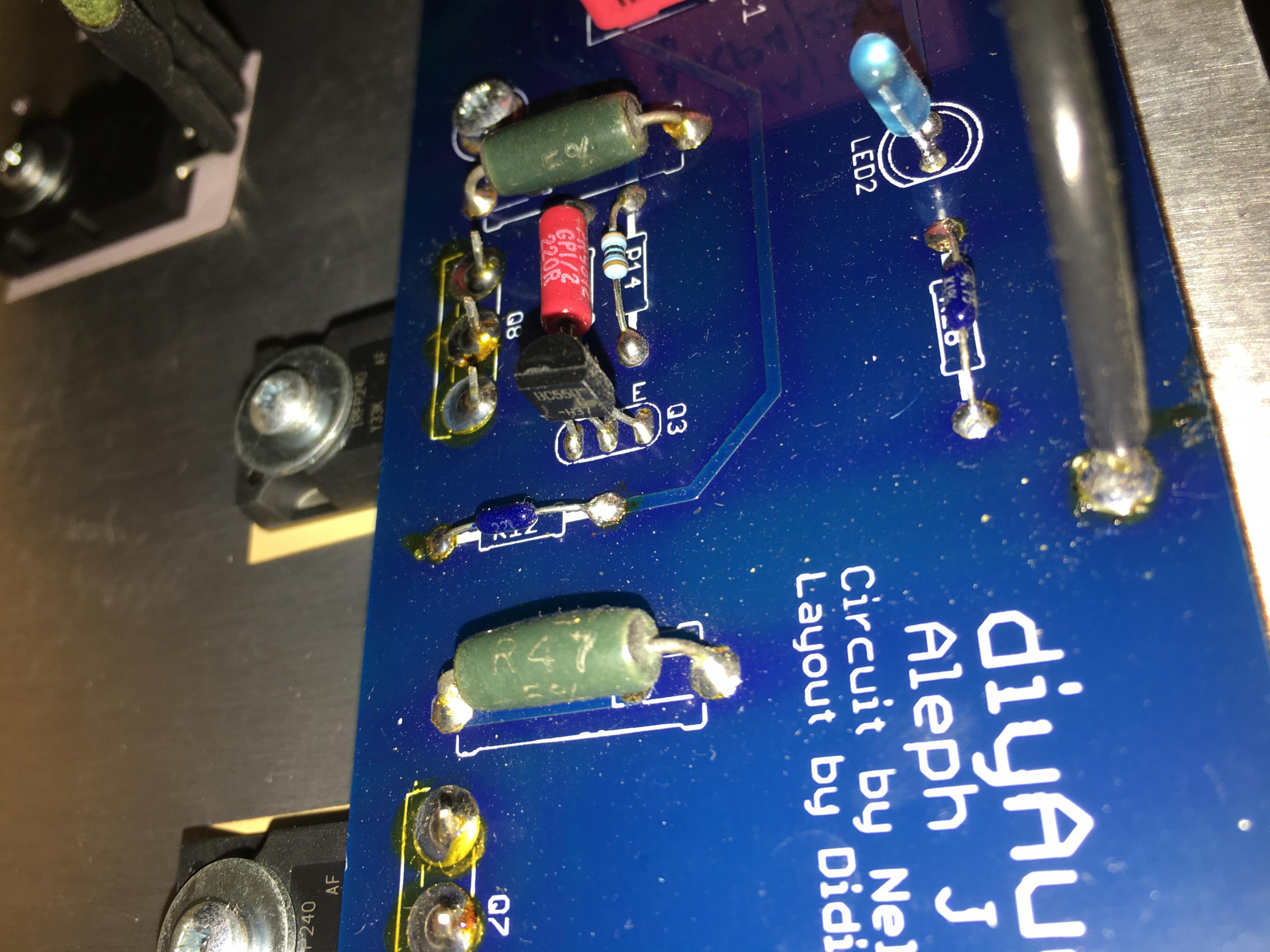

I'm well into building my Aleph J now, having completed the power supply psb and started the first amp board. So far it's been pretty straightforward, following the original build guide and referring to the BoM, but four issues have arisen about which I'd very much appreciate some guidance.
1. C6 and C7. The parts that Mouser sent, which match the recently posted BoM, have incorrect pin spacing, 10mm instead of 5mm. I stumbled across some discussion deep into the 500+ pages of the original guide that suggested these could in fact be left out. Can someone confirm this? If, so, should jumpers be used instead?
2. Smaller MOSFET orientation. I can't find where this has been specified, but it must be obvious to those more experienced than I am. I've searched for and enlarged a number of pictures of completed boards, and see what appears to be both orientations represented. I found no link in the DIY store's listing to a spec sheet, but perhaps I just don't know where to look.
3. In some photos there is a zip tie around the paired JFETs. Is this advised? If so, why?
4. R8 appears to be alternately filled with a jumper or a pot. What are the pros and cons of this decision?

The input j fets should be held together with some heat shrink or a zip tie and a bit of thermal paste between them. Helps them stay the same temperature
Some closeup pics might help for orientation. You should look up the data sheet for the device your using and note the pin out. Then use the schematic to verify the orientation.
The circuit will work without c6 and c7
Thanks, evanc, for the quick and helpful reply. The closeup photos were great at showing orientation of the transistors.
My questions were in part to address what I understand to be the overall purpose of this thread, to help flohman and alanhuth in preparing a new build guide for 'noobs', like me. For others like me moving along from building a pair of ACAs, details like orientation of transistors are essential. Similarly, situations where the builder has more than one option (e.g. insert a pot or a resistor) require a bit more background than we are likely to bring. I'm thoroughly enjoying acquiring this background, and very much appreciate this thread and the willingness of those of you more learned and experienced to help us new folks build our skills. And in the case of the Aleph J, an amazingly capable amp!
Happy I could be a help.
For r8 I have a potentiometer. Maybe someone more knowledgeable can chime in on what a good value fixed resistor could be used in this position
Like I said I really think it’s good to get the data sheet for all the active parts and note the pin out. I usually sketch a picture right on my printed out schematic. Then go to the schematic and board and figure out how things should be oriented. It’s important because Sometimes we can inadvertently choose parts with different configurations then previous builders.
