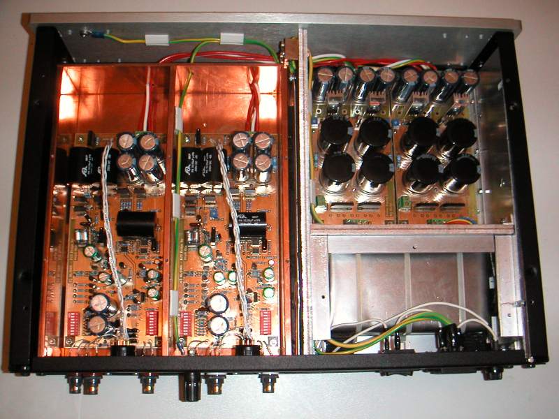

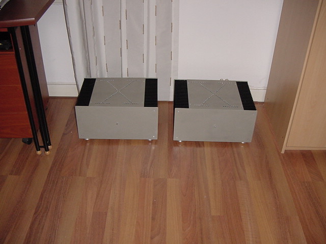

I just modified the german pre with 8 opa's627 and bypassing them + a bigger power supply and al new elko's. It sounds great but I. am still thinking of an Pass pre. I first have to sell the german pre. Greetings teake

My Aleph

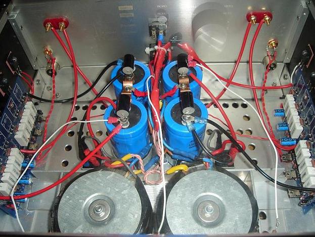

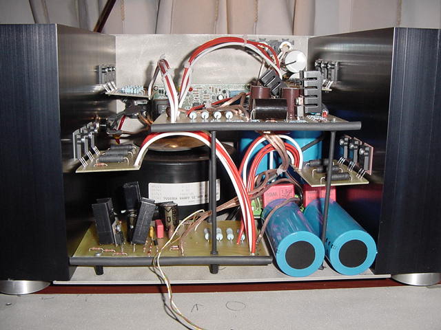

Well, then I will also will post my Aleph

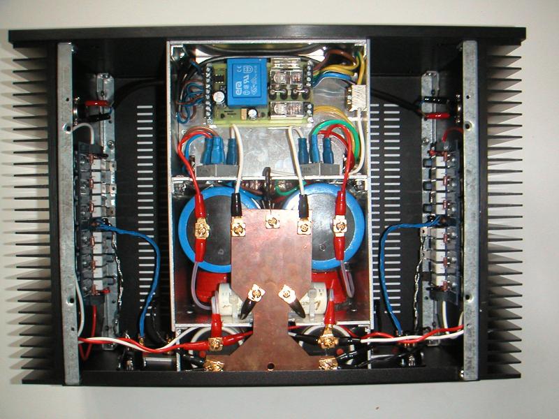

I tried to minimize wiring, as these can introduce all kinds of trouble. The power house is based in its own aluminium box in the middle as containment of the magnetic field.
(that field containment was not fully successfull.
But I learned from my mistakes, and with my Pass ONO I had it pat.)
The soft-start module is completely my own design. It works both with a contact and an external 12VDC signal. It's a 2 relays softstart with all thermistors, etc. in the DC signal path. Startup with four resistors in series, then bridged with the second relays. And it has signals and delivers power for a DC protection when neccesary.
Greetings, Harry

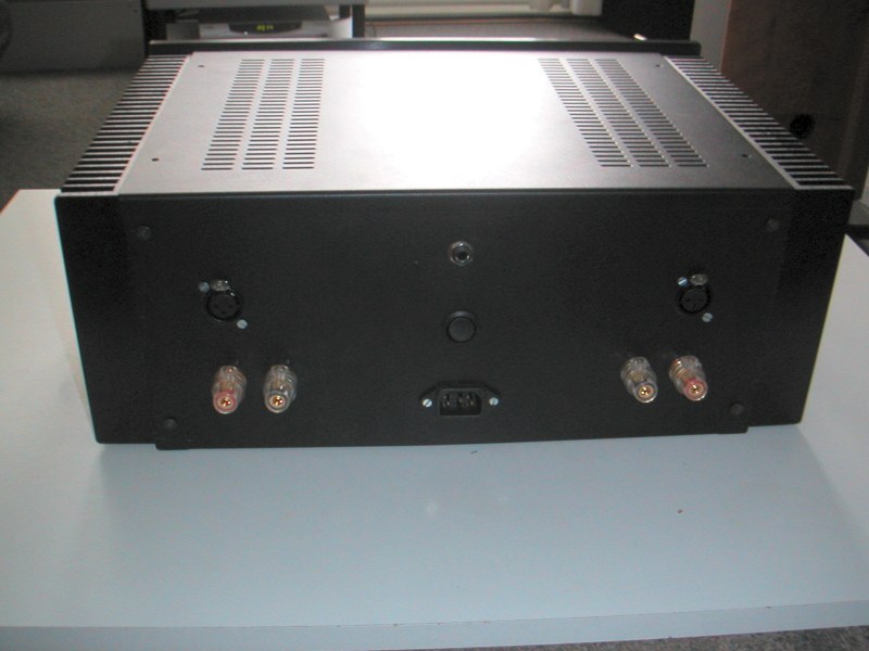

And this is the backside.
One of the reasons for the long building period is the fact that I wanted to be able to solder the signal wiring, but still be able to dismantle the system. That meant using XLR connectors mounted on the inside. The 24 mm punch I needed for that had 10 weeks delivery time!

Really impressed by your Aleph 5 end result, especially as i've read day by day what it took to get there, Teake.
