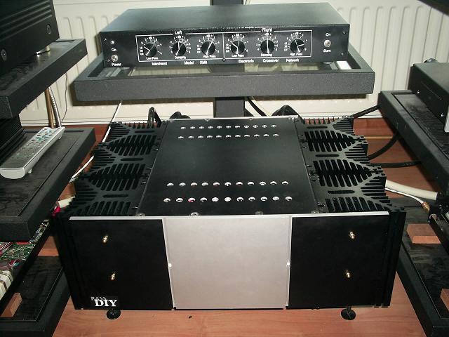

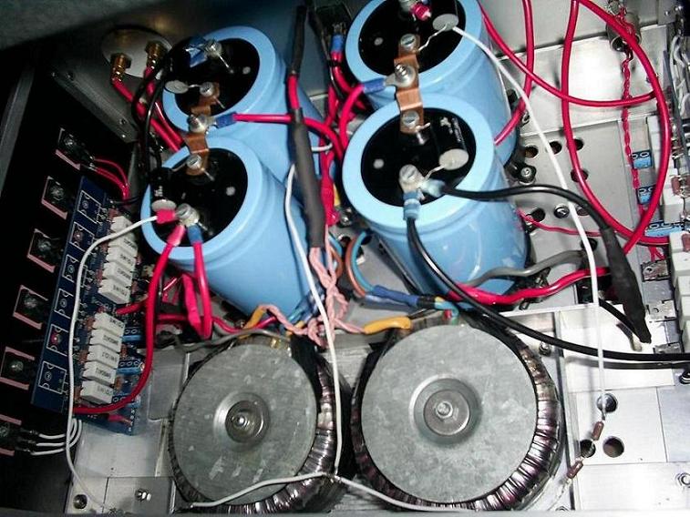

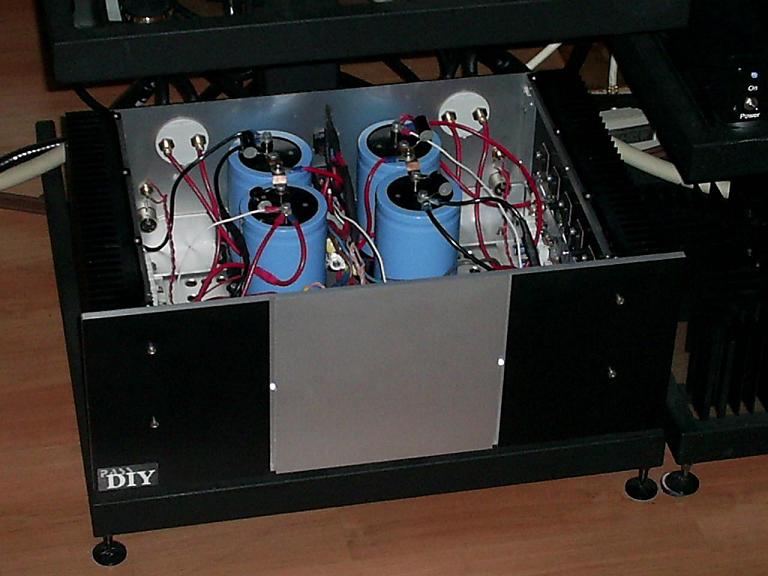

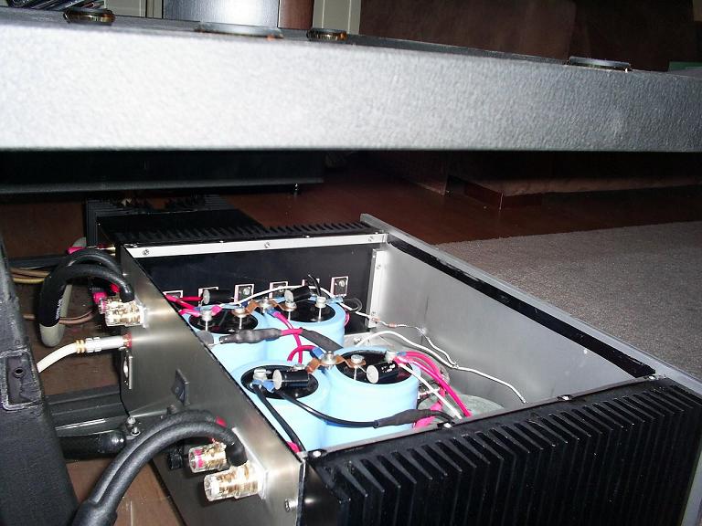

back again with my aleph 5!
I made a little upgrade, I went from 4 x 47000uf BC's to 4 66000uf mallory and it made some real difference, more dynamics, more stage and more micro/macro information, the music is going easyer and it's more relaxed. Some photo,s Grtz teake

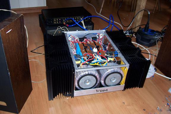

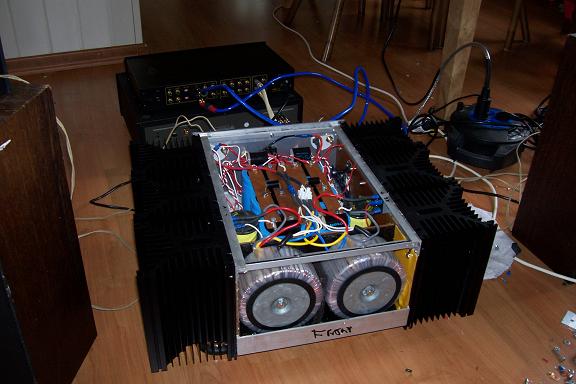

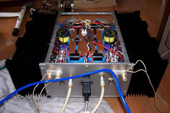

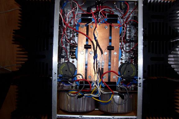

Hi there!
It lookes like a disease! I upgraded the aleph again, put some more capacitance, 6 big coolingblocks, silmic 220uf's, 2 x 625va and 2 x 2,2mH inductance, and again I could hear more. Bigger stage, deeper, more backgroundfinesse, but also cleaner, les warm. The heatsinks are getting handwarm, between 20 and 30 degrees. sometimes there is little hum wich gets bigger and than dissipears.
I wonder if I should put R19 out to see if I get more? Any answer is welkom! And I am going through! Grtz Teake

Hi Teake,
Really looking good! And probably sounds great too. Next stop: monoblocks. 😀
Or changing your Pre to a Pass Pre for balanced connections.
Keep on having fun!
