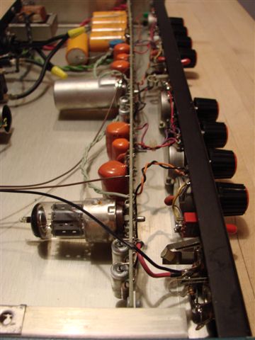

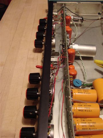

Hello, great thread so far!
I have a 35 year old F2-B I play bass through it, and nothing else sounds as good to me to this day.
I'm really good with a soldering iron, understand very basic electricity etc. but stop WAY short of saying I know electronics. Schematics give me the willies, but I think I can get through this one... If I have to. This would be my biggest electronics project though, so I kinda need some hand holding to get started.
The last few years I've noticed the sound seems to have progressively dulled and lost it's life. The unit also has a little hum, and is pretty noisy. I was wondering if anyone could take a look at a picture and / or suggest the items I can replace which will restore it, maybe even make it sound better than new. All the resistors, etc. came with it originally, and it may have been re-capped back in the 80's but nothing has been done to it since then.
Here are the things I'd like to add or update with it:
It has an old 2 prong electrical cord with no safety ground - That can't be good when beer gets spilled on it.
I'm feeding the input with active EMG pickups. They have 200 ohms output impedance. Should I put a resistor on the input? I've read the F2-B really only likes passive pickups.
I'd REALLY like to make the main output a balanced 3 conductor connection instead of the unbalanced 1/4" one currently there, is that possible? All of the other gear in my rack is balanced in/out, and I use the rig in some really noisy environments!
I'm feeding a balanced TRS 10K ohms input (a compressor) from this unit. I don't really think I need more gain, I'd just like to ensure no hum from lighting, electrical, etc.. As well as giving the compressor the drive it wants to operate well.
Here is some good advice I've been given so far elsewhere, can anyone add to or suggest changes? :
" ... Tubes and caps are the most likely for hum.
The orange ones are not electrolytics and do not need replacing. All cracked resistors obviously need replacing
Every one of the electrolytics needs replacing. The yellow ones and the silver ones.
If you want to quiet the noise, replace one of the resistors in the PS with a cheap choke -- it'll do wonders. - Replace the first 1K5 resistor with something like a hammond 154G
Replace the power cord! Particularly since you plug an instrument that you touch in to this, that should be fixed asap.
If you want a balanced output, use an output transformer -- Edcor would be good here, something like the XSM10K/10K would likely work well and could just be bolted to the output.
there is an issue which is that the Z out of the preamp is like 50K and won't likely do a good job driving the transformer's inductance. I think you should either work another tube in there (6T4 perhaps?) to lower the Z out so it can actually drive something like a cable, or the next stage, or you should switch from the 12ax7 to something with a lower rp -- maybe a 12ay7 or 12at7. The former will increase the signal a bit -- a 0.1u coupling cap will be too small in either case.
Assuming you do lower the impedance, on the primary you would connect out to + and - to ground (or the cathode if you like), and leave the input ct unconnected. For out, the "right" way to do it is to connect the + and - transformer taps to hot and cold, and connect the chassis (now grounded to safety ground) to the "ground" pin on the xlr.. ... "
